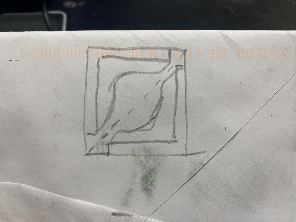

I don't have a fancy CAD machine but my first thought on how to make one is as follows:  Start with a legth of thick walled square tubing of the appropriate inside dimensions.  Cut a length twice the length of the final bracket (the sides with the holes in the above illustration) (call it 2X.  Cut off the sides and bottom for X distance.  You now have a box of X length with a tab of X sticking out on one end.  Then, fold down the tab so that you have a box open on one side.  Weld the edges of the tab if you need that much strength.  Then, cut the box on the diagonal giving you triangular sides.  Drill the holes and there you are.
As I think about it you could start with a length of tubing 3X, close up 2 tabs to make a closed box, cut it on the diagonal and you would have 2 brackets and no waste.
I hope this make sense.  It would be a lot easier to show on the back of a bar napkin (how all great projects are originally designed.)
Another option would be to cut two pieces of angle iron to the inside width, sandwich them between two square pieces of plate, weld around the edges, cut the squares corner-to-corner, and grind smooth.
Here’s a back-of-the-envelope sketch (a poor second to a bar napkin, but it’s still morning):

Another option would be to cut two pieces of angle iron to the inside width, sandwich them between two square pieces of plate, weld around the edges, cut the squares corner-to-corner, and grind smooth. ...
Yeah, pretty sure that or something very similar is what I will go ahead and do -- Thanks.
