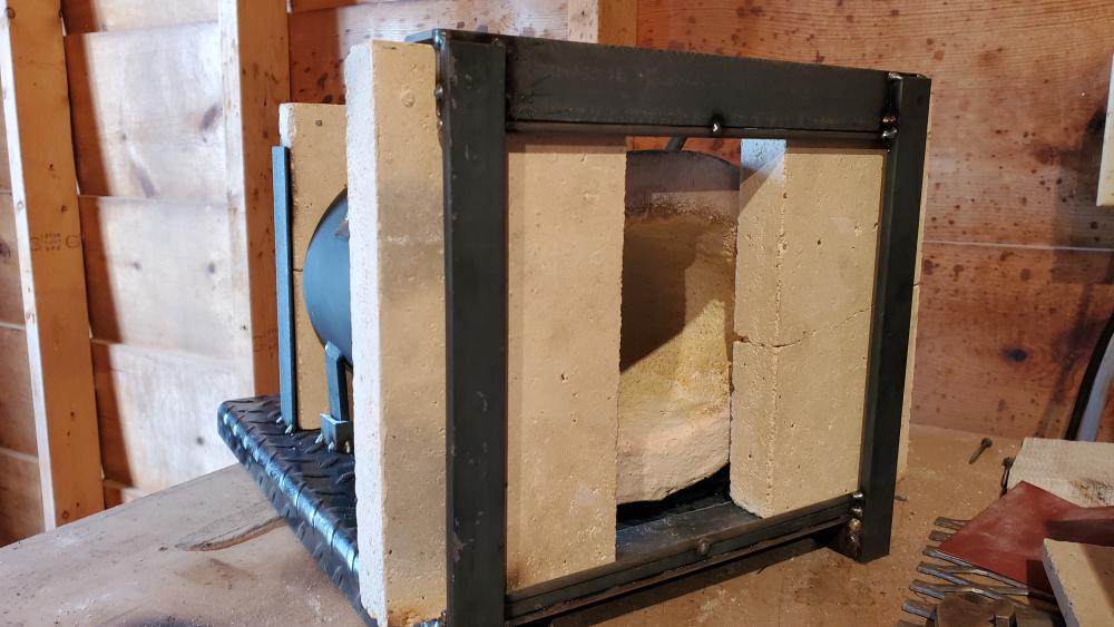

If you build a fixture from angle iron, it can keep your bricks stacked in place in front of--not against-- the front exhaust opening. Then you can keep your bricks an inch or more away the exhaust opening. With this little bit of distance, exhaust gases can rise up and escape from the forge, no matter how small the distance between top and bottom bricks. Thus, you can greatly decrease the size of the opening, without increasing back pressure in the forge. Once you have actual control of the exhaust opening, then it becomes time to coat the in-facing surface of your bricks with a re-emission coating, to radiate more heat back into the forge interior, greatly increasing the incandescence of internal surfaces. The higher into the incandescent range the forge surfaces get, the greater the amount of internal heat, for fuel gas expended, will get transferred to work surfaces.
Thank you for the input. I've been planning to build a fixture out of angle similar to what you mentioned, but I was going to keep the bricks pretty close to flush with the forge. Since installing the blower I have observed no issues with back pressure. Even when testing with both ends briefly blocked, the flame doesn't even sputter.

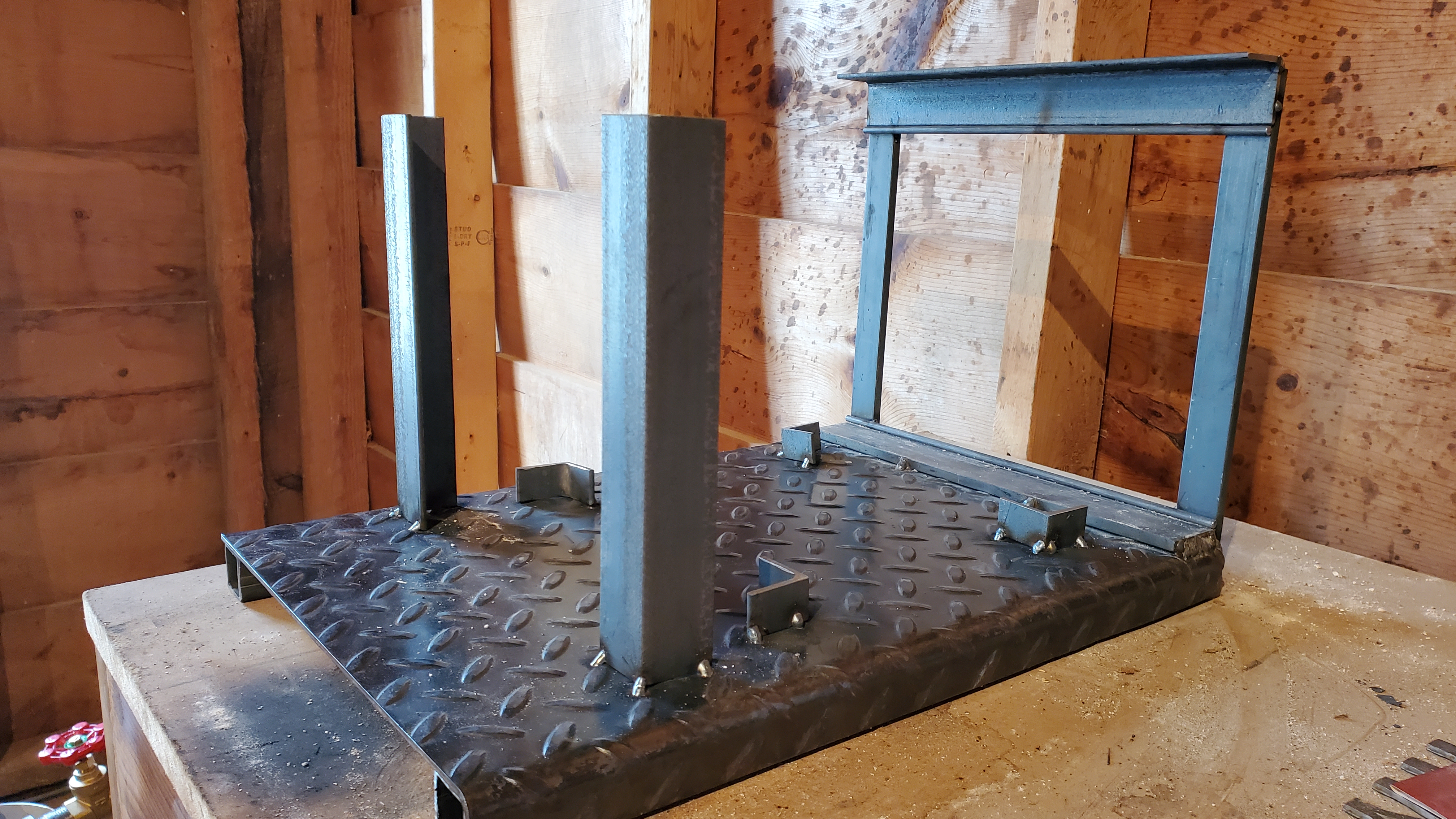

Quick update, I got a bench top stand welded together for the forge. It allows an air gap between hot surfaces and the bench and it also holds firebricks in place for the doors. Simple and 100% adjustable / removable.

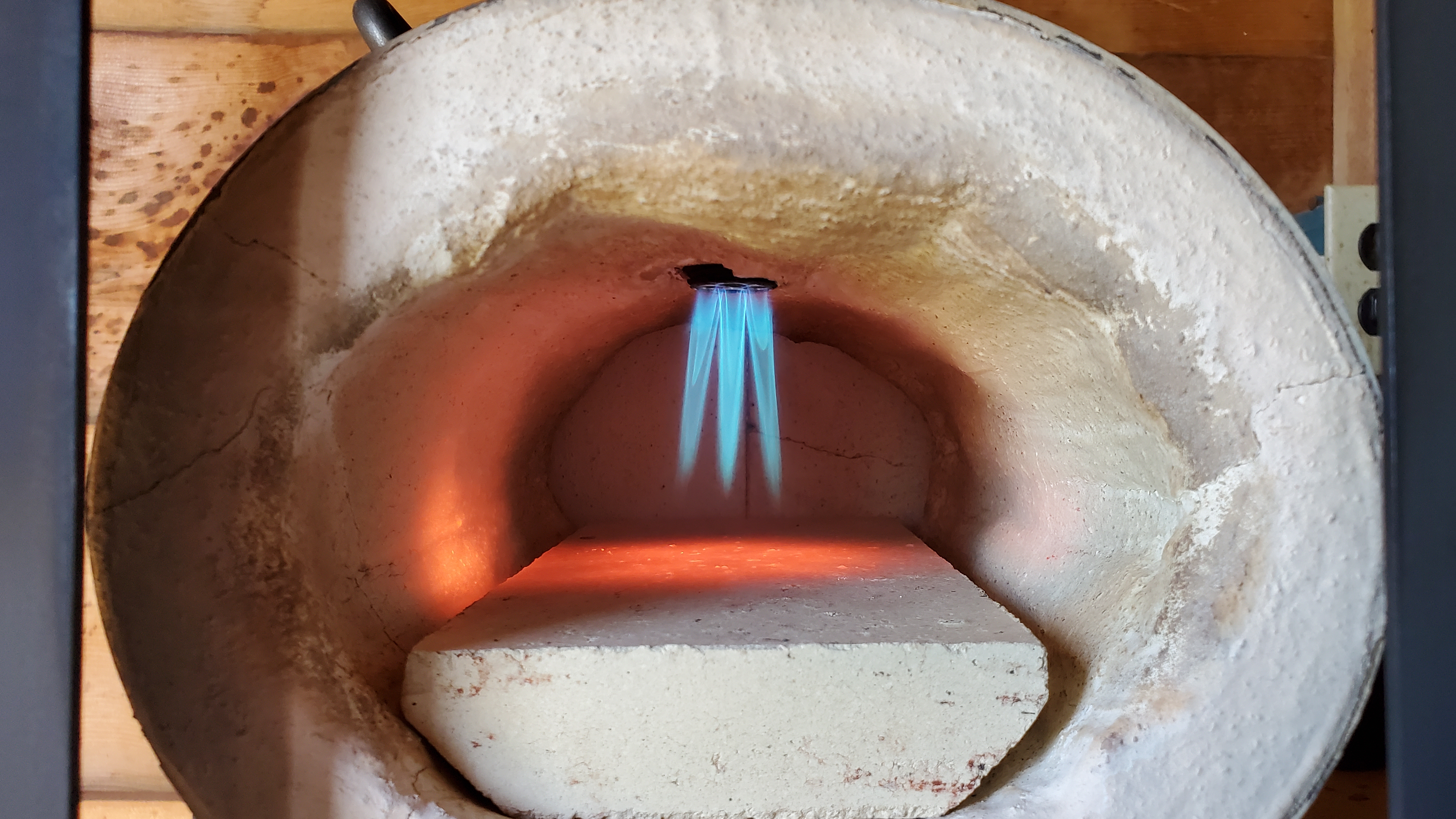

Today I finally got around to adding a diffuser. Hoping it will add stability and help hold the flame at lower temps. It sure required me to open up the regulator a little more!
Im not really sure if I like the flame output better or not. The flame is a little more sensitive to the mixture once up to temp and it certainly concentrates heat in the middle. Guess it'll take some use to decide.
Well, as the acknowledged picky of the group: I like it a lot. But...probably you'll find that more is better, as the smaller the flames the shorter they'll get; this leave more distance between them an your work, for all combustion to complete. Remember, it isn't just unburned fuel that makes trouble. Any super heated oxygen left over will instantly form scale ou your work pieces.
Thank you Mikey, that means a lot!

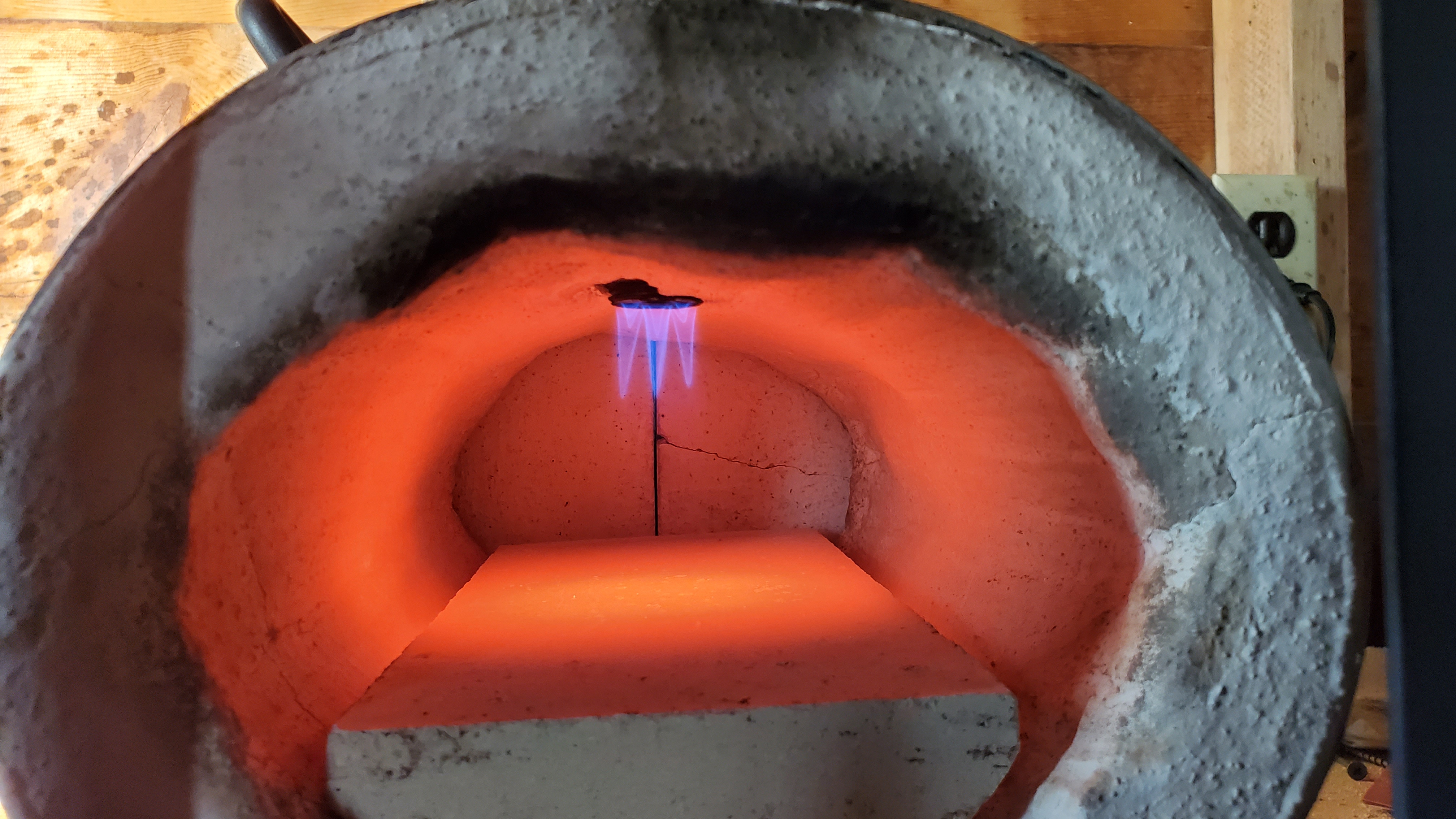

After some use, I think I'm on the right track. It's not quite as forgiving with settings on the high end, but it now it's able to be throttled way down and still run reliably without the flame traveling up into the burner tube.
(That black soot is just from momentary flames rolling out the front during transition between low and high.)
Oh, yeah! Those shorter flames look very likely :) I also note that they are a darker blue, which indicates leaner; but not too lean. You can always quickly heat up your forge with longer flames, and then cut them back, before inserting work pieces. After seeing this photo, I advise moving on with  finishing up little forge details, rather than playing with the burner any more. And I never advise stopping short of the goal. Congratulations on winning a Blue ribbon for burner design :D
