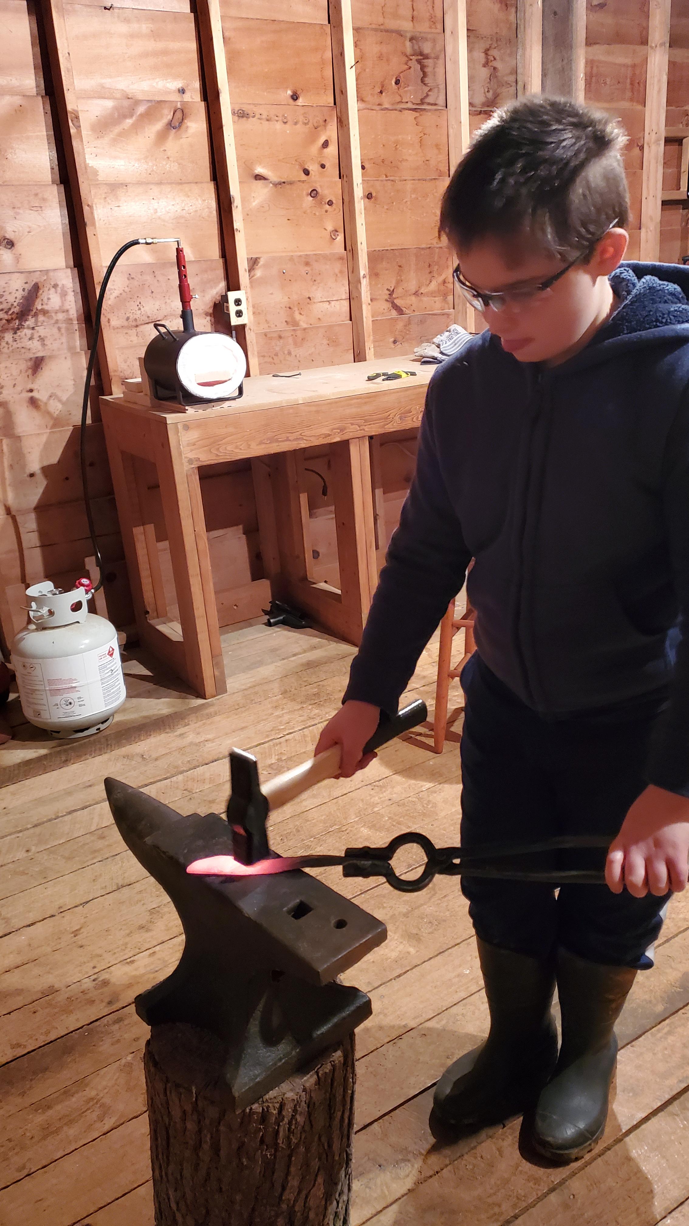

My 12 year old boy has been interested in smithing (I am too) so for Christmas we got him a Hell's Forge single burner. I plan to build a nicer forge with a ribbon burner if he sticks with it.
I have a question in relation to the jet size. The manual mentioned it being .035"
I found that the regulator doesn't have to be opened much to heat the forge enough to work steel. (Which is good, because I'm making him buy his own propane.) However, in order to keep the flame from occasionally running back up into the 3/4 burner tube, I have to open it up more for the sake of velocity. There is a fair bit of dragon's breath as a result. Would a smaller jet help with this? I'm tempted to update it with a Frosty T-burner.
Also, when I try to partially cover the back to reflect heat, it also has the same effect on stability of the burner.

Lee, sorry, I can’t help much with the tuning, but I do have a two safety concerns. First, it looks like you son is wearing synthetic materials at the forge. Most synthetic materials are a big point of concern at the forge. Things can/will go wrong and you don’t want a hot piece of metal melting your clothes to you. Second, you need to get a heat shield on the wall behind the forge (if that’s where it’s going to stay.) You don’t want the dragons breath from the back of the forge to cook you wall. Safety first!

Thank you for the words of warning. I do need to get my son a leather apron and a cotton shirt for safety. As for position of the forge, that is temporary. I was very careful to monitor temps of all surroundings and there are some firebricks behind the forge too. I'll get a better arrangement worked out very soon!
A couple of inches of dragon's breath exiting the forge is standard.  I wouldn't be concerned until it gets past 8" in a darkish room.

If you put the forge on a piece of cement backer board and tack some to the wall behind it you won't have nearly the concerns about starting a fire. Even if the dragon's breath doesn't get close enough to start a fire it will dry the wood out to the point it won't take much.
No synthetics is a cardinal rule, cotton, wool, leather, linen, etc. are all good.
There's a good chance you won't be able to turn your forge down much. Naturally aspirated burners are sensitive to back pressure and that will increase when you close off the back. More seriously with this type forge are the exhaust gasses leaving the forge, the burner is right above and the gasses will wrap around the top and be drawn in, replacing combustion air.
Moving it away from the wall or better putting it on it's own stand so air can freely flow will help, a LITTLE cross breeze is a good idea no matter what.
Your forge will get hotter if you use fire brick to partially close the front opening. The project shown being heated above only requires a small opening.

From the picture the only suggestion I have that hasn't been mentioned is the anvil should be closer to the forge. One step is about standard that way the steel doesn't loose much heat getting to it. Might take a look at some of the shop layouts in the building or designing a shop thread.
I won't discuss the burner. You could do better, but it isn't your principle problem; space is.  for reasons I will never understand manufacturers keep positioning single flame burners at top-dead-center on their oval forges. It only takes a mount's thought to see it should be placed high up on one side, and aimed toward the far edge of the forge's floor.
You or your son has placed a thick brick over that floor, aggravating the lack of distance for the burner's flame to do its work.
Nevertheless, the forge's interior is reaching nearly into yellow incandescent range; this tells me that what you need isn't a change in burner, but a change in forge interior. Lose the brick; it will do far better service covering the rear opening.
Then, stack a baffle wall made of firebricks about 1" to 1-1/2" away from the edge of the front opening. Use Kast-O-lite 30 or Plistix 900 to make a much thinner forge floor, so as to protect the ceramic fiber blanket, and run Plistix around the rest of the forge interior, to protect the blanket and your son's health.

So I looked up this product; on their own site, they describe it as refractory cement. Not as castable refractory, nor as rigidizer. A legitimate rigidizer, such as fumed silica, is able to penetrate the entire thickness of ceramic wool blanket, and has a dye in it, which allows you to judge when that job is done. A castable refractory makes a suitable flame face, and does much to physically protect the insulating layers from damage.
Refractory cement is designed to glue refractory bricks together; not as a substitute for refractory, nor as a flame face. What it will do quite adequately is mix together with the blanket in a thin layer to provide limited protection of the ceramic fiber, within that layer from greater damage than the flame would do without it. What it will not do is to stop flame damage, provide adequate physical protection to the insulation, or provide sufficient support for the insulation.
So, the answer to you question is no; it is not sufficient to protect the floor. Yes, you should  add some Cast-O-lite 30 over it to make a floor, and you should also add Plistix 900 over it, to coat the whole forge interior; even over a Kast-O-lite 30 floor.
While waiting for these items to arrive and be used, nothing prevents you from running the forge at lower heats, in a very temporary mode.
