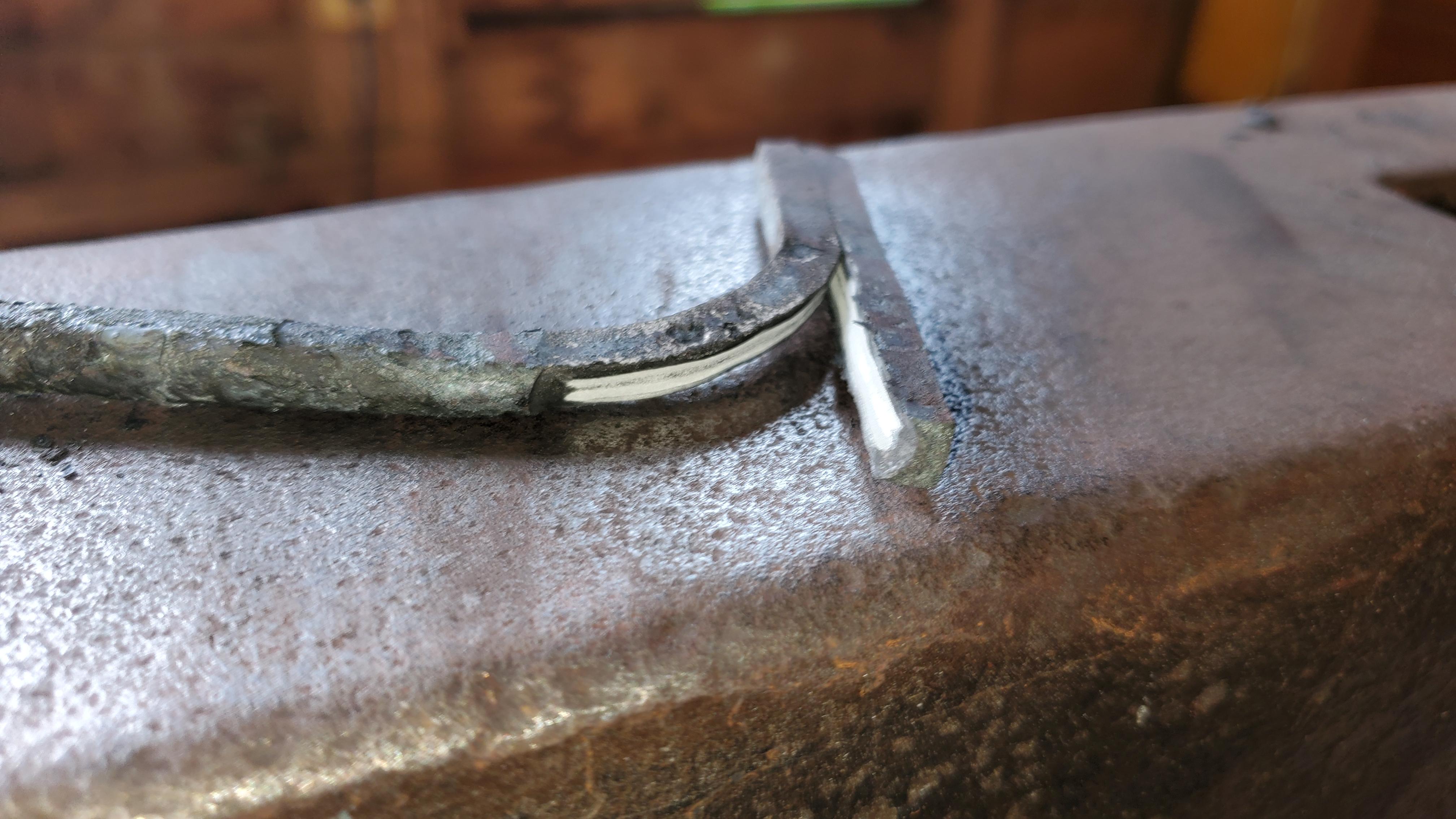

  3. My forge is very, very easy going when it comes to air/fuel ratio to hold a flame, especially once it heats up a little. Could my ratio be off enough that it prevents a good forge weld, even with flux? I know there has to be something simple that I'm missing, but it's about to drive me nuts.
  4. Still no bond.
  5. Buzz, excellent information! Thank you, I'll try again with square stock as you recommended. Apparently the forge was hotter than I realized. I turned it back down to my normal operating temp. I could see the color change but the temp reading didn't. *Sorry for the repeated picture in my last post. This forum doesn't always cooperate with my phone.
  6. I sanded it down clean and tried again. It still looks like the seam isn't bonding good. My Harbor Freight laser thermometer is reading between 2150⁰ and max. Borax was applied as soon as the steel was hot enough to melt it and reapplied each time before going back in the forge. Around what temp should I be at for mild steel? There are a lot of conflicting opinions out there citing "soak time" and how big your hammer is. It's my understanding that one should be conservative on the first round of hits?
  7. Mikey, Thank you for the input. I'll admit I didn't clean them up before putting them in the forge. I was under the impression the heat would remove any oxidization. I'll try it again this weekend. Seemed sooo close to sucess, but no banana.
  8. Hey guys it's been a while but birdhouses have finally let up and I got back out to the forge. I finally installed a new blower (same cheap type, just a new one) and it's working much smoother. I noticed how hot it looked and decided to give forge welding a shot. Low and behold, success!!! Nevermind, I got too excited. It split apart as I was trying to form it.

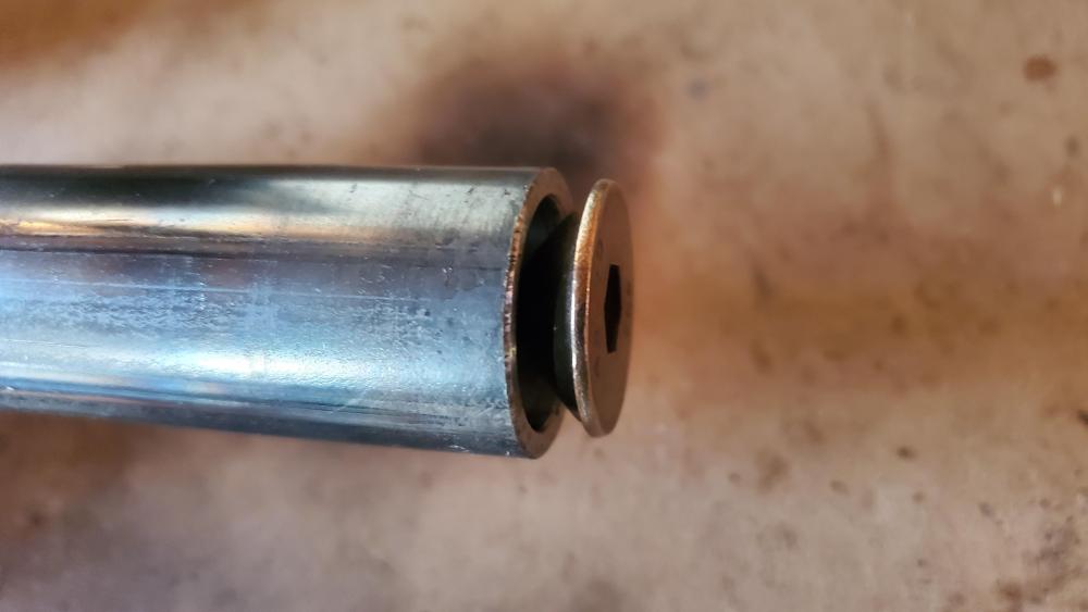

  13. I cranked it up a bit. Thd picture doesn't do it justice.
  14. Frosty, These pictures give a better example of how it fits in the burner tube. Mikey, I do agree that simplicity and repurposed parts would be excellent, but I've come to a point with my current forge and blower where nozzle design has to be balanced with efficiency of flow.
  15. The insert goes inside of a 3/4 black iron pipe that I cut down to size. I squared the end and trued the inside on a lathe. The spacer for the insert started as a piece of steel round stock that I turned down to just barely fit inside the 3/4 pipe after trueing. While it was still in the lathe I drilled a 5mm hole in the center. I cut the rest of it to shape with a milling machine. The cone of the insert is a 14mm (I think) stainless flathead bolt that I turned down to just a hair over 5mm then pressed into the spacer. I'll try to get a better picture of the assembly tonight after I get home from work.
  16. Thank you! I never can leave anything well enough alone. Last night I fired it up briefly but haven't had the opportunity to heat any steel. I hope the new burner will help reduce scaling caused by direct contact with the flame. That said, I might miss having a hot spot handy. I need to look into a better blower design. I've been using the same 12VDC blower for over a year. I do like using a smaller one but I wish it would maintain a bit higher static pressure. (Plus it vibrates a good bit.)

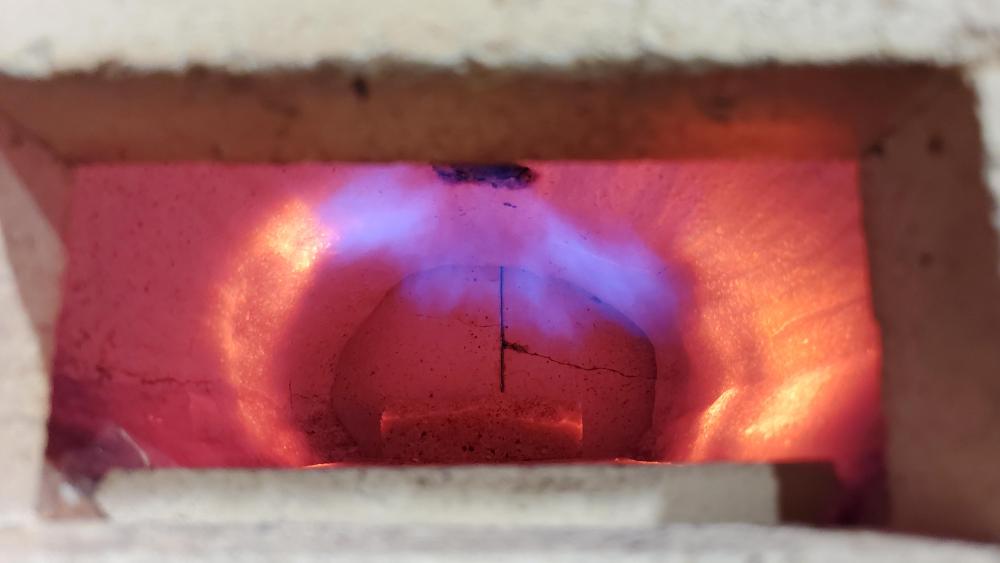

  17. It's hard to get a good picture of what my eye actually sees. The ceiling and walls heat first and it slowly travels down to the floor and then closes in toward the middle. It's hard to get a good picture of what my eye actually sees. The ceiling and walls heat first and it slowly travels down to the floor and then closes in toward the middle. Sorry for the double text above. This forum editor is kinda screwy sometimes. Anyway, below is my burner insert. I made the mistake of poking it and it fell out. (This started as a test fit anyway.) Apparently it stayed cool enough to prevent discoloration on all but the bottom face.

  20. Thanks guys. That last picture was with my previous burner nozzle design that I've been using. (The top brick on the front of the forge was temporarily removed for the picture.) The nozzle works well, but the bit of restriction it adds prevents my small blower from supplying the air needed for forge welding temperature. In a previous design, I had an additional 1" 90 to drop the fan input lower. That hurt output enough that I quickly changed back. The open nozzle I mentioned was requiring that much air and gas to keep the flame out of the burner throat. Recently I also tried a modified nozzle (that, oddly enough, I made with the forge) to kick the flame over to the side. I guess it did ok, but I wasn't impressed enough with it to bother letting the whole forge heat up. It seemed to really be concentrating the heat in one spot far more than my favorite nozzle. Maybe I should give it another whirl.

  25. Mikey, I experimented with raising the burner today. When I put it up inside the burner mount tube, it concintrated the gas flow straight down. In the attached picture, I have it up as far as possible without restricting the spread. I can confidently say that this little forge is probably as good as it's gonna get. (Zero dragon's breath either.)
