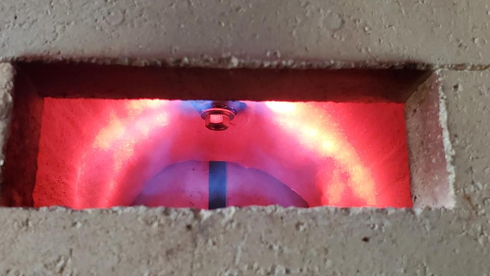

Scale is now at a minimum. Two things have changed:
I started running the forge a little hotter and use the small amount of dragon's breath to tune by. (Plus my steel reheats quicker.)
The second thing (which I stumbled across) I've started leaving the rear of the forge open about 1/4 inch. For some weird reason, the opening helps the whole forge heat much more evenly.

That's good news Lee. Sure the forge heats more evenly with an exhaust port at both ends. The flame behaves the laws of fluidics and having one end blocked means the fame has to swirl around a bit before finding it's way out. If on the other hand it can flow both directions more flame will reach the back end of the forge and more fire means more energy transfer to the liner which means hotter liner and BRIGHTER IR radiation onto the work. At the far end of the forge.

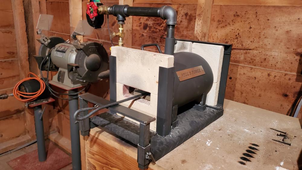

This evening I added an adjustable extending work rest to the forge frame. I think it'll be handy!
To have the rear bricks up against the edge of the forge opening is okay, but a 1" space between the front bricks and the edge of the forge would work out best. However, your forge is fan-blown so, no big hurry to change it over.

I think I've worked out a burner that spreads out the flame to cover a larger area. Even when turned wide open, no cold patches on the floor of the forge like before. This is a first.
That is very good progress; it seems to be heating your forge pretty well.
How far can you move the flame retention nozzle back up into the refractory, without diverting its flames? I think it may last pretty fast, otherwise.
The nozzle is currently even with the refractory. (Other than where it has chipped on the left side.) No part of the nozzle was glowing so hopfully the flow of gasses is sufficient to keep it cool enough.
I can try raising it more next time I fire up the forge.
If it isn't even glowing with your forge at orange-yellow incandescence, you should have no problems with it, after all :)

Seriously though, have you noticed what a nice job his burner does of heating a very wide area, Frosty? Looks like they might make a much easier alternative to ribbon burners for "D" forges. I do like alternatives :)
I would've had to had my eyes closed to see what a beautifully wide foot print the burner has though my imagination was going a different direction.  I was envisioning giving the tubes in the nozzle a little twist and mounting it top center in a vertical cylindrical forge perhaps with a domed roof.

I was initially doubtful about the new design but it seems to work well over the full range of heat possible with my current blower. Up until now, I'd never been able to turn it wide open without getting cold spots from unburned gas. I'm glad the nozzle works because it was honestly kind of a pain to build.
