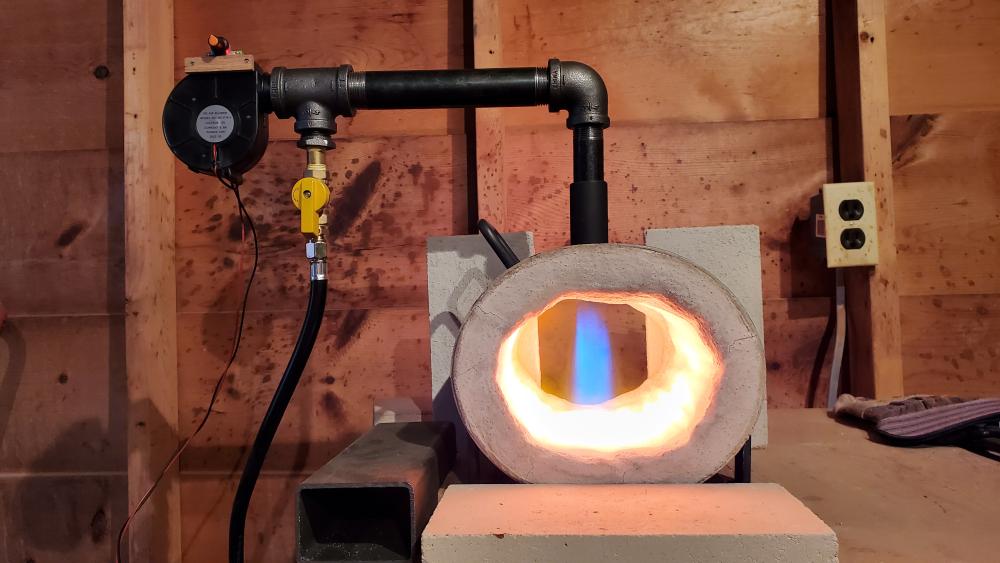

The 100HT seems to have made a bit of difference overall. This weekend a small 12v blower and speed control came in. I'm going to experiment with a blown burner too for this summer. Great thing is all it takes to swap burners is loosening one bolt.
A variable speed burner fan, could solve your problem. Usually I discourage the choice of fan blown burners. However "circumstance alters cases." Just remember that too much air is just as bad as too little :rolleyes:

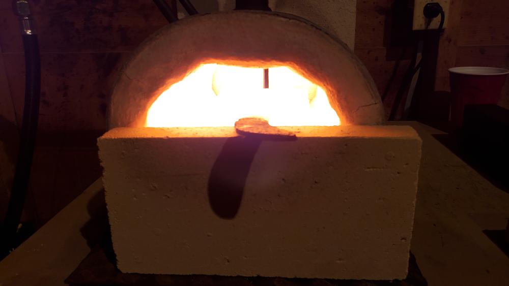

First test run with the mini blower. This thing got hot QUICK!
The second photo shows a very good flame. The third photo shows how hot the forge is getting, without the help of forward and rear baffle plates. However, you would be better off cutting your flame lengths in half, and adding those baffle walls, would allow you to do so, without losing any appreciable heat in the forge :)
How can long flams become a problem? It take sufficient distance for the fuel to combust completely with the oxygen content in the burner's induced air, to prevent some of those super-heated oxygen molecules from combining with alloys on work surfaces, creating scale.
Forward and rear baffle plates? Please explain with a little more detail. I'm interested!
It certainly needs some modifications. Adjustments are way, way overly sensitive. (Worse than tuning a carb.)
Part of that is due to the motor not responding well to being turned way down, and the other part is that I'm only using the regulator to adjust flow of propane. Again, it's very jumpy down as low as I'm running it. I probably need to restrict the outlet some and/or add a needle valve.
...and yes, as you stated, there was scale-a-plenty on the steel until we got it tuned better than what you saw in the third picture.
3/4" T burners I've built tend to run best between 10-18psi and max out about 24, most won't turn down much below 8. NARB on the other hand makes good stable fire stop to stop on the regulator.
Lee: The reason your burner is so sensitive is because it belongs in a larger forge. Imagine how careful you'd need to be on the throttle with a 600hp hemi in a Honda Civic.
The end baffles are Mike's recommended and my seconded thermal baffles. Basically refractory walls not quite closing the ends, a 1" gap to allow exhaust gasses to escape superheat and radiate IR back into the forge chamber. What works well are kiln washed Morgan k-28 IFBs laid on edge I like two on the bottom and one centered on top. The arrangement allows you to separate them to make the size and position the openings you need for the piece you're making.
Frosty, I am indeed realizing that my burner is oversized for the forge. It sure does work well once it's tuned though! -Hahaha
I look forward to building a little larger forge (not too big) with a ribbon burner. I think I enjoy messing with the burner more than I do forging. Guess some of us are just built that way.
Do you think a diffuser of some sort in the end of my burner would help with the long flame? My biggest concern is overly restricting flow of the $10 Amazon blower. I'm not sure how much usable pressure it can produce.

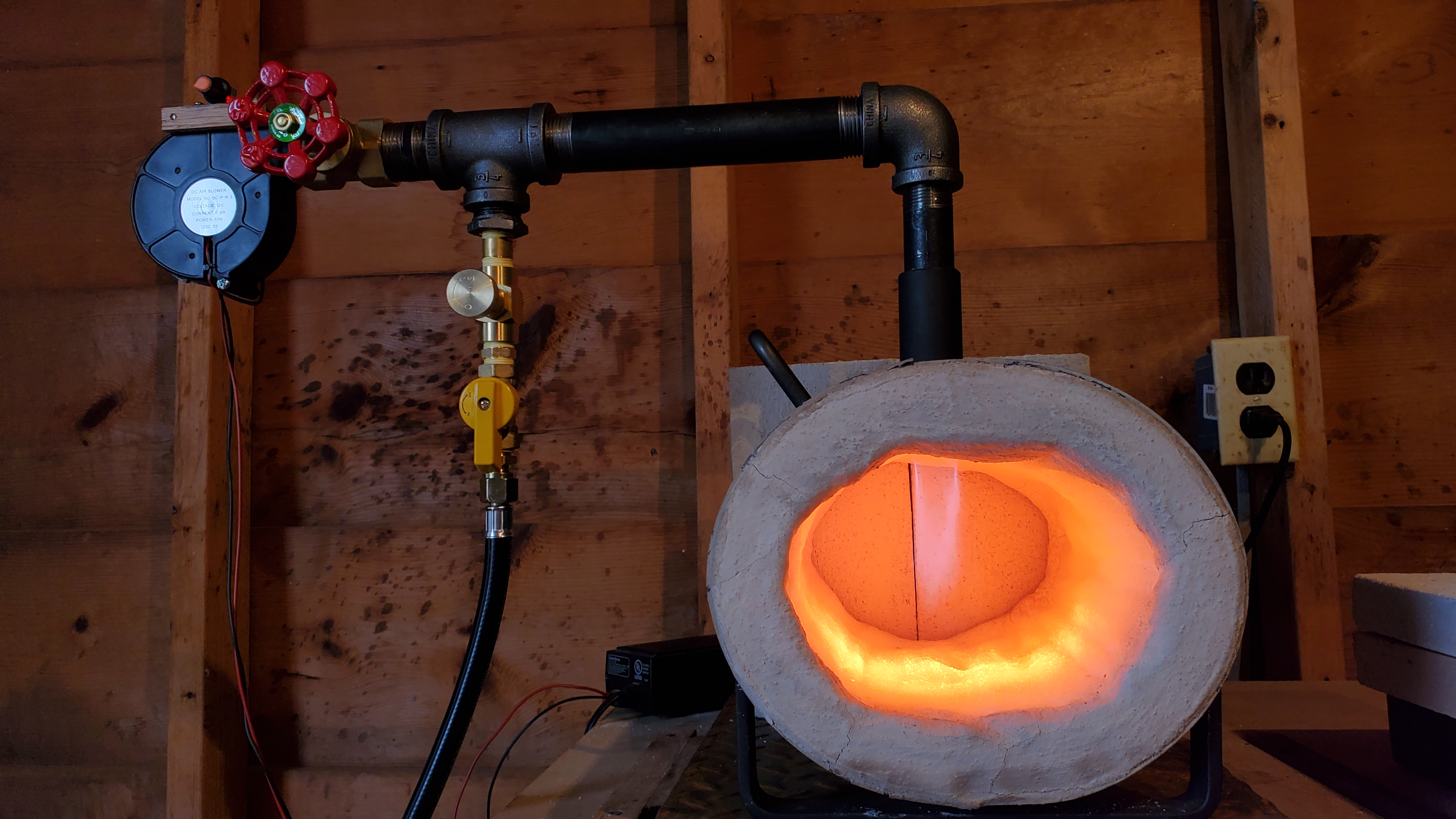

Quick update: I installed a gate valve for air and a needle valve for the propane. The picture is a low-ish flame. I had trouble balancing air/fuel for low heat before adding the valves.
It's going to take a little practice to get the hang of adjustments, but I'm pleased. Thank you Frosty and Mikey for your help!
I don't think we have mentioned yet how much approval your first burner design deserves. The one change that I would bring up has to do with your desire to try a ribbon burner next. Why not try a slightly different version of multi-flame burner nozzle on this burner instead?
Some guys have successfully turned fan blown burners similar to yours into multi flame burner heads, by trapping a flat stainless steel disc, drilled with several small holes in it, at the end of the burner's flame nozzle. I believe that most use the drilled stainless steel disc from a shower head for this, but I think that drilling your own disc from a thicker piece of stainless sheet, will cause your work to last much longer. Just a thought.
Looks much better. Now all you need to do is close this end up some and you'll have a screaming HOT forge.
