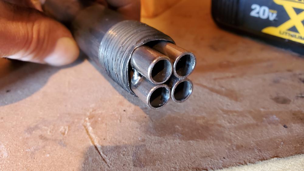

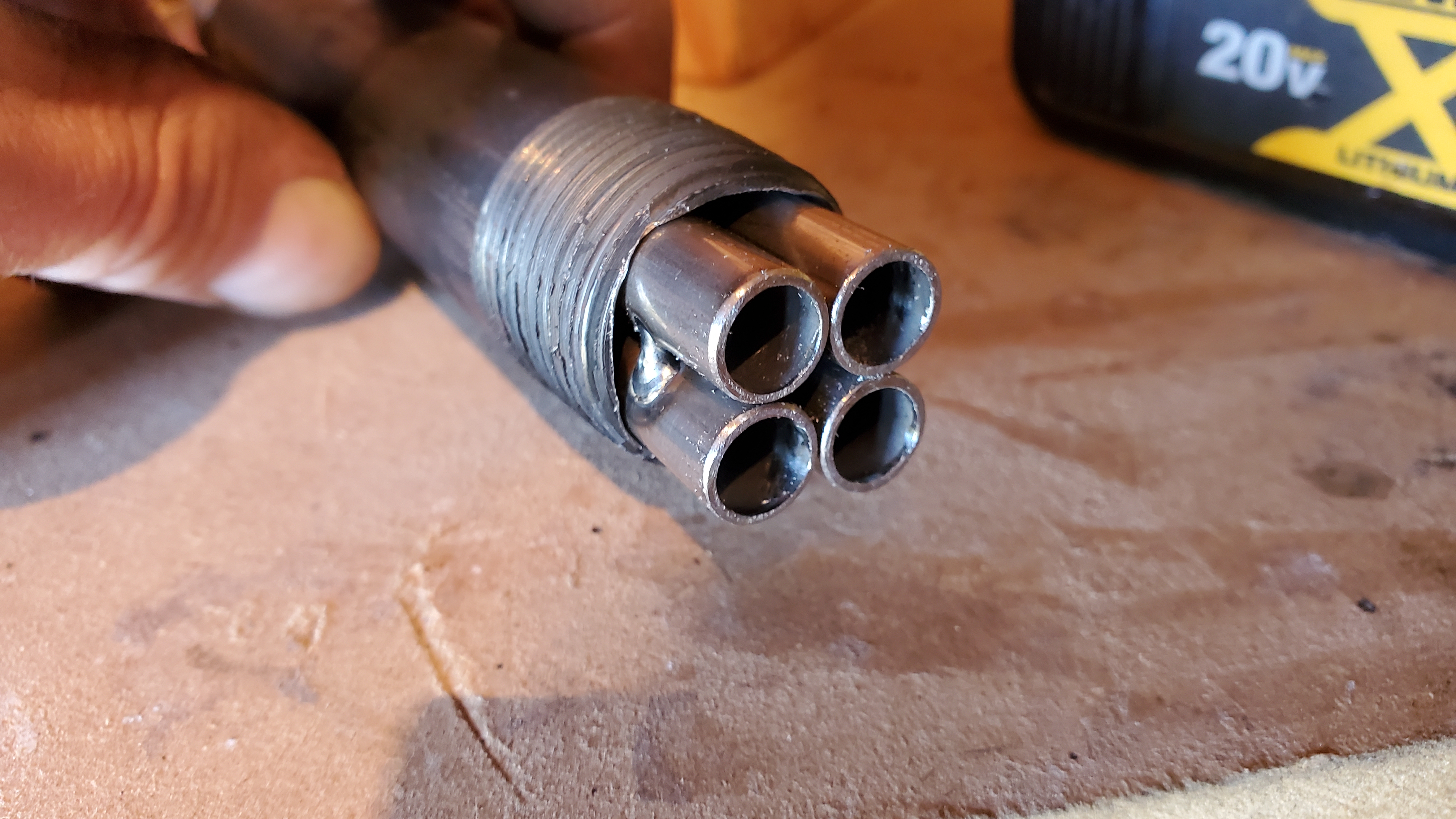

The main run to my burner is 1" black iron. Propane is fed in from a simple tee. The 90⁰ fitting before it goes into the forge is also a reducer for the 3/4" burner tube. The burner tube is 6" long.
The diffuser is made of four 3/8" OD pieces of hydraulic tubing, 1 1/2 inches long. I tack welded in sets of two, then tacked the two sets together.
They didn't fit, so I spent a lot of time with the Dremel. Once I got them to at least start in evenly, I flipped it over onto a chunk of wood and gently persuaded it all the way in with a 3lb sledge.
1/4" OD tubing would probably fit about perfect, but I used what I had on hand.
Im still not 100% happy with stability of the mixture. At times it fluctuates between green and blue. I think my next step will be adding a twisted piece of flat stock inside the 1" line to help agitate the propane and air more.
I can confidently say that this setup would supply two 3/4" burners, without a doubt.

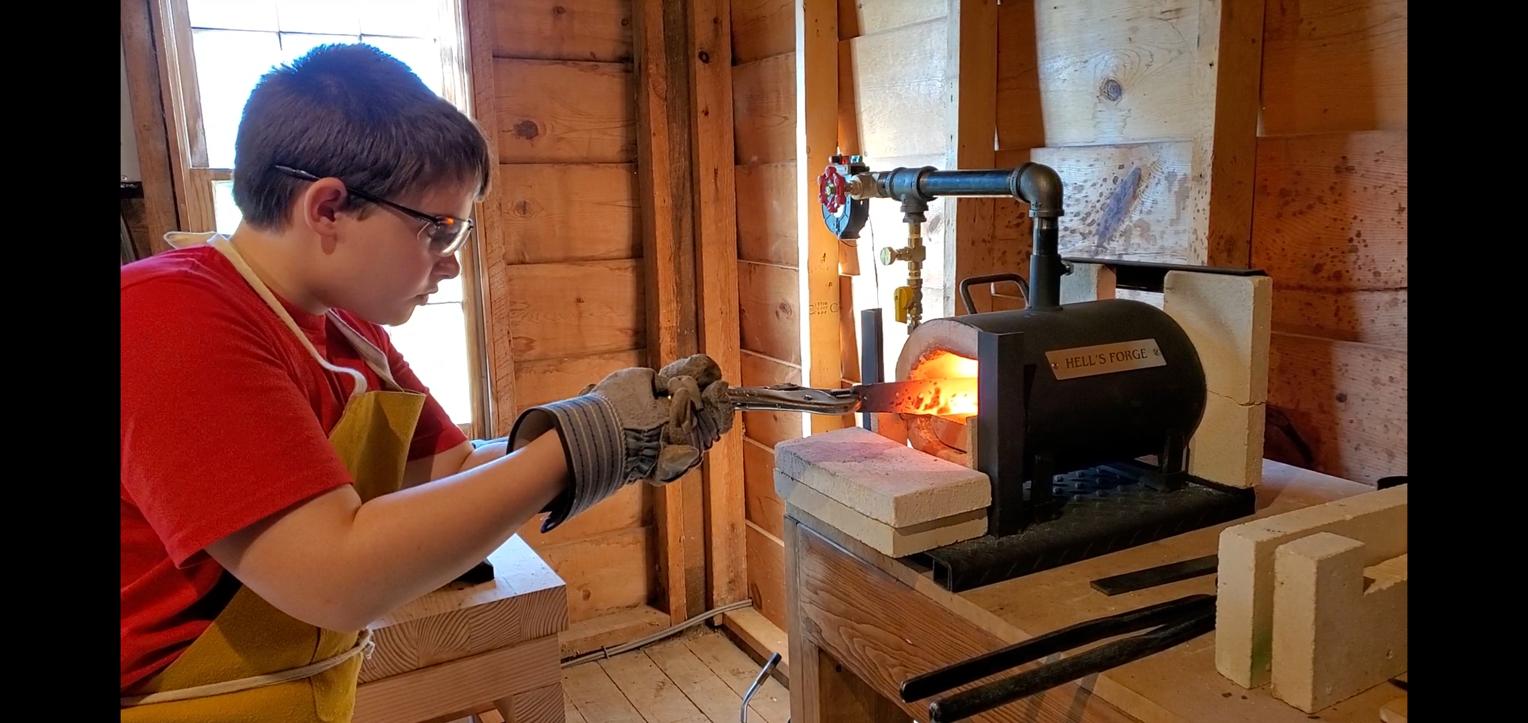

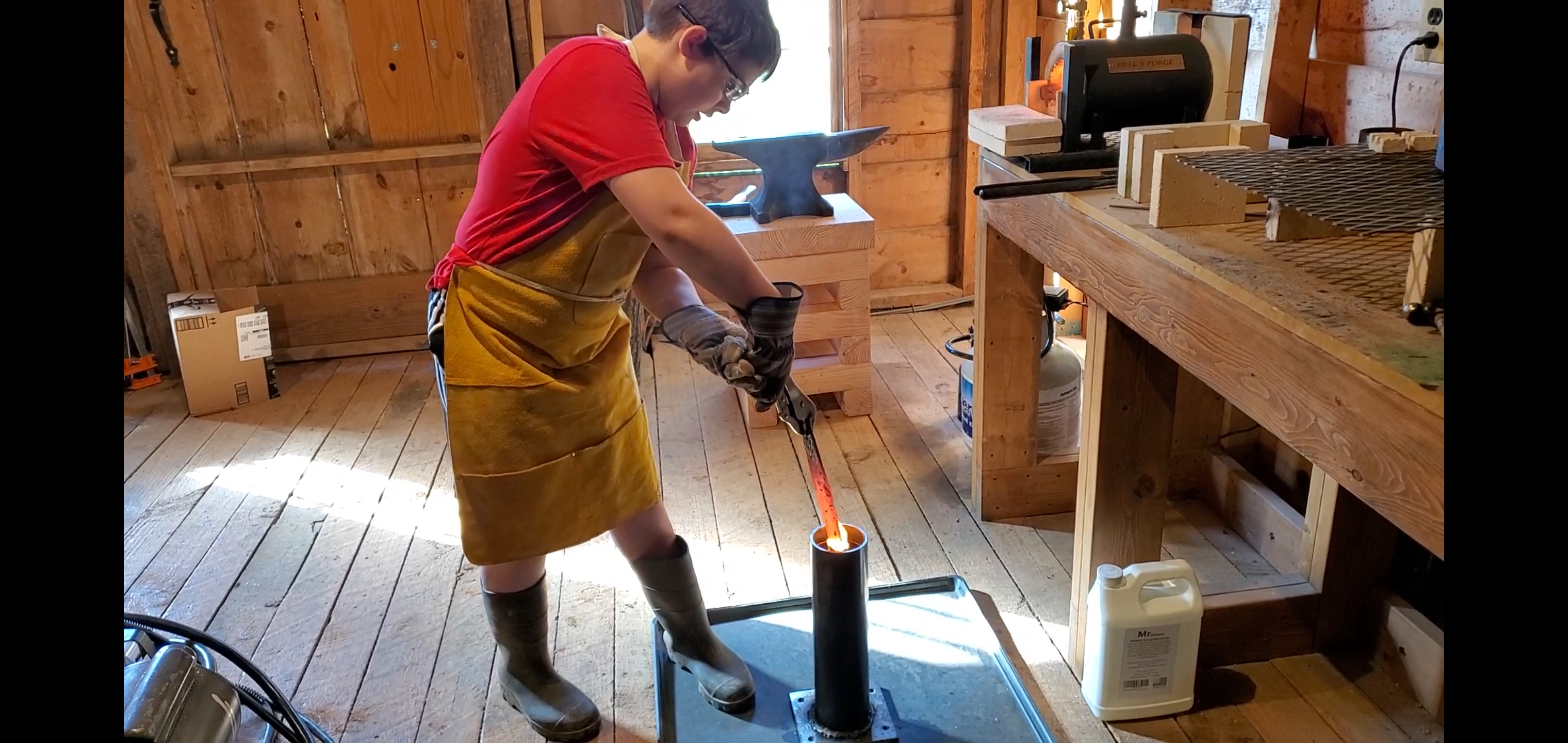

My son just quenched his first knife blade! I hope it turns out ok. It was hard to get it all heated evenly in our small forge.
Dear Lee,
Good for him.  You will be able to do the tempering evenly more easily by watching the oxidation colors.
I do have to comment on PPE though.  Shorts and open top boots are not optimal.  Something hot going down the top of the boot can cause some really bad injuries.  Long pants over the top of open top boots are a much safer combination.  I had a friend who caught a piece of hot metal from a hot cut in the top of his open top boot and had to undergo some serious reconstuctive surgery on his foot and ankle.  And it never was quite right even after surgery and rehab.
Another comment about safety. Quenching in hot oil on a wood floor is inviting a disaster if the quench tube were to turn over. The shallow pan would not contain the burning oil and the fire would spread like wild fire, possibly burning the building down and causing injuries. Our shop has a gravel floor and we always quench outside for safety's sake.
