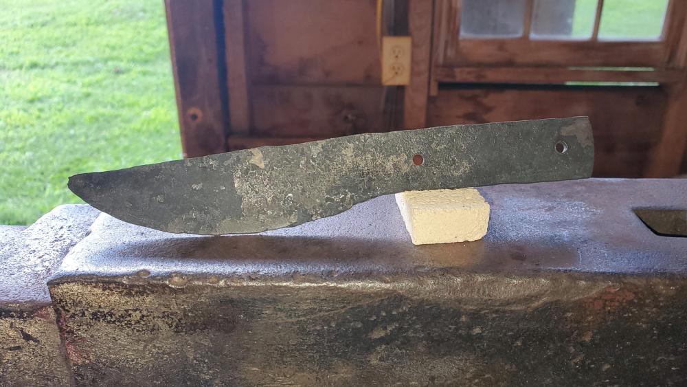

LeeHene Posted August 8, 2023 Author Share Posted August 8, 2023 I completed my first knife this weekend. It was mystery steel from an undisclosed source. The heat treat turned out acceptable, considering. Quote Link to comment Share on other sites More sharing options...

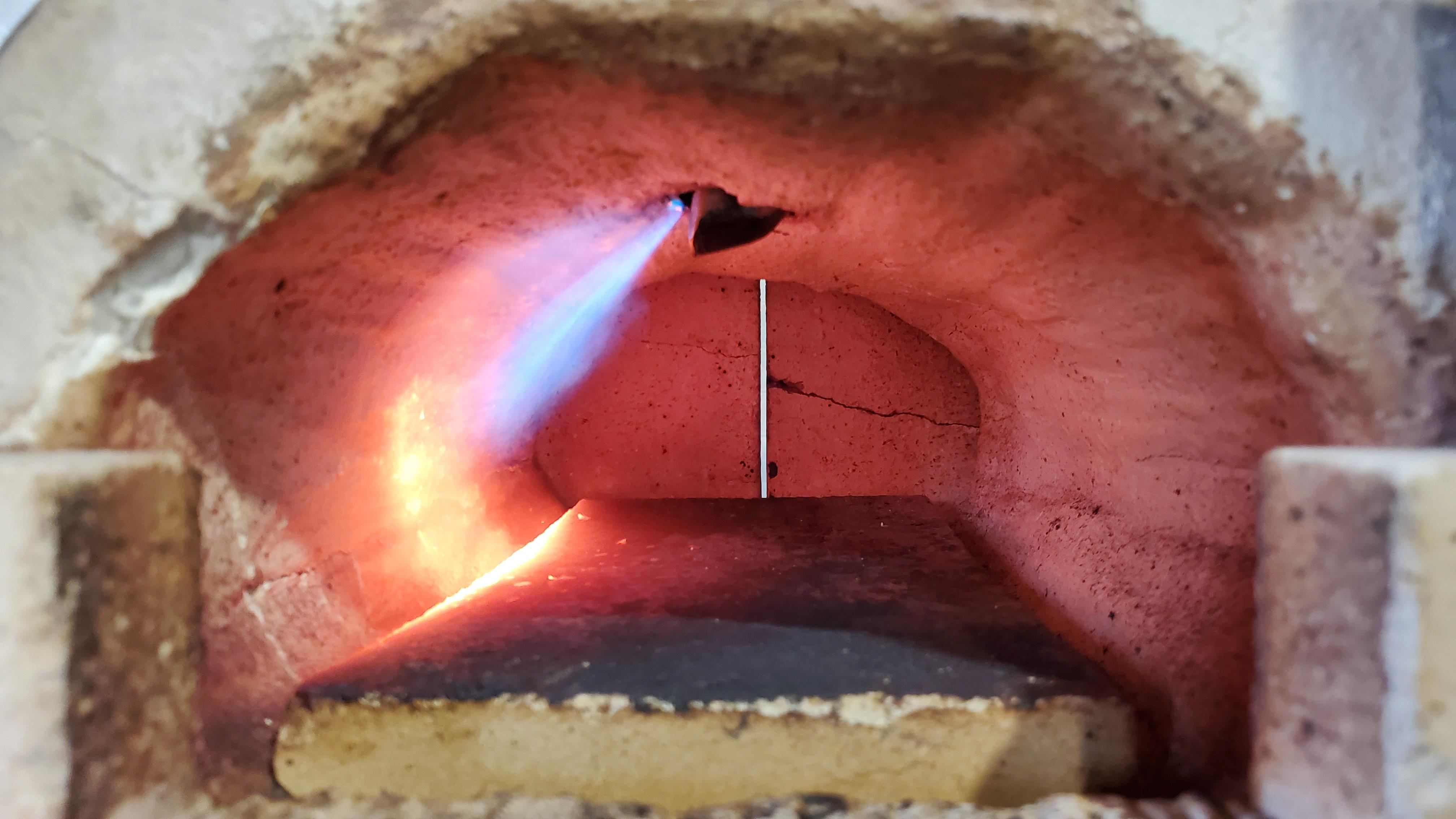

Frosty Posted January 8 Share Posted January 8 I have two main thoughts. but a little background story first. The main point being unless you change the nozzle fuel usage shouldn't change at a given psi. Some burners are more efficient but too often less effective. I'd suspect your flame velocity is high enough superheated combustion products are blowing through your forge instead of hanging out transferring energy to the line so it can work for you. My other thought is the wide open ends venting HOT gasses before they CAN transfer their energy while radiating infra-red to your shop rather than bouncing it around IN the forge where it can work for you. My first experiment would be with baffle walls on the openings. Then maybe repositioning the burner to swirls the flame in more or less one direction in the chamber. I think I mentioned aiming it across the top of the chamber but down at an angle across the floor to produce a swirl works well too. Frosty The Lucky. Quote Link to comment Share on other sites More sharing options...
LeeHene Posted January 9 Author Share Posted January 9 Thanks guys. That last picture was with my previous burner nozzle design that I've been using. (The top brick on the front of the forge was temporarily removed for the picture.) The nozzle works well, but the bit of restriction it adds prevents my small blower from supplying the air needed for forge welding temperature. In a previous design, I had an additional 1" 90 to drop the fan input lower. That hurt output enough that I quickly changed back. The open nozzle I mentioned was requiring that much air and gas to keep the flame out of the burner throat. Recently I also tried a modified nozzle (that, oddly enough, I made with the forge) to kick the flame over to the side. I guess it did ok, but I wasn't impressed enough with it to bother letting the whole forge heat up. It seemed to really be concentrating the heat in one spot far more than my favorite nozzle. Maybe I should give it another whirl. Quote Link to comment Share on other sites More sharing options...
Frosty Posted January 9 Share Posted January 9 Two thoughts. If you can keep the same angle, move the burner to the right. You can see how the burner port in the forge liner is deforming the flame. Second. fill the gap between the firebrick floor and the wall the flame is following so it doesn't get caught in the gap. This will allow the flame a smooth path so it can heat more liner surface and swirl in the chamber more freely. Frosty The Lucky. Quote Link to comment Share on other sites More sharing options...

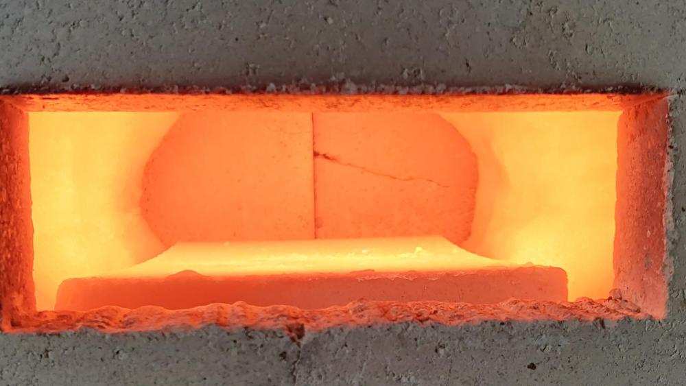

LeeHene Posted February 25 Author Share Posted February 25 Hey guys, its been a while but I only get to sneak into the machine shop at work occasionally. I finally got to complete the latest version of my burner design. I think it might be a keeper! Introducing... The HALO burner! Quote Link to comment Share on other sites More sharing options...
Frosty Posted February 25 Share Posted February 25 Glad to meet the HALO burner Lee. Get any pics of a HOT forge so we can see how it looks? How about a pic of the burner itself, you have my interest. I LOVE new flame shapes. Frosty The Lucky. Quote Link to comment Share on other sites More sharing options...
LeeHene Posted February 25 Author Share Posted February 25 It's hard to get a good picture of what my eye actually sees. The ceiling and walls heat first and it slowly travels down to the floor and then closes in toward the middle. It's hard to get a good picture of what my eye actually sees. The ceiling and walls heat first and it slowly travels down to the floor and then closes in toward the middle. Sorry for the double text above. This forum editor is kinda screwy sometimes. Anyway, below is my burner insert. I made the mistake of poking it and it fell out. (This started as a test fit anyway.) Apparently it stayed cool enough to prevent discoloration on all but the bottom face. Quote Link to comment Share on other sites More sharing options...

LeeHene Posted February 25 Author Share Posted February 25 Thank you! I never can leave anything well enough alone. Last night I fired it up briefly but haven't had the opportunity to heat any steel. I hope the new burner will help reduce scaling caused by direct contact with the flame. That said, I might miss having a hot spot handy. I need to look into a better blower design. I've been using the same 12VDC blower for over a year. I do like using a smaller one but I wish it would maintain a bit higher static pressure. (Plus it vibrates a good bit.) Quote Link to comment Share on other sites More sharing options...
