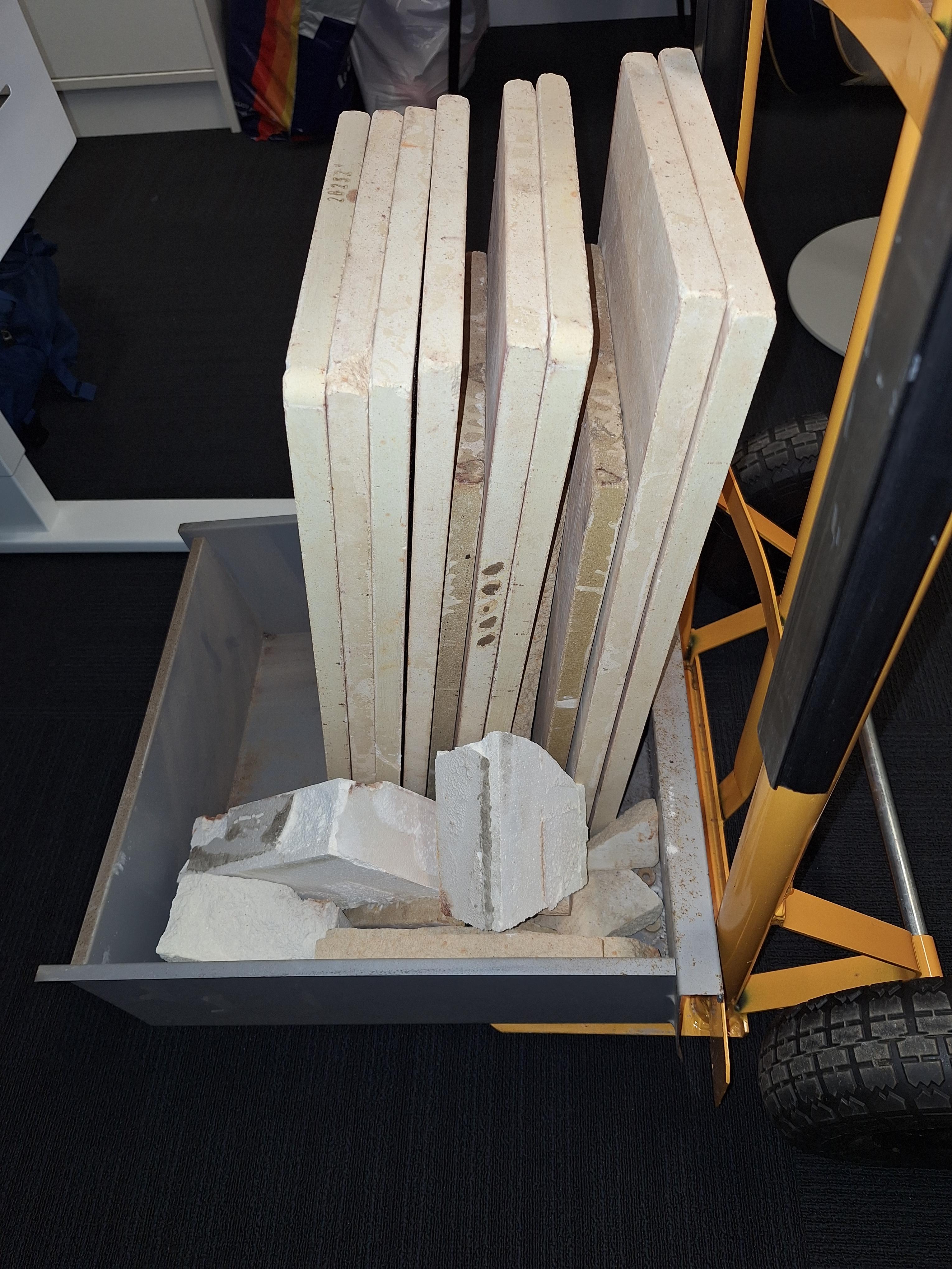

Our school has recently opened a new building and the Art department have moved. They got a new pottery kiln as part of the new fit out because the old one was rusting to pieces. It has all the shelves and other accessories they need, so the old spares were going to be dumped:
Almost a dozen intact kiln shelves (19mm thick x 25cm x 55cm, or 3/4" x 10" x 22") and several large but broken pieces, a few pieces of kiln washed ISB and a nice metal drawer that will become my new, more compact JABOD!
Not to mention, I will also soon have a set of map drawers from them that are surplus to their requirements in the new digs!
One very happy smith here!
