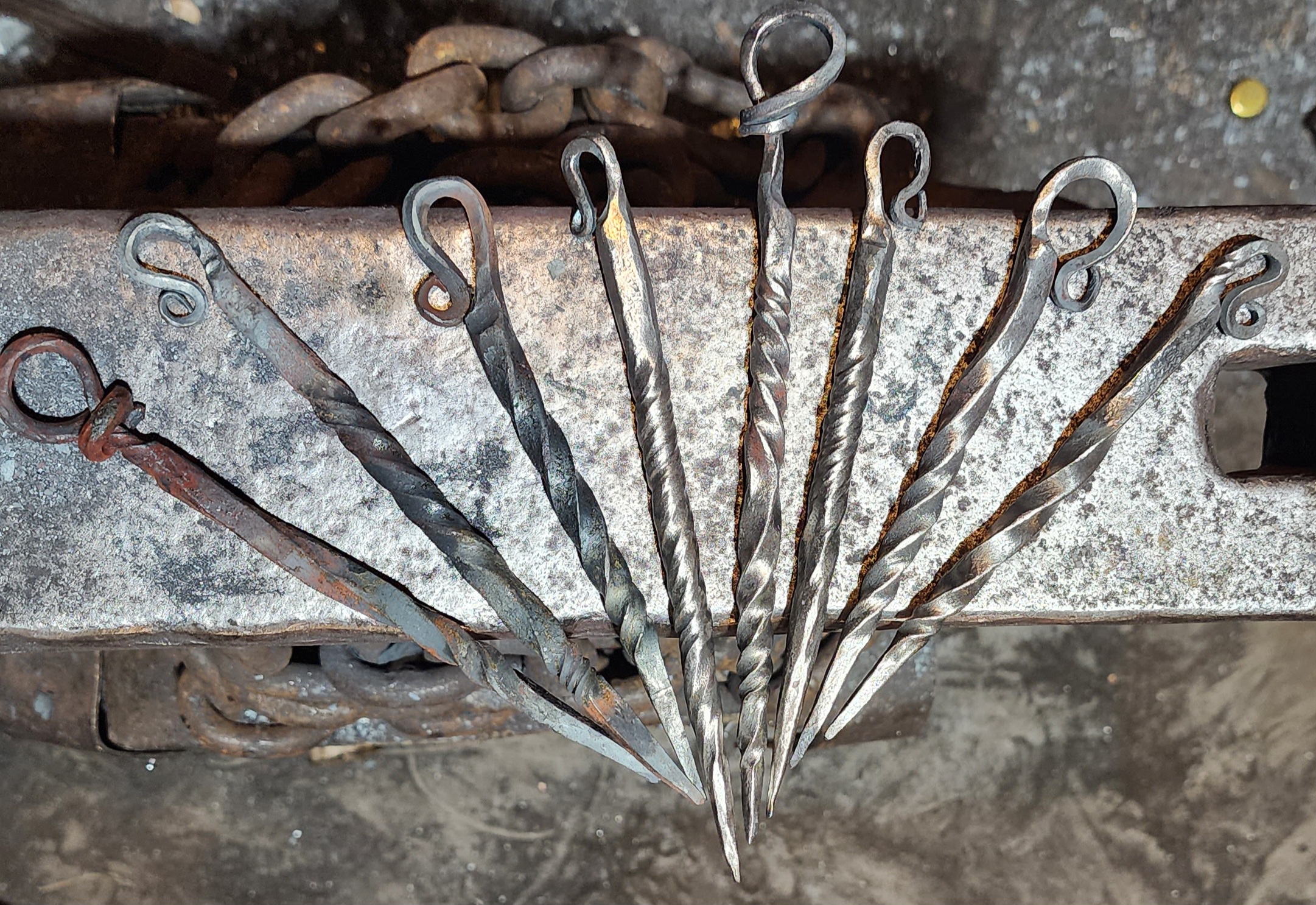

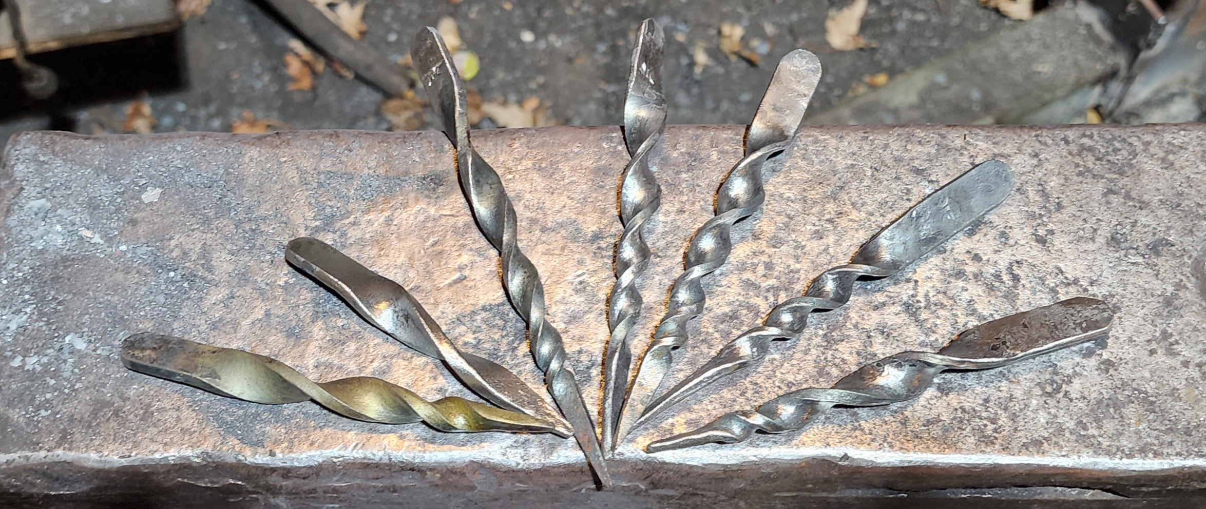

Chad J. Posted November 29, 2022 Share Posted November 29, 2022 Making icicle style hanger for Christmas trees. The flat twists were actually really good for practicing tapers on thin stock. I had my new apprentice(?) Starting on these and she learned fairly quickly. I knocked out about 35 total between the two styles, just need to drill holes and add ribbon to hang them. I'm thinking of just clear coating them. Quote Link to comment Share on other sites More sharing options...
Daswulf Posted November 29, 2022 Share Posted November 29, 2022 Nice icicles Chad. Clearcoat would work fine with them shined up. I have made a few ornaments that turned out darker and end up blending into the tree. I try to either polish up and clearcoat or paint them now. With all the lights and other flashy stuff on the tree the forged metal color gets lost. Hefty, if you get the time to practice with it you should be fine. There are many good instructional videos online to check out. I just never tend to have the time. Quote Link to comment Share on other sites More sharing options...
Shainarue Posted November 29, 2022 Share Posted November 29, 2022 In regards to forged color getting lost in the tree - I wonder if you brushed it with a brass bristle brush while hot - or heat tempered to the iridescent colors - if that would help it stand out without painting? Quote Link to comment Share on other sites More sharing options...
Chad J. Posted November 29, 2022 Share Posted November 29, 2022 The top picture, left side that one I did hit it with a brass brush. It was still only a subtle change. Quote Link to comment Share on other sites More sharing options...
Les L Posted November 29, 2022 Share Posted November 29, 2022 Chad, that's a nice job on the icicles. The one you brass brushed may not have been hot enough when you started brushing. You should be able to get a nice bright brass color. Make sure you don't have a brass coated steel brush. Quote Link to comment Share on other sites More sharing options...
Daswulf Posted November 29, 2022 Share Posted November 29, 2022 Looks pretty brassy to me. If you have enough to play around paint one white and just clear coat the brassed one and another and see which you like more. You can never truely know what the consumer will prefer. Do them how you like them. And if you get a commission for one different you can accommodate that if you want to. Quote Link to comment Share on other sites More sharing options...
Frosty Posted November 29, 2022 Share Posted November 29, 2022 Chad: The brass finish will show better if you don't lay it on a shiny steel surface to photograph. If you REALLY want a brass effect, bring the work to brazing temp, give it a touch of fluxed brazing rod and wipe it to even it out. A clean piece of cotton canvas or old jeans is what we used in metal shop. With practice you can lay braze smoothly without a wipe. Then if you were to file or sand the edges of the twists for contrast. Hmmm? Frosty The Lucky. Quote Link to comment Share on other sites More sharing options...

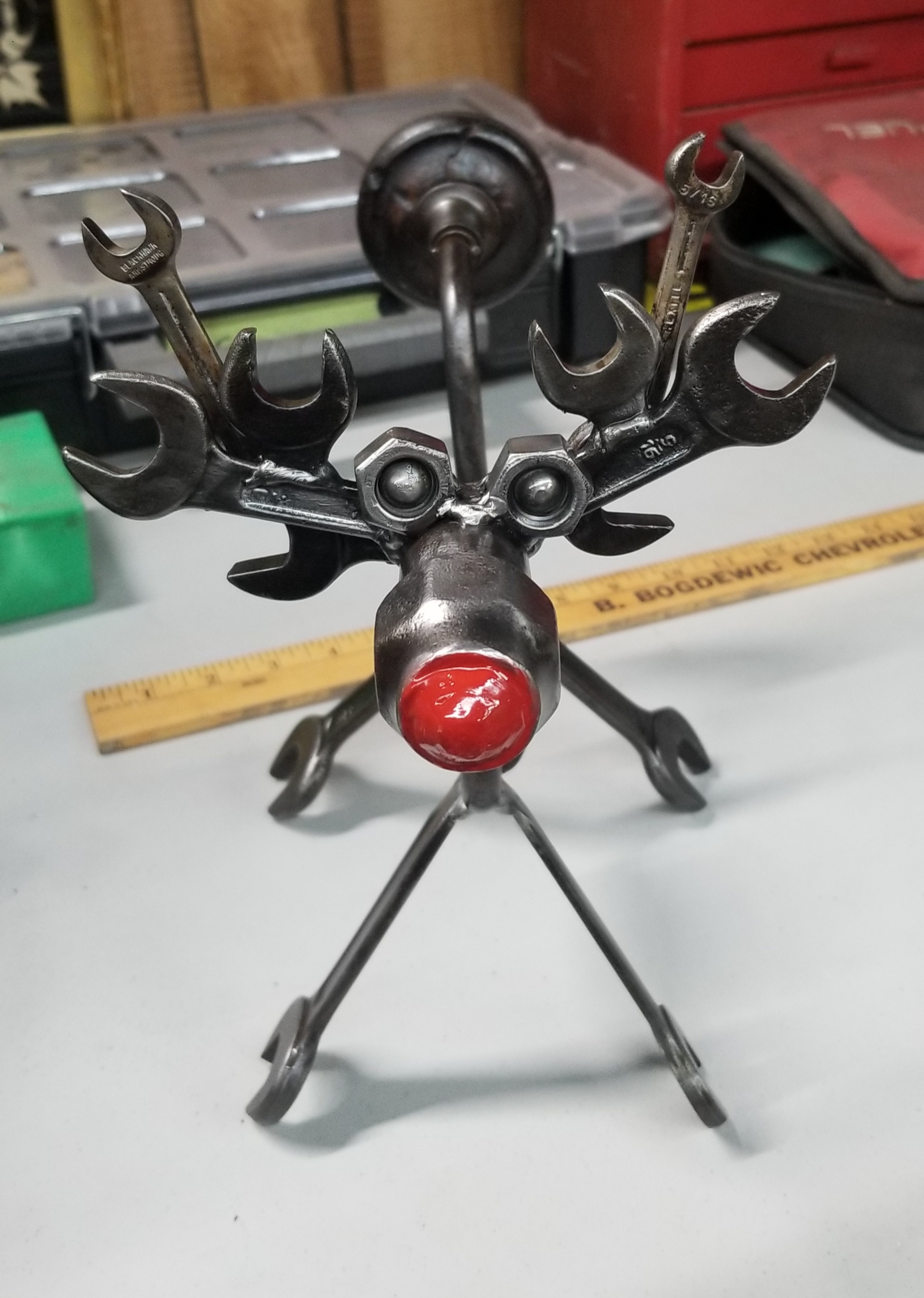

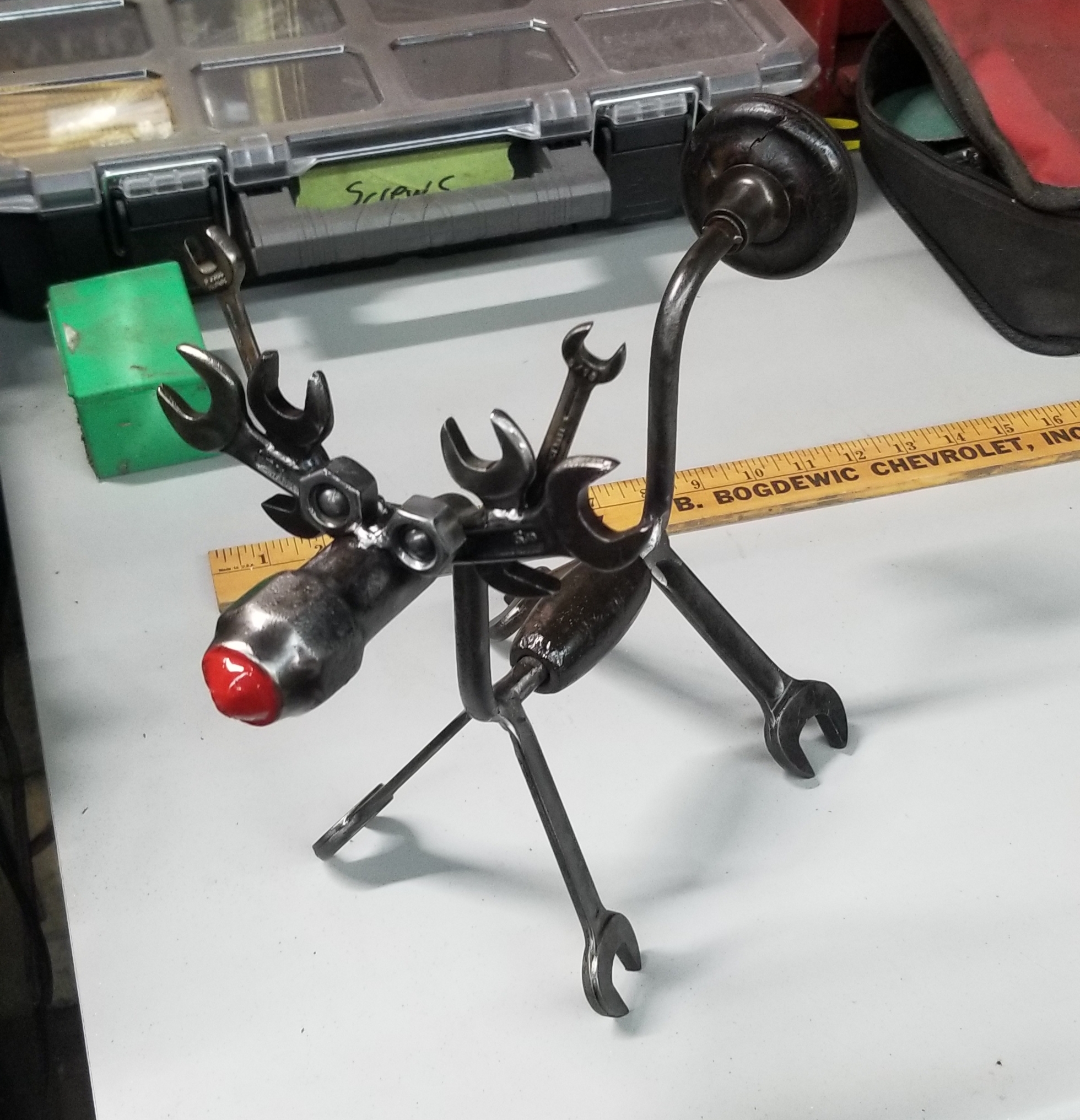

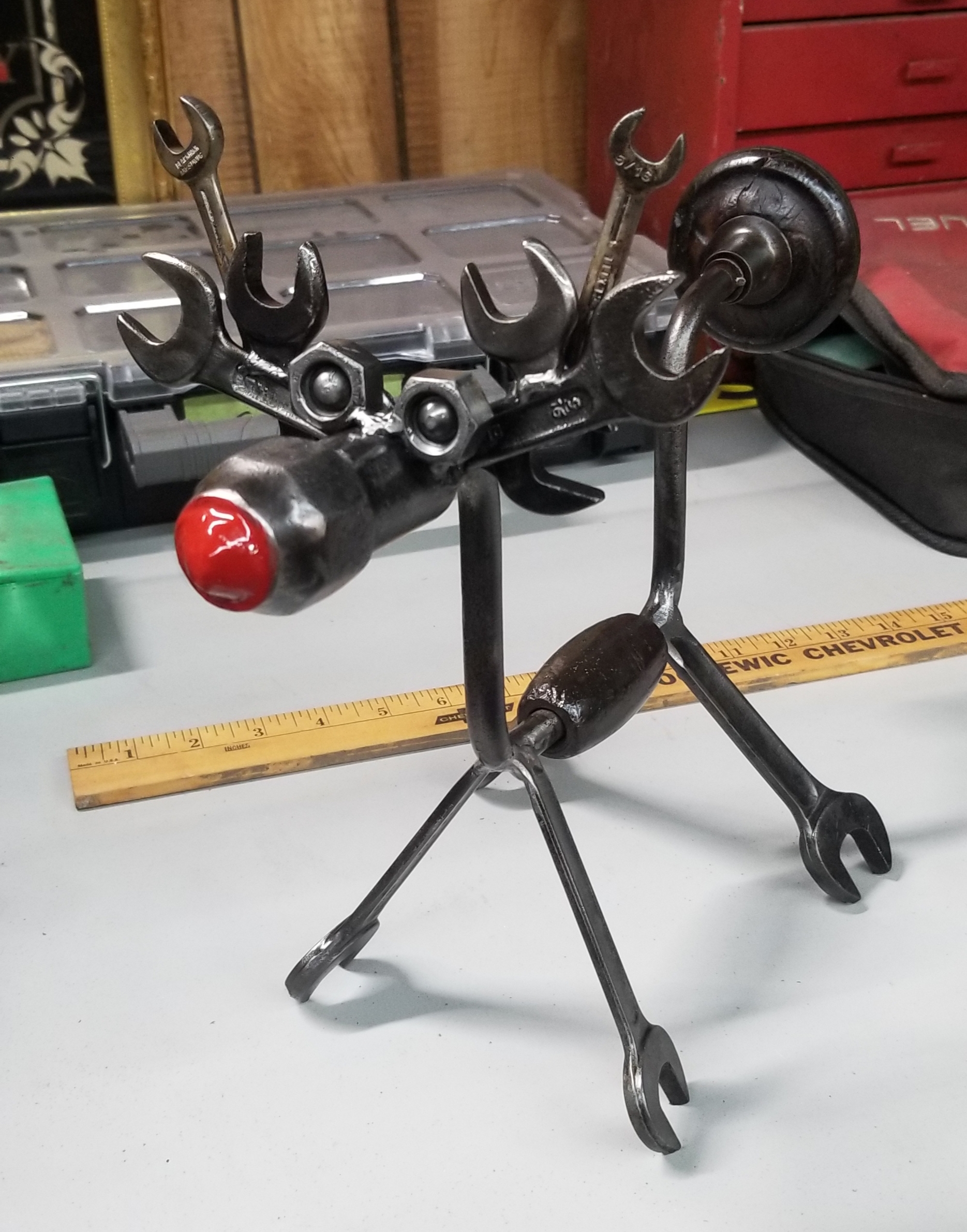

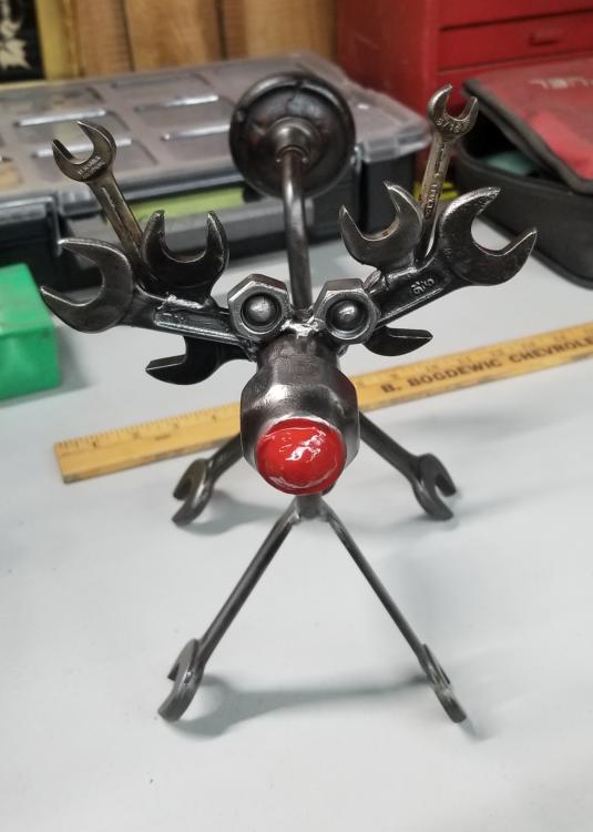

Daswulf Posted November 30, 2022 Share Posted November 30, 2022 Saw this guy someone had made and just Had to make one. I have a bunch of old hand braces some junk and some good. This was a junk one. Hope the photos do it some justice. Little Rudolph is cute. Quote Link to comment Share on other sites More sharing options...
Shainarue Posted November 30, 2022 Share Posted November 30, 2022 Love it! Quote Link to comment Share on other sites More sharing options...
Scott NC Posted November 30, 2022 Share Posted November 30, 2022 Rudolph put a smile right on my face. Nice photos. Chad J, I love your icicles. Quote Link to comment Share on other sites More sharing options...
Daswulf Posted November 30, 2022 Share Posted November 30, 2022 Glad to make you smile. I was smiling making it. Picked out some parts last night in planning to make him. Shainaru, Thank you! Quote Link to comment Share on other sites More sharing options...
Scott NC Posted November 30, 2022 Share Posted November 30, 2022 "I was smiling making it. Picked out some parts last night in planning to make him." That's what I like. Speaking for myself, I go off into my own little creative world and all other thoughts and worries just fizzle away into nothingness..... Quote Link to comment Share on other sites More sharing options...
Daswulf Posted November 30, 2022 Share Posted November 30, 2022 Just like forging something, you get into the zone and forget everything else for a little while. I was happy to find very similar unplated wrenches in my bin. I still have a big pile in the bin but the smaller ones are getting tough to locate. I'll have to do some fleamarketing this spring. And reorganize my bin so the small ones aren't on the bottom. On another side note, I had babbit material melt out from behind the wood handle when I welded on the legs. It was on its side on the welding table when it happened so it just poured onto the metal table and not on me. Quote Link to comment Share on other sites More sharing options...

Frosty Posted November 30, 2022 Share Posted November 30, 2022 Cool Rudolf, Das. The first pic had me going for a while, I kept trying to figure out where the ret of the regulator went, then I scrolled down and had my head slapping moment. I haven't been impressed with what passes for restores here and tools at 2nd hand or pawn shops are near new prices, flea markets seem to be to save people from making dump runs. Yard, garage, etc. sales are the best hunting grounds around here. I really miss swap meets an flea markets in the lower 48. <sigh> Frosty The Lucky. Quote Link to comment Share on other sites More sharing options...

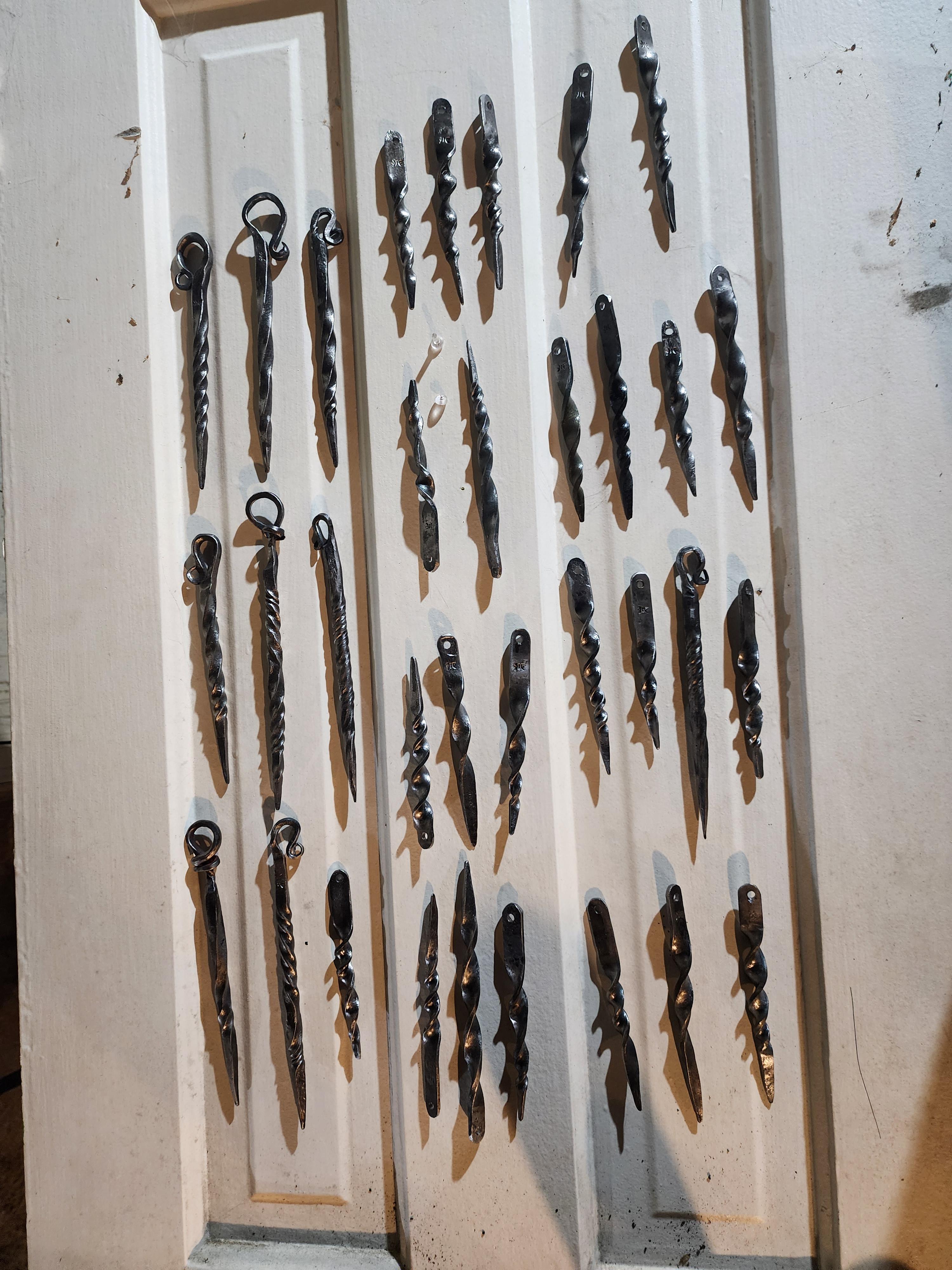

Chad J. Posted November 30, 2022 Share Posted November 30, 2022 I, uhhh, may have made a few. Quote Link to comment Share on other sites More sharing options...
