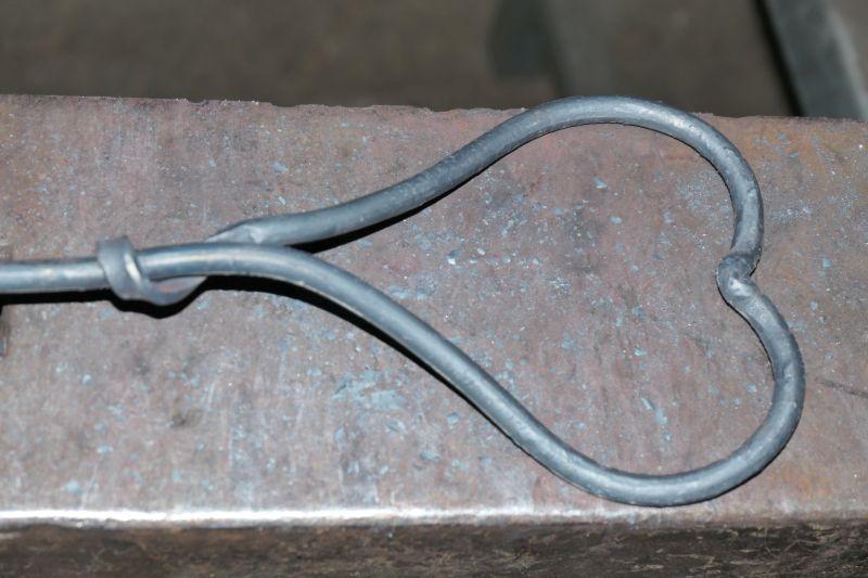

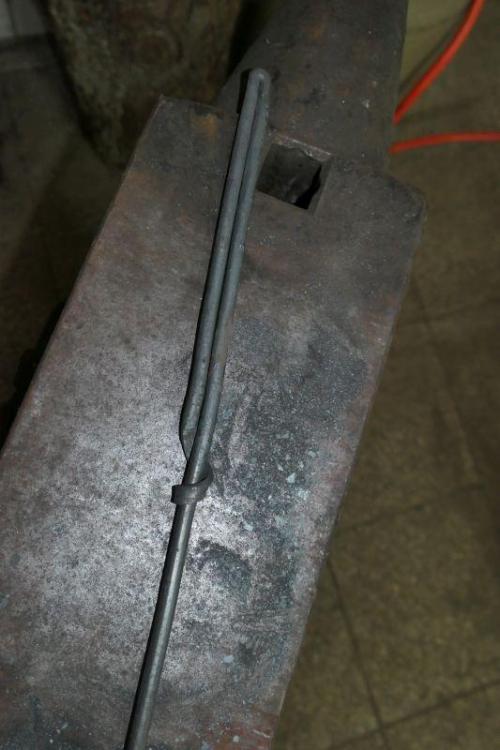

Daswulf Posted May 7, 2022 Share Posted May 7, 2022 Nice pictorial wicon. How do you finish it? Cut it off? What next? I can picture some fun variants of the design. It looks like a good quick demo with a product they can walk away with to proudly give their mothers or loved ones. Link to comment Share on other sites More sharing options...

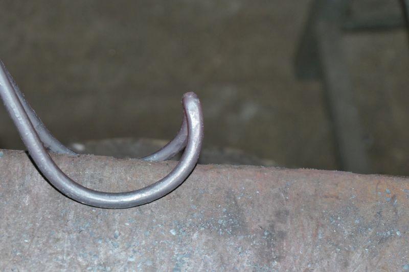

wicon Posted May 7, 2022 Author Share Posted May 7, 2022 We make a short square tip so they can be pushed into a flowerpot. The stem about 30 cm long. (Sometimes i tell the child now it can hammer it into the livingroom cabinet - makes it's parents looking funny . GRIN) The smallest heart I forged was made of 2mm round for a mini cactus, the biggest one of 2,5m by15mm round. That one was in a set of 5 different forged hearts. Link to comment Share on other sites More sharing options...

wicon Posted May 9, 2022 Author Share Posted May 9, 2022 Tip for demos: Don' tell the spectators what you are forging. Let them guess. Interesting how few people can imagine what you are forging until you fold it open. And many stay - at least until it's ready. Willy Link to comment Share on other sites More sharing options...

wicon Posted May 11, 2022 Author Share Posted May 11, 2022 I seldom teach forging. Mostly I forge on events like school or city festivals, christmas markets and so on. So I see my "customers" only 15 to 30 minutes. To make shure that everything stays safe, I handle the steel and the child works like a striker would do - Whomp - tink - whomp - tink... Except when only light blows are needed like bending the heart open. p.s.: Tink --- (Usually) the father: "Hit harder!" --- Twank - missed. I tell the child: "Don't strike so hard. You will miss. You are simply to young make heavy blows and hit the steel. Get 12 to 16 years old and you will hit ard and not miss. Willy Link to comment Share on other sites More sharing options...

Frosty Posted December 4, 2022 Share Posted December 4, 2022 Nice heart! I'm thinking if I let the end of the taper widen a bit and incise it lightly, when I bend the scrolled end around I can fit the spread taper to look like a hand holding the scroll. Now I just saw the "hand" rotated 90* and with an open center above he scroll with the leather thong threaded through both so the hand was "holding" on. This got my piece juices flowing, these'll make nice Christmas stocking stuffers and Valentine's day isn't that far off. Thanks. Frosty The Lucky. Link to comment Share on other sites More sharing options...
