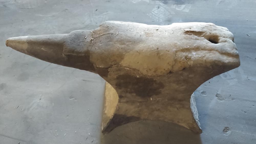

Hello everyone! I'm trying to get started in blacksmithing and inherited an anvil from my grandfather. However, the face of the anvil is heavily mushroomed and partially cracked on one side. My question is simple, is this repairable? I do not have welding skills but I do have grinders to resurface it. If it is repairable what steps would you recommend?

Yes it is repairable with the Gunther/Schuler method followed *EXACTLY*  which unfortunately  requires a lot of skilled welding.  I'd suggest finding an ABANA Affiliate that's having an anvil repair day; except that I have no idea if you are even in the USA where ABANA is! The hardened steel face is quite thin on an anvil; grinding on it would be like my wife saying her diamond ring is dirty and having me take it to the shop to grind 1/8" off it to clean it up!
Going forward I would source an improvised anvil and get to smithing and save that one for it's horn and hardy hole and perhaps to find someone to repair it in the future---I've seen a large number of anvils damaged worse because they were "repaired" by people who might have been excellent welders but knew squat about anvils and how they were constructed!
Note if you use your browser to search on:    anvil repair site:iforgeiron.com     over 1700 specific hits show up and go into it in great depth.
Normally when people are asking about repairing an anvil it is in usable shape and trying to "repair" or grind on it would do more damage than just using it as is. This old one Is pretty beat. Not to say it couldn't be used as is.
Just grinding won't help. These anvils have a wroughtiron body with just a steel faceplate, which in your anvils case is heavily mushroomed and even delaminating. So grinding it down will only remove what's left of the steel and leave you with wroughtiron which will just continue to mushroom as you forge on it.

There's nothing to say you couldn't make a stand for that anvil and forge on it. Just be aware where the delaminating area is and where the faceplate is gone and avoid those areas.

While it can be repaired if done correctly it might cost as much as a new anvil. Personally I'd hate to see that old workhorse repaired, it deserves a place on display, maybe a museum. That's me though.

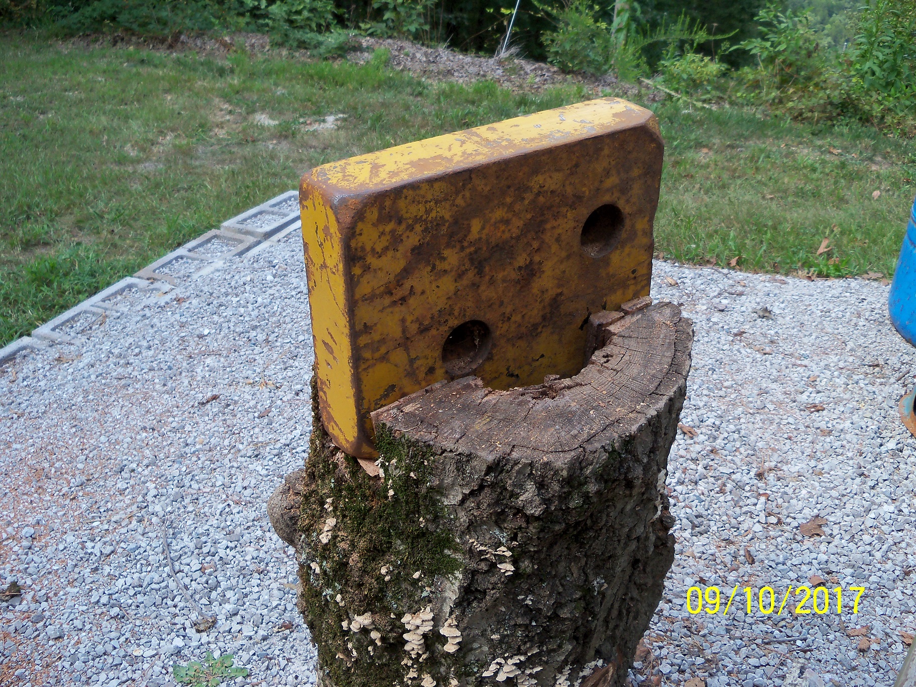

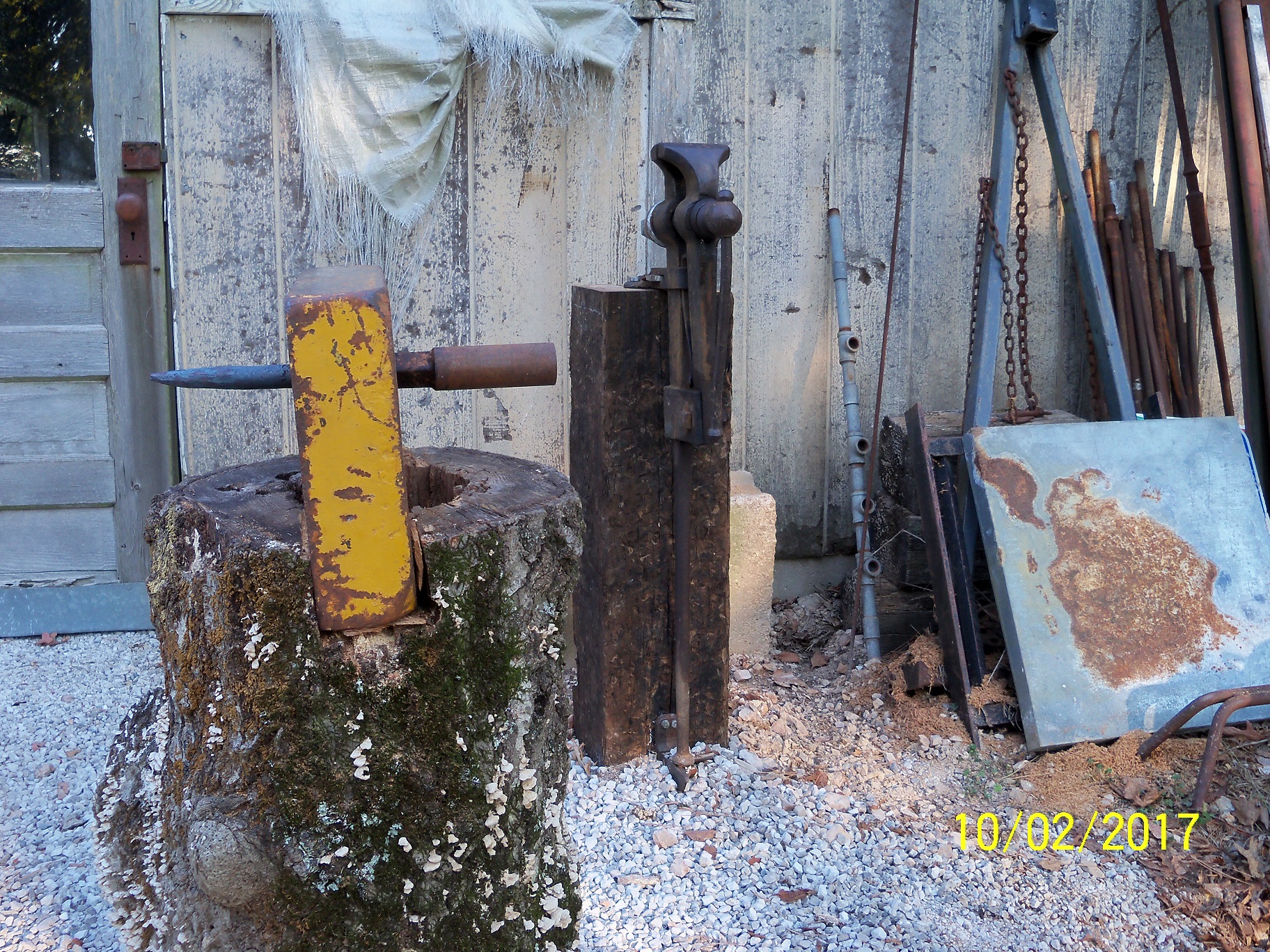

Here is a primer for improvised anvils. We paid $35 for it at a club meeting and it weighs 110 pounds. If you have a scrap yard or heavy equipment repair shop near you, bulldozers are made of anvils. I think this was a counter weight off of one. Like others have said you could use the horn and hardy hole from yours and cherish it as a family heirloom.
BTW: Welcome to the insanity.:)
That one the holes are round all the way through but it wasn't hard to make a bick for it though. I put several weld beads on the sucker rod and drove it in for a very tight fit which works very well for light work. Of course we have three London pattern anvils, so a full size horn and Hardy holes are no problem.
Those holes are called runner or blade bolt holes. Runner bolts lay flush with the surface, the square section allows a nut to be from the back side. Finding them with 1" square sockets would make a sweet hardy hole. Good score Thomas, must be nice to know an insider at the scrap yard. Or be a TPAAAT master. ;)
tmarkley:  I'd keep it as is and use it as a horn and as a hardie base.  You can use a file to dress up the hardie hole to accept standard size hardie tools.  If I were you I would occasionally hit some small hot metal on it to honor all the work it did for your grandfather and all the work he did on it.  As suggested I'd get an improvised anvil such as a piece of RR rail mounted vertically or something like the illustrated bulldozer weight and then start hitting iron.  Keep the old timer in your shop as a conversation piece and maybe hang a picture of your grandfather over it.
