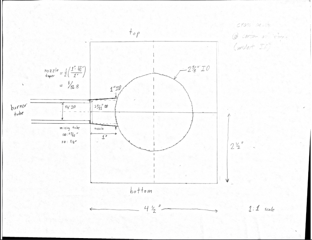

In more exciting news! The bricks arrived today, and I've started drawing my plans for the interior and nozzle. Here's a sketch of a cutaway view at the dead center, where the inner diameter is widest (2-3/8"). To clarify, the inner diameter will taper down to 2-1/8" at the ends of the 9" length, per Tristan's instructions.
I know some of the handwriting isn't easy to read so here's some of the major points. The end of the burner tube will rest flush with the wall of the firebrick. (That means this forge will absolutely need an external mount for the burner). The nozzle tapers from 27/32" (the OD of the mixer tube) to 1" over 1" length. That gives a rise/run of 1/12.8. I settled for that because the dimensions are easy to hit. Make the smallest ID just big enough for the tube to fit inside, and the largest ID 1" flat. I'm going to cut a wooden trapezoid to use as a go-no-go gauge.
This arrangement will help the burner to last well. But, the firebrick won't, unless you coat it with something to keep the flame from attacking it! Aside from this, your design looks very sensible. I look forward to seeing it in action.

Alrighty, shaped the interior tonight and added horizontal threaded rod to the frame. Doing the interior was a lot easier than I thought it would be. I used a 2" hole saw (all I had on hand). I took "bites" with the hole saw, then switched to a 1/2" bit and drill holes into the remaining cylinder to weaken it, then used a screwdriver to break it apart. I had to chase the hole from the other end of the bricks to get it all the way through, so make sure to center the hole saw pilot bit.
To make the burner flare, I started with a 3/4" drill bit, and filed it with a rat-tail file until I could fit the burner tube inside. Then I got myself a 3/4" socket with a 1" OD for a gauge. I filed a flare into the hole until I could fit the OD of the socket in the end of the flare (see pictures).
IMG_20210116_173716.jpg.962d7b795abe1d85bcb8b33bc3cc07be.jpgIMG_20210116_173708.jpg.c00cde2c035978f73562389172776eed.jpg
Then I scraped out a taper to make the center of the forge have 1/4" wider walls (added a 1/2" to the ID), per Tristan's advice. I did this with dull woodworking chisels.
I didn't scoop much out of the burner side so I wouldn't mess up the nozzle. Now the center has an ID of 2-1/2" and the openings have 2" IDs. The taper now runs a little flat because I didn't scoop out that side. I need to do a little more tweaking there.
Here's the mock-up assembly:
(there's just enough length on the horizontal rods to thread a nut on either side, I almost messed that up)
And lastly I figured out a way to mount the burner with what I have lying around. I have some 18ga stainless sheet I can cut into pieces the size of the forge's outer dimensions, and pop rivet them to the angle iron. I have a flange I can pip rivet to the sheet. I just need to wait until I can throw sparks again. Unless anyone knows a way to cut 18ga SS without a grinder or access to a brake?
