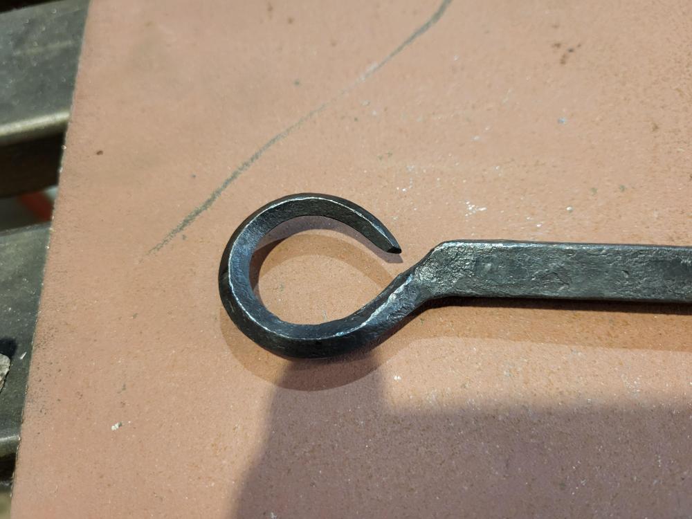

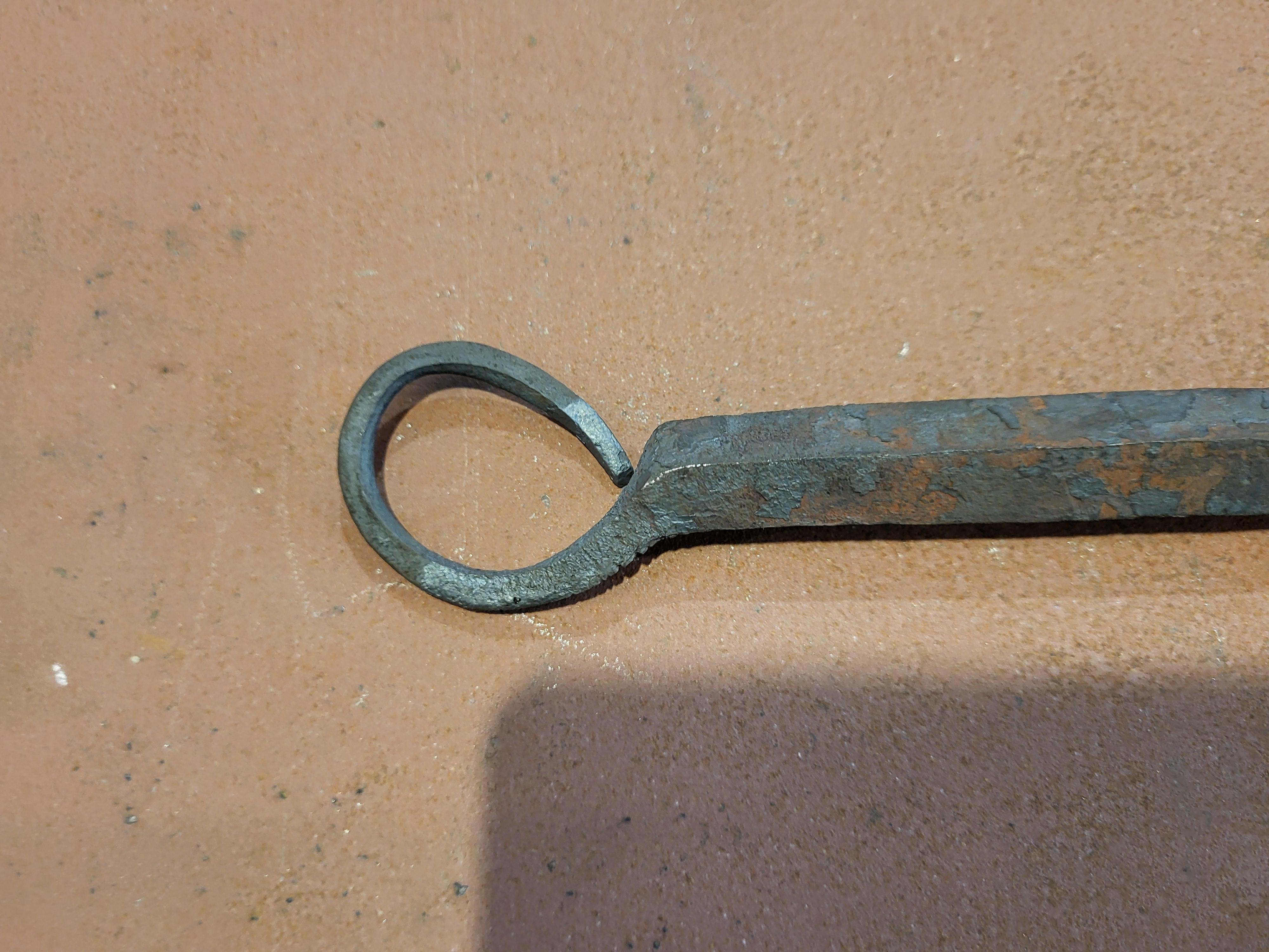

I've been doing a little more research on this. The original picture I saw must have been in my Facebook feed because I did a search for "hand forged carabiner clip" and found the same, or similar, image on Etsy.
It looks to me like a suitable curve for the hook section, to allow the wire clip to fit and work, should be a section of a Fibonacci, or golden, curve. Mine are currently too semi-circular with parallels either side. I'm not going to actually plot a golden curve mathematically but having that in my head should help me to visualise what I'm aiming for as I forge. I also figured out that my holes for the wire clip were in the wrong spot. I did a cold-forged piece out of thinner stock at work (ignore the curve. It's still wrong - rush job.) and with correct hole placement, the wire has a satisfying over-centre "snap". I took a video as well, but I couldn't re-size it smaller like the images.
I'm hoping this design, once I forge out a few more to polish my method, could become a popular sale/gift item.
Thanks for looking.
Jono.
I thought I was so clever to come up with this idea but then while going through blacksmithing videos on youtube  I watched one that was a tour of an old midwest blacksmiths shop that had become a museum and there on one of the tables was the same knife!  In any case I thought it was a good repurpose of a rusty abused pair of tin snips and you get two knives from one pair, a left and a right!   I think I have to make a sheet metal sheath for it.   Also in the picture is a small hardware item that I'm not sure of its purpose but looks interesting.  I have found perhaps half a dozen of them in my garage or barn and have no idea what they might be used for.  My property was formerly a place where ice was harvested and stored so it may have something to do with that endeavor.  Any ideas?
Don't get hung up on the golden mean, you just want functional snap hooks, you don't need to describe them mathematically. Proportion can be pretty important. I think the shank is a little too long but that's my taste, not a rule. The clip should be closer to the hook, any weight on the hook will extend it some and with the clip as it is stretch might cause it to slip out of the hook. If that makes sense.
Just don't get hung up on any one detail and keep making them, you'll know when you get them right.

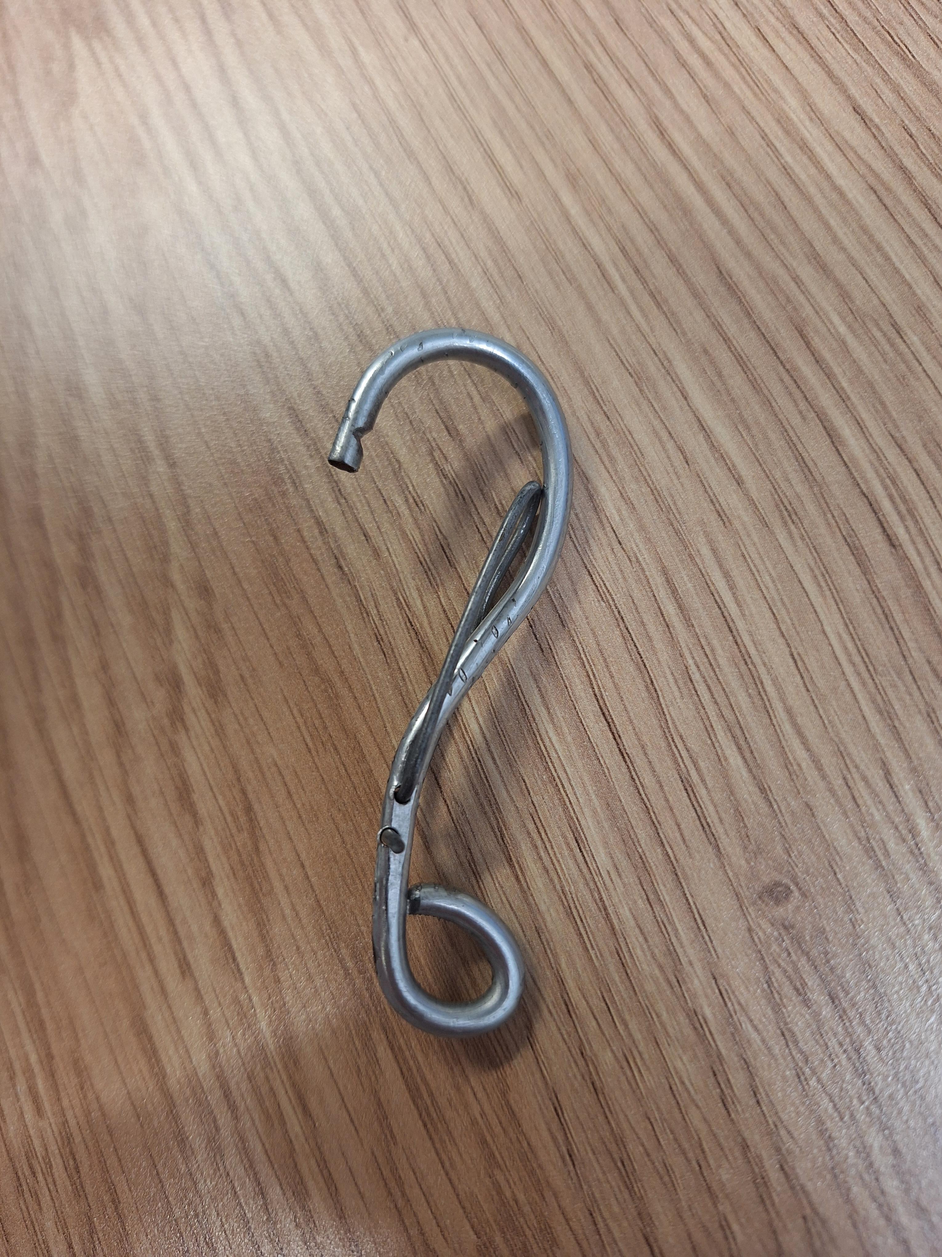

good Morning Jono,
The finger on the inside of the hook is so the Hook won't release and loose it's load, when the Hook goes slack. Is there a way you can make it springy so you have to push the finger open, to disconnect.
I use Hooks similar to that to hold Box End Wrenches together in my Walk-about Tool Bag.
Neil
Hi Neil, yes, it is springy. I was going to post a video of it but it was too big on the screen. The two photos are to show that it can spring to fully-open or fully-closed, with an over-centre action. I'm still playing around with the placement of the holes for the wire, and what kind of wire, to get one that stays only-closed and can't over-centre the other way because it will bottom out on the inside of the hook. I hope that makes sense.

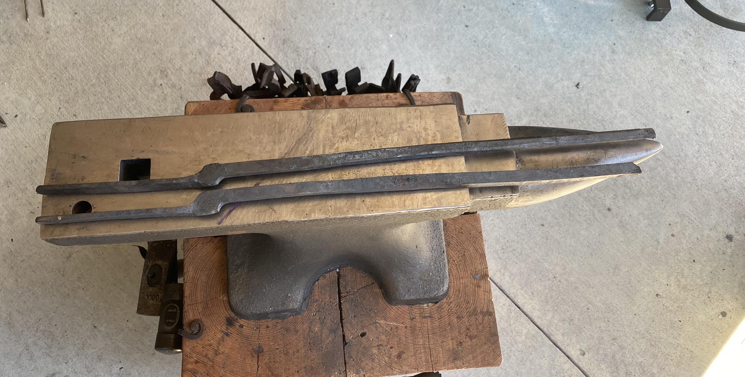

Saturday started off great!  I was going to make my first hammer, or attempt to do so.  I needed to resize my "long-finger pincher-style" pickup tongs to fit the blank, so I stuck it in the fire.  I got sidetracked by looking for my bending jig, which was exactly where it was supposed to be in my anvil rack, but I was digging around in a cabinet.
By the time I got back on track, it was almost too late.  They were burned, but not completely burned to the point of being ruined.  However, I thought they were weaken enough to be inadequate for holding the hammer blank now.
So, time to make a proper set of pickup tongs similar to TA's.  I thought 1/2" coil spring would be big enough, but it looks like the bosses are a bit small.  I think they will still work, but I'm going to remake them using 3/4" 4140 that I ordered off eBay (my GMC Sierra has 150,000 miles and needs new front struts...hmmmmm).
These are my first set of tongs from scratch.  It's fun learning the techniques.  I'll try to finish these up Thursday or Friday, depending on my work schedule.

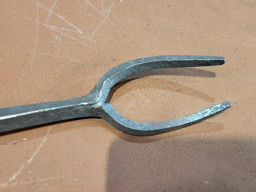

Yesterday and apparently in theme.
Not really happy.
the flipper is maybe to small. And i forgot to bend it a bit, so flat as a pancake.
But happy with the eye at the end.
The fork needs to be more pointy, but the ridge runs nicely.
but the eye is wrong. It keeps twisting so the ridge does not continue.
and for a set, they are similar but also not. Size of handle is to different.
i think i will try the flipper a 2 piece with a rivetted handle to the flipper.
Those are corrected easily enough Gewoon. The spatula can be heated and a shallow S bend but in the shank just behind the blade.
The fork is only missing some file work and making the tines more parallel towards the ends. If it's mild steel I just put a spacer between the tines and squeeze them in the leg vise. Don't close them too much but if you need to open them back up you can do that on the anvil horn slipping the crux of the fork over the horn with the handle standing vertically. You can then simply pull the fork straight off the horn forcing it to spread, do this a little at a time checking to see when to stop. Or you can lightly tap with a hammer on the tine's curves on a wider place on the horn. Again, do a little and check till they're how you like them.
Making forks come out functional, even and pleasantly shaped takes practice, keep at it and don't forget the file is your friend.

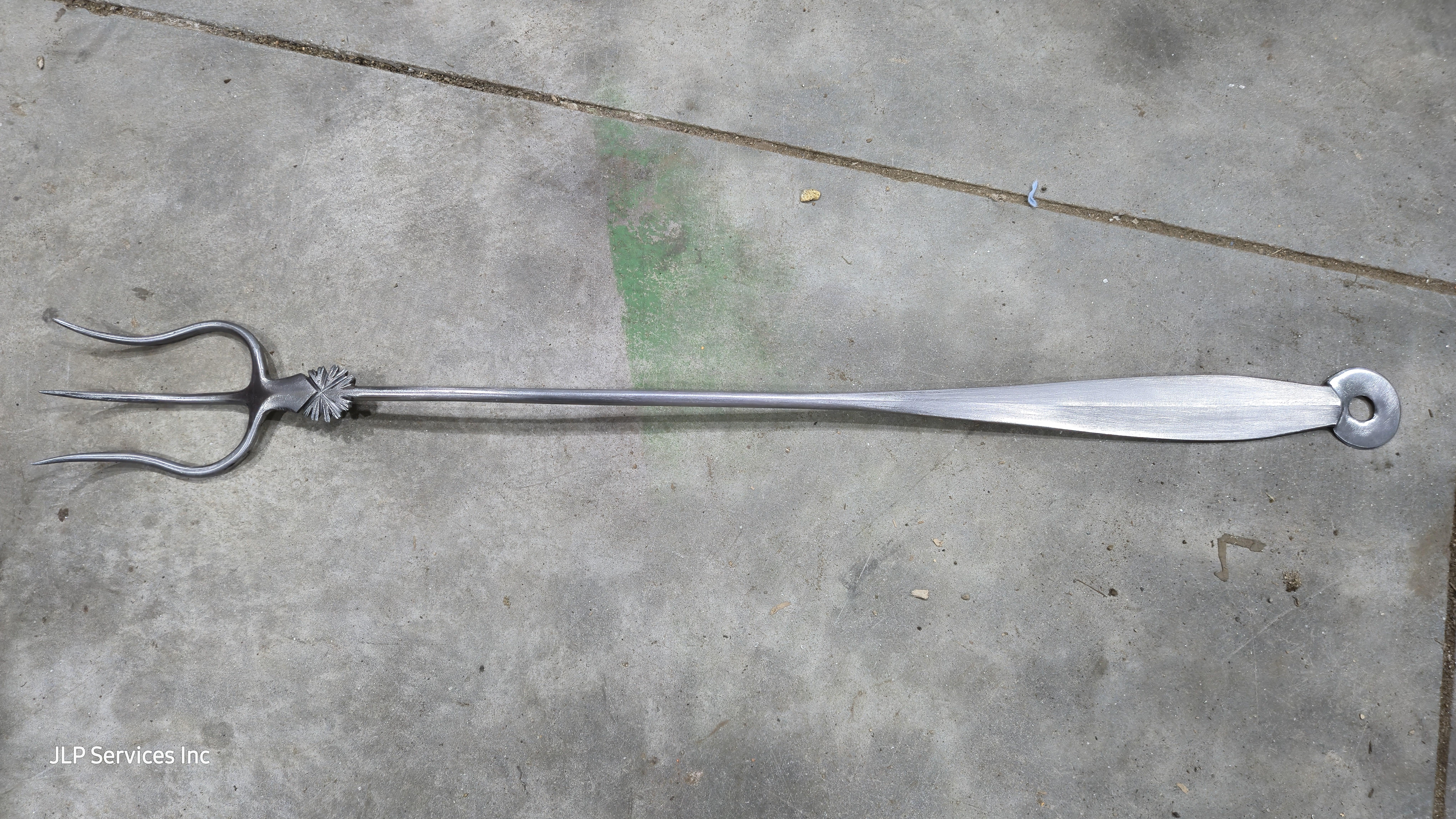

Photo of fork that is going to SOFA that will be auctioned off with the Indiana group..  I think Brian and Ed B. will be there.
I forged the 2nd fork and the 3rd for the Nol Putnam Memorial hammer in Broadway VA few weeks back.
The last is the lock forged for saturdays demonstration.
Beautiful forks Jennifer, they'll be a big hit.
Is the set down just before the handle on the lock lift up once it passes the bale and latch it in place?

Forkpart is easy to fix, i know. Was to tired to continue. Is more the eye part at the end i'm dissapointed. And it is overworked already, with big grainstructure (i can see it cracking).
The spatula I will bend, only my stupid me already put the finish on. Was after the photo I realized it will not work the way I made it.
Ah well, not to bad for 3hours work, just more care for the details are needed.
