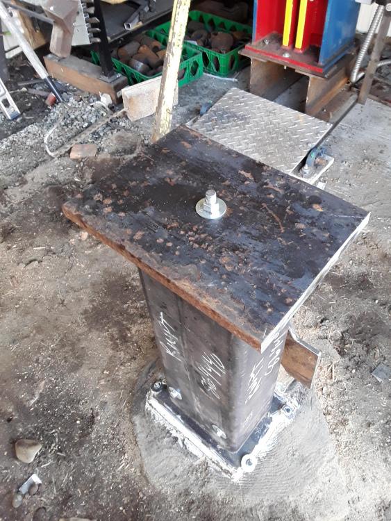

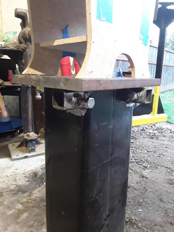

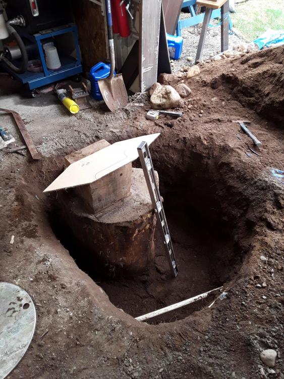

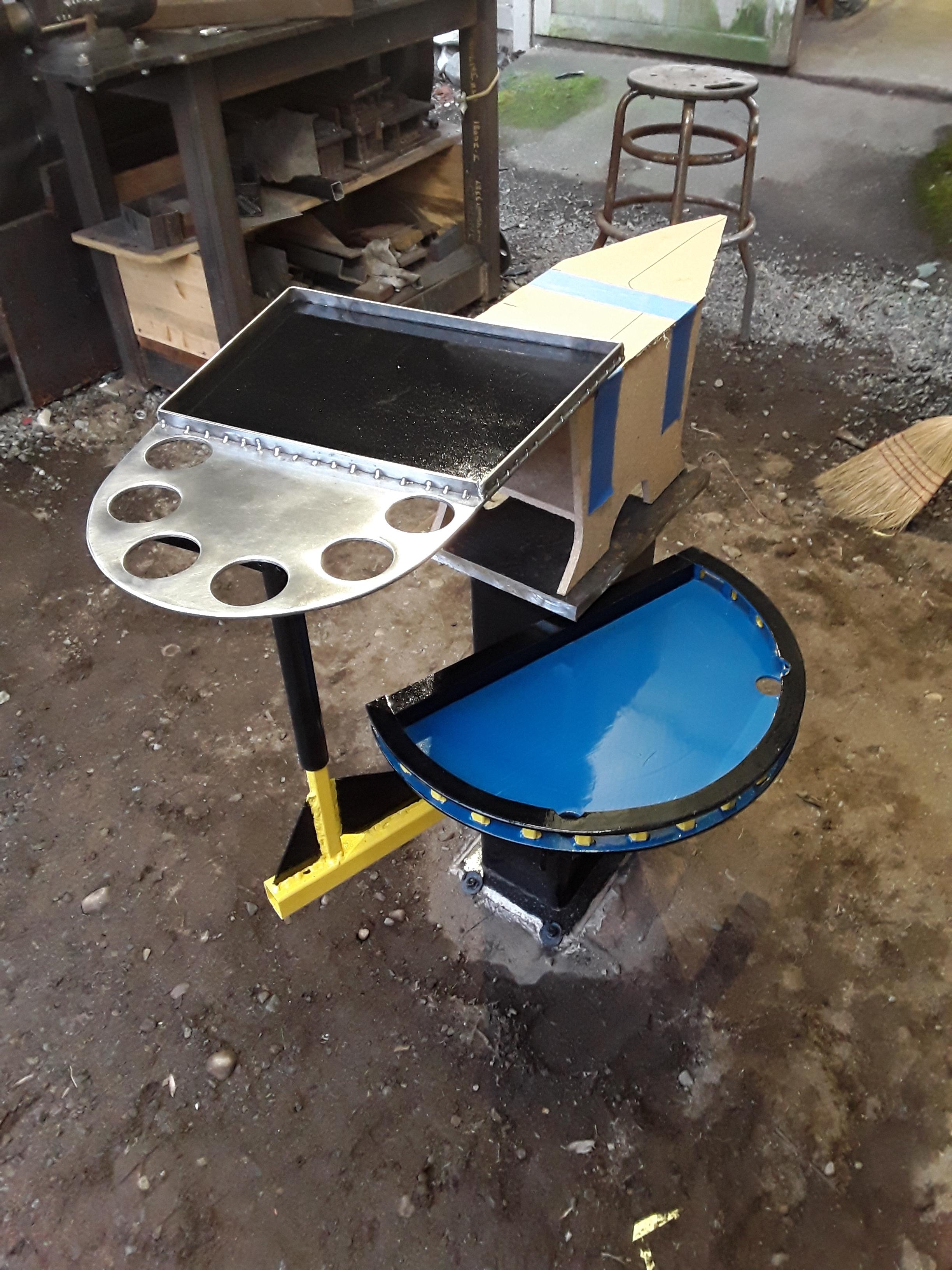

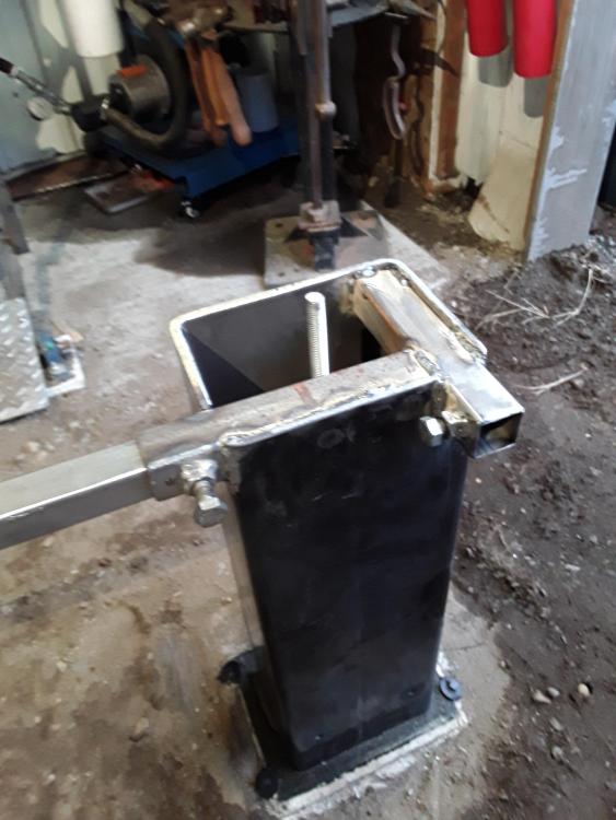

Peppie Posted February 20, 2020 Share Posted February 20, 2020 I am a firm believer in mass under your hammer should be as solid as possible. So this is were I started for the mount of my Italian Piggy. It is in transit from Italy, should be here in about 2 weeks. The cedar log is buried 3' in the ground. It has a tendon cut on the top to accept a 6 X 8 X 1/4" rectangle steel tube. I scratched my head for a few days on how I wanted to keep the stand column in place and firmly attached to the stump tendon. I first made a square washer out of 1/4" plate to fit around the tendon. This will prevent the 1/4" thick steel column from digging into the top 9f the stump. I lag bolted the base of the column to the stump tendon as seen in the previous picture. That will keep the column from tipping from side to side... but I needed to keep the steel column to stay firmly on top of the steel plate washer. I mounted 3/4 of a square steel tube to the tendon. It is lagged into the tendon from the sides. I then bolted a length of 1/2" all thread to the bracket. Quote Link to comment Share on other sites More sharing options...
Peppie Posted February 20, 2020 Author Share Posted February 20, 2020 Topped all of that off with a 8 X 12 X 3/4" base plate. This is solid. More to come......thinking about a swiveling shelf??? Quote Link to comment Share on other sites More sharing options...

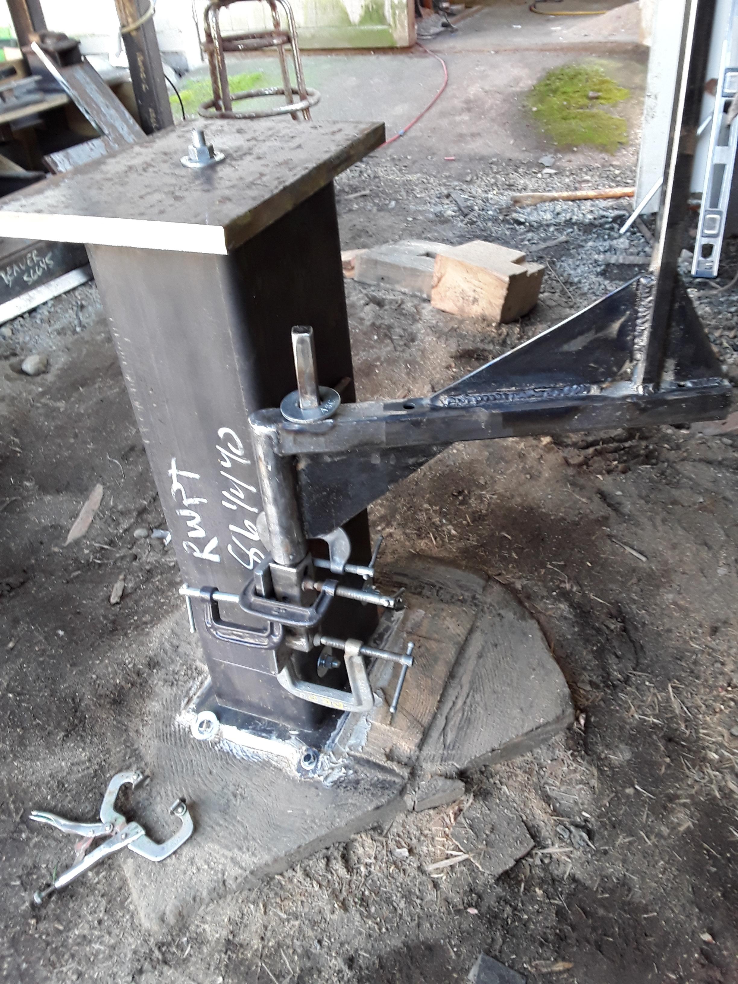

Peppie Posted February 21, 2020 Author Share Posted February 21, 2020 So today I fabricated a swivel arm to hold 2 shelves. One for below the anvil, and a self for just above the face of the anvil. Quote Link to comment Share on other sites More sharing options...

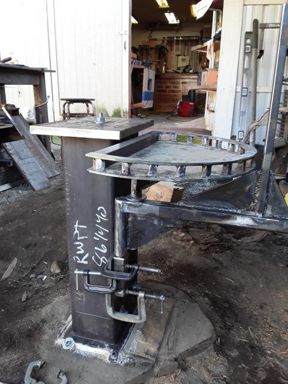

Peppie Posted February 22, 2020 Author Share Posted February 22, 2020 Today I had time to get the bottom shelf fabricated. Quote Link to comment Share on other sites More sharing options...

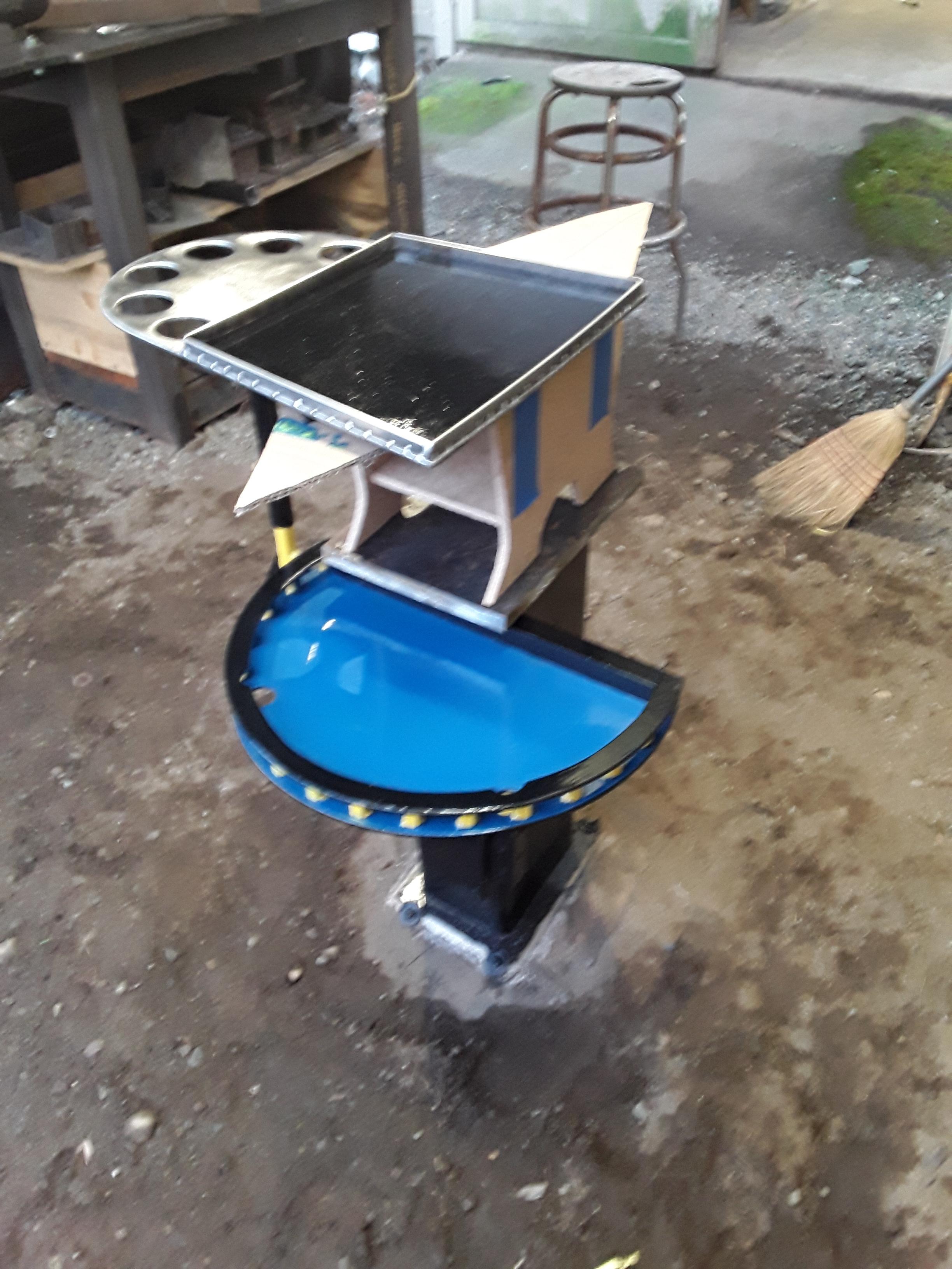

Peppie Posted February 24, 2020 Author Share Posted February 24, 2020 Yesterday I fabricated the top shelf. Wanted it to hold a few hammers and a butcher's brush. I like that both the shelves can be turned out of the way, or I just remove 5ge shelves completely. Quote Link to comment Share on other sites More sharing options...
Peppie Posted February 25, 2020 Author Share Posted February 25, 2020 Had time to make them "kinda" rustproof. I kept the color theme to blend in with the press. Quote Link to comment Share on other sites More sharing options...
Michael Posted February 25, 2020 Share Posted February 25, 2020 Looks like the last anvil stand you're ever going to have to make! Love the plywood Anvil mockup! Quote Link to comment Share on other sites More sharing options...

Latticino Posted February 26, 2020 Share Posted February 26, 2020 Are you going to fill your upright tube with a sand/scale mix compacted with old motor oil for additional mass/sound deadening? Quote Link to comment Share on other sites More sharing options...
Peppie Posted February 27, 2020 Author Share Posted February 27, 2020 Frosty--- knowing you have seen hundreds of stands.... your statement puts a smile on my face, and a fancy feather in my cap. Miss Piggy will feel like she is belly deep in mud! Captropheus- I have a habit of over killing. Latticino- yes, I spent today mixing up an oily batch of play sand, and packed the column full. Quote Link to comment Share on other sites More sharing options...
