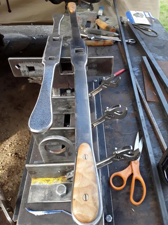

Peppie Posted March 18, 2020 Author Share Posted March 18, 2020 I just cant leave well enough alone! I know I will be twisting Damascus billets in the future. So I took the time and effort to build a jig, and a couple of twisting handle/wrenches. The jig is adjustable along the center. It is also easy to remove, and mount to the stand. I can also use it mounted to a bench. The bar in the jig is 3/4" square stock. It was a breeze to twist. The plate in the "tower " slides left to right to accommodate different sizes of square stock. 1/2",5/8",3/4" and 1". Quote Link to comment Share on other sites More sharing options...
