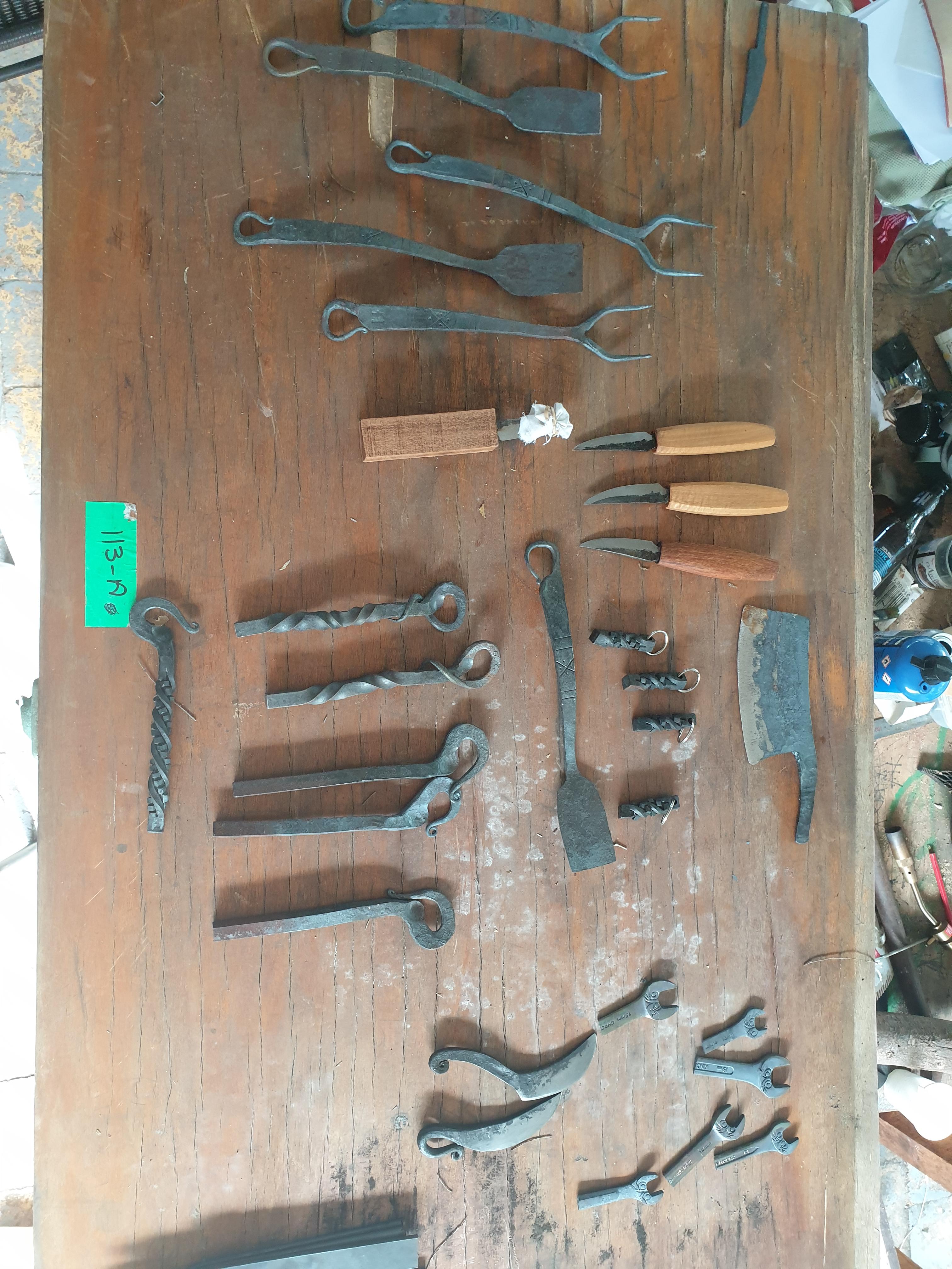

Bonnskij Posted October 13, 2021 Author Share Posted October 13, 2021 Well I've been made redundant, so that's absolutely wonderful... Nevertheless, man's gotta eat. As does everyone else in the household. Among other ventures I'll attempt a couple of markets before Christmas. I might not have the skill of most people on here, but at the end of the day, I do like how many of my things looks and with any luck, so does somebody else. And as it turns out there's not a lot of competition in the tropical blacksmith scene. Here's a few of the things I've finished/ am still working on: Quote Link to comment Share on other sites More sharing options...
BIGGUNDOCTOR Posted October 14, 2021 Share Posted October 14, 2021 Well that sucks about your job. What field are you in? Look around your area for a niche that you can fill. A local pottery studio made plates for a local restaurant. I have another potter friend who has made coffee mugs for a local business. Where I am horses are a big deal as well as other livestock, so items geared towards them might sell well. Being in OZ - if the stereotypes are correct -anything beer related could be a good seller. Try some forks with the tines about half as far apart, as they are a bit more useful all around. BBQ skewers are an easily made item that doesn't require a lot of stock. Flatter works a bit better as the food does not spin when flipped like with round ones. Campfire forks are fun, the type used for cooking hotdogs, marshmallows, corn. Maybe decorative wire covid mask hooks that go around the back of the head, and take the strain off of the ears. Quote Link to comment Share on other sites More sharing options...
Bonnskij Posted October 14, 2021 Author Share Posted October 14, 2021 Yeah. It's a bit of a depressing and surprising turn of events. I'm the last remaining technical staff at the department and the decision to let me go to save money was made by people 400km away from here and earning ten times as much as me. Sounds sensible aye? I'm in science, but have been accumulating experience that I was hoping I could use to eventually pivot into aquaculture. The stereotypes aren't wrong! BBQ's are a big thing here too. Thanks for the tips on the forks and skewers. I'll give it a crack. Hopefully I'll get a good idea of what will sell or not after the first market. I've got about a month to prepare. My contract runs out at the end of the year, so I guess I've got some time to look for a new job too, although the job market is a bit bare bones in my field(s). Quote Link to comment Share on other sites More sharing options...
