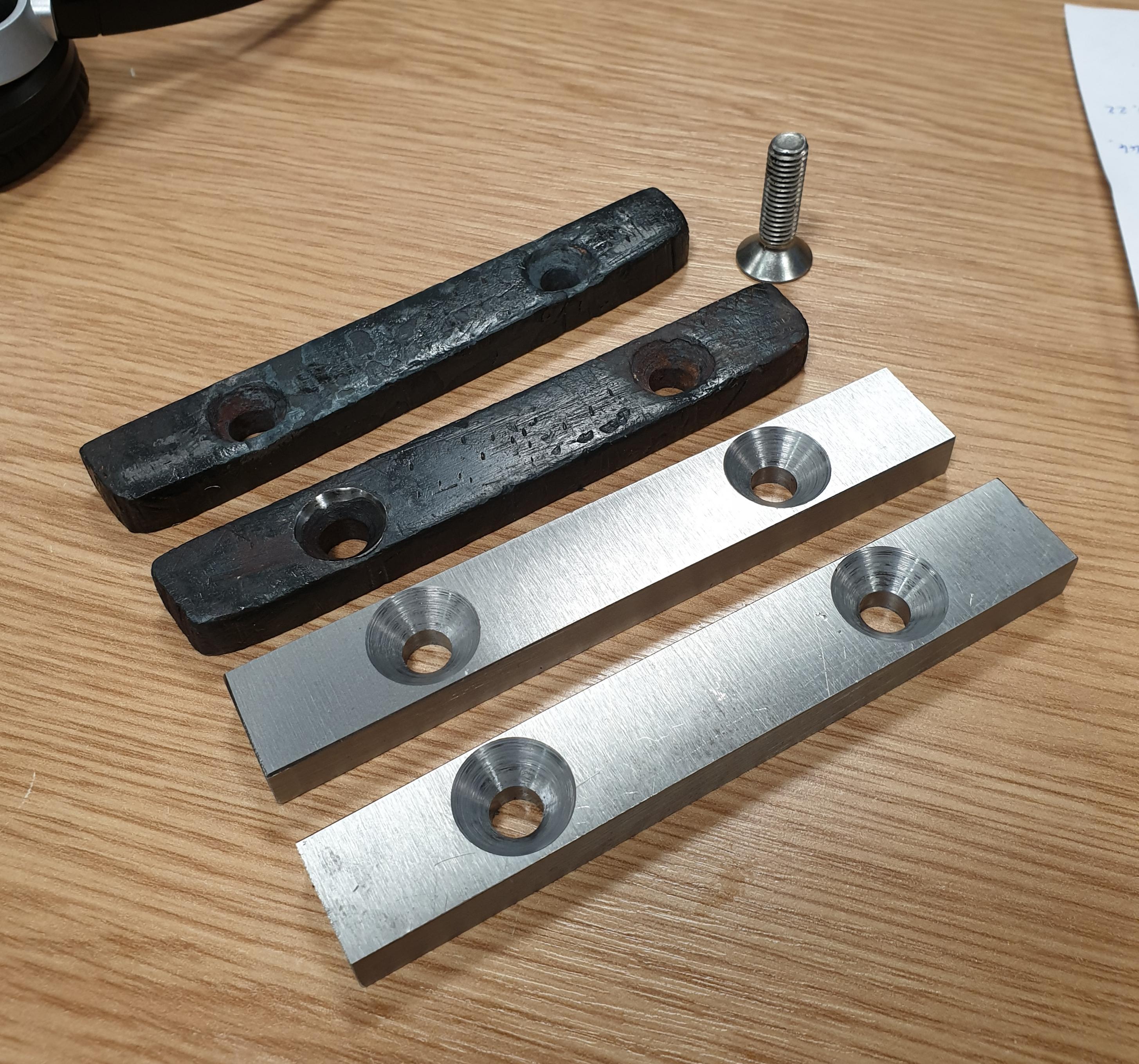

Jon Kerr Posted December 5, 2019 Author Share Posted December 5, 2019 New removeable jaws made by the workshop. I can dress them up with a grinder and then heat treat as appropriate. As for the "mangled" hole.... I have that half of the vice in the car boot with me. I'll have a go at lunchtime at drilling out the stuck bolt! At least now I can use the jaws as a guide for where the original hole was. Quote Link to comment Share on other sites More sharing options...

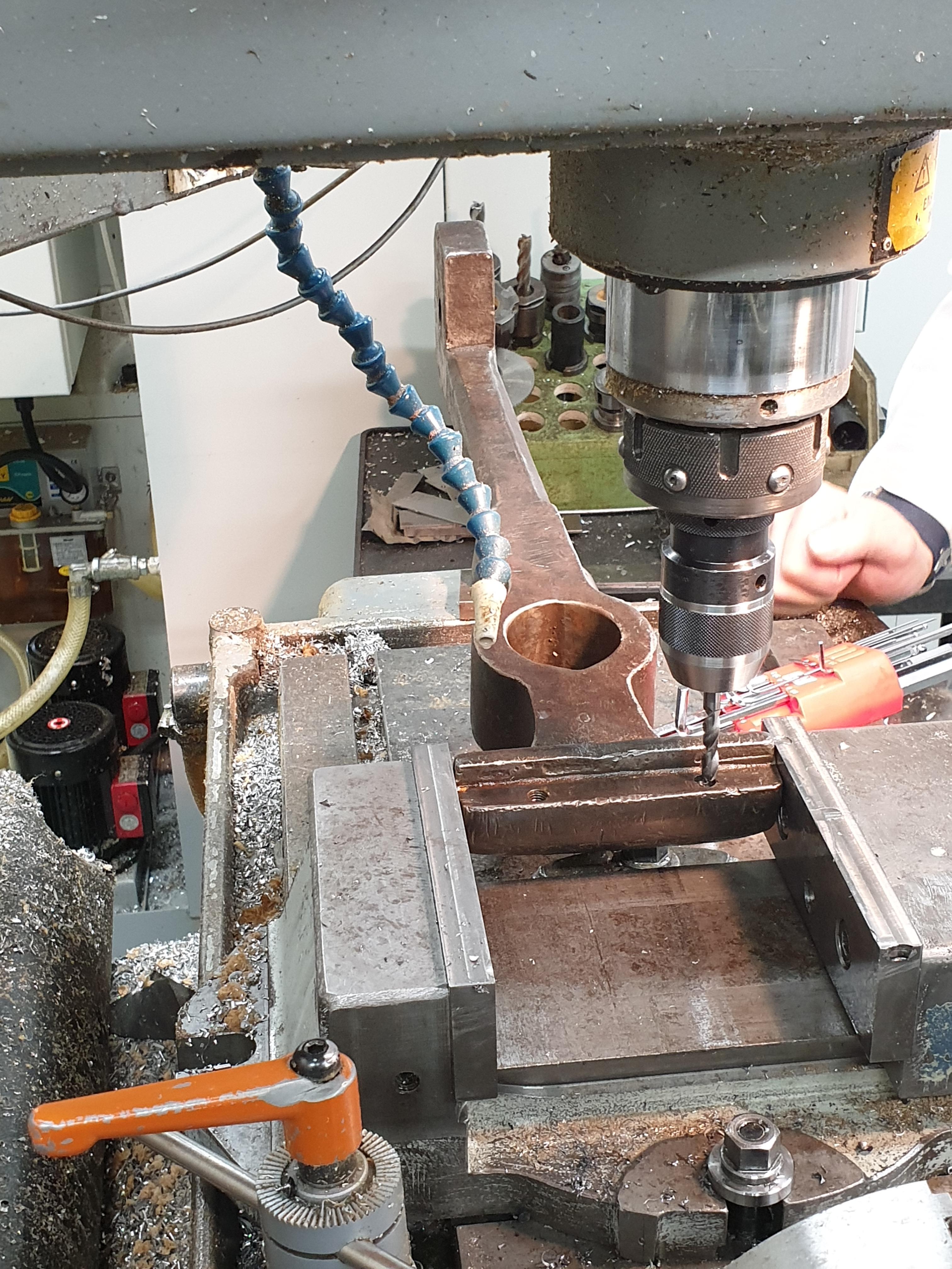

Jon Kerr Posted December 5, 2019 Author Share Posted December 5, 2019 Well, this escalated.... in a good way! Took the vice into the workshop at lunchtime intending to use the pillar drill. One of the chaps had a look and reckoned the hole was too mangled to stop it wandering. He offered to do it for me on the mill! This turned out to be a lifesaver as there was something VERY hard stuck in the bottom of that hole. Even the milling machine with a carbide drill was NOT sounding very happy. Furthermore the hole hardly matched up to the measured holes in the jaws so wouldn't have fitted even if I'd been successful. In the end, my mate succeeded in drilling the hole out in the correct position, and even tapped it for me. Next step, get it home, get the other set of jaws on, and reassemble, then sort out a vice stand. Very happy! Thanks again for all your help and advice. I'd have probably done something silly and ended up in a far worse position. Quote Link to comment Share on other sites More sharing options...

Marc1 Posted December 5, 2019 Share Posted December 5, 2019 7 hours ago, Jon Kerr said: This turned out to be a lifesaver as there was something VERY hard stuck in the bottom of that hole. Even the milling machine with a carbide drill was NOT sounding very happy. Furthermore the hole hardly matched up to the measured holes in the jaws so wouldn't have fitted even if I'd been successful. Most likely a broken drill bit, or a broken off stud extractor. The sort of left behind bits you find when you try to fix someone else's unfinished repair. And that reaffirms the principle of never using those wretched extractors unless you have a plan B and a plan C to apply after they break off. Quote Link to comment Share on other sites More sharing options...

Anachronist58 Posted December 5, 2019 Share Posted December 5, 2019 Specially modified carbide endmills will cut cobalt drills. I have had to shatter broken carbide from holes. If saving the part is paramount, then as Thomas Powers mentioned, it is off to the Wire Electric Discharge Machine (EDM). Marc 1, I agree wholeheartedly - leave those wretched extractors to the highly skilled professionals, like me. Robert Taylor Quote Link to comment Share on other sites More sharing options...
Kozzy Posted December 5, 2019 Share Posted December 5, 2019 When all else fails, I use small carbide endmills and manually eat out most of the offending bits. I happen to have a lot of worn 1/8" carbide endmills and just chuck em in the foredom, carefully picking around in the hole. Eventually you get to the point where what's left can be basically pried out of the hole. I don't think I've ever had the privilege of a part that would actually be mountable on the milling machine...everything seems to be too awkward for that. Not fun and definitely last ditch method. However with care, I've saved a lot of holes from needing to be enlarged. Quote Link to comment Share on other sites More sharing options...

BartW Posted December 9, 2019 Share Posted December 9, 2019 I've done a similar repair last year, with similar results, and even with a broken drill bit in one hole too. My fix was somewhat different though. I ground out the drill with a carbide endmill - very slowly , lots of coolant. But I never tapped the hole, I just cleaned it, degreased it, made new jaws that lined up perfectly, and made soft copper rivets; and hammered them in. The customer wasn't going to use it to hammer on anyways, and the copper rivets are still holding up strong ... And with the mangled thread on the inside, it's really stuck in there, but still easy to remove, it is soft copper afterall. Quote Link to comment Share on other sites More sharing options...

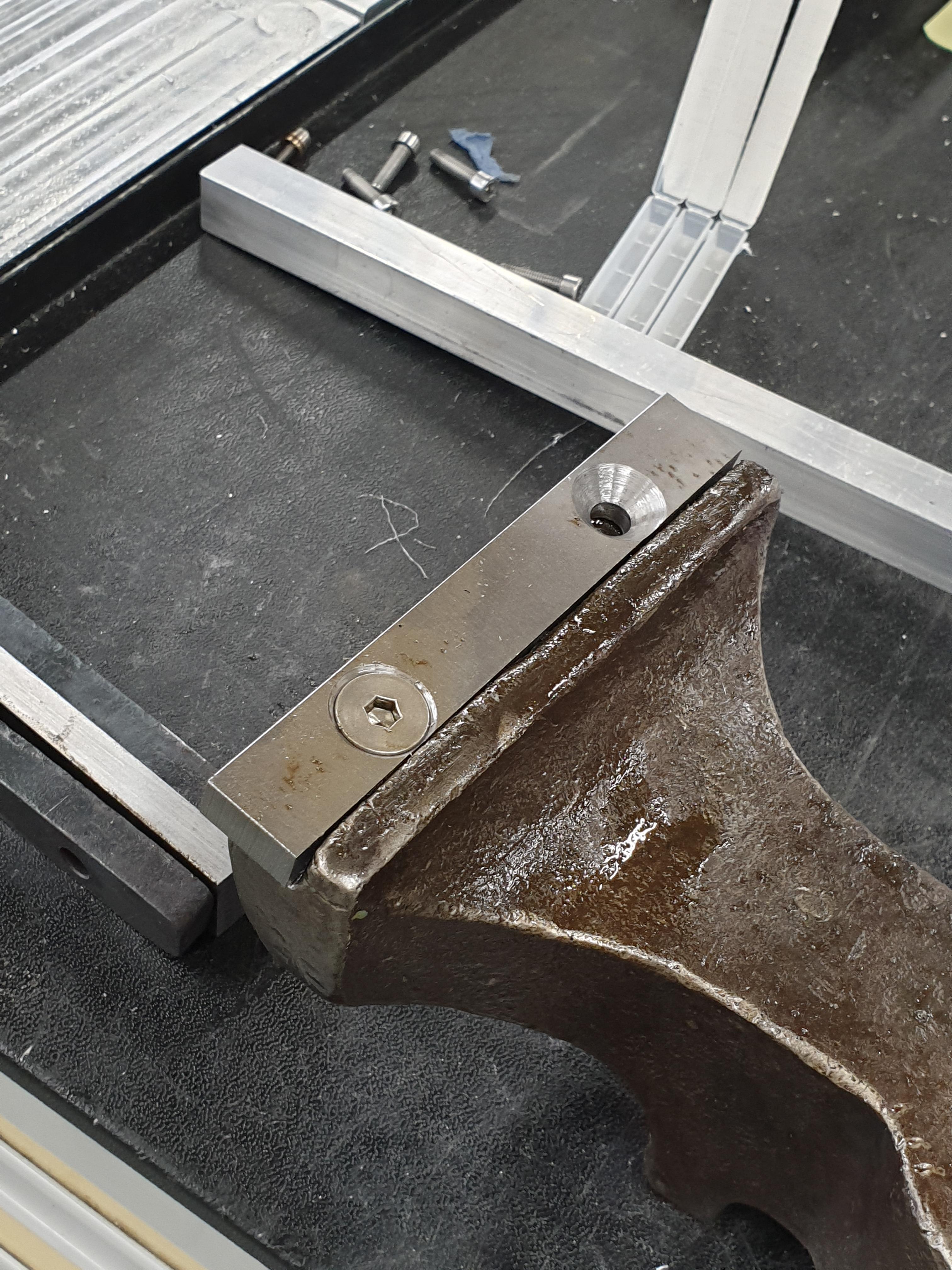

Jon Kerr Posted December 9, 2019 Author Share Posted December 9, 2019 The jaws are now in position. I intend to dress them with a grinder at some point, including radiusing the edges facing the vice body which may help them sit better. As you can see the alignment of the jaws isn't great. Does anyone have any guidelines as to what the alignment should ideally look like for a closed leg vice? Obviously due to the swinging mechanism they are only going to be parallel at a certain distance apart. I started making a vice stand for this. I still have a ways to go..... Unfortunately, I also made the mistake of leaning the vice up against a cabinet while I drilled out the holes for the stand. I watched in slow motion as the 30kg vice began to topple sideways and crashed into my 3D printer.... I had tools in my hand, and there was no way I would catch it in time. (A stupid mistake. It was a temporary storage location under a bench. Accident waiting to happen. Fortunately the 3D printer wasnt currently in working order anyway, but its certainly not going to be working any time soon now!) *sigh*. Two steps forward, one back. Quote Link to comment Share on other sites More sharing options...

Marc1 Posted December 9, 2019 Share Posted December 9, 2019 Collision of the old and the new. The new lost It seems that your moving jaw is lower than it should be. Check the big pivot bolt or the eye in the jaw for wear. Also, the jaw insert don't sit properly in the jaw. The old one were not as high and sat below an edge that formed as the jaw rolled over with use. You may have to dress the jaw and fit the insert so that it sits flat and square against the jaw. Be careful with the grinder. Use only flap disk and that very sparingly a bit at the time checking repeatedly until the jaw insert sits square. Quote Link to comment Share on other sites More sharing options...
