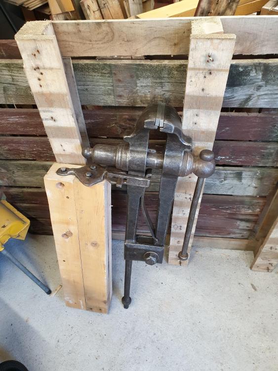

I picked up this vice cheap on eBay. Unfortunately the photos are old- its now been fully wire brushed, oiled and is ready to go except one problem... the jaws.
The vice has removeable jaws. I have no idea if this is a modification, old repair, or original. I doubt its original.
When I bought it, the jaws had bolts in (1 missing), but the vice was seized shut. Once I got it unseized and cleaned it turns out these bolts were in a bad way (they certainly werent holding the jaws in much!)- the threads are mostly ruined and one of the holes is actually mangled and diagonal- I cant see how it ever had a bolt in it. Really strange.
My question is- what would you guys do to repair it?
I've tried drilling the hole out and tapping but its too tough without serious gear. I had no joy trying to drill the mangled hole out clean.
Would you weld the jaws back on?
I have no experience welding but am about to purchase a stick welder and gegt a friend to teach me. Would that be an appropriate fix?
I'm really hesitant as I dont want to ruin a really nice old vice, but its sat useless for the past few months since I cleaned it and I desperately need a solution.

Got any friends who work on big trucks or equipment and are used to fixing bad holes/bolts?
Unfortunately not :(
Is that the route you'd pursue though Thomas? Trying to fix the bolt holes?
Later vises did generally come with replaceable jaws.  That was standard on machine vises so they just carried it over to leg vises.  They have benefits in that you can use a hard flat, a hard checkered to really grab (and mar your part in most cases) or a soft brass to protect part surfaces.
I'd personally replace them by fixing/tapping the screw holes..but I can't really see just how bad things are in the photos so don't know what you have to work with.
You could also do smooth holes and just have dummy locating pins on the back of the replaceable jaws--that'd be easy to do with screws in that you just tap the threads in the replaceable jaws themselves to hold the countersunk screws and let the rest of the screw poke into the old holes (unthreaded) in the vise body.  A bit of screw location error provides some friction and they would need to be tapped into place to stay and could be tapped out pretty easily to change to soft jaws.
Note that you'd have to make your own jaws if you did the above.  It's not hard.
Considering that a post vice is designed to forge on it, I wonder how well those screws will withstand hammering on the jaws.
Of course for ordinary vice work, swapping jaws and replacing with different metals and surfaces is very handy. Not sure I would want that on my post vice.
Having said that, I wouldn't modify what you have. Just repair it to original conditions by drilling and tapping for new screws. Not hard to do, lots of good advice in youtube for such procedure.
If you then smash the screws when forging, you know you need a different post vice.

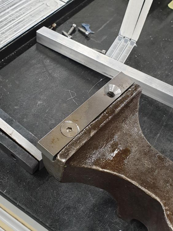

Thanks for the replies everyone. I'll post some more pictures and details but I might not be able to get into the workshop till the weekend.
Had another go tonight. (Only had 20mins in the shop). Watched some YouTube videos about drilling steel earlier and followed the advice.
Having a new drill with better speed control and a better chuck helped. I made it through 1.5 holes before the battery died (and it was late anyway). Only openening them up from approx 6mm to 7mm, ready for an M8 tap, but it worked.
I also have a new tap wrench, which doesnt slip on the shank. So i managed to successfully tap the first hole out to M8.
I've attached pictures of the dodgy hole. Not sure how much success I'll have drilling this one. Any tips?

It is a patience game. Last time I replaced the elbow in my boat engine exhaust, I found one of the bolts had broken off and half of it was still in the hole after pulling it out.
Drilled it out with progressively larger bits. In my case the forward section of the hole was stripped, so had to bore all the thread out, cut an oversized thread and screwed in an insert to bring it back to original.
My suggestion is to use high tensile screws.
Those screws will take a beating, look at how the edge of the jaw body, rolled over the jaw insert from the hammering.

Further update: The workshop guys have given up. Whatever material those jaws were made from, its HARD! They tried annealing with a torch and it made no difference- must be air hardening steel.
I can possibly anneal them at home in vermiculite, but the guys are going to make me some new jaws from steel gauge plate for now. I owe them some cakes for their trouble!
Tonight I'll have a go at finishing drilling and tapping the holes....
Jon Kerr, it appears to me that there is, indeed, a screw broken off in that one mangled hole. Try to extract it. If successful, the advantage would be having a pilot hole in true position.

Tonight I succesfully finished drilling and tapping the 3 good holes.
I couldnt move onto the mangled hole as I want to use the jaws as a guide and I left them with the workshop guys.
I did try removing it with the "reverse tap extracto thingy" but couldnt get it to bite. I will try once more once I've drilled a small hole knowing the centre point, but I'm doubtful.
Thomas et al: are you saying I'm likely to not be able to drill out the bolt with a hand drill? (I have no experience doing so) Maybe I need to take it to the workshop pillar drill.
Marc: I hear your concerns re/ M8..... at this stage I dont want to go further to try and move to M10/12, but I understand I'm taking a risk. At my current smithing skill level I'm not likely to be doing very heavy work on it for a while anyway.

I saw an Allen set screw in the bottom of the damaged hole. They are hard and difficult to drill. Use a Drill Press or a Mill/Drill at very slow speed. When you get the hole drilled through (go right through, not a dead hole), tap for a Heli-Coil or machine  for a bushing from a larger Grade 5 or better bolt (drill and tap the larger bolt in a Metal Lathe, to your desired inside size (8mm??). Cut the bolt to the desired length and you now have a Bushing. Perspective is not cast in Stone. The jaws are sitting on a ledge, on each side of the Jaws, the set screws only hold the Jaw to the Ledge, they don't take the abuse.
Don't drill the bad hole with a Hand Drill, unless you want to make the problem worse. NEVER USE an E-ZE-OUT!!!!! An easy-out will make your problem worse by expanding the stuck piece and locking it in forever. Then the E-ZE-Out will brake and you throw the whole Vice in the scrap. No Lesson Learned!!
