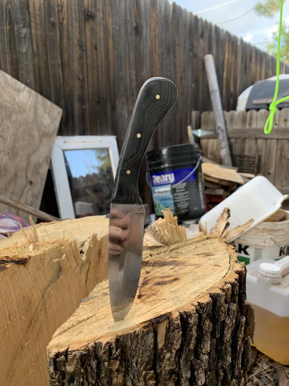

I finally got around to finishing my second knife and I would love some feedback!
It is leaf spring steel from my old jeep with paper micarta scales and brass pins.
If anyone knows of a good way to treat the micarta please let me know, when i finished shaping it had a weird dirty look, so i hit in on the polisher and it just made the scales really slick. So if you have a good way of finishing those let me know!
Depends on what you like. Some folks bead blast them to give a matte finish with some tooth to it.
I can't give you any advice on micarta as I don't mess with it much, but I wanted to say your knife shows a lot of promise.
One suggestion, and take it for what it's worth, is to take your bevels up much higher.  I would have run the bevel up a little more than twice as high as you did at the heel and run it out perpendicular to the plunge line until it broke out on the spine of the knife.  (Ok, that probably isn't as clear to you after you read it as it is in my head when I wrote it :) )
My opinion is worth exactly what you are paying for it, but I feel that gives you a better performing knife as well as a better looking one.
Keep it up!  That level of fit and finish on a second knife is rather rare, and shows that you are not afraid to put in the work it takes to get good at this.
My experience with DIY micarta using fiberglass resin is that the higher you go in sanding grit, the darker it appears and the more slippery it becomes.  I usually use a paper towel or clean cloth and rubbing alcohol to clean up the scales at the end of the shaping and sanding.   I have a knife where the handle is a bit slicker than I'd like and I plan to use a triangular file or hacksaw blade to cut a shallow checker pattern into the scales for more grip.  I'll try to remember to report back here afterwards, but it may be a few days before I can get to it.
That’s a solid idea! Just to add some grooves to make it easier to hold onto. I may try that on this blade but I’m rather happy with it and would hate to mess it up! Chances are though I’ll make a few more knives!

Well thank you! It means a lot, this stuff is hard and it’s great to get some help. I totally understand what u mean about the bevels. This is probably the fourth time I’ve actually attempted bevels so I was more concerned with actually getting an edge. I agree though and wish I took it up higher as there is still a lot of meat on the spine.

Very nice knife actually. I would take the grind up higher too; for cutting performance and looks.
How did you harden / temper it ? You also did a great job on the surface finish; you must have spent hours on that. Well done.
As for the micarta; depending on which kind, and if you don't have access to sandblasting equipement; but you could also use a rotary steel brush on a bench grinder on it; in some micarta's it gives a nice finish ( like an orange peel texture - less slippery yet stil fairly dark).
