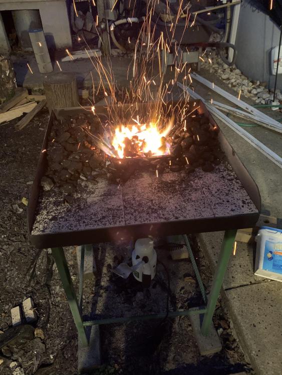

Building a coal forge
First fire but then rain came.....

I was burning wood to start.... anthracite :blink:, i’m in south Jersey and Im lucky tractor supply carries coal, can’t find other coal even in Philadelphia

Your coal is in too large pieces, break it up to acorn or smaller and you'll get a much better fire. Smaller pieces have a greater surface to volume ratio making it easier to light. Being smaller means the open spaces between are smaller so the air blast is in better contact and  is consumed burning the coal so less free oxygen contacts your work.
WAY too much air, even for wood. You don't want flames shooting out of the pile, you want it contained under a pile of coal which keeps ambient oxy off the steel and reflects IR back towards the center and insulates the fire. This gives you better heat control is much more economical but isn't so showy.

Thanks I will take a look, today I tried the anthracite and my blower must be too strong because I broke off a piece of metal soon I hammered (too hot) plus I had trouble to get closer because the heat and all this outside with a nice temperature of 58F, my blower is for computers but is so strong I use to clean the floor of my garage.

I would say you are right about too much air. You can make an air gate to control the amount of air blast.
How can I make an air gate? The blower fits in the pipe and I don’t even cover with tape.

I did that and that was a big difference, now I don't have any problems to start a fire using charcoal and coal, the only problem is my forge is outside and I can't see the heat color and so far I melted a few metal pieces.

Out on the prairies where they didn't have any shade or trees, they used to have a barrel propped up for them to stick the metal in to see the colour in the shaded interior. Used to forge using buffalo dung for fuel.  I bet you can come up with a way to shade your set up!  (I've forged using my body to cast shade on the anvil to tell the colour of the metal.)
How about a lean to blocking the sun made out of a tarp some rope and a couple of poles? It has worked for me.

Did you take the pump out of the pipe and just aim it at it? I use a ball valve to adjust the airflow. I have a hose coming off the pump hooked to a ball valve on the tuyere pipe. It's has a pretty large range of adjustability. From just barely any air to blowing the fire out of the pot.
Pnut
I bought a variable speed adjuster from amazon and works really good, cuts the speed from a full blow down to 50%

That'll do it. Some pumps cool their motor by the amount of air entering the intake so if you slow down the motor they overheat. I'm not saying that is the kind of pump you have I'm just passing on some info
