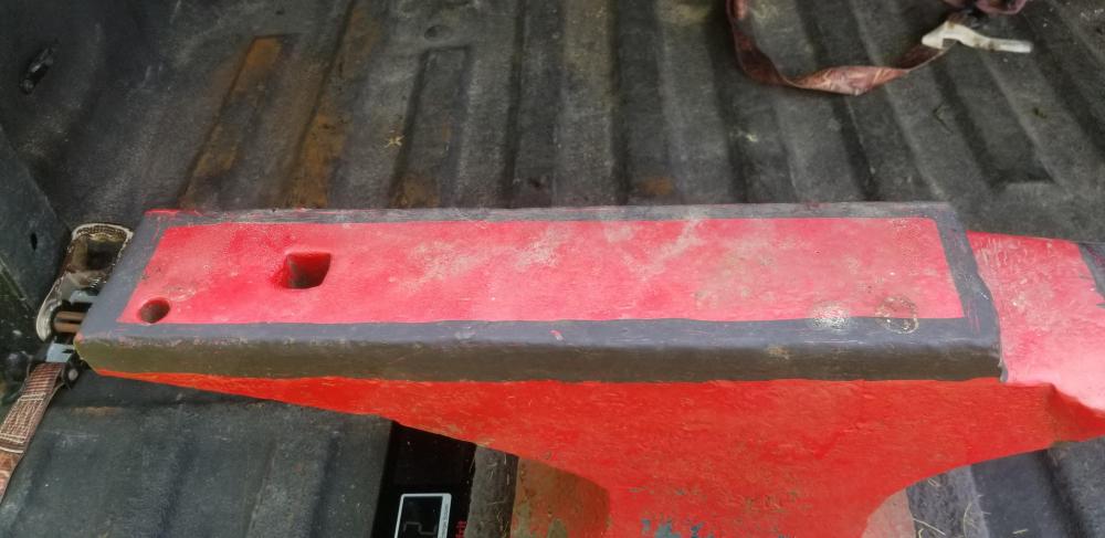

For the last little while I've been banging away on a 200 Lbs block of P20 and mentioning the word "ANVIL" to everyone I know in hopes someone would know that guy that had one in there back yard... Well today was that day. total wt is 152 Lbs. and I was told it was painted to look like a cartoon Anvil complete with hand painted Acme on the side. So I took the wire wheel to it and found this... Any Ideas on what I have? the rebound is fantastic compared to what i have.
I know that it is a hay budden. One of the anvil gurus will be along with more info shortly. Make sure you dont grind or mill the face at all.
A well know reputable brand. Way to go.

I was going to hit the top with a flap disk to take the paint off, but I might go with paint stripper and a wire brush first.
Ooooh, a FREE Hay Budden? I sure hope you bought a lottery ticket or two today!
I think a disk grinder and cup brush will clean that beauty right up. Wear breathing protection you don't know what kind of paint's on it, might be lead based.
Someone with a copy of "Anvils In America" should be able to tell you as much as the numbers can.
I'd use just the wire cup brush.  Flap disks can remove metal and from the looks of your anvil, it doesn't need any metal removed at all.  The only time I've used a flap disk on an anvil was when the face had been really marked up.  The flap disk knocked the marks down to an acceptable range.  Yeah, a free Hay Budden, you really got a huge blessing.

Did a little research on the number and came up with a year of 1901.
Would that be a solid steel verson or the half wrought half steel?

It doesn't look like anyone has mentioned it. Its a farrier pattern anvil. The deal sticking out to the right is for pulling clips on horse shoes.

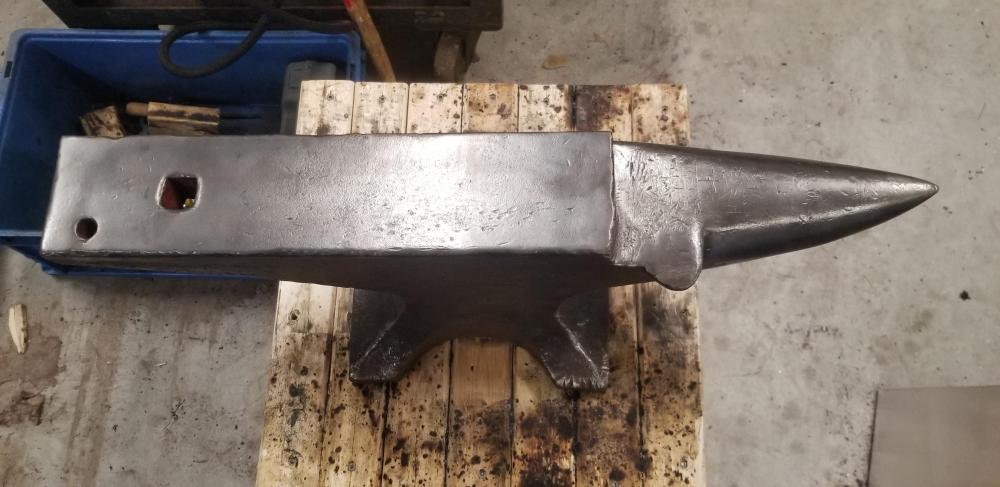

Thought I would add a after pic. looks like there are 2 weld lines. one in the middle and a clearly defined line 0.75" from the top.

Okay, off the rant box.  That beautiful anvil just gets more beautiful every time you post a picture of it.  Congrats.  (Dang that was hard to say!) :lol:
Dang!  That's  nice.........................I mean, surely you could get that silly ball to bounce higher!  ( you know I'm gonna rib you about your good fortune forever, Dan, so get used to it!) :D:lol:

Nice job on the clean-up!  The rebound test looks like it returns nearly 100%  Now you don't need another anvil for the rest of your life :D
