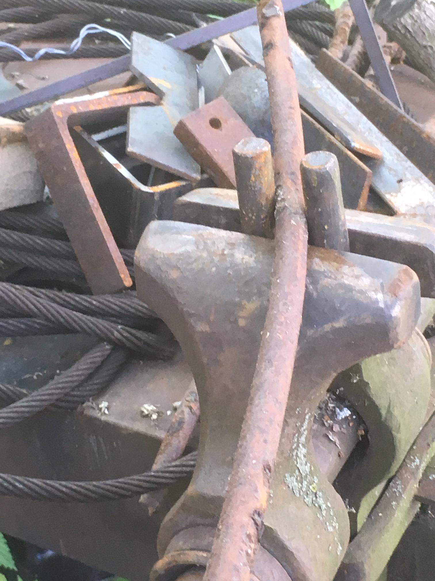

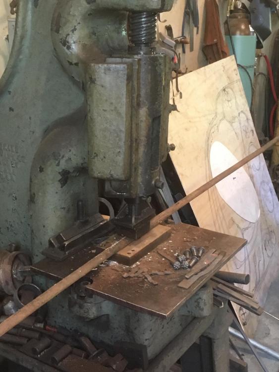

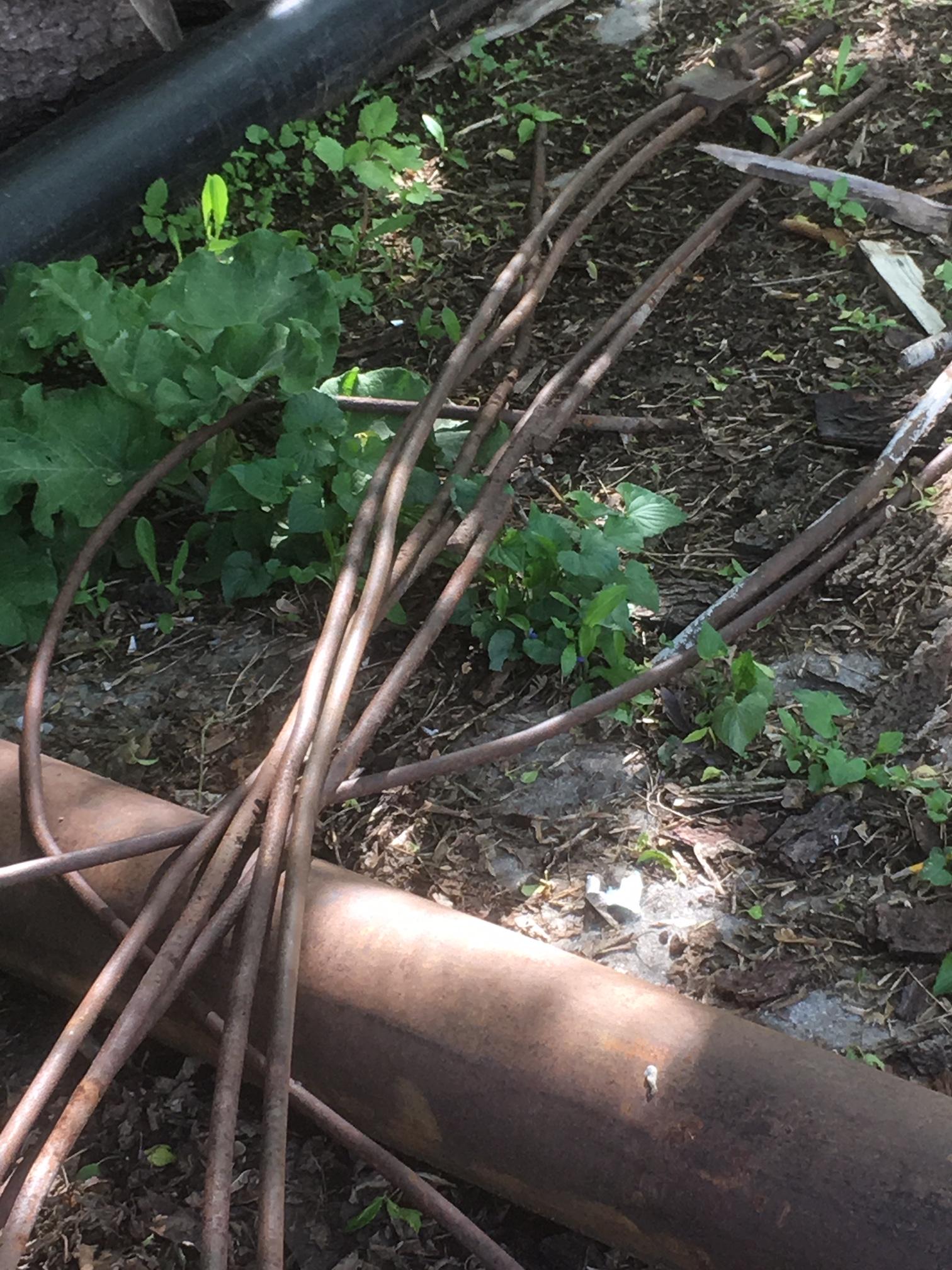

Judson Yaggy Posted May 25, 2019 Share Posted May 25, 2019 Ok braintrust, here is my dilemma. I made about 30' of interior barrier railing (95% fabricated) out of some very old, rusted, pitted silo hoops I had in my scrap pile for some clients who wanted the most rustic, salvaged look and materials I could find. It was around 200 linear feet of 1/2" and 9/16" material. Silo hoops are both curved to begin with and abused from the deconstruction process, so they needed to be straightened. Doing so was ok if tedious for that amount of material. Trouble is, they liked it so much they changed the design of the other railings in the house and want the same material. I would love to know any tricks that would make straightening another 700 linear feet of material faster than my process. What I've been doing is 1. cut to rough length. 2. roughly tweak to approximate straight with bending forks in a vise 3. put flat dies in the fly press and work the high spots down. See photos below. Working cold to save time and rust, sorry, I meant patina. Anyone have a better way? Quote Link to comment Share on other sites More sharing options...
anvil Posted May 25, 2019 Share Posted May 25, 2019 Basically, your pics show how I would do it. Bending forks and scrolling wrench. If you arent using stands, then Id add them as needed. I use my vice instead of a press. Lol, hire an apprentice. Quote Link to comment Share on other sites More sharing options...

Judson Yaggy Posted May 25, 2019 Author Share Posted May 25, 2019 7 hours ago, anvil said: Basically, your pics show how I would do it. That's good to know, was pretty sure I was on the right track, just fishing for a trick I hadn't heard of! 7 hours ago, Charles R. Stevens said: This is what your sway backed anvil is for! My anvils are dead flat, as they shoud be in a professional architectural shop! (poke poke!) If I want to hammer over a hollow I use the swage block. 6 hours ago, Glenn said: You do not need the entire length perfectly straight. I do need the entire length very straight. I've cut the rough length to +2" oversize. The rail sections are between 6 and 10 feet long, and this is for a very precise installation, despite the rough looking material. Should have said that the bars run horizontally, thus the longer lengths (not 36" balusters). 4 hours ago, BIGGUNDOCTOR said: I used to straighten out the 12 foot long bent bar stock for the CNC screw machines. Anywhere from .0625"-.625" using a small lathe. That's interesting! You win the prize for most helpful. Will try that tomorrow. Thanks all! I should add that my apprentice went and got himself a job with lower pay but more regularity off the farm. Teenagers! Quote Link to comment Share on other sites More sharing options...

Frosty Posted June 4, 2019 Share Posted June 4, 2019 Don't they have a threaded end? If so make a pulling yoke you can attach to the trailer hitch. Make a set of straightening rolls by welding solid bars vertically to a piece of plate you can spike to the ground. Slip pipe over the vertical bars to act as rollers. You want them spaced so the bar to be straightened is flexed slightly back and forth as it passes through. Now spike the plate to the ground and lace a silo rod through to start, screw the yoke on the end and pull it through with your vehicle. If it's not straight enough flip it over and draw it again. By flip it over I'm referring to it's original orientation as a ring, not end for end. Yes? If it's still a little wonky take a hammer to it but it should be darned close in a draw or two. Frosty The Lucky. Quote Link to comment Share on other sites More sharing options...
