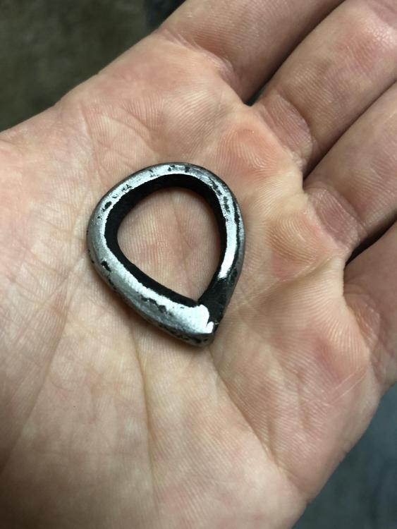

Hey everyone! I built my first forge ever yesterday out of some bricks in an old grill. I’m using a black iron pipe and a hair dryer with a shop vac attachment as my air source. Charcoal is the fuel.
Mid anyone has any suggestions or recommendations please let me know what I need to do to forge properly and safely.
Thanks Dallas
Looks like too much air. If the hair dryer is connected to the pipe disconnect it and just point it at the pipe. It more than likely won't need to be pointed directly at it for adequate air. Play with it and see what works best for you.
Gentlemen.... I HAVE BENT METALL!!!!!
I had a few extra hours to play around and I was trying to be very mindful of both fire management and hammer accuracy.
I employed your advice about the air and I worked really well. I didn’t realize how fast I was burning through charcoal that I didn’t need to be. It was definitely a learning experience and also very rewarding.
