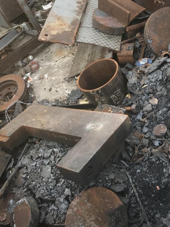

Ok so I saw this thing at my scrapyard. Not sure what it is, but Its just a huge hunk of steel that had an ok rebound with a ball peen hammer. Can anyone ID what it might have come off of? I was mixed on buying it as I have a decent 150# Vulcan and I would need to trim this plate to be at the correct height to work on. What do y’all think?

From the angle of the picture, the face with the hole would be the top face. Ideally I would like to cut off the bottom protrusion which would get the top face close to or lower than where I need my anvil height. I could also cut it directly in half and have 2 anvils with upsetting blocks. I would hate to buy it and find out cutting this thing is more than I’m willing to spend.

I never took any measurements but my guess is it’s about 3” thick. If I go back today I’ll be sure to bring a tape measure with me. The piece isn’t super hard so many cutoff wheels should eventually get through it.
I would be shocked if a scrap yard didn't have a set of torches handy, and would also be shocked if the yard workers couldn't be bribed to make a cut for you with a box of doughnuts.
But personally I'd keep it like it is and stand it up on end.

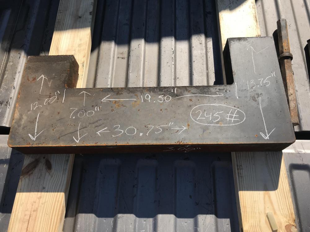

Here are the dims.
Its a little hard to see the but it’s 3” thick.
Interesting to find the material stamped in the plate when I flipped it over.
SA-387 grade 22

Chrome Molly often used for boilers and pressure vessels.

After getting home and standing it up in the driveway it is actually perfect. It’s about 1/4 shorter than my Vulcan. It must have been sitting on some crap in the yard because it felt taller than that. Also I’m getting around 60% rebound. The hole in the top is 1-1/2” but there is a broken tap inside it. I guess I can break that tap out and sleeve it with some 1” square tubbing. Any comments or suggestions?
Yes it's probably NOT a good alloy for hammers. Very low in carbon as might be expected for an alloy where LOW brittleness was mandatory!
C   0.05 - 0.15
MN 0.30 - 0.60
P  0.025
S  0.025
SI  0.50
CR 2.00- 2.50
MO 0.90 - 1.10
