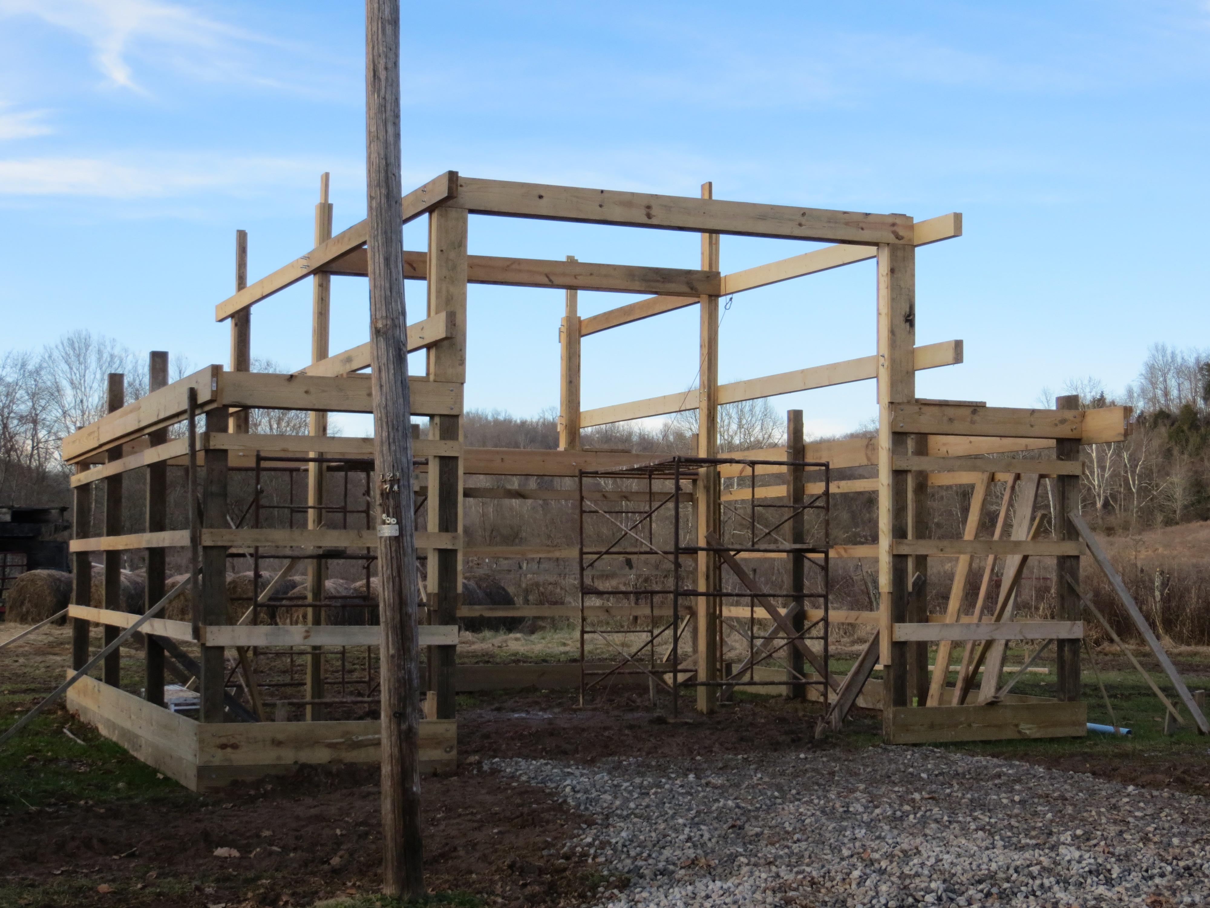

Well I have begun to build what will be my 5th shop. My current setup is in an old machinery building/ horse stall and between roof leaks, gophers and no room due to sharing space with farm equipment I have decided its time to make a dedicated structure. This new shop will still pull double duty as a mechanic shop as needed but I think I have got it planned out well enough to minimize the junk buildup. I have been sawing ash trees on my property that have been killed by the ash bore for the majority of the lumber. The posts are recycled from another pole barn that the owner wanted out of there way. I went to auctions and bought lumber I did not want to saw out. I have got the layout decided, now I just have to build the thing.121312119_Polesfornewshopset.thumb.jpg.e62c50fb2f5fa9e8feabf4c725b7730f.jpg

Great start; how are you going to floor it?  You could nail PT lumber around the perimeter and fill it with crusher fines. Having the floor above grade makes it a tad drier; though Ohio is a bit swamplike compared to out here.
I used propanel for my roof and walls on the theory the less that can catch on fire the better. (Steel purlins and trusses too). Again local environment considerations. Fire is fairly common around here---hence my house has a steel roof now too.
Current plan is to skirt it with pressure treated wood, then install board and batten I have been sawing above that. Flooring in the forge area will be crushed pea gravel, I find its easiest on my feet. The main mechanic area will be larger stone until funds allow concrete. I am planning on pouring one corner 6'x10' with concrete so I can frame it in and insulate it. I'm going to keep my mill, and future lathe in there to keep it away from all the dirt,grime and condensation. Going to add a little wall stove and window ac unit to give me a lounging spot in all seasons :D

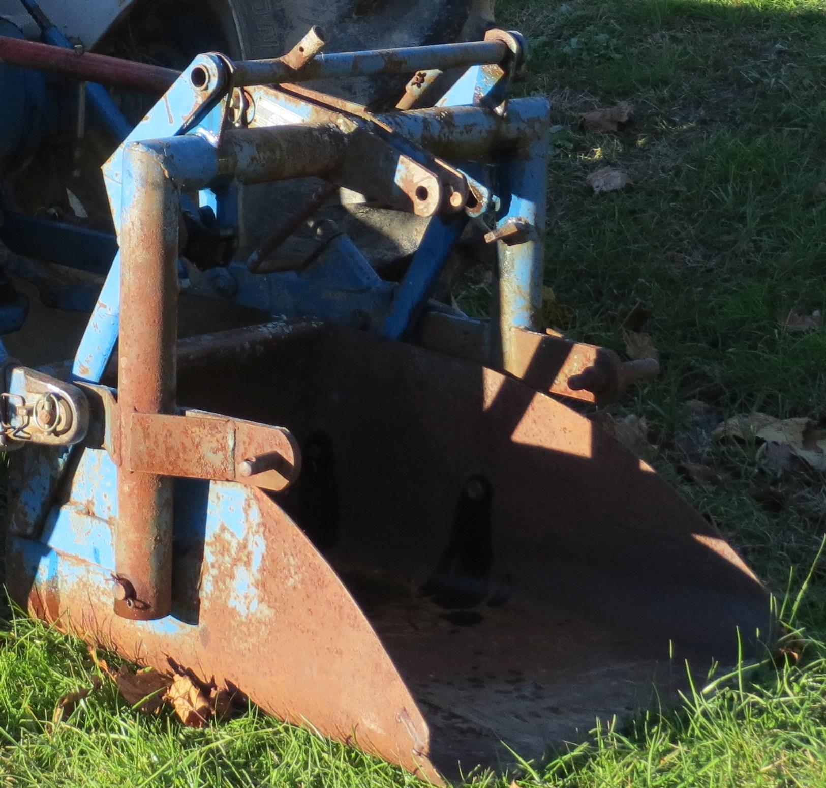

I need to correct the grade of my shop site and add some fill dirt on a low corner. I should have started with a level site but I lacked the proper equipment to move and grade the dirt. Today I went to a local sale and purchased some older Ford implements for my Ford tractor.  I purchased a scoop to move the fill dirt into position and a rotating box blade to grade it out. This should be a real upgrade from the wheelbarrow and shovel!
Remember to pack the fill material a few inches at a time, more fill material, more packing etc.
Any drainage system(s) should be installed before the fill material is added.

I have made some progress between the rain showers we have had. All the perimeter girts are now done. I decided to extend the door height to 12 feet. My posts were to short so I pinned and boxed in a stub of 6x6 to gain the height I need for the taller door.  Today I made two laminated 4"x 8"  posts. I'm going to set these in the center section with steel across the span to lift items off my truck in the future.

I've made some progress between the rain showers. I have all the girts bolted on now. I notched out the last of the beams today for bolting but the rain got me in the end before I could set the cross braces. Oh well, it looks like we should have one day without rain this weekend. If the weather cooperates i'm going to set rafters.
