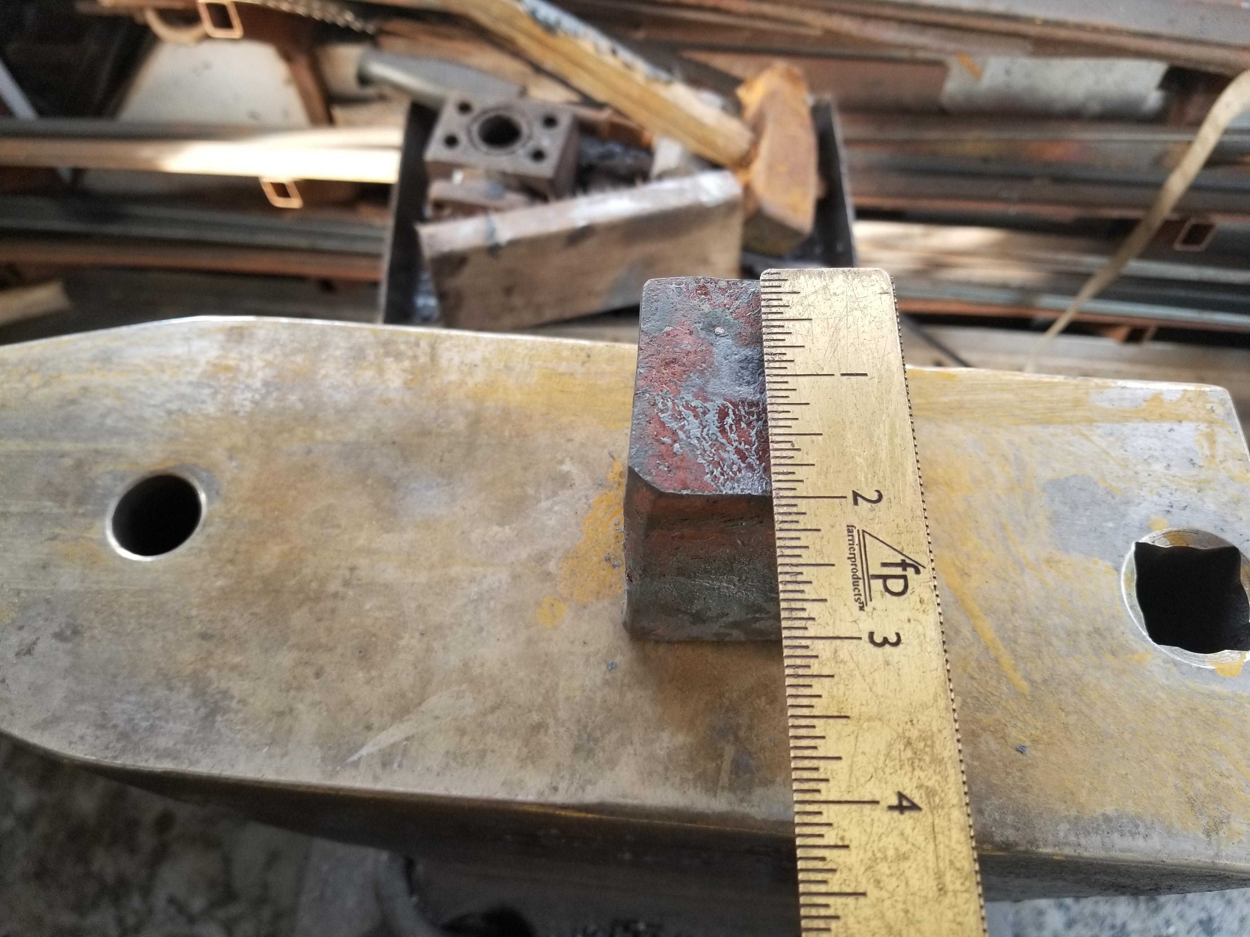

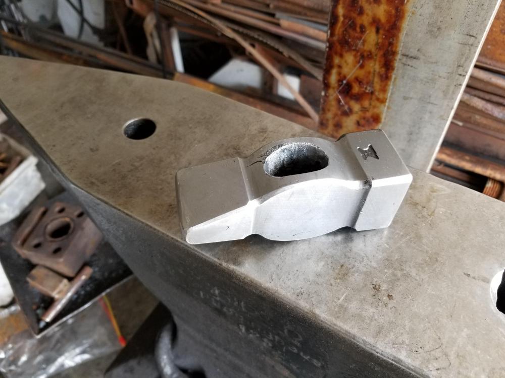

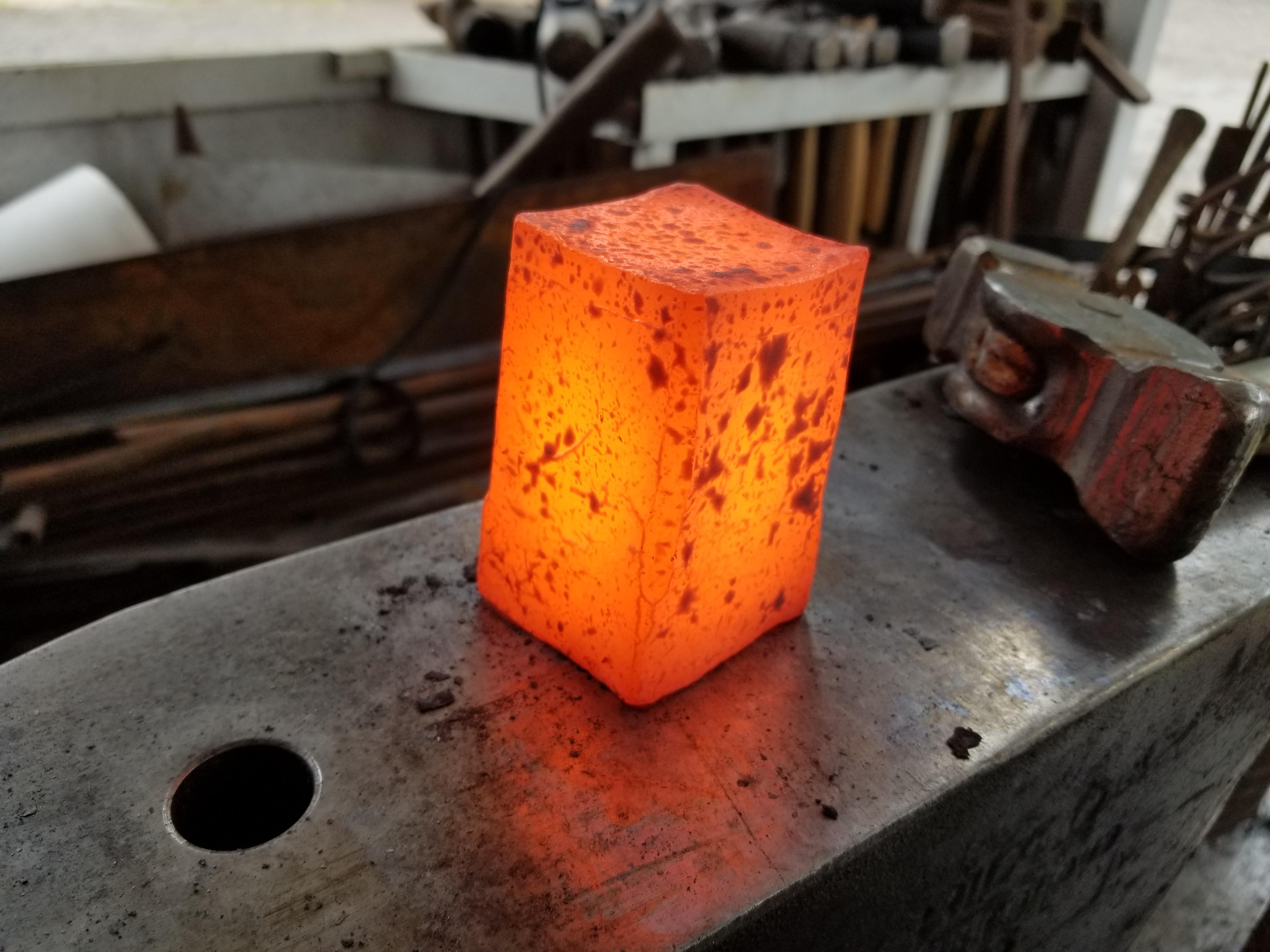

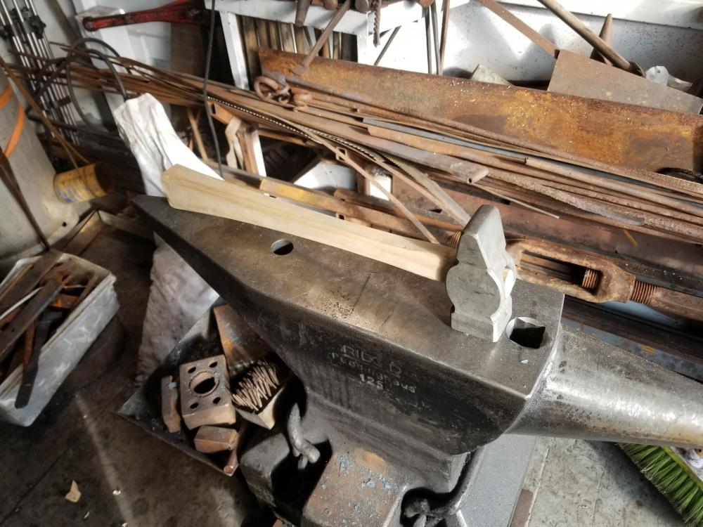

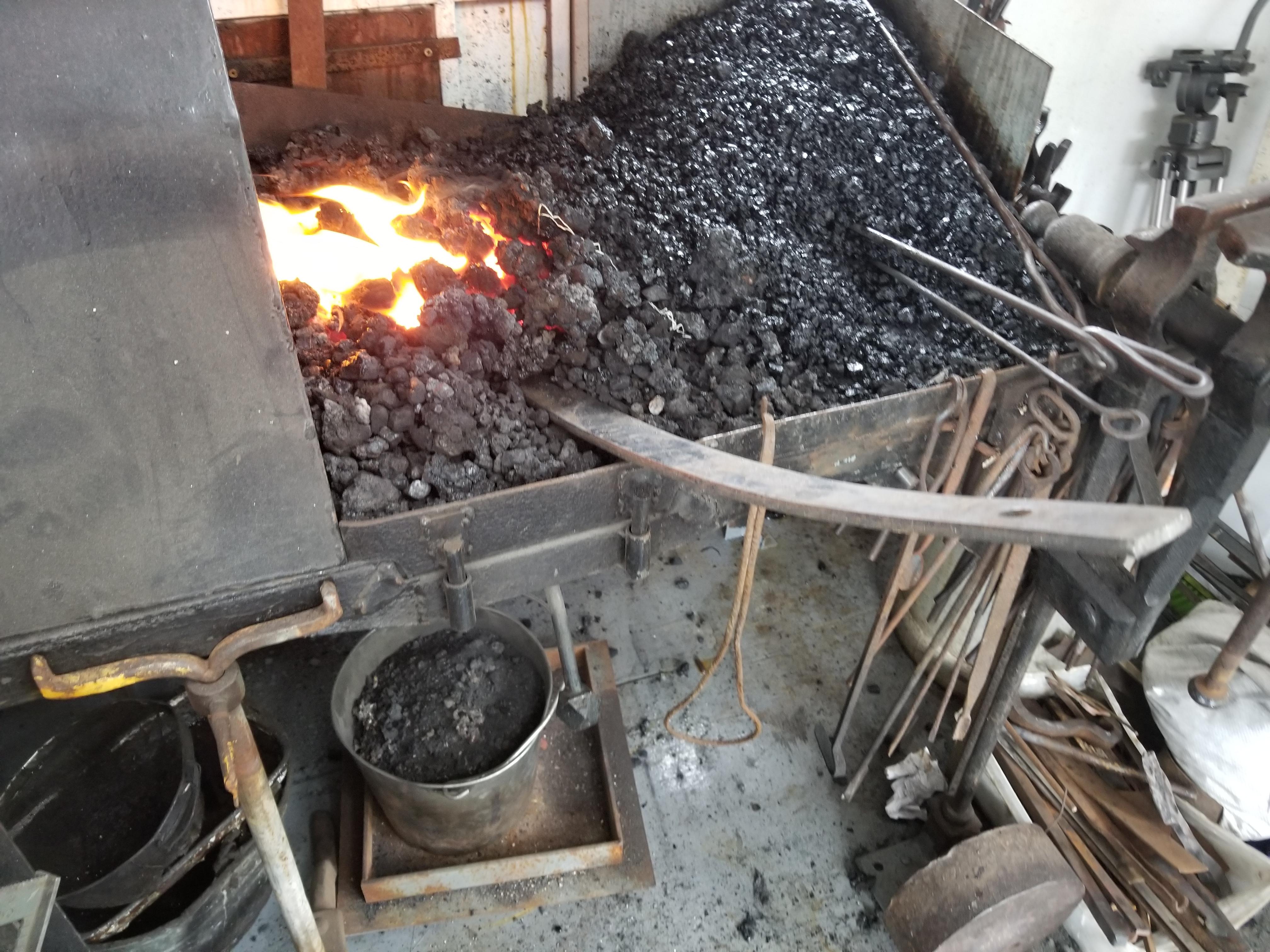

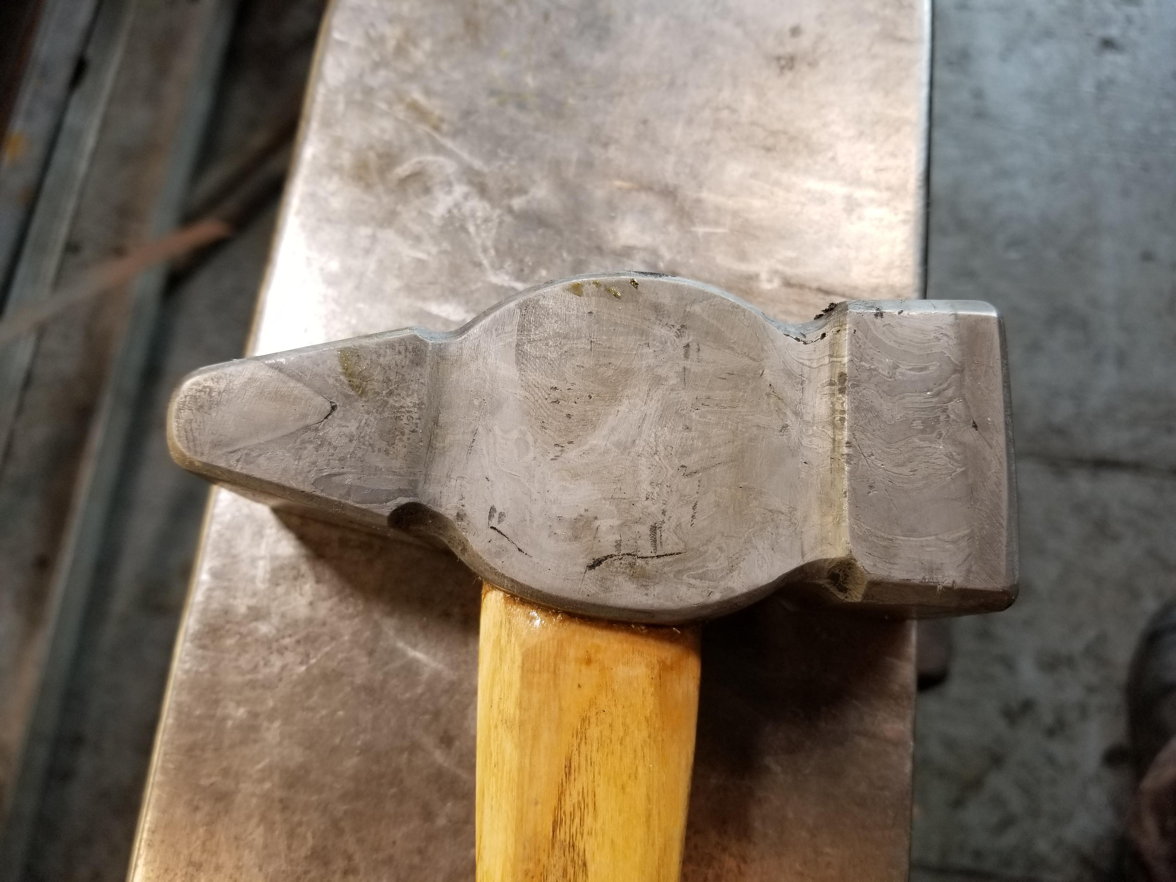

This past week I spent some time at Fair demo's..   I foolishly suggested that with some help from a fellow smith (Joe L.) that I'd like to make a wrought iron hammer from some wrought iron he gave me from the Longfellow bridge in Boston when they did the refit..
He smiled and said " Sure"..

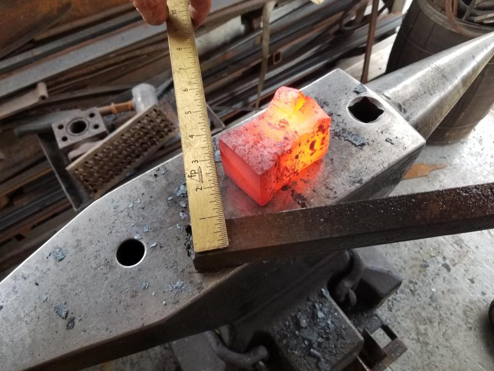

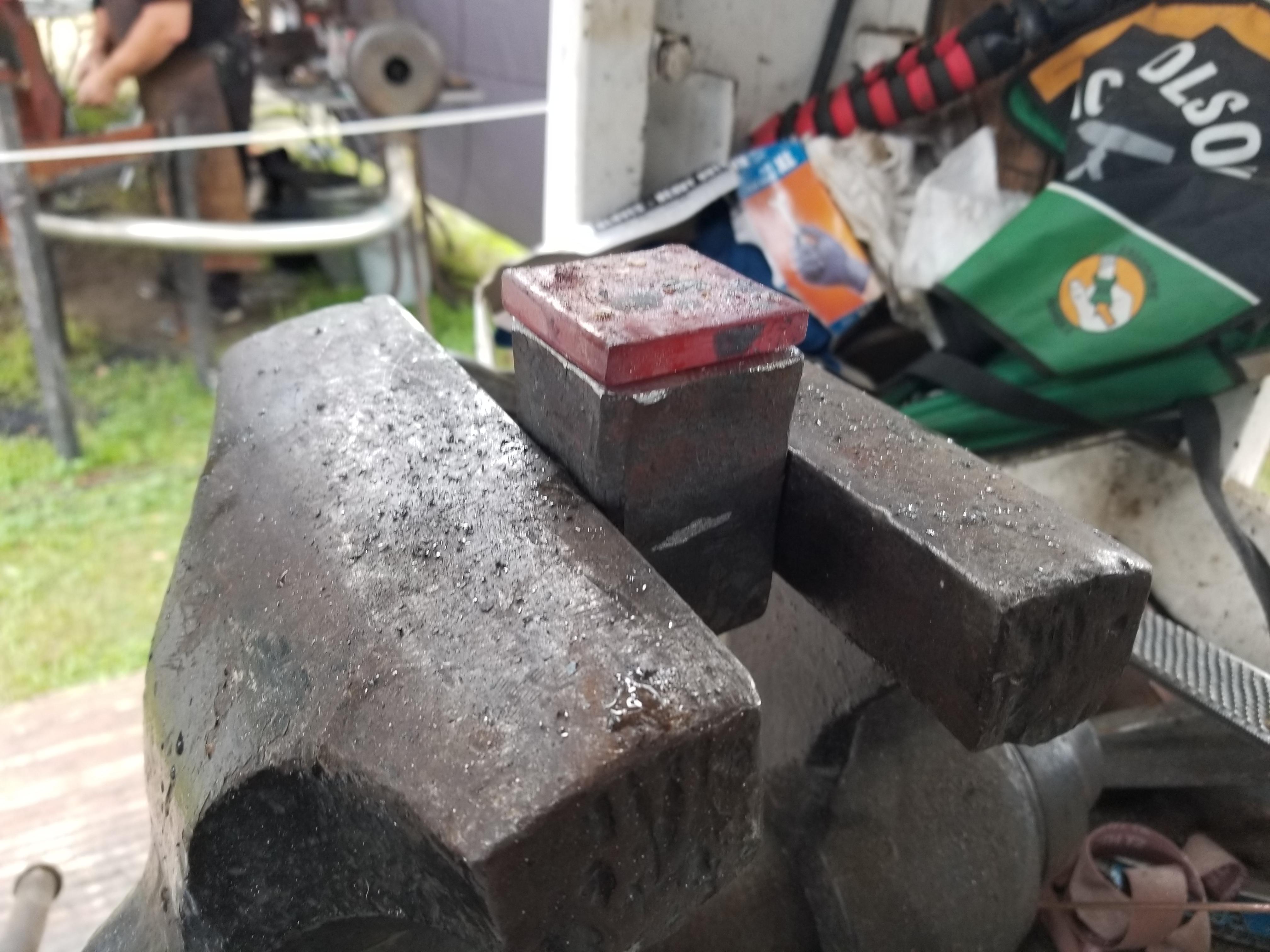

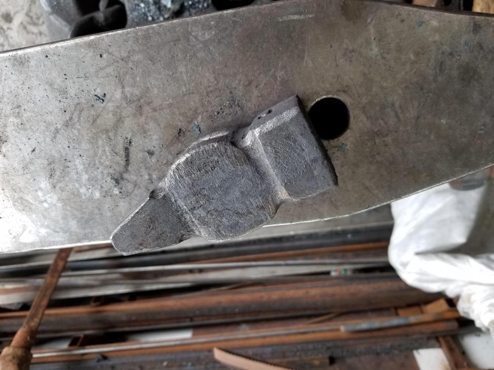

Anyhow, it was 1.125 and we upset about 12" of it to get to the desired size..  I then welded on a 5160 face and a 5160 peen as it was the only material I had handy for the job..
There were some legistist problems like not having the right tongs, and not having a fuller, then making a fuller and thinking it was made from mild steel but it was made from W1 and broke when quenched in water.. Making due with 1/2 the fuller..

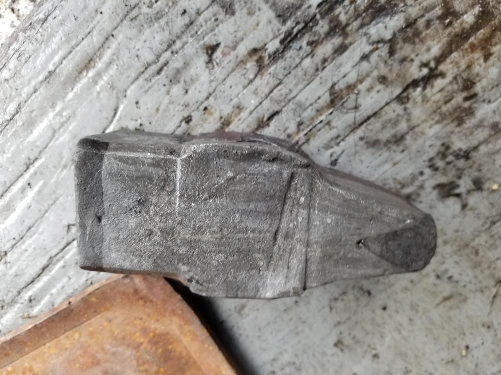

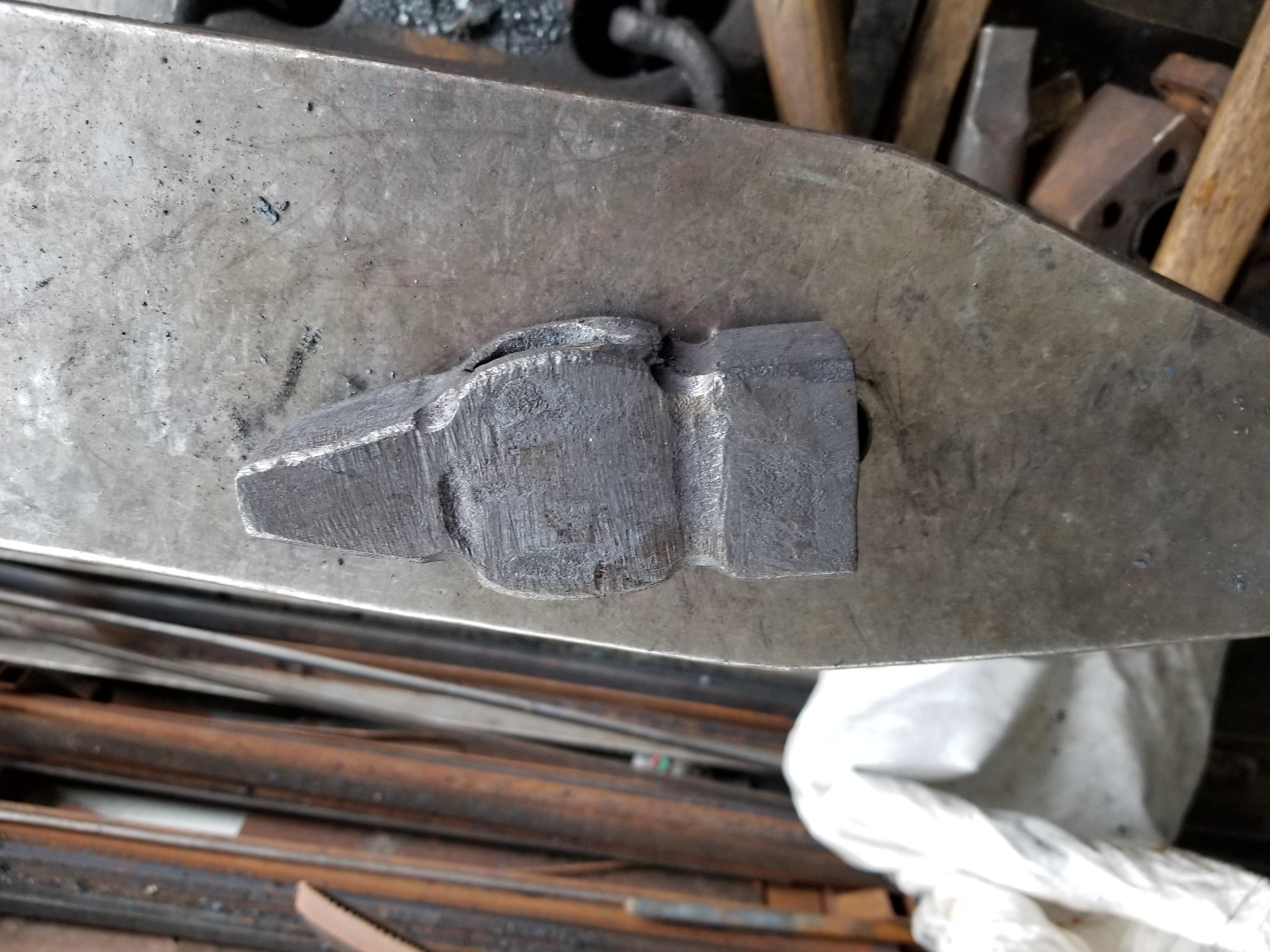

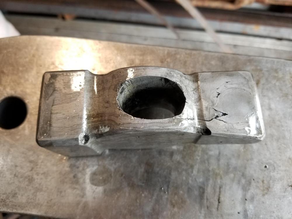

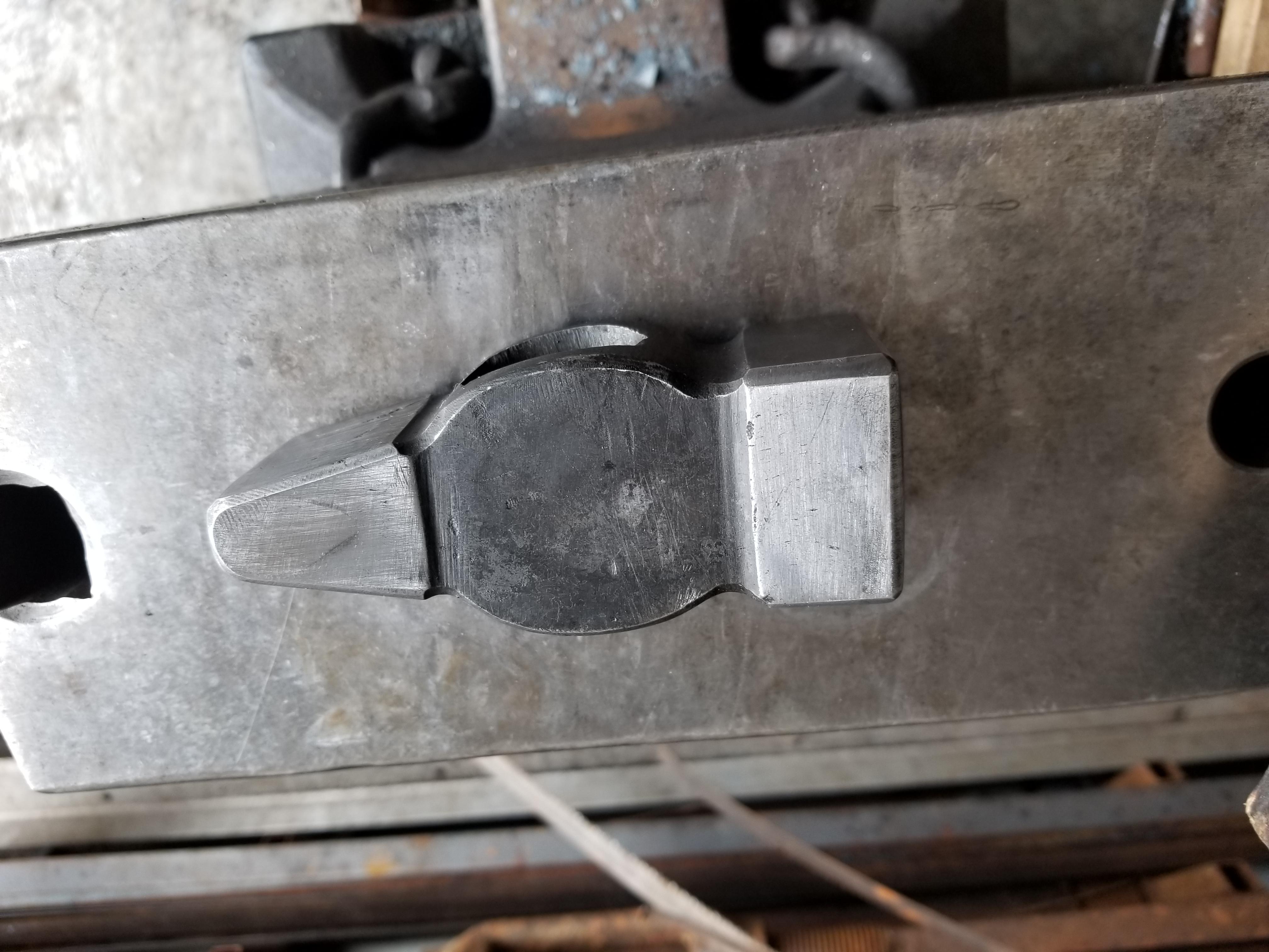

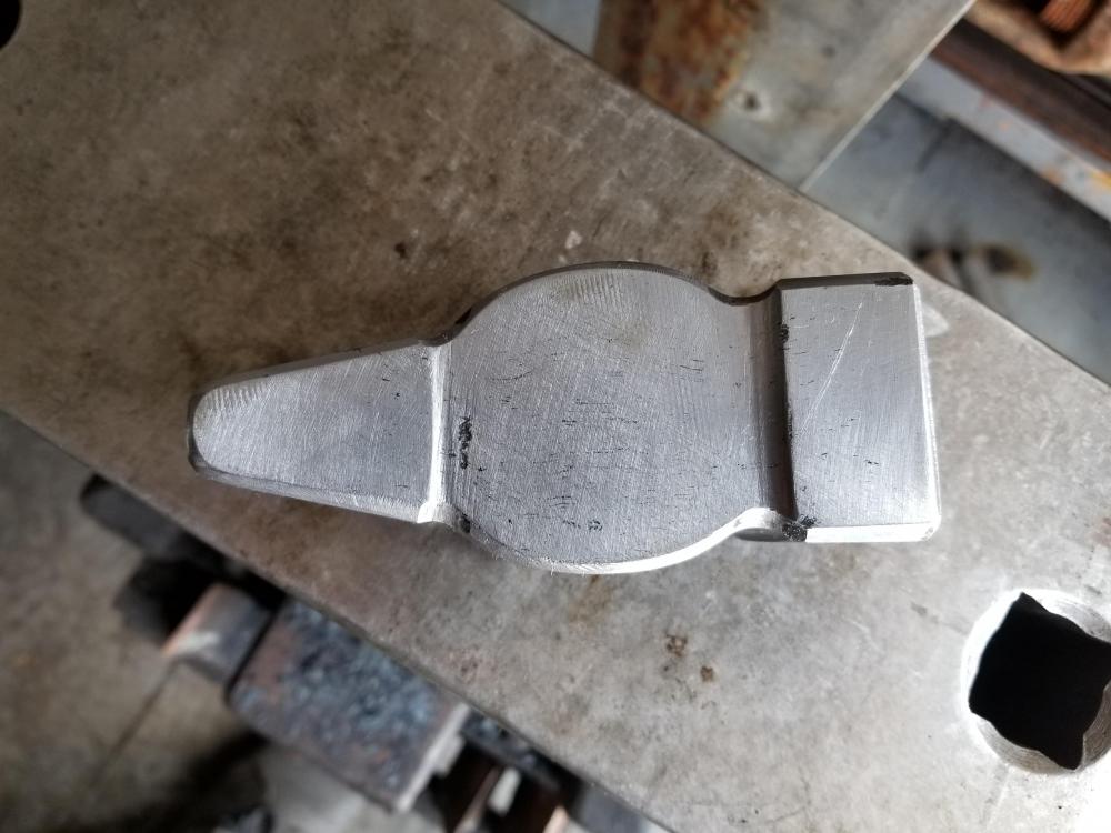

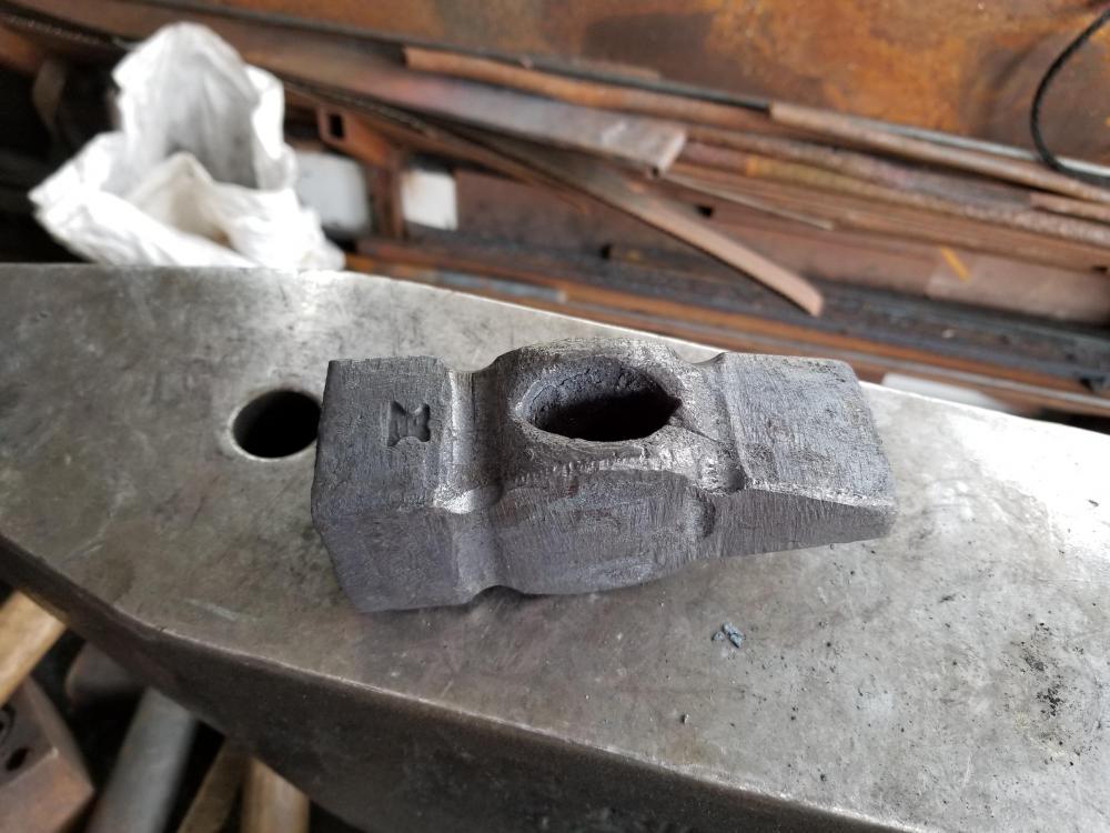

Few more pics of progress.. This is the hammer filed and ready for hardening..
Thnks Anvil.. it's a take away from the information we talked sbout..
Stevomiller it was pretty tough go at some points using only the tools stocked in the trailer...
The fuller snapping and having a striker that was unskilled (first time) made for a very interesting demo to say the least...

Arkie,  Thanks, now if it will stay together for hardening, I will be super stoked..  it is cool how the grain showed up even filed.. It will look really nice when hardened and acid etched..

The forging of this hammer really was a shot in the dark as I really didn't have any tools for doing a good job in the trailer.. Again it's a demo trailer so to take on a project of this magnitude with very few tools just makes one push their skill set to the max..
In the shop with the right tongs and such splitting really isn't much of a problem..

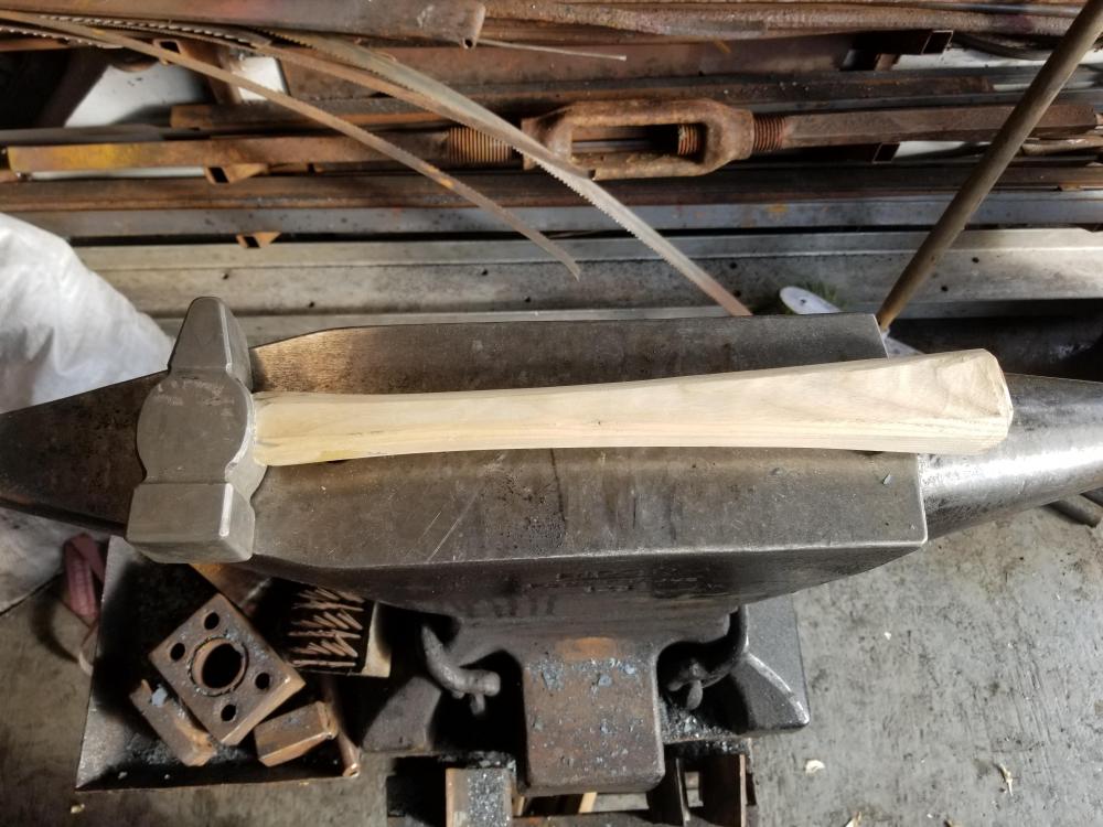

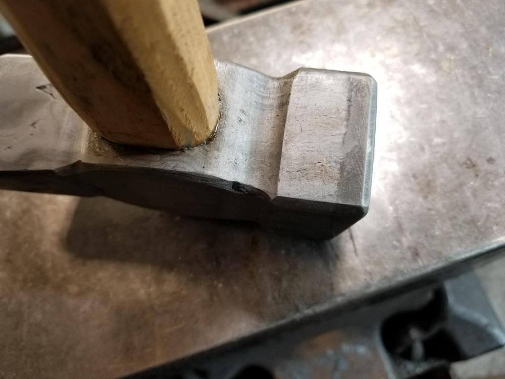

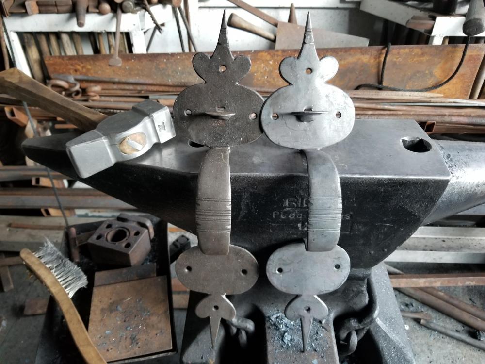

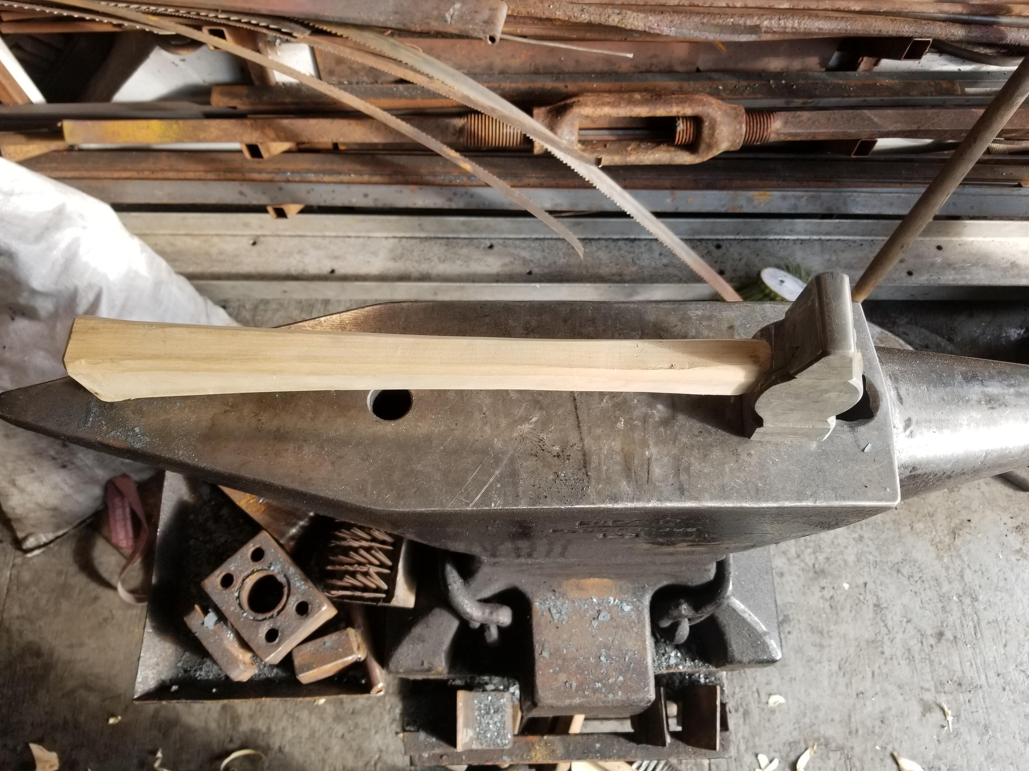

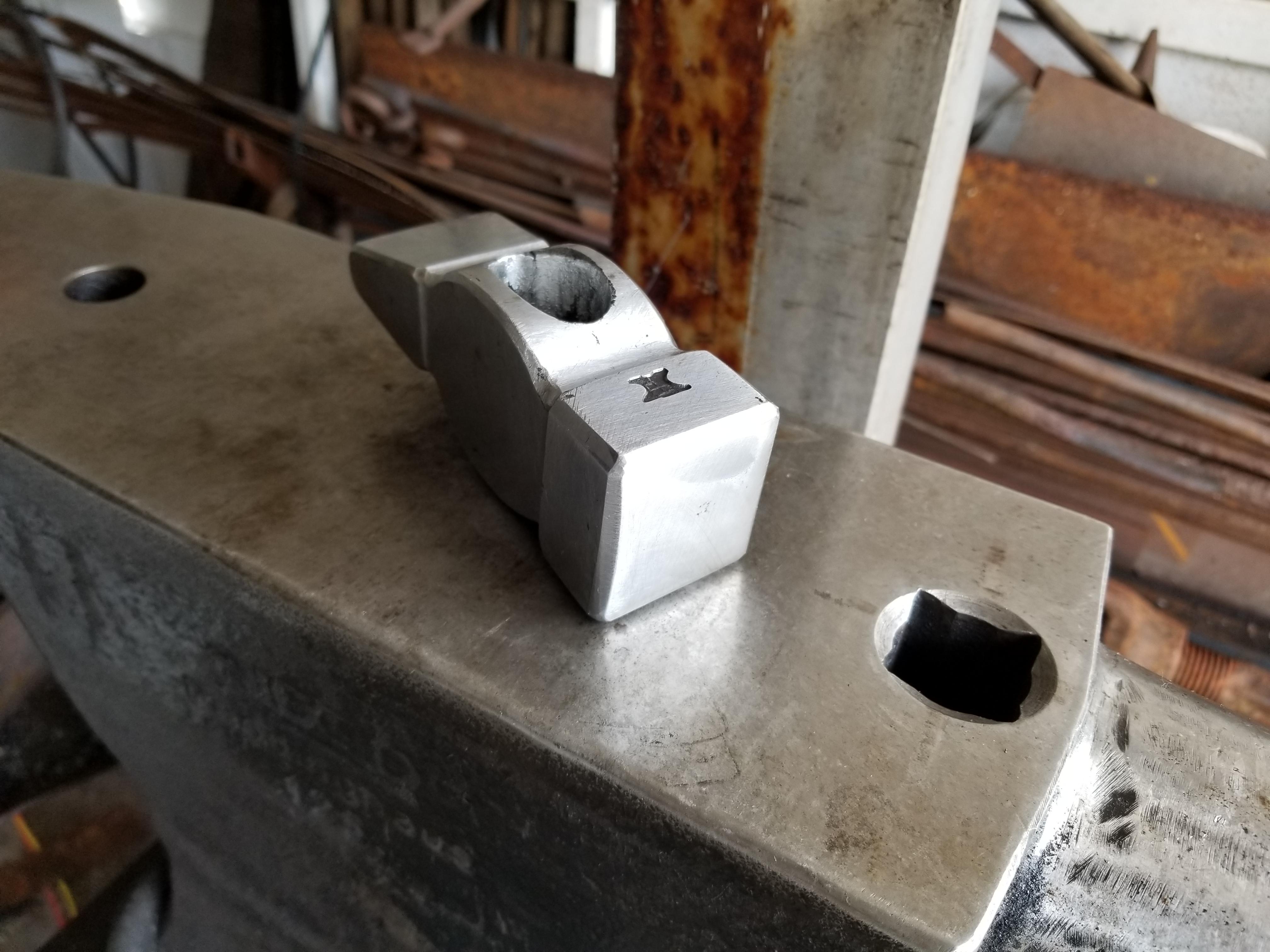

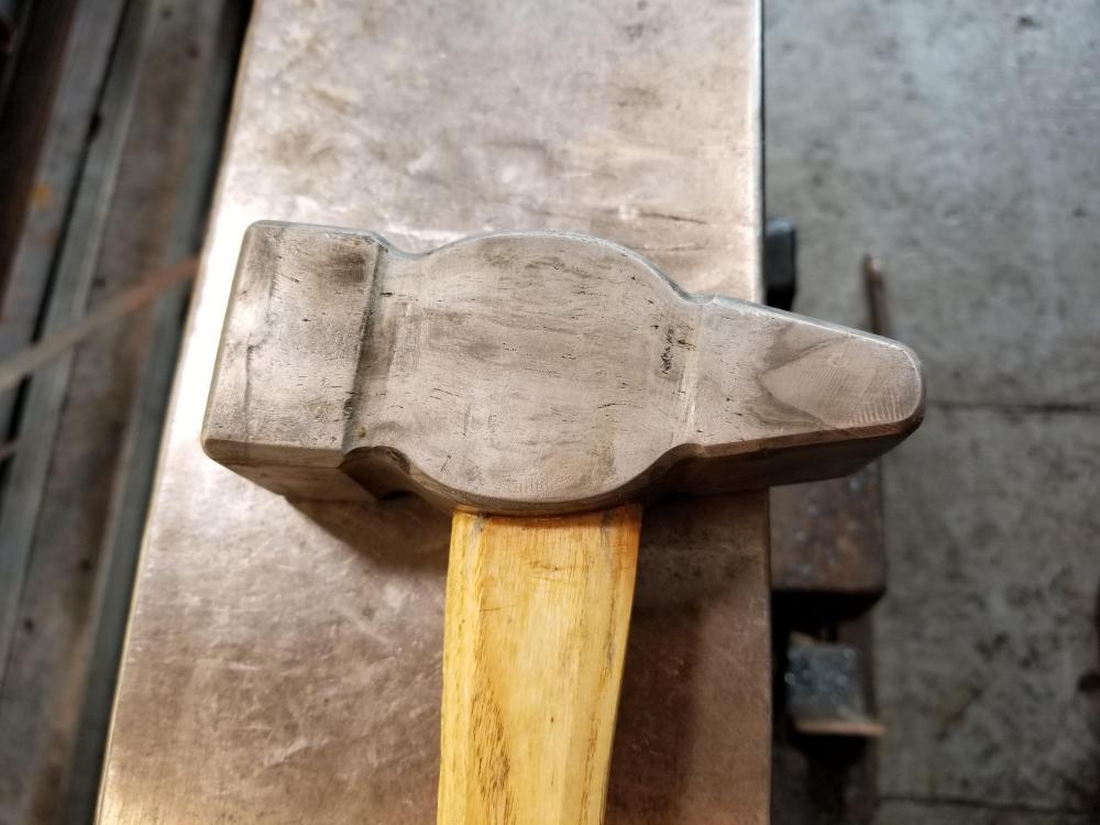

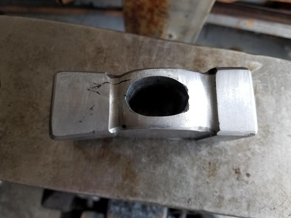

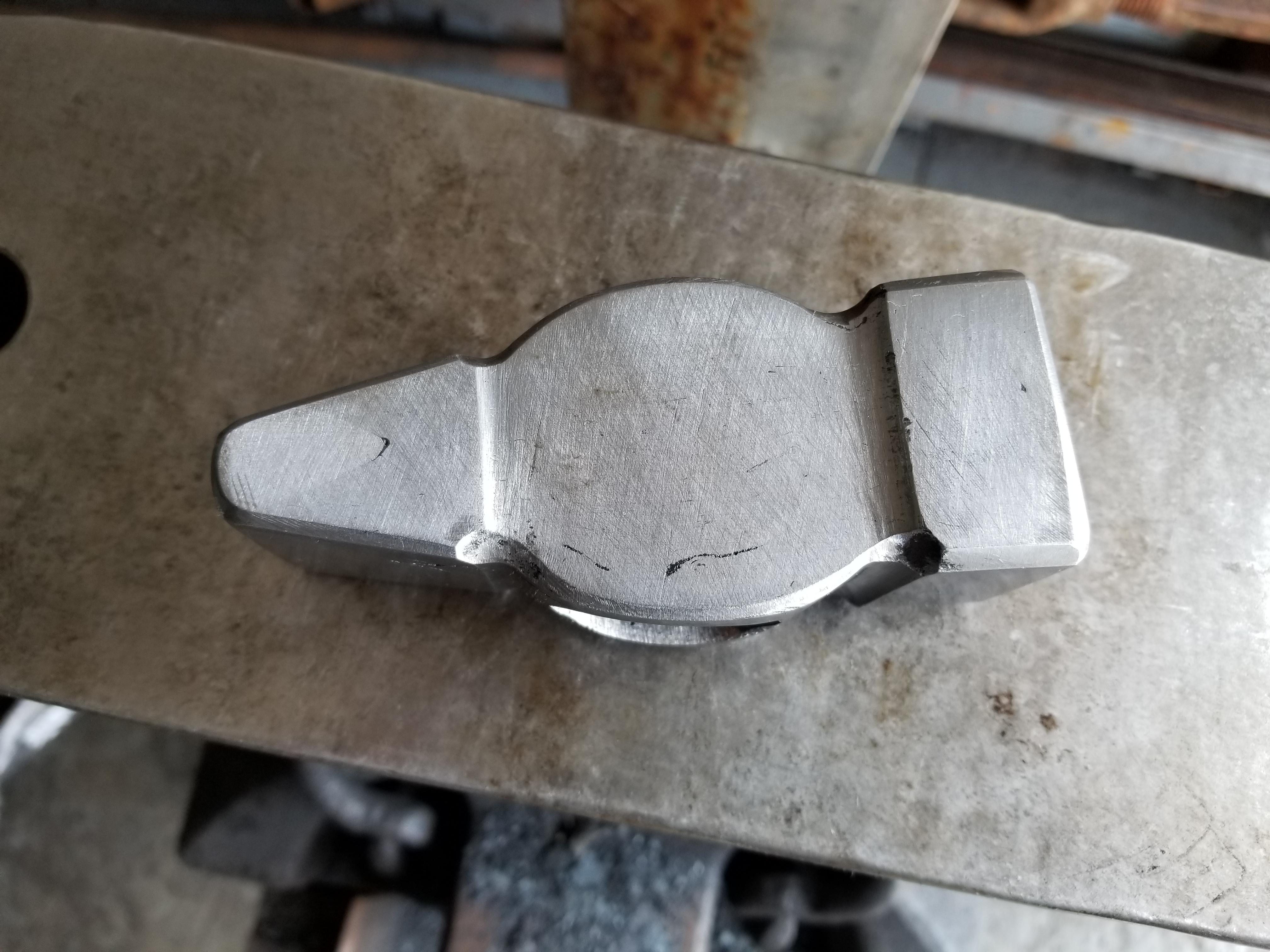

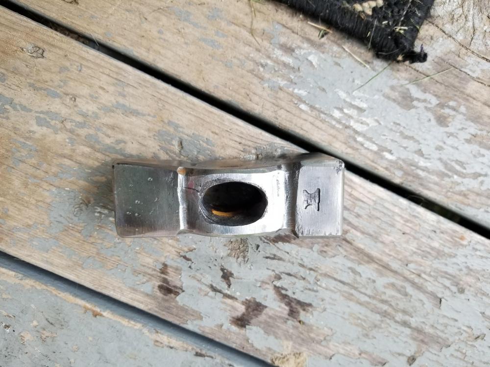

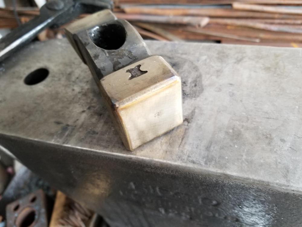

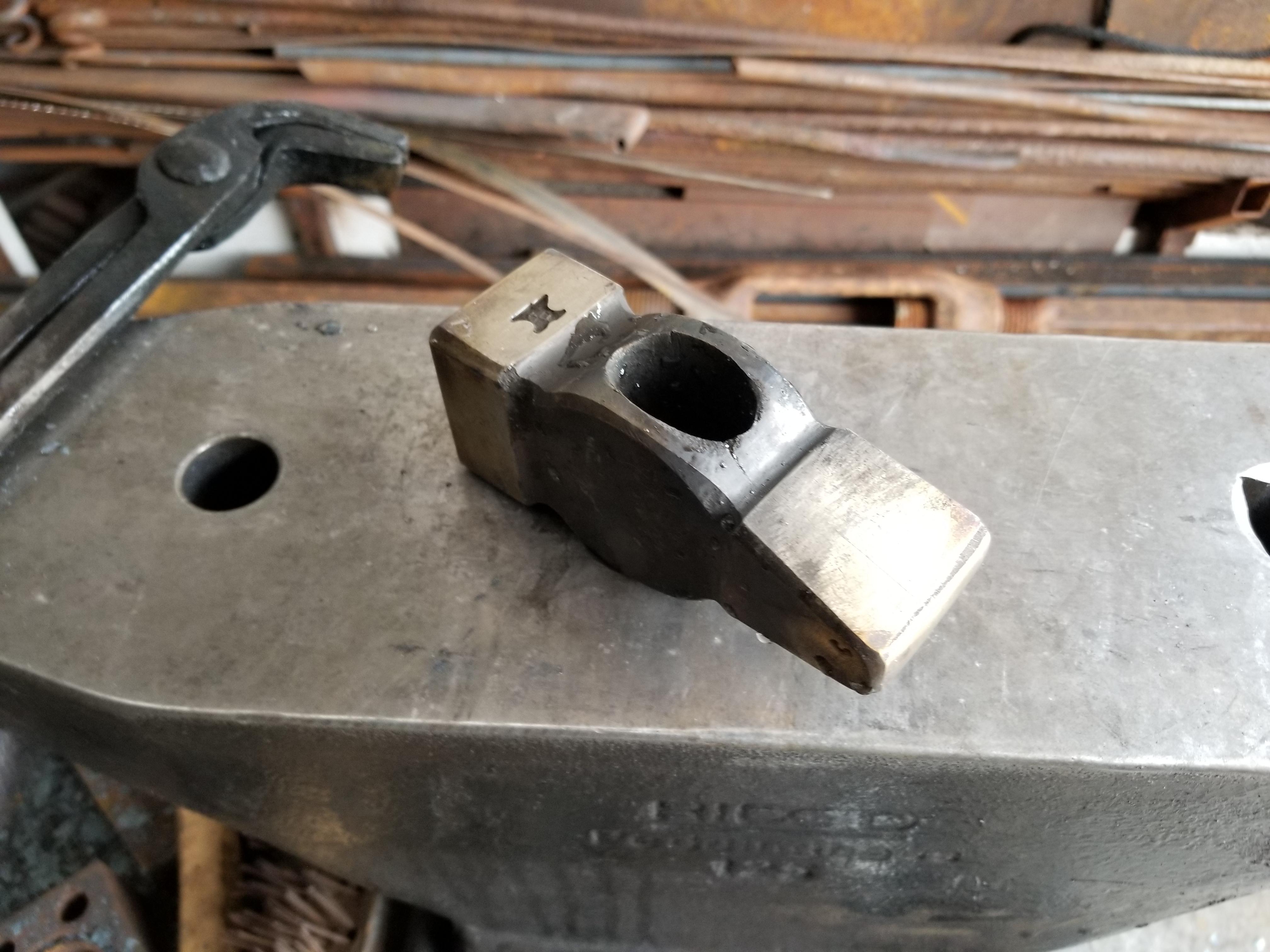

Ok, so the hammer is finished..
Pictures are of stages..  Cleaned after hardening, tempered,  broken fuller,  1st acid bath,  handled..
I usually harden in water but since this was 5160 I dragged out the trans oil..  Not wanting to take the risk..    I did do a hardness test with a sliver I cut off the 5160 and it hardened in water at a very low temp and was perfect..   While it took a slightly higher temp in oil to get the hardness to set in..  It took 2 attempts at hardening..  second time was a charm..

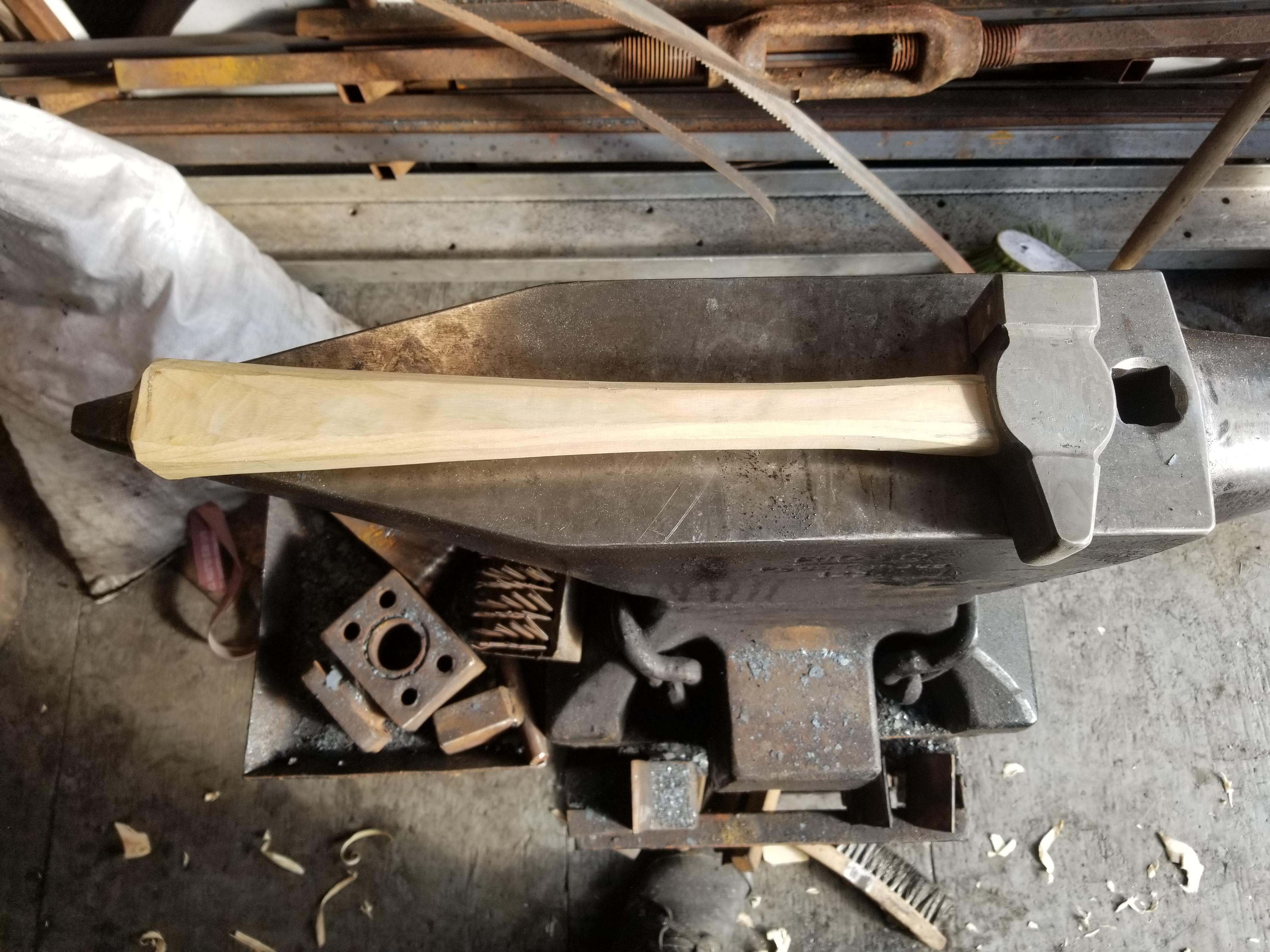

The handle is hickory from Indiana..  It was sent to me by a great guy from another forum I am on.. He sent me 2 slabs he cut out of a tree..
This hammer is truly hand made with no electric or modern tools used..  I did use some epoxy for the eye and wedges..  but even the steel and wood wedge was made in house.
I weighed it and get 2.75lbs and 3lbs with handle..
It was radius tempered..

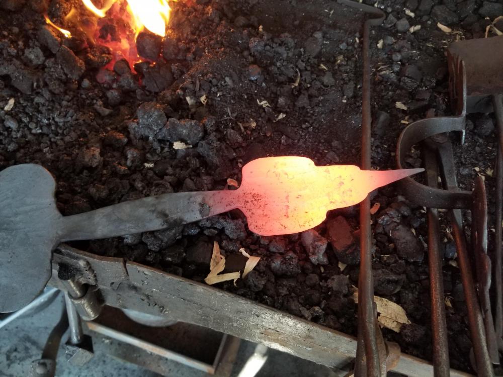

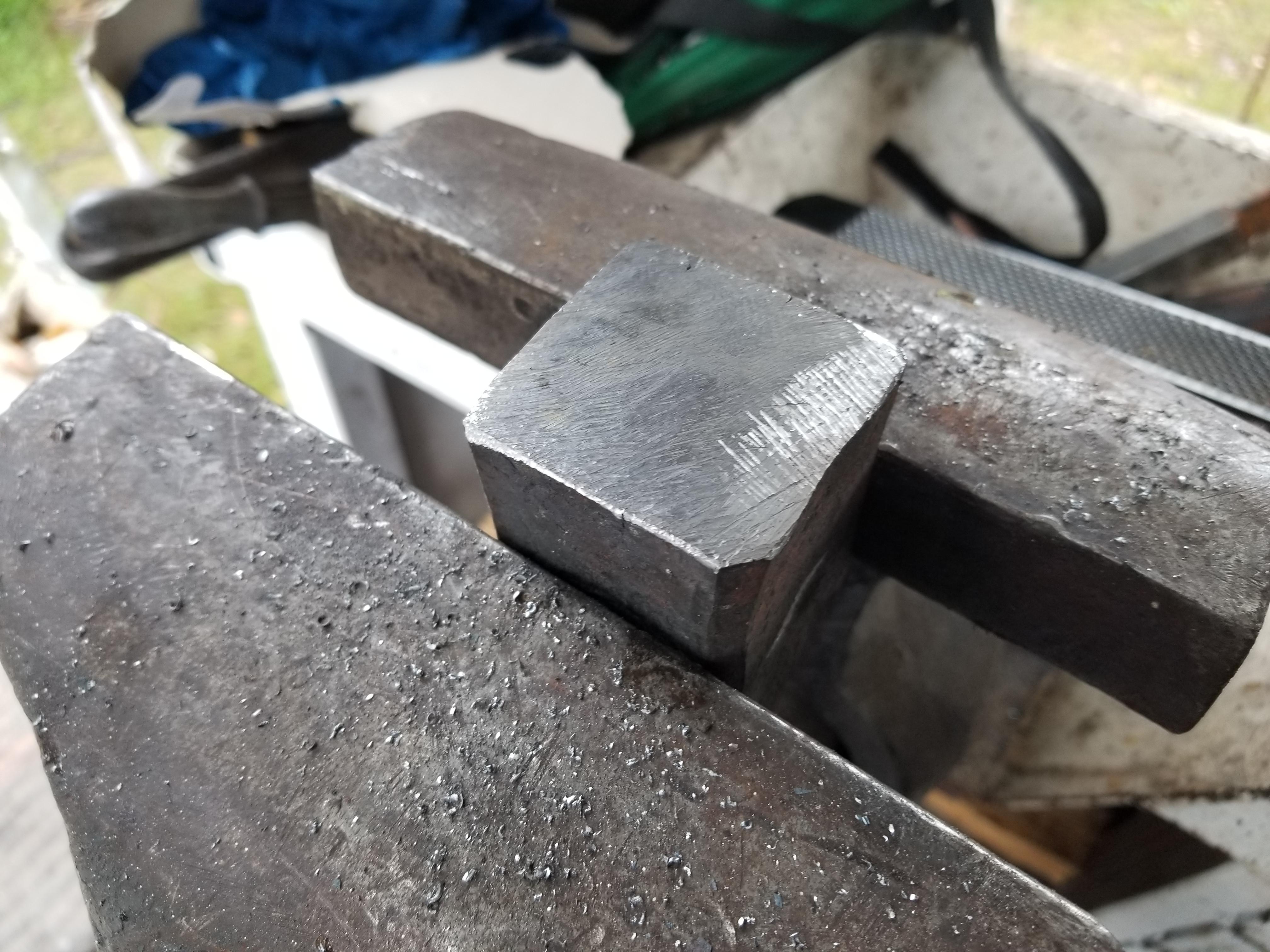

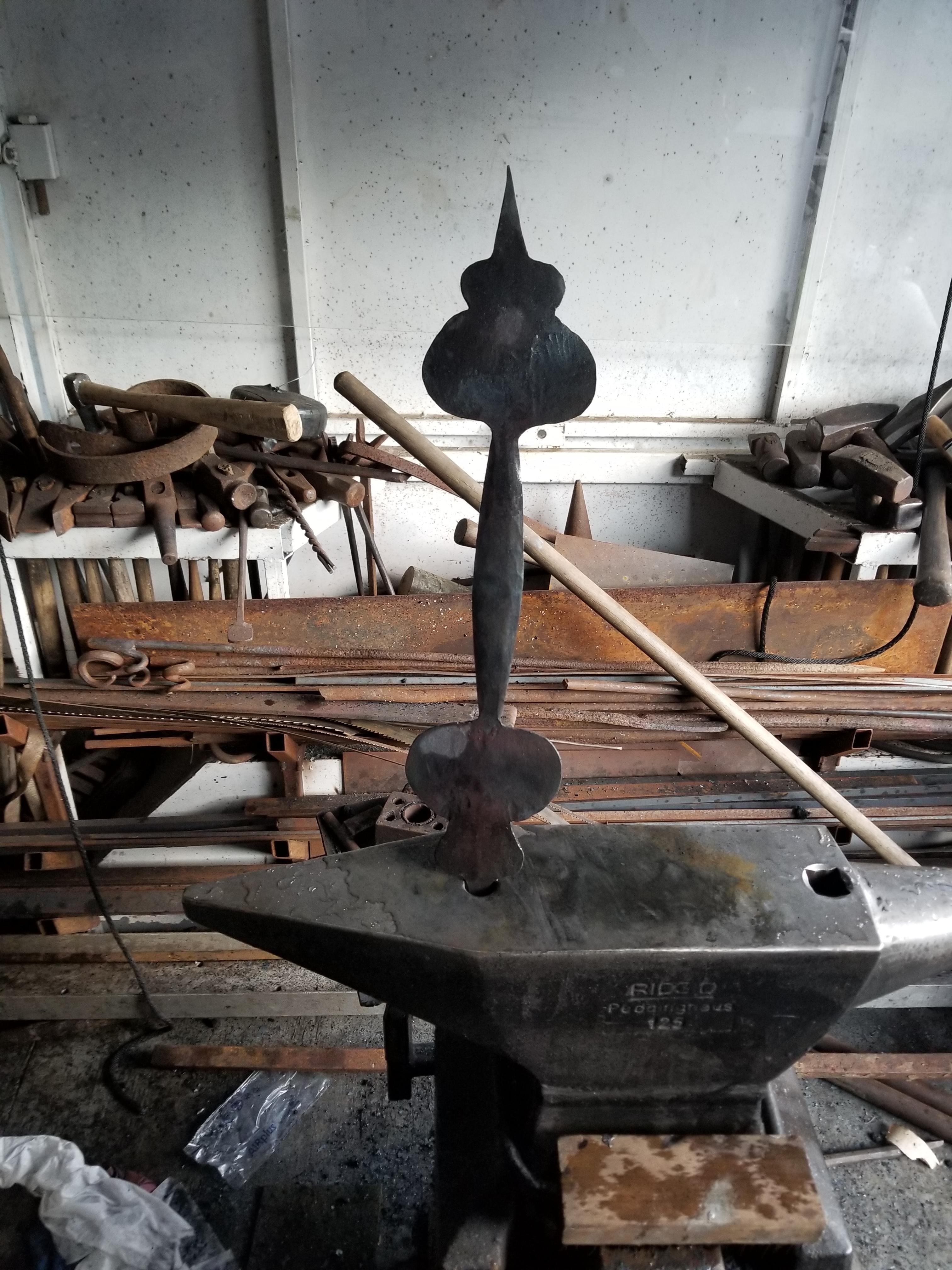

Today I ran the hammer through it's paces for about 3hrs and change..  Few things.. the face is a little softer than I'd like.. most would consider it perfect but I like a hard hammer face..
it's hard and a file will skate it, but it still shows some wear..  Other change would be just a slightly larger radius in the faces edges the face is to flat for working uneven items like when working a latch of this type..
Otherwise it's pretty sweet with no hot spots in the hand after the 3+ hrs of heavy use..
In other words I'm a happy camper..

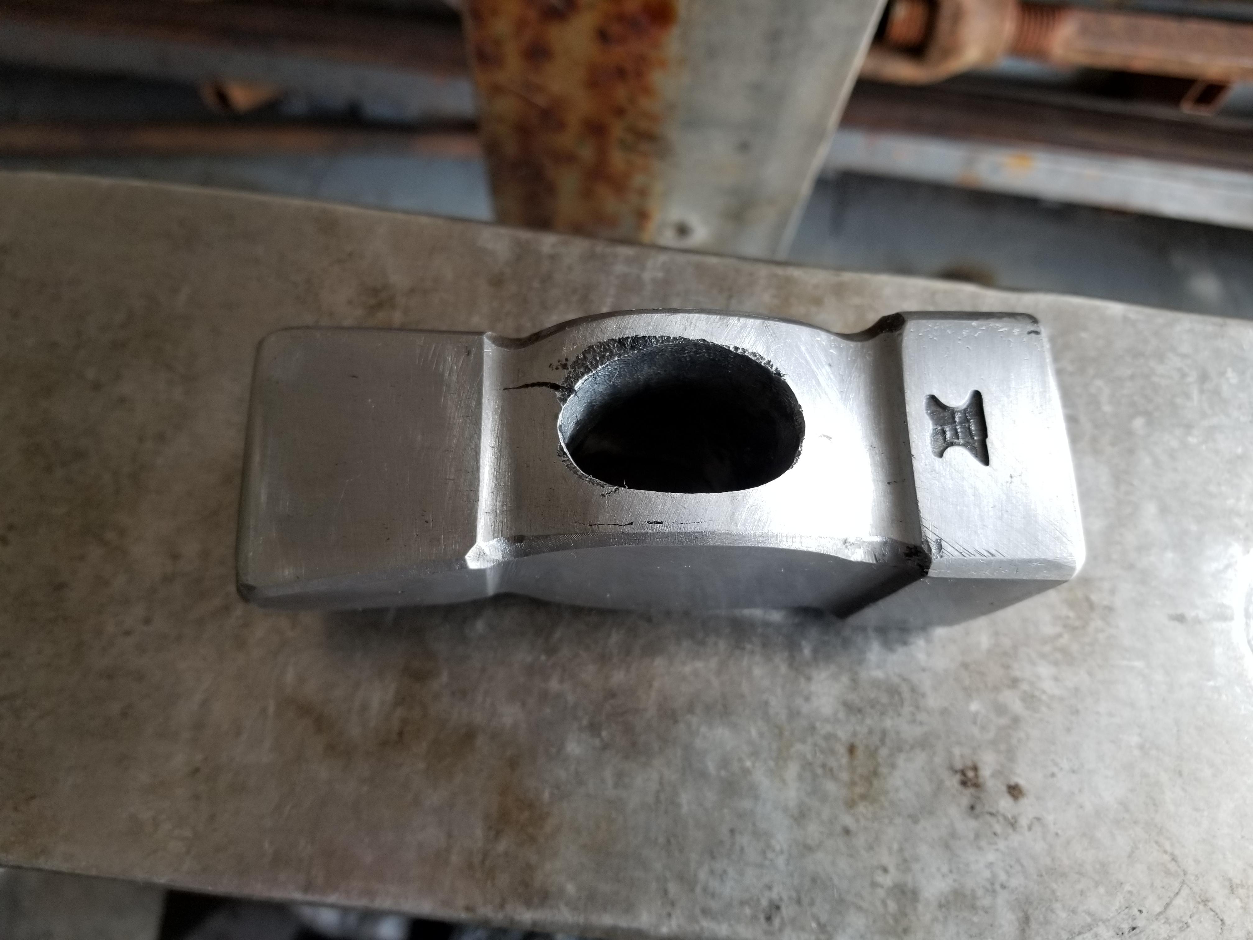

5 hours ago, 1forgeur said:
Pics of the face?
Here you go.. it's hard to tell from these pictures the radius..  Really it's nearly flat with maybe only 1 or 2 degrees radius with the very center of the hammer being flat about 3/4" sq..
