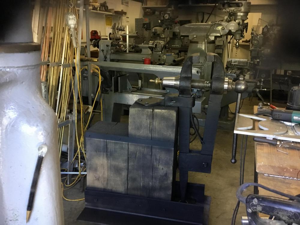

July 13, 20188 yr Well guys, I hit the xxxxxx jackpot. I couldn't bring myself to just post it on the "it followed me home" I had t take it a step further. Was at a ranch a guy was selling and I saw this sitting outside next to some trash. he said he was in the process of cleaning up and getting rid of stuff. $50 later and a sore back getting it out of the trunk, I got this gem home. over a meter in length and 17cm wide jaws (7"?) and the thing weighs over 100# Since it is so tall I think that I will just make a simple base on the floor (maybe some 1/2' flat stock with a hole to accommodate the foot?) to keep it off the ground and then anchor as usual to a bench. Any mounting suggestions welcome. Cheers. Edited July 14, 20188 yr by Mod34 Inappropriate language

July 20, 20188 yr Author There is no need to quote what we all just read. That is a gorgeous stand you made up for that big-boy. And BIG it is! I will probably pattern my stand after yours. Cheers. Edited August 13, 20187 yr by Mod34 Excessive quoting
July 20, 20188 yr The problem was it was front heavy, and it weighs 300 plus lbs, once it started to go it’s imposible to stop . I’m looking to find a 400 pound anvil for the back end, I’ll never use it but it will look good. This pic shows my place for anvil.

July 20, 20188 yr That's a beautiful vise but that's not what it's for. Unless you're really tall, say in the 7' range it's too high. That vise is for beating on with sledge hammers and should be MUCH lower. Even drilling a hole in the floor to receive the leg it would be too high for me to make proper use of it. It also needs plenty of clear space around it to swing a double jack hammer. (That's two handed in old man speak) Where you have it set now would be right for a bench anvil but that old beauty isn't made for file work, it's built to laugh at your biggest hammer and hardest swing. The anvil vise is pretty cool. Put it on a spread foot and it'll be plenty stable. Cut it from flat plate so you can stand on it without tripping over the structural shapes in the foot it's mounted in now. Id just cut a piece of plate that extends say 30 cm. wider and longer, bolt it to the existing foot and put it to work. If the plate's edge trip you bevel them. Beautiful set up you have. I drool at the thought of a 300 lb. Soderfors anvil, almost makes moving to Sweden sound like a good idea. Frosty The Lucky.
July 20, 20188 yr Author There is no need to quote what we all just read. Thanks Frosty! I like the simple plate and lower height idea a lot. There is that slight knob at the end of the foot of the vise which then goes up to some shoulders about an inch above. Is it meant that the "shoulders" support the complete weight of the vise? If so, maybe just cut the correct size hole into the plate on the floor to accommodate the knob at the end of the foot and call it a day? This would bring the height of the jaws to just about knuckle level. What do think? \Cheers! Edited August 13, 20187 yr by Mod34 Excessive quoting

August 13, 20187 yr aaamax" The pin sticking out of the bottom of the knob on the leg is intended to socket into the floor, mount, something solid. The knob distributes the force of heavy blows so the pin doesn't have to take it all. Alexx: SWEET vise and nice stand if the upright flange of the angle iron base isn't a trip hazard. Frosty The Lucky.
