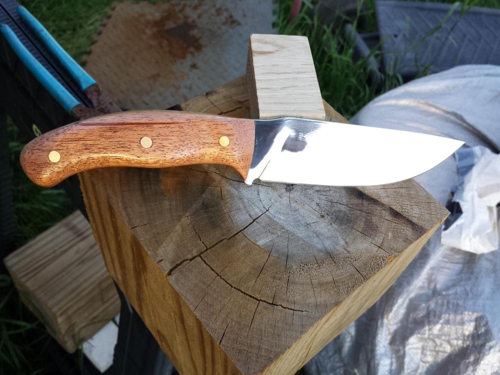

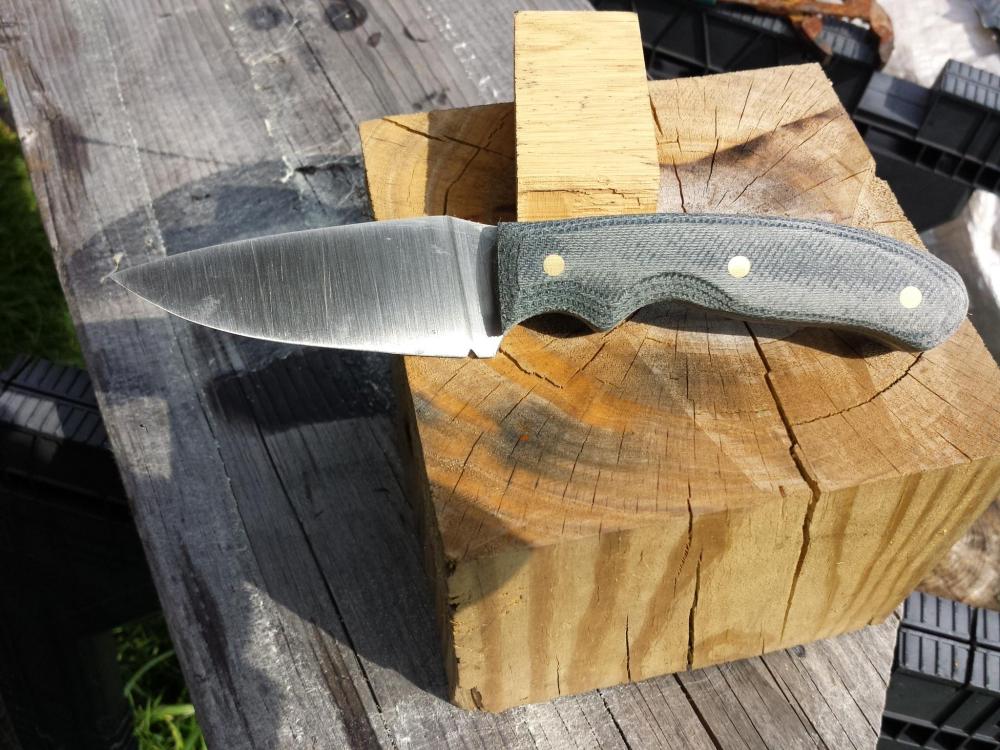

I've been commenting and critiquing others, so I figured it was only fair to post some of my own work for you guys to have a go at.
I'm still less than 20 knives at this point in time and actually less than a year with a forge. These are the latest ones, I actually just finished both of them. Well... The one with the micarta (my first ever attempt at making micarta) needs a final finish on the scales and sharpened, but here they are for you guys to pick apart and tell me what I can do better.
Look great to me.  The scratch peepers May come along and demand you hand sand for five hours, but I think they are really pleasing looking.  The first one looks to be integral....not sure because of the glare.  If so, well done!  I really like the look of the second one.  It whispers, “cut things” in my ear.

Thank you Lou. Yes, I need to work on my finishing. No arguments there at all. The second one is just a scotchbrite belt finish after a 220 belt. I still ended up with a few random oddball scratches though.
The first one doesn't actually have a guard, it is just the plunge line. They are both full tang and "V" ground.
Hard to tell, what You can do better, because the critiques that I maybe have are all about taste and personal preferences.....I like the knife with the wood handle much more because it is not so Spyderco-like as the other one and has a more beautiful blade shape......but as I said, very personal.
What is most important to me are the edges of both blades....both knives have very nice edges and very accurate points....very well made!

Well, I've never forged a knife so my critique is based on next to no knowledge.  They are great looking knives.  I prefer the second one, and as it has been mentioned it is sort of spydercoish.  Or as I say, cop knife.  Looks good. the Micarta looks quite toothy.  can you tell about how it is made?  If I had a criticism, it would be that to my eye, if the leading edge of the scales paralleled the plunge line, it would just seem more in place.  but it is an aesthetic opinion.  It's a sweet knife. as is the other.
Thanks Mike! Now that you say that, I agree. It Does throw the aesthetics of a little with those lines being different doesn't it.
As far as how the micarta was made, I made a "box" out of plywood. A bottom and 3 sides. Then I lined it with wax paper. I had 6x6 inch squares of old denim cut and I placed one in the box, then soaked it down with fiberglass resin. Add another piece and soak it. Kept repeating until I got just a bit thicker than my desired finished piece. I then put another piece of wax paper on the top, and another piece of plywood and snugly clamped it to hold it in place until the resin cured.
After it cured, I trimmed the edges and cut it in half to make it into a pair.
If you like the look and feel of the blue jean micarta as you have it then ignore the next part.  If you want to give that micarta a little more of a glossy/smooth appearance and feel, you can sand it with relatively fine grit.  On the top layer that will bring out the blue jean pattern a bit more, but it will make the handle a little more slick/slippery in the hand.  Again, it's a preference thing and nothing wrong with what you have.  Always test on a scrap piece before trying it on a finished handle though.

I think they are good, but if you want the nitpick issues, I'll give them to you :)
The pin placement on the wood handled one looks a bit off.  I think the center pin needs to be a bit higher.  Sometimes you have to space the pins unevenly to make them look right after the handle is shaped.
The plunge line for the second one appears to run up to the spine.  High grinds are good, (ie no noob grinds)  but it is a pet peeve of mine to see a plunge line if I am looking straight down at the top of the spine.
It looks like the plunge on the first one has been washed out by buffing, but that may be caused by poor lighting in the pic.  Nice crisp grind lines are a must for me.
I'm not sure I like the triangular notch in the second one.  Stress risers like that make my skin crawl because I am an engineer by trade.  To be fair, however, someone would have to be doing something pretty abusive to cause it to break so it is more of a personal thing to me.

It does on that side (I did get a little heavy on that grind) but is not really visible on the spine. I know what you are saying though and will make sure to watch that in the future. The other side is good and the other knife is good, so it is definitely something I need to watch on my consistency.
It is. My thought was to blend it a little since it was a higher polish, but yes it does wash out the line. Not so much "blending" then. Got it.
Actually I don't either. I agree with you about the stress point and I'm going to round it out when I put the edge on it today. I used a triangle file to mark it and just kind of left it. I do need to fix that.

Edit: The pin placement... Yes I agree. I didn't realize it was that bad until I got the scales shaped. Definitely something to pay attention to.
Another very nit picky comment :D on the first one, the notch (sharpening choil?) looks like it cuts into the plunge line. If it were moved forward slightly so the back of the notch was flush with the plunge line, it wouldn't interrupt the plunge line and then that line would extend smoothly to the bottom of the ricasso. But that's just me being pickticularly picky.
That is a very good suggestion. I hadn't thought of that but I can see it now that you mentioned it. Thank you!
