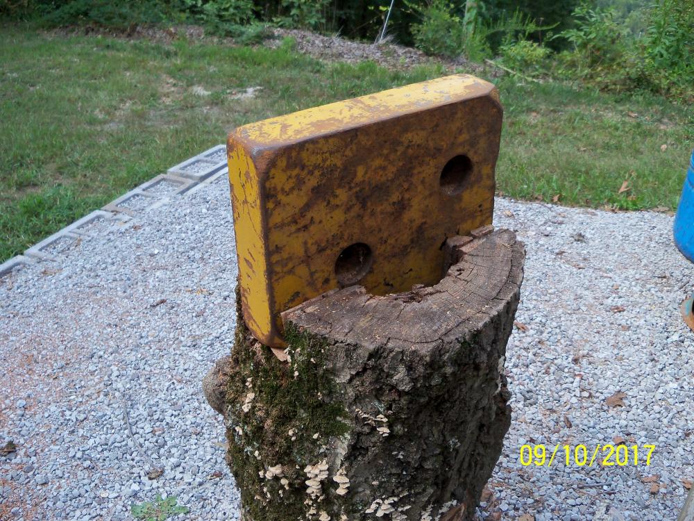

could use some anvil advice
stoped by the scrap yard. didn't find anything I really liked but I did find a 15 pound sledge hammer head. and a nice pair of tongs. I figure I can use the sledge head untill I can find something a bit bigger. any ideas how I can mount this thing?

However you mount it, mount it with the face up for starters. It'll work better for you in that orientation.
Could use a stump, 4x4s or 6x6s on end. I believe another member here mounted a hammer head as an anvil. Try looking in the improvised anvil thread or the show me your anvil stand thread.
Works for me. thanks
think I know what i'ma do. a trip to lowes is in order. I'll post a pic when done. but I also got an idea for something to look for at the scrap yard too. an axle shaft.
so last question. should I do something to this sledge head? like make the face flat or something?
for the stand I decided I'm gunna burn it into a old table leg and strap it to the side of my box to hold it up. eventually I'll stick it in a bucket of concrete
Burning it into the wood will destroy the temper on it. I'd have to *SEE* the face to tell you what, if anything, needs to be done to it.
it's in the shop. I'll take a pic tomorrow. I'll see if I have a hole saw big enough then. I'll cut a hole and just hammer the thing in the rest of the way.
and I was just about to ask a stupid question. I was about to ask if I could heat treat it after burning it into the handle but then I realized that wouldent be a good idea unless I want the table leg to be on fire
If you mount it to use as an anvil it doesn't need a handle and few table legs are made from wood that makes for good handles---so what are you trying to do?  Note a slightly worn farrier's rasp is excellent for shaping handles to fit.

this is the sledge head.
and the basics I know about Australia are they have the cool fords and koalas look cute and fluffy but will murder you
Here's my suggestion for the sledgehammer head: Make some kind of stand that holds it solidly, but allows you to quickly remove it, flip it over, and lock it back in place. Grind both ends smooth (being careful not to overheat it and ruin whatever temper it may have), but make one end a rounder than the other. That will give you two different working surfaces that will do two different things.

I like that idea. it'll take time tho.
No, it won't. Slam together some scrap lumber to make a stand: a vertical post under the hammerhead to put it at the right height, more wood around the side to hold the head upright (leave just enough room for some wedges to hold the head in), more wood around the base to keep it from falling over. A couple of pallets will give you all the wood you need, or the guys at a construction site might be happy to have you get some scrap lumber off their hands. Get the whole thing done in an hour or two.

Don't get aggressive when smoothing the ends, just knock the rust off at first. The heat treating may not go all the way through the head.

Your point?   You can do a lot of smithing on a gently curved face, but working on a semi flat can be easier.
A hole in a stump will generally loosen with work and a simple knock out wedge will make flipping it easy.
