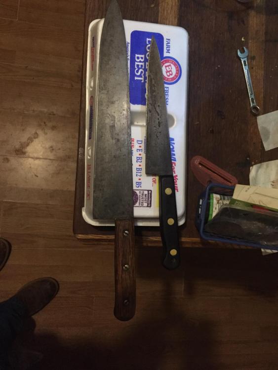

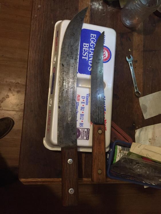

Charles R. Stevens Posted April 8, 2018 Share Posted April 8, 2018 All depends on what you need... the Fosters Brothers has a 11 3/4” blade 17” overall its little brother sports a 7 1/2” blade and is 12 1/4” overall. Now butchers are another mater all together... The small one is a nice general purpose knife, and sees a lot of use, tho honestly I can use the larger one with equal dexterity. The larger one comes to its own vs large heads of cabbage, melons, winter squash and such. Man 8” Chinese cleaver amazingly enugh serves the same purpose Now the English butcher is another animal all together As is the french style butcher So as to a 10” being max... Quote Link to comment Share on other sites More sharing options...
Foundryman Posted April 8, 2018 Author Share Posted April 8, 2018 Thanks for the feedback guys, it's given me a lot to think about. That 17" chefs knife is a beast Charles! The Chinese cleaver is cool too, something I'd like to try out sometime and I love the patina on your knives, it really gives them character. The rounded tip is an interesting idea, and at 2.5mm thick I can understand why you love it, it must cut like a laser. My go to paring knife has a very similar handle to what you describe and it sure is comfortable to use and indexes to your hand nicely. Funny that you should mention the Japanese slicer, it's already on my list of future projects though I honestly think it would end up only being used as a carving knife. I made a nakiri last year with a chisel grind and in terms of sharpness it's by far the best performing blade I've made though I couldn't get on with it when it came to dicing onions because of the lack of a pointed tip held it back. My 1095 prototype came out of the tempering oven last night so i'll hopefully get it finished up today and go from there. Quote Link to comment Share on other sites More sharing options...
