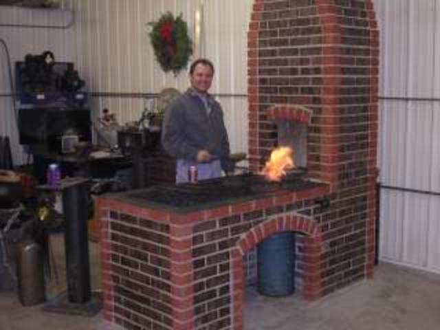

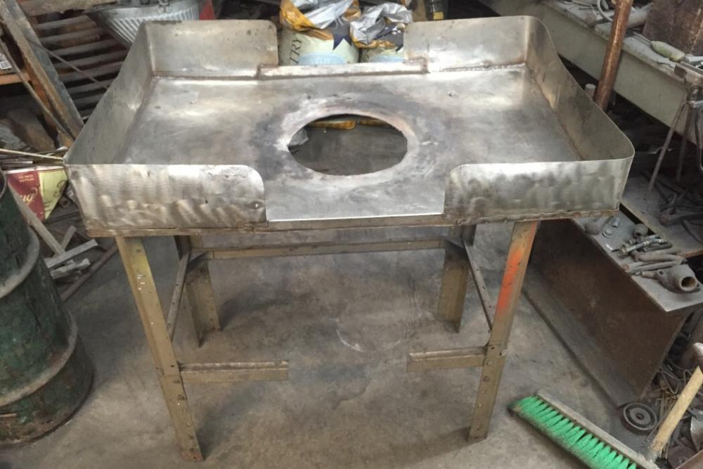

AggieBlacksmith Posted April 2, 2018 Share Posted April 2, 2018 I'm in the processing of creating a new forge and I want to know what YOURS is made of. Any recommendations on where to buy fire pots, blowers, sheet metal, etc.? How's it working for ya? Also, for those with a forge but WITHOUT a welder, did you have your forge pieces welder for you? Thanks! (below is the kind of forge I'm going for) Quote Link to comment Share on other sites More sharing options...

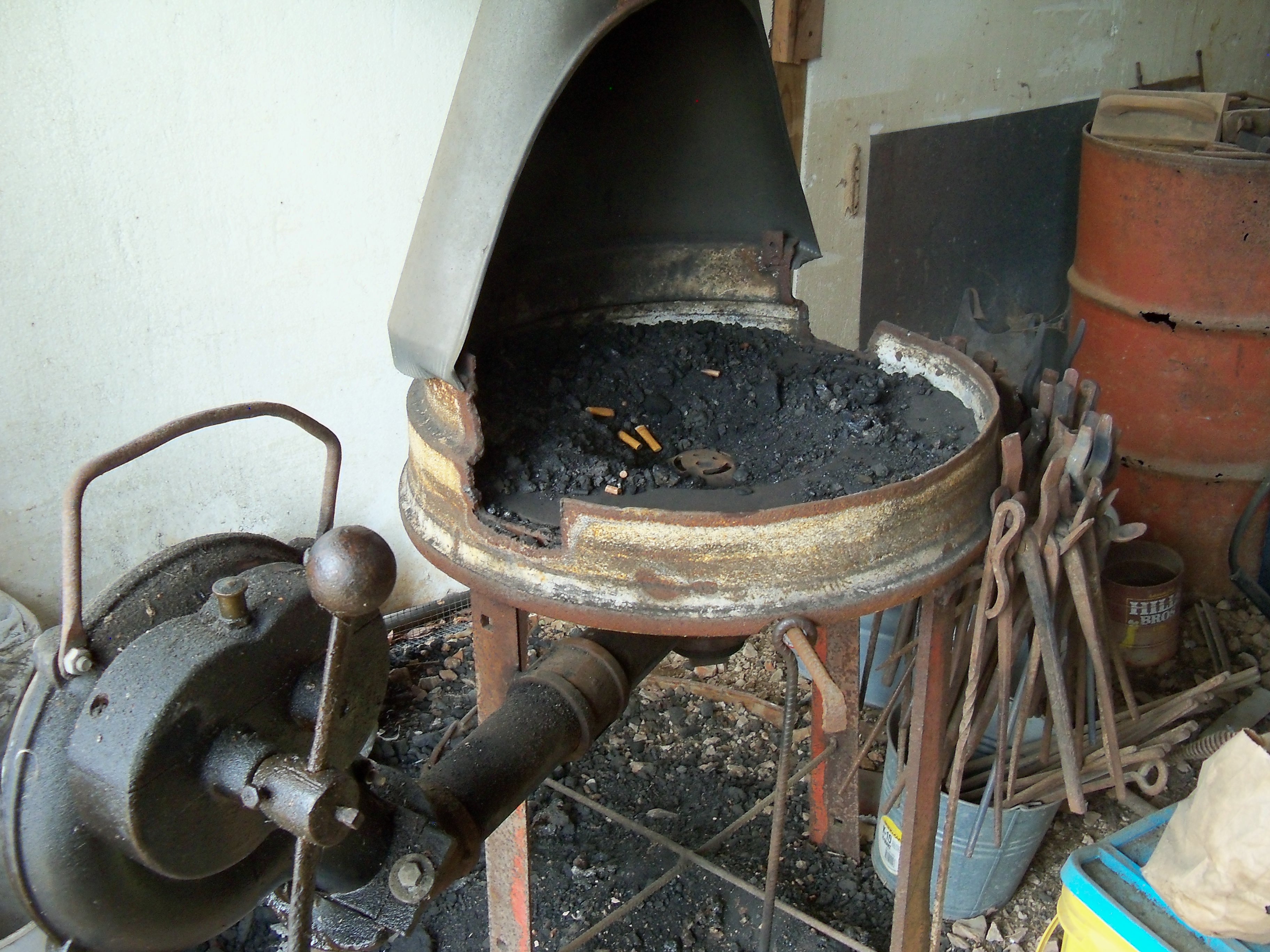

ThomasPowers Posted April 2, 2018 Share Posted April 2, 2018 Lets see: Current project: propane forge made using only hand tools, body is a balloon helium tank, liner kaowool. (using 20 penny nails for rivets as I have a bucket of bent up ones...) In Use: NA Propane Forge, body is oxygen cylinder, liner kaowool Retired: Blown Propane Forge, body is grain auger tubing, liner kaowool In Use: Coal forge, forge pot is axle cover from a 1937 Banjo Rear End; been using it since the mid 80's it's in it's 3? forge body In Waiting: Coal forge, large champion RR forge came equipped with firepot and blower US$80 As Needed: adobe charcoal forge used with twin single action bellows; part of the Y1K demo kit and the forge gets build from local clay/adobe on site. As for where I get my stuff; mainly the local scrap yard. Wouldn't it make a lot more sense to get in touch with the local blacksmithing organization and find out where they are getting this stuff local to yourself rather than asking the folks in Australia, Iceland, South Africa, Belgium, the UK... Quote Link to comment Share on other sites More sharing options...

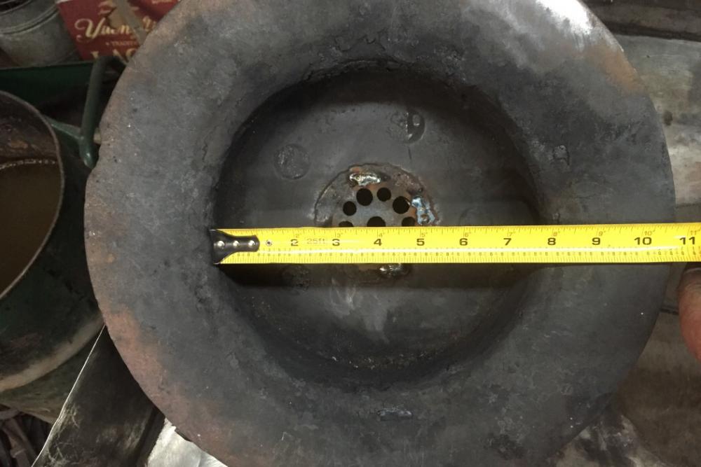

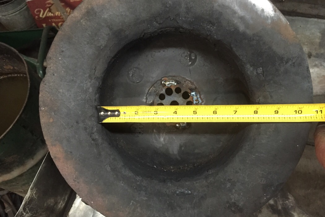

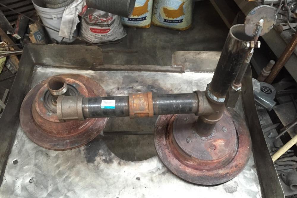

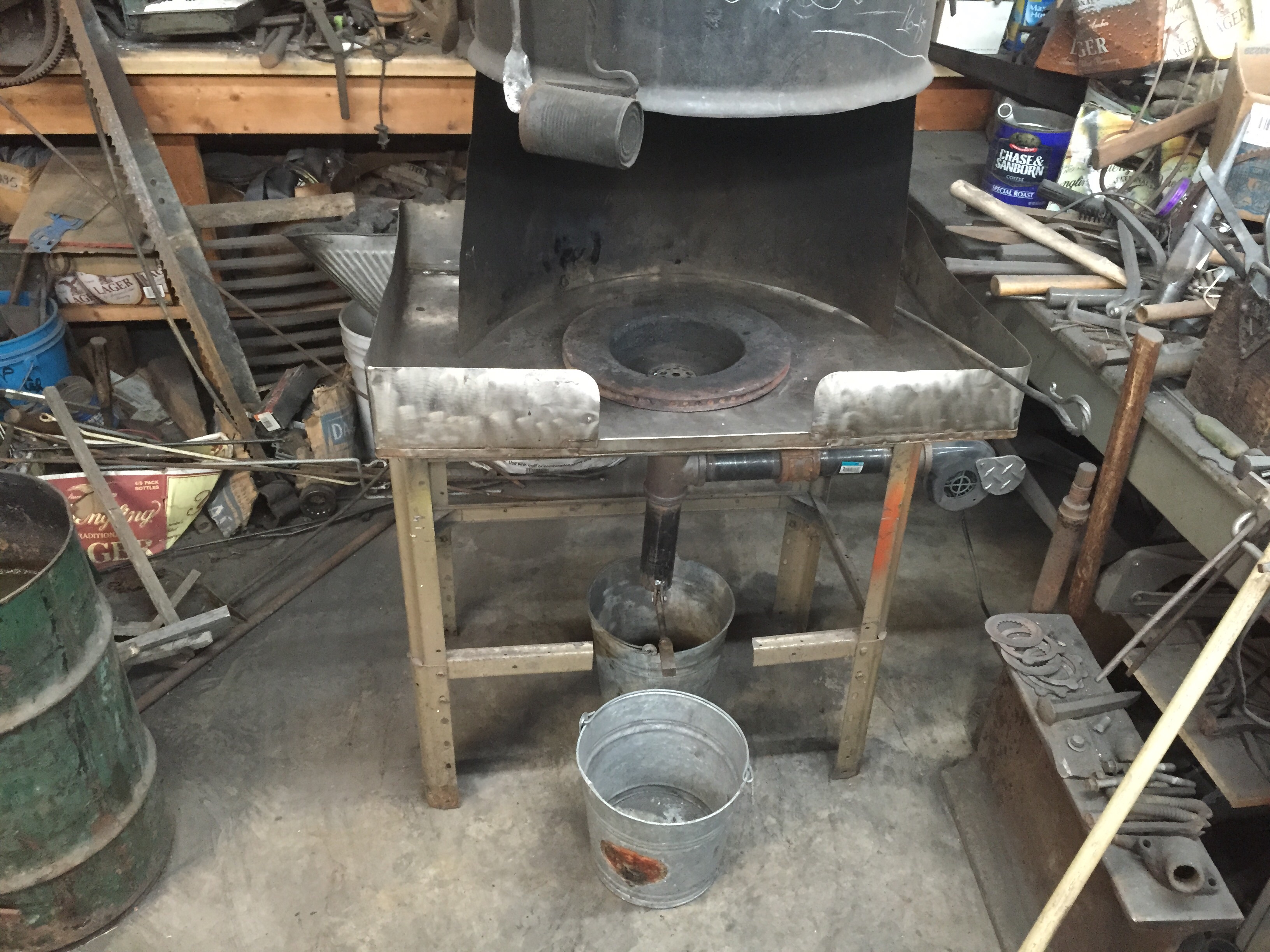

Daswulf Posted April 2, 2018 Share Posted April 2, 2018 I'm a touch it, see it kind of guy too. That's why I collect a lot of scrap when I see uses for it, or that it could be useful. Mine is made up of an old table saw base for the legs, stainless steel table with a hole cut in it for the 8"dis. 2" deep brake rotor I'm using for the fire pot. ( also have one that's 3"deep for the rare times I need it. Fencing around the table was some kind of stainless front hood deflector thing. The 2" black pipe for the T I did buy at Home Depot, tho now I source it way cheaper at restores and wherever. The Dayton blower was given to me by a friend at work when I was talking with him about making a forge. ( they are still available new) I bought a variable speed router control from harbor freight to control the blower. I have a welder so I welded most of the stuff together. It could be bolted as well. Note: the blower is still available under a new model number. It will pop up in a Google search. Quote Link to comment Share on other sites More sharing options...

Kevin Olson Posted April 2, 2018 Share Posted April 2, 2018 Mines an old dryer. The dryer fan is ducted through a sliding air gate to the pot. Fire pot is a disk brake rotor 8 in.x2.5inch deep. Quote Link to comment Share on other sites More sharing options...
jeremy k Posted April 2, 2018 Share Posted April 2, 2018 Brick, controls can be run from both sides - depending on what LG Power hammer I need to use. Forge controls are designed to resemble a blacksmith/wheelwright "traveler". Quote Link to comment Share on other sites More sharing options...

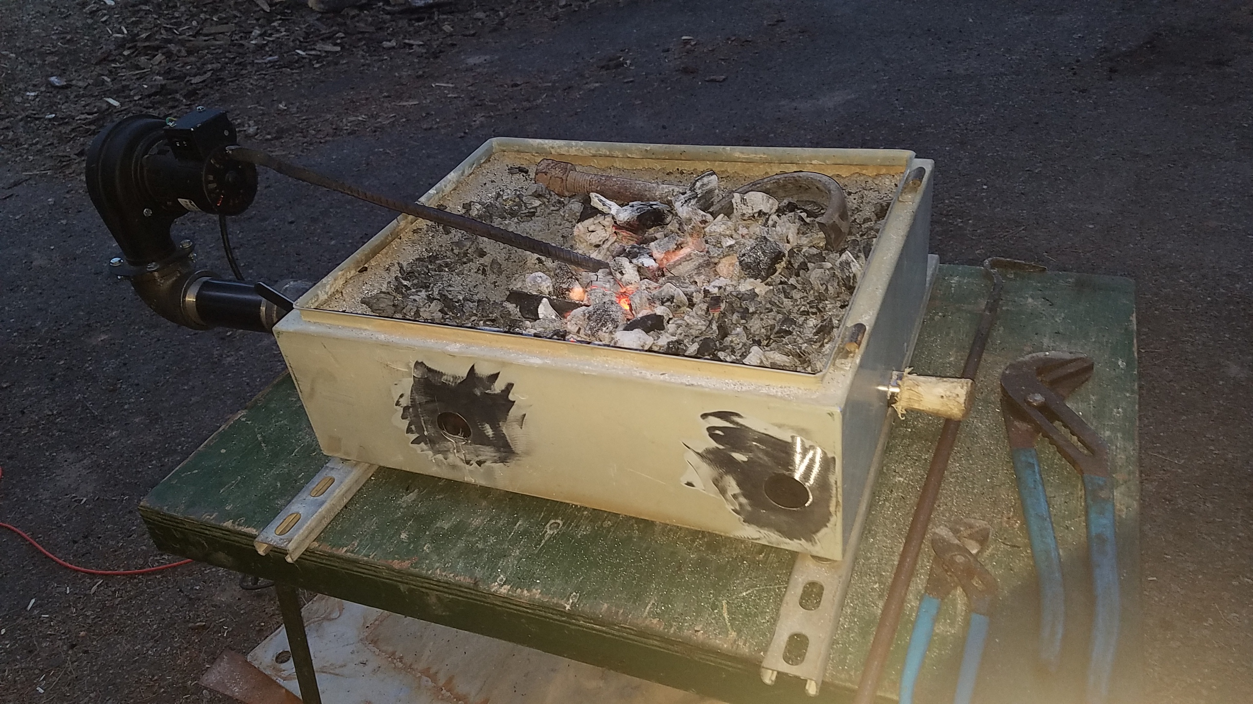

ShortMagPirate Posted April 2, 2018 Share Posted April 2, 2018 That's a nice shop, jeremy. Don't let my wife see that. My forge is an old electrical enclosure with a 1" stainless pipe running through it, a few air holes, a bed of refractory cement and an old blower I've been hanging on to for a few years. The only things not scrounged are the pieces of 2" black pipe. It's not ideal by any means but it seems to work for now. I have a brake rotor that will be making the transformation to a forge soon, as I find time to work on it. Quote Link to comment Share on other sites More sharing options...

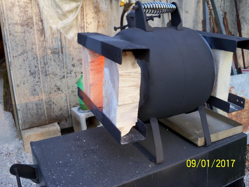

Irondragon Forge ClayWorks Posted April 3, 2018 Share Posted April 3, 2018 My coal forge is a cut down semi 26 inch wheel that was donated the table is a cast iron man hole ring and the fire pot is home made with a commercial grate set in fire clay. The Champion hand crank blower was donated. The only cost I had was for the 3 inch pipe for the tuyere. The propane forge is home made, an old 20 lb tank with a commercial GACO kiln burner home made salvaged BBQ cart for table. Quote Link to comment Share on other sites More sharing options...
Frosty Posted April 3, 2018 Share Posted April 3, 2018 Fire pot? I don't need no steenkeen fire pot! The large coal forge out by the old tarp tent on a connex shop is a 3' x 4' sheet of 14ga. with a 2" angle iron rim and a couple 1" angle stiffeners under it. The air supply is 3" exhaust pipe and 2" exhaust pipe. The 3" is the vertical running from a welded on bolt flange that connects it to the bottom of the table. The other end of the vertical is closed with a clamp on 3" exhaust flap cap about 10" +/- below the grate. The 2" is welded into a 2" dia. hole in the vertical section about 2" below the fire grate at 90*. Everything needing a large hole has a hole saw. I LOVE hole saws. Legs are scrounged sq tubing, spreaders are scrounged angle iron similar to the table rim. The spreaders are at a handy height for a shelf. The fire grate is an over thought piece of plate with a bunch of 3/8" holes drilled in it, most of which are blocked. The forge is a "Duck's Nest" the fire rests in a depression in the rammed clay that covers the forge table. I shape and size fires with bricks. I have an old blower of some brand I found hooked up to a 13 HP ac motor I got on a trade. The blower clamps directly to the 2" horizontal exhaust pipe and I have the blower about as choked as I can get it or it's WAY too much air even for a pretty darned large fire. The more portable is a Buffalo rivet forge with a Champion 400 hand crank blower. Another Duck's Nest forge. Frosty The Lucky. Quote Link to comment Share on other sites More sharing options...

Mark Ling Posted April 3, 2018 Share Posted April 3, 2018 Haha, Aggie Blacksmith, That picture of the forge looks familiar...Steep hollow? Go to Bryan Iron and metal and pick up some plate and put together a forge, though do you not have a welder? That would be the cheapest is to get scrap plate rather than new. You are more than welcome to stop by here and I can show you my shop and set up, and do some forging demos if you'd like. Also have coke for sale if you need some, looks like you are wanting a coke or coal forge. Mack bolt and steel most times has anything that Bryan Iron and metal doesn't. My particular forge is an old cast iron pot from about the 1920s, but if I didn't have that I would fab up a fire pot out of some plate and put that on a steel plate table that way I have a place to store extra coke and tools. Littleblacksmith Quote Link to comment Share on other sites More sharing options...
AggieBlacksmith Posted April 4, 2018 Author Share Posted April 4, 2018 littleblacksmith, Hey man! heh, yeah that's Steephollow. Before yall's demo in February I'd been looking for a good forge setup, and I really liked theirs. I'm a bit of a perfectionist, and since I'm having to start out with just a RR anvil, I figure I could make it up by making a long-lasting, decent-looking forge to start with. I've been to Bryan I&M and I sure haven't seen anything near as big as what I'm looking for. Am I missing something? Also, thanks for the heads up on the coke! I'll be coming by hopefully this semester to use some for my first heat. I'd love to come by your forge sometime soon as well. Quote Link to comment Share on other sites More sharing options...
