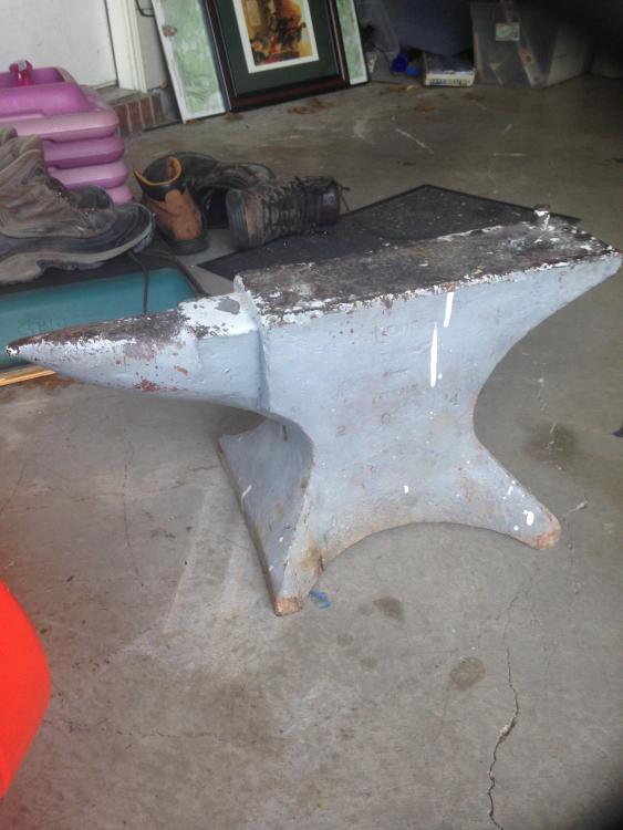

  5. Howdy all, I need some help with this anvil. I bought it today and did EXTENSIVE online research, and the only references I could find to it were on this forum (which were vague). I'm looking for any history/insight that any of you might have into the how old this anvil is, who made it, and any other bits of knowledge you might have. On the anvil itself, the words (barely readable) are as follows Lewis Warranted Best Tiedin (Is this a last name? Am I misreading this? NO results on google for tiedin. Doesn't even sound like a legit word to me) Thanks
  6. Thanks all, I bought! It's a 250 Lewis anvil (if any of yall have heard of that brand).

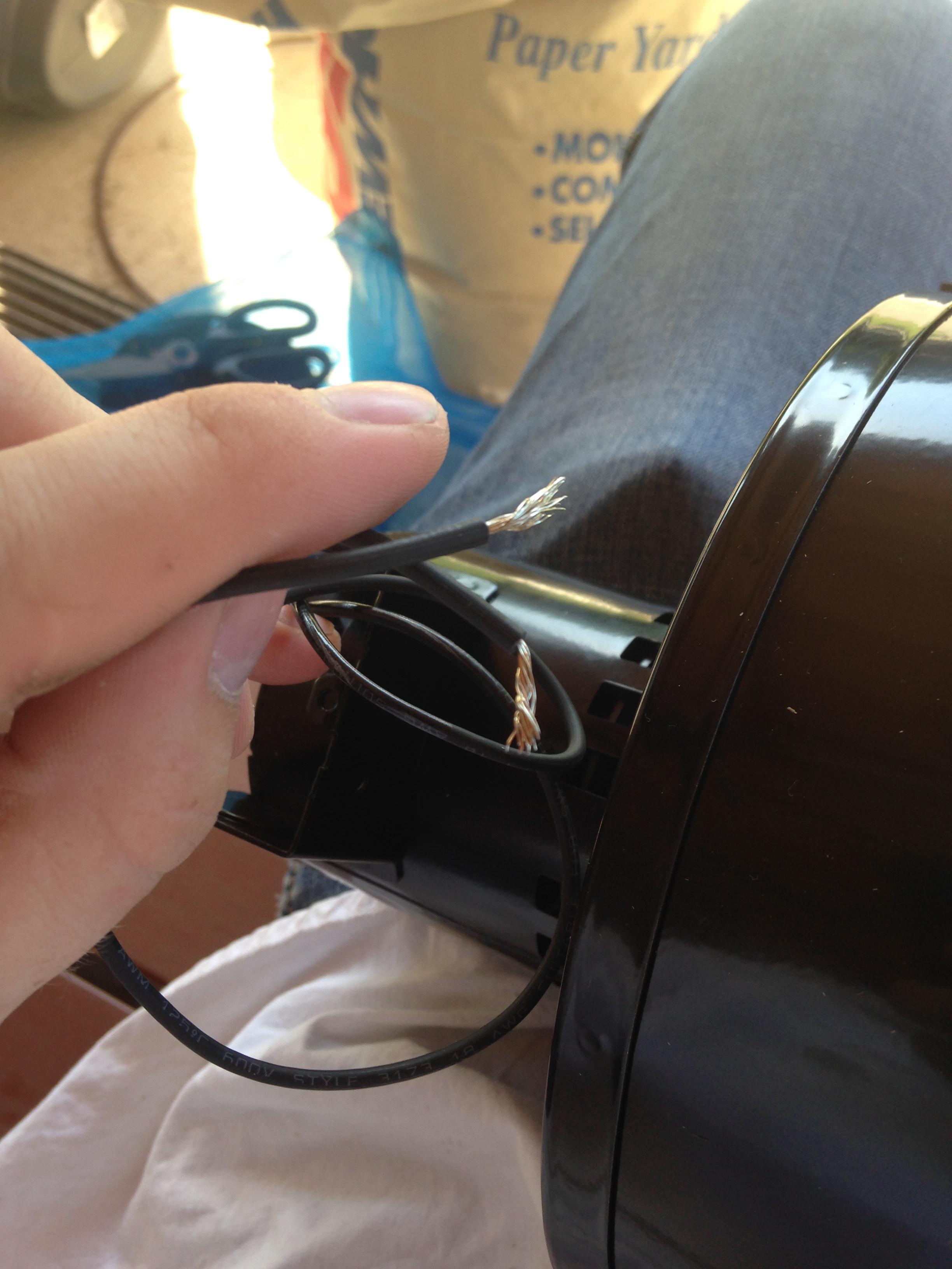

  9. So let me get this straight...the best course of action would be: Use a 3 terminal power cord...connect EITHER of the two black blower wires to EITHER of the white/black wires...connect the green wire to a screw on the blower chasis...plug the 3 terminal plug (that those the wires converge into) into the foot pedal...and then plug the foot pedal into an outlet. Sorry, like I said, I'm electrically challenged.

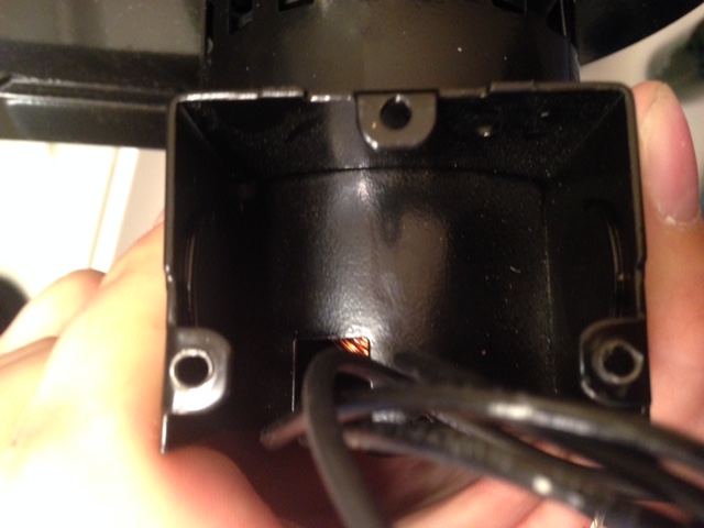

  10. Hey Robert, I'm probably gonna call Fasco tomorrow and get tech on the phone to see what they recommend. Here's the photo of the inside of the box. There are literally no markings inside and again, both wires are identical in every way.
  11. That's the problem though, the 2 wires on the blower don't distinguish between hot and ground.
  12. No problem. So you literally just run the third wire to a screw on the outer casing? Also, with a 3-terminal, would wires from the top 2 terminals on the each wire to the 2 blower wires and then the wire from the bottom terminal on the plug fasten to the the casing?
  13. What exactly do you mean by a fashioner and how would you attach it?
  14. Thank you Wayne, that's exactly what I was looking for! So just to be sure, the blower needs to be wired to a 2 terminal, non-polarized 115v power cord?
  15. Howdy smiths, So here's the short of it: I have a Fasco B24220 AC blower and I want to wire it to a foot pedal which will plug into a standard outlet. My trouble is, I'm electrically challenged. Any advice on electrical specs/wire/foot pedal I can buy to accomplish this? Here's the info on the wires connected to the blower (which which happens to be a NON POLARIZED AC MOTOR?): CSA CL1251 OR AWM I A/B 1258C 600V Ft-2 E29326 AWM 125*C 600 V Style F 3173 18 AWG Suitable for Switchboard Wire. Thanks and Gig'em! Micah

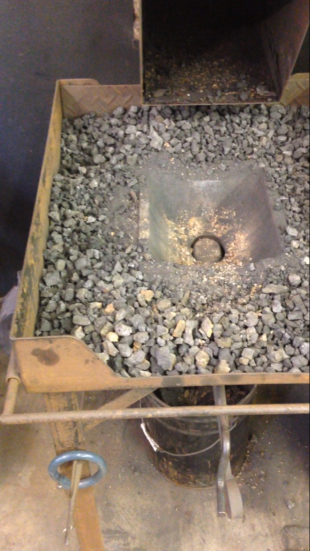

  20. I'm in the processing of creating a new forge and I want to know what YOURS is made of. Any recommendations on where to buy fire pots, blowers, sheet metal, etc.? How's it working for ya? Also, for those with a forge but WITHOUT a welder, did you have your forge pieces welder for you? Thanks! (below is the kind of forge I'm going for)

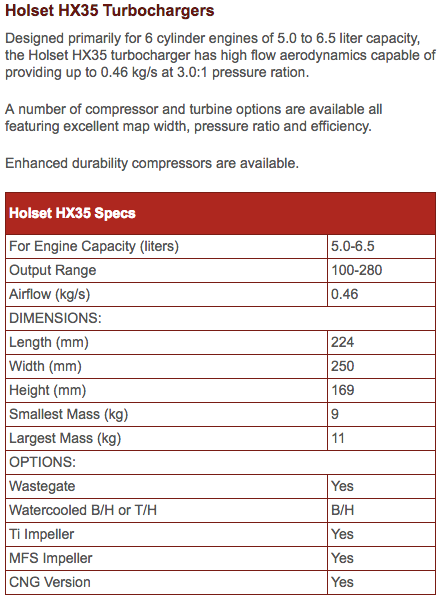

  24. Howdy! I was at the scrap yard today and found myself a Holset HX35 Turbocharger. It looked a whole lot like a squirrel blower, so I bought it! Only after researching it did i realize that it was primarily used for cars. HOWEVER, before I toss/sell it I wanted to be sure: CAN I USE THIS AS A SQUIRREL BLOWER FOR MY FORGE? Thanks!
