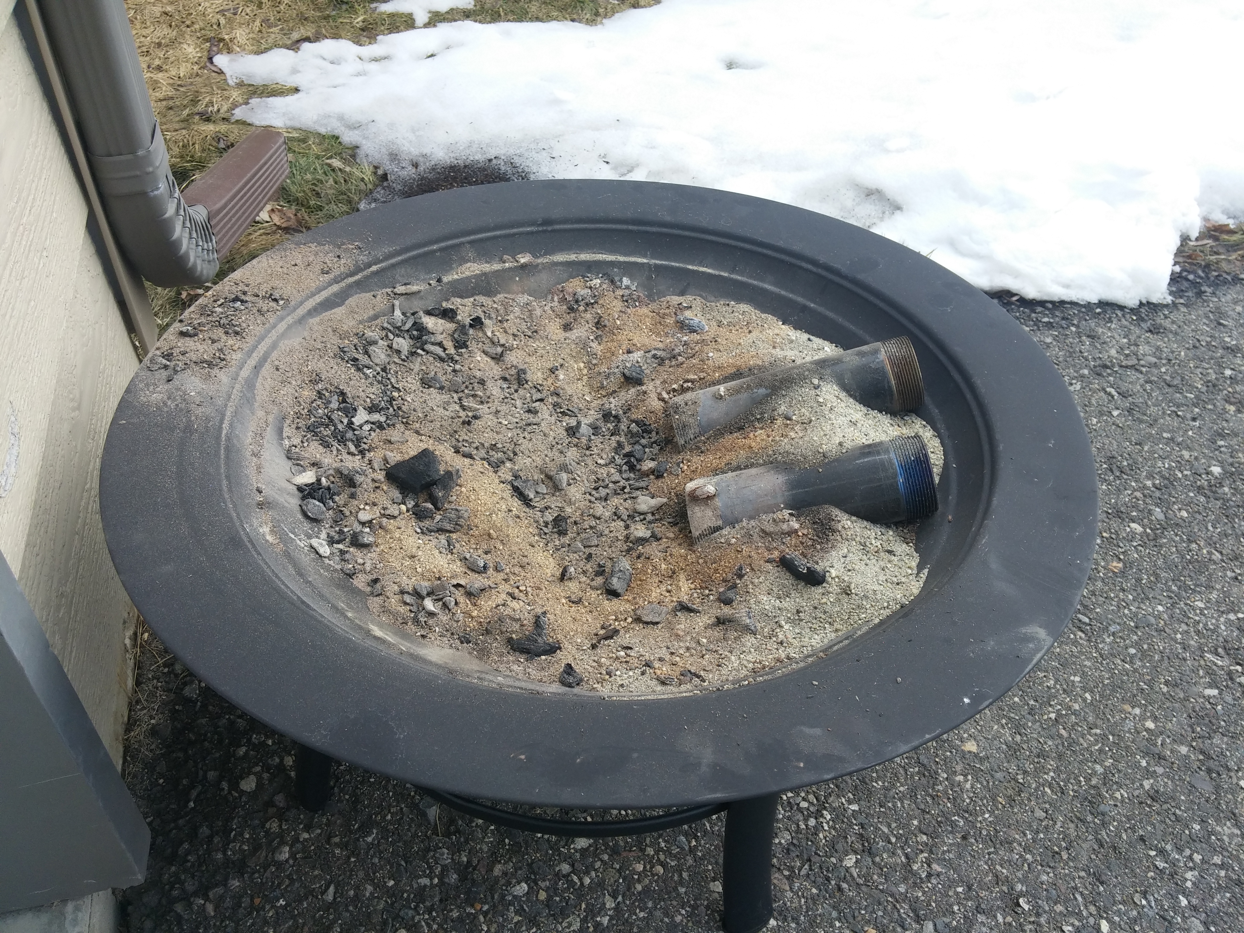

Stahlmann Posted March 8, 2018 Share Posted March 8, 2018 Hi guys, I've looked around on the forum and through other sources, and haven't found this exact question answered, so I'll go ahead and ask. Yesterday I went through the process of trying to heat treat my anvil carved from railroad line (marked 1939). I've read many instructions on how to do it, including the oft quoted/referenced Weygers book, but have not seen this issue addressed... As instructed, I set my anvil upside down on the coals and then buried the striking surface. I covered the surface deep in super hot coals and had a hairdryer going on them just about constantly from all angles. As you'll see in the attached picture, I used pipes on one side to get air up under the coals, while also heating the surface coals on all sides. The blower was kept on low, and at times alternated from 6in to 2-3ft away from the fire depending on the heat coming off of it at a given time. I did this for over 2 hours, trying to get the surface to cherry red. The hottest it ever got was a visibly dull red which, when water quenched, did not pass the file test. My question is, will it hurt the anvil performance to bury it entirely in hot coals? The exposed base of the anvil, I believe, is acting as a heat sink and pulling the heat away from where I need it. The obviously dated Weygers book suggested using asbestos as an insulator (no thank you), but I'm hoping I could get the same effect with a full pile of charcoal. Are there any drawbacks to this? Also, one book I'm using "The Complete Bladesmith" by Jim Hrisoulas suggests an easy way to temper the anvil post-quench by heating it in the oven for several hours at 325 F. What are your assorted opinions on that method as well? Quote Link to comment Share on other sites More sharing options...
ThomasPowers Posted March 8, 2018 Share Posted March 8, 2018 Way too shallow a fire; you want 4-6 inches of hot coals under the rail as well as on top, building a simple tuyere would work a lot better than blowing air in from the sides. If you were using briquettes DON'T they are engineered to put out less BTUs than real charcoal. How to build a forge has been covered on this site probably hundreds of times; I'm sorry you couldn't find it. Basically this is "I put a lawnmower engine in my full sized pickup and I can't get it to 75 mph---what's wrong?" type of question. Quote Link to comment Share on other sites More sharing options...
Daswulf Posted March 8, 2018 Share Posted March 8, 2018 Yup this is where the picture speaks a thousand words. The forge design is why you are not getting up to temp. ( and depending on if you used briquettes or lump charcoal. ) Quote Link to comment Share on other sites More sharing options...
JHCC Posted March 8, 2018 Share Posted March 8, 2018 If your fire is big enough, you don't have to worry as much about the base acting as a heat sink. That's only an issue if it's pulling out BTUs faster than the fire can put them in -- in other words, if your fire is too small. I totally agree with not wanting to use asbestos as Weygers recommended back before people realized how bad the stuff is. For the same reason, you don't want to use unrigidized ceramic wool or the like. However, if you have access to a decent supply of firebrick, you might try piling those around and on top of the fire. They'll act as a heat sink, to be sure, but they'll hold in more heat than plain air. Quote Link to comment Share on other sites More sharing options...
Stahlmann Posted March 8, 2018 Author Share Posted March 8, 2018 1 hour ago, ThomasPowers said: How to build a forge has been covered on this site probably hundreds of times; I'm sorry you couldn't find it. This was just for a one-time project to heat my anvil. What I couldn't find was about exposed sections of anvil/rail line drawing heat from the striking face. I'm trying to learn. I'm new. Your snarky sarcasm is "appreciated", and really "helps". By the way, I used actual real true genuine hardwood charcoal. 59 minutes ago, JHCC said: If your fire is big enough, Thank you for your constructive and truly helpful input JHCC. I'll make the fire bigger, deeper, and with some fire bricks added as well. Quote Link to comment Share on other sites More sharing options...
Daswulf Posted March 8, 2018 Share Posted March 8, 2018 For a one off, it would be easy enough to just dig a fire pit in the ground and run the tuyere in it. No building up needed then just fill it in when done. But since you have the bricks to build up what you have ( other then a longer tuyere lip may help) I guess that's simple enough as well. Quote Link to comment Share on other sites More sharing options...

ThomasPowers Posted March 8, 2018 Share Posted March 8, 2018 I'm sorry but if you need to build a forge you need to build a forge. Not building a forge to do a forge's job; you should not be surprised at having problems. Instructions on how to build forges are rather well represented on these forums---even doing them on the cheap and with improvised equipment. The question being why did you think that not building a know good design to heat metal would be a good idea? Quote Link to comment Share on other sites More sharing options...

ThomasPowers Posted March 9, 2018 Share Posted March 9, 2018 Adding a cover won't do the job. You need a deeper bed of coals. Use the firebrick to build up parallel side walls and put a tuyere along the bottom. Don't need nifty tools---I don't remember anybody saying anything about needing nifty tools---where did that come from? Take a look at the JABOD forge. I've done pattern welding with a claw hammer and a piece of rail---just cut to length, no other work done on it. (we used charcoal sieved from bonfires in the desert. We did have a nice hand crank blower but a blow dryer would have worked too.) I'm not disturbed by folks calling me rude as I consider so many people rude for wanting folks to help them out but not supplying enough information to do so properly. So I'd drop the discussion on rudeness and get back to how to modify that set up to work: Do you have access to an electric drill? (Gave each of my daughters one for Christmas when they were teenagers; brought one to college with me when I was young...) Can you find/source a piece of blackpipe? Here in the USA often sold for use with natural gas. If yes to both you can build a tuyere by drilling 1/4" to 3/8" holes in the top 1/3 of the pipe along the length your fire needs to be.. One end gets the blow dryer directed into it the other end gets plugged---dirt can work. Place along the bottom of your forge. Add real Charcoal, (was very happy to hear you are using the right stuff!) Get a good deep fire burning then add in the rail top down and pour charcoal around the sides LOW AIR otherwise you burn out the charcoal just leaving cold air blowing on the face. You may need to lift out the rail and put more charcoal under it from time to time. Low Air! Quote Link to comment Share on other sites More sharing options...

Buzzkill Posted March 10, 2018 Share Posted March 10, 2018 On 3/9/2018 at 2:07 AM, Stahlmann said: The hottest it ever got was a visibly dull red which, when water quenched, did not pass the file test. Just a minor point here. I haven't ever messed with trying to harden a piece of rail, but does anyone know if it would even contain enough carbon to pass the file test with a successful quench for maximum hardness? Quote Link to comment Share on other sites More sharing options...
ThomasPowers Posted March 10, 2018 Share Posted March 10, 2018 Yes regular train rail has about the eutectoid point of carbon or higher. (So 70's-80's points C) Often more Manganese than plain 10XX alloys for work hardening Quote Link to comment Share on other sites More sharing options...
