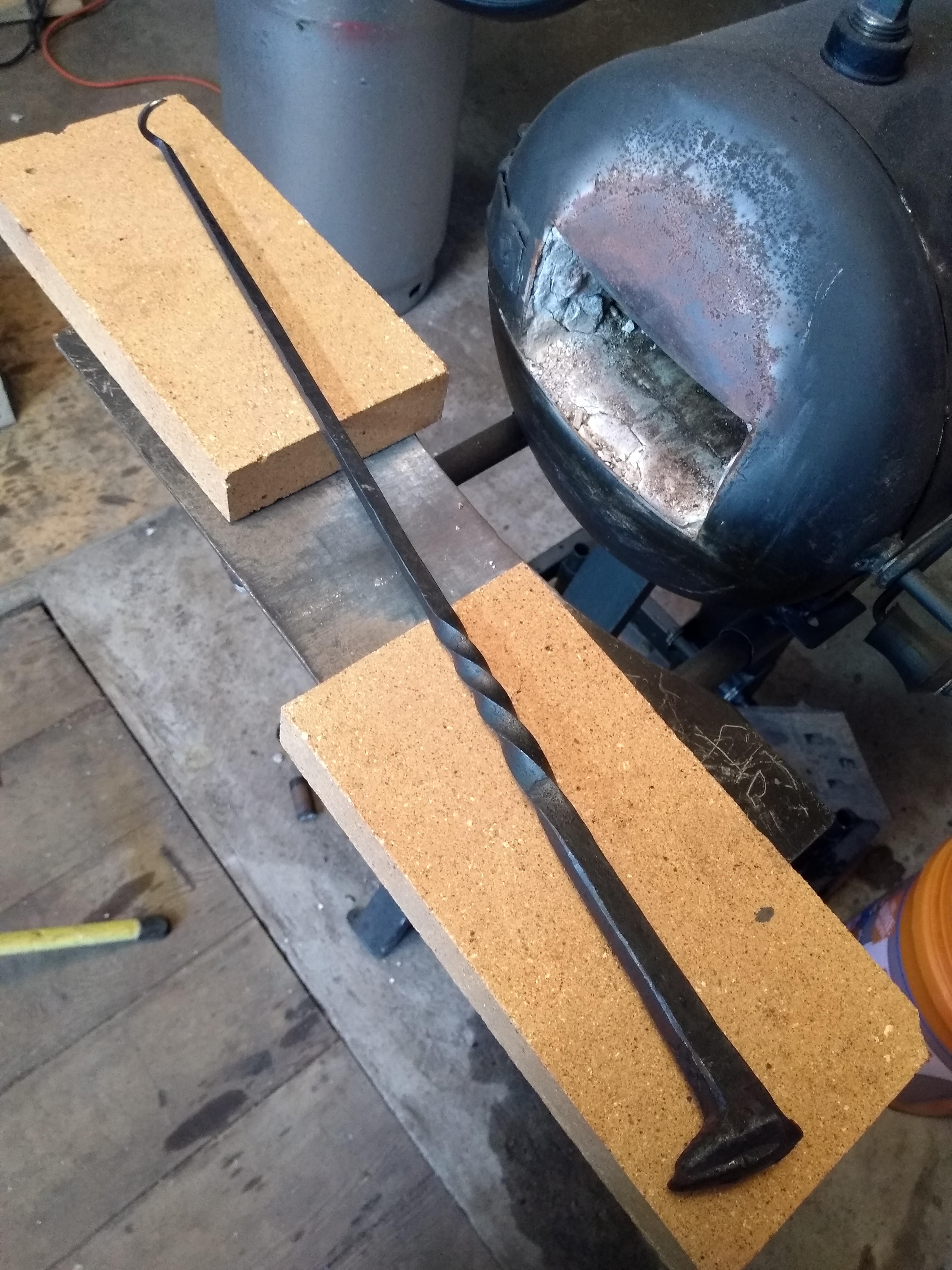

ausfire Posted May 29, 2018 Share Posted May 29, 2018 I had to google pandrol clips - never seen one of those. Our steel sleepers have a different fixing. Here are a few ideas for rail spikes. These are mild steel spikes - not the older wrought iron ones which are much harder to forge. Quote Link to comment Share on other sites More sharing options...
tkunkel Posted May 29, 2018 Share Posted May 29, 2018 Ausfire, nice collection! Especially like the little backscratcher hand on the left! I've made mostly hook style bottle openers, along with a few churchkey style openers. I haven't done the long drawn out items like the fork and poker. Another time......;) Quote Link to comment Share on other sites More sharing options...
