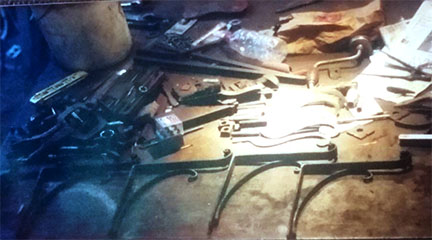

anvil Posted January 17, 2018 Share Posted January 17, 2018 If your table has open space on it, yer not working hard enough. 5'*10'*1" plate. Base is 6" channel, legs are 4" heavy Gage ibeam. All set back 12" from the edge.table top is not attached to the legs/base. I can attach a post vice a ywhere, or multiples if needed, but nothing is attached permanently. It is Not a welding table,,, it is Not a grinding table. It's for layout and assembly. All surfaces are used to check such things as level, edge bend, twist, and to set right angles. Could t be without it Quote Link to comment Share on other sites More sharing options...

beaudry Posted January 18, 2018 Share Posted January 18, 2018 7 hours ago, anvil said: If your table has open space on it, yer not working hard enough. I've never quite understood the idea that to be productive a work space has to be a cluttered mess, although I admit, everyone has their own method to their madness. For myself, I try to keep my main work table clear except for the job at hand. There are three other smaller work tables close by where tools and parts that are in use are easily within arms reach. There's steel topped cabinet right next to my layout table that houses the welder, tig cooler and plasma cutter that is about 3'' lower. This enables me to pile tools on that surface below the level of long bars that overhang the main table surface. The difference in height also allows me to clamp all along that edge. Quote Link to comment Share on other sites More sharing options...

anvil Posted January 18, 2018 Share Posted January 18, 2018 16 hours ago, beaudry said: I've never quite understood the idea that to be productive a work space has to be a cluttered mess, although I admit, everyone has their own method to their madness. First, you must have missed the emoticon. Second , i had three small jobs running simultaneously. These brackets were a quick fill in. The second, of which you can see parts in the pic was from an "ironing" of a log home. I did brackets, lighting, rails, door and cabinetry hardware, fire place doors and accessories. The house was a six month commission. Sorry if I offended your neatnic fetish. Third, cleanup happens when the job/ jobs are done. Fourth, this is a post about tables, not preferences on shop practices. Quote Link to comment Share on other sites More sharing options...
