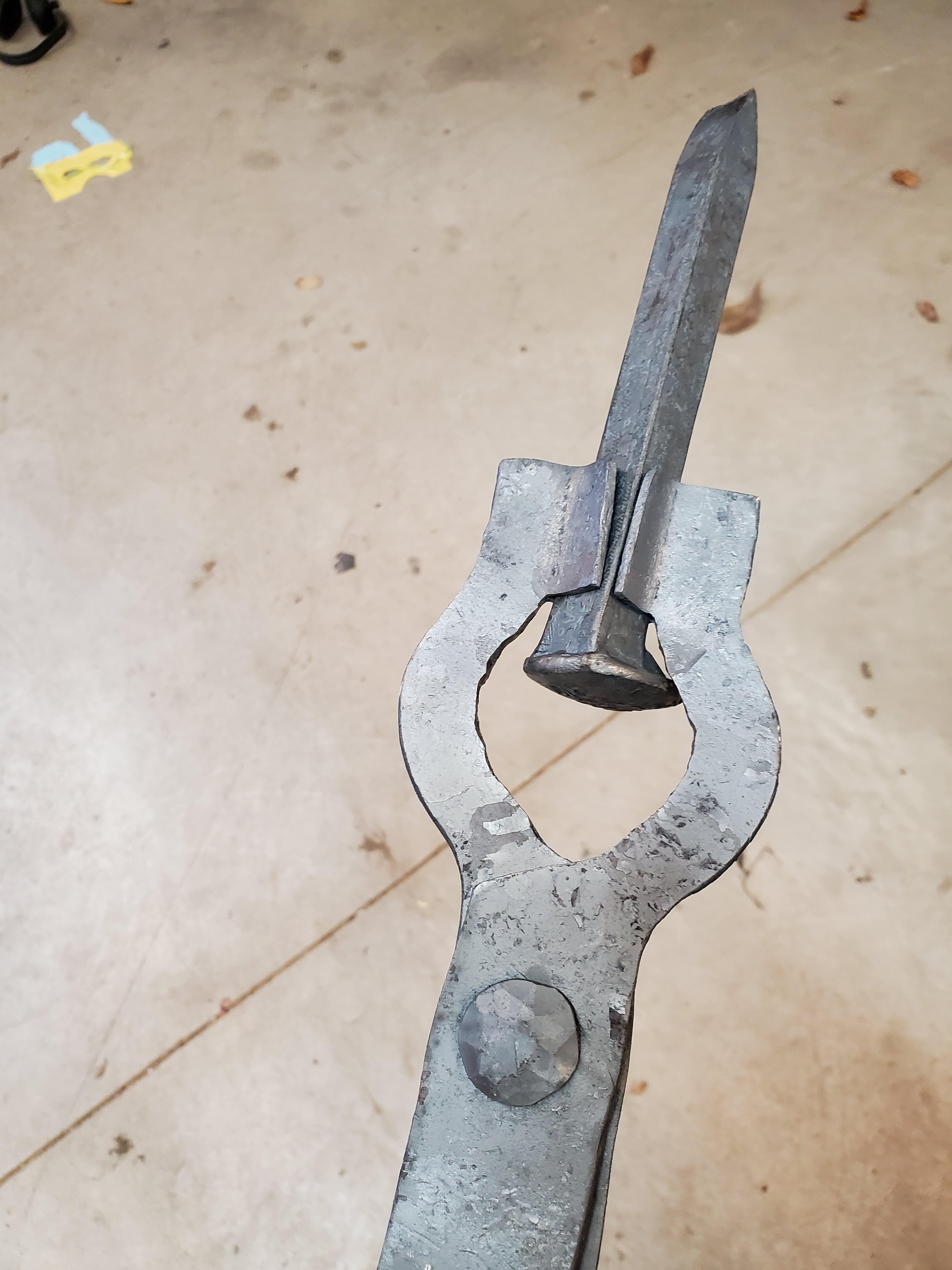

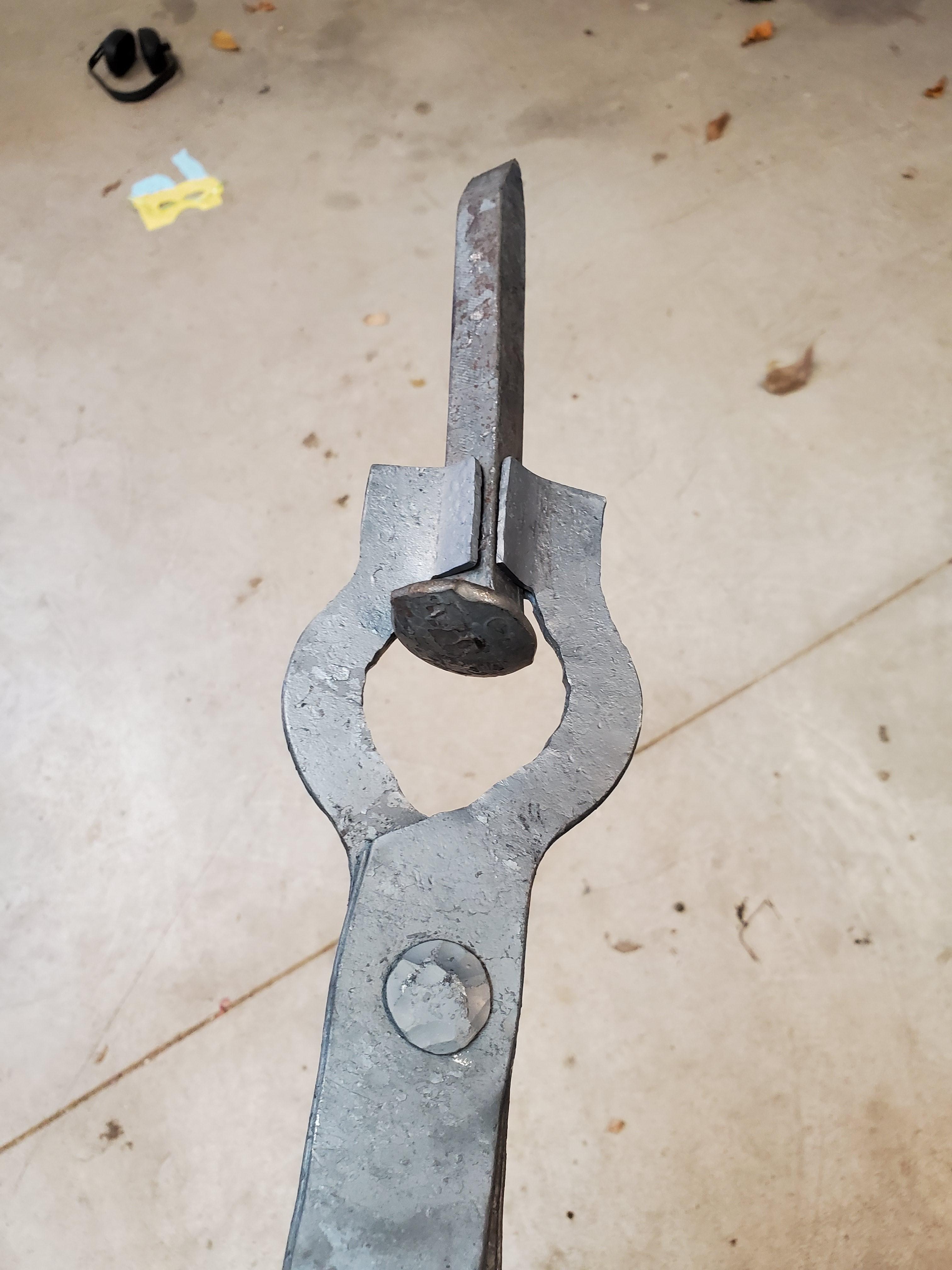

JHCC Posted May 18, 2019 Author Share Posted May 18, 2019 Update: made a little tweak to the shape of the bows, to allow the reins to close more. Definitely more comfortable in the hand, if rather unusual looking (but then, looks were never the point, were they?). Quote Link to comment Share on other sites More sharing options...

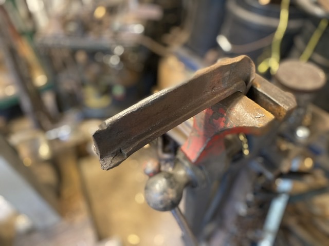

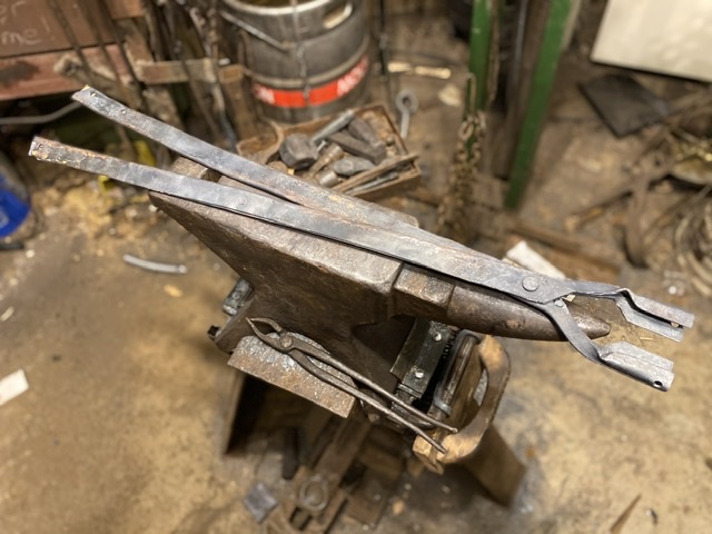

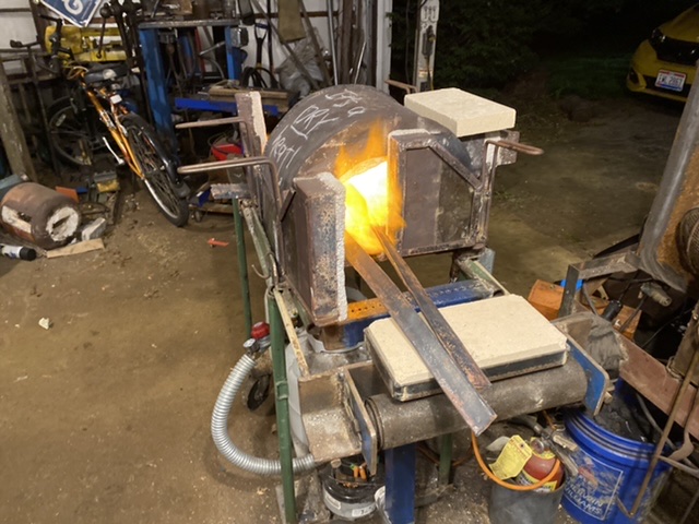

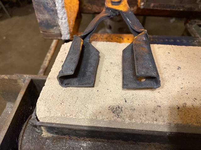

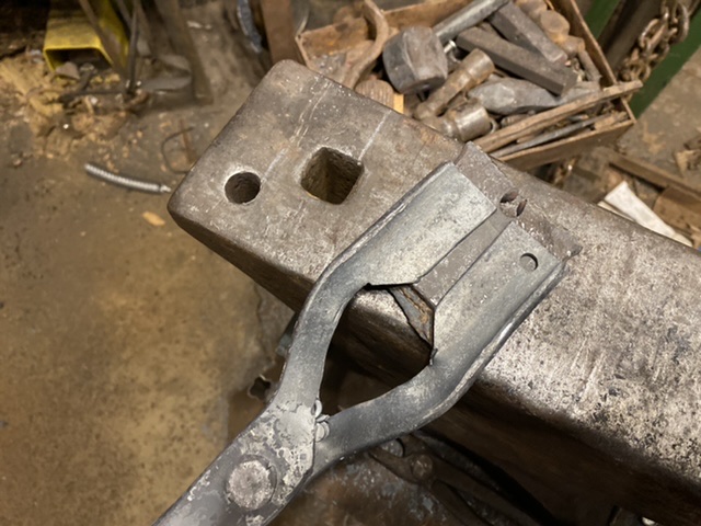

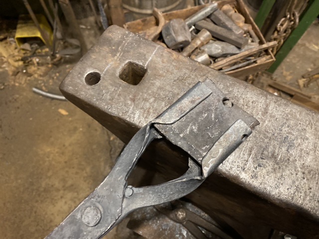

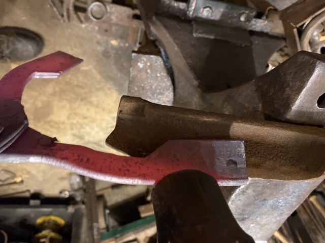

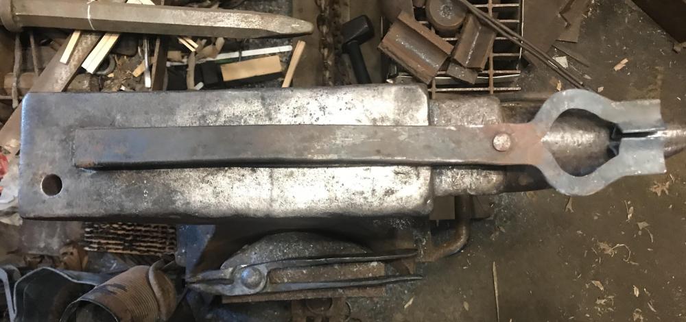

JHCC Posted September 24, 2020 Author Share Posted September 24, 2020 Made another pair, and incorporated some updates to the procedure. I flattened both pieces before any further work: I didn't get a photo of the next step, alas, but I marked the notches on one piece, clamped both pieces together side-by-side in the vise, and cut both notches at the same time with an angle grinder. Despite my earlier observation that drilling would be better than hot punching, I was short of time and wasn't able to anneal the parts and drill them, so I went ahead and hot-punched anyway. It actually came out pretty good, especially with a bit of filing of the holes. I bent the jaws, riveted the pieces together, and flattened everything out: Here is the tooling I used for opening the jaws: a long hot-cut turned sideways in the anvil: And a narrow fuller held in the post vise: (Both of these are made from FAIR rail anchors with the short leg brought back to 90 degrees, drawn out, and squared up.) The jaws were opened up first on the hot-cut (apologies for the flipped photo; blame the forum software): And then on the fuller: The jaws were shaped around a section of leaf spring (front): (And back): There's a bit of an offset, which keeps the center of the stock in line with the center of the reins: The finished tongs. I may eventually shorten the reins a bit, but I want to take them for a spin first: Quote Link to comment Share on other sites More sharing options...

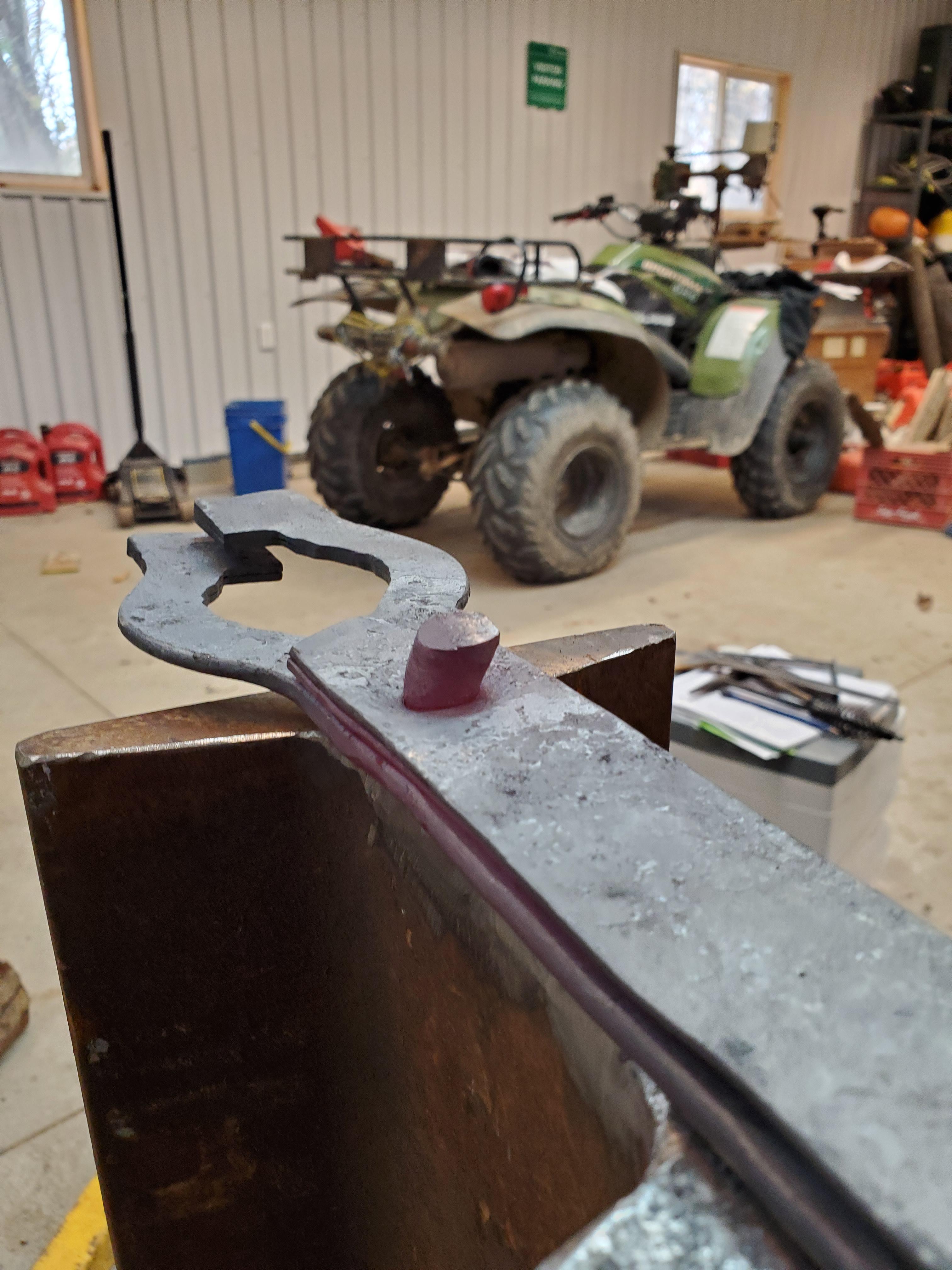

benjhind Posted October 30, 2020 Share Posted October 30, 2020 (edited) I did it! I made something! Thanks JHCC for this thread and idea! I thought this was the perfect project for a new person to the craft so I gave it a go. I happened to have a set of bedframes that some ignorant idiot left in a public place and I picked up. Paint removal was a challenge. I tried wire brush and grinding wheel, which both just smeared it around. My paint stripper was old and thick, and after thinning with methanol did a marginal job. More grinding and wire wheeling and I burnt off what was left. I didn't fold them quite perfectly, so I cut the poor ends in order to hide it. Curving the jaws was a bit of a challenge without a horn but i worked them around the fuller I ground into my railroad track. The rivet was made from some rebar that I rounded off to 7/16. I thought I would drill the hole but the steel proved a little too hard for my dull 7/16 bit so I enlarged my 1/8 hole with a punch that I ground out of some tool steel from my scrap bin. I had to cut out my first rivet and straighten the tongs. I may have made my holes oblong in the process. The second rivet entry well but it was tough to get the tongs moving again. I managed to get vice grips on either rein and get them apart. They hold the spike securely, but not perfectly in line with the reins. A little more finesse is required, but I'm happy to have my first set of tongs and look forward to forging without burning my hands!! Thanks again JHCC ! Edited October 31, 2020 by Mod30 Remove @name tag Quote Link to comment Share on other sites More sharing options...

benjhind Posted October 31, 2020 Share Posted October 31, 2020 Thanks folks!! IFCW - you know I showed the good side of the rivet, right? Sorry to the mods for tagging members - too many forums and too few brain cells on my part. I used a home made ball peen hammer for the rivet. I ground the shape into a hammer I found on the highway. Here is the other side of the rivet. I bet you can't guess that I'm pretty exited haha Quote Link to comment Share on other sites More sharing options...
