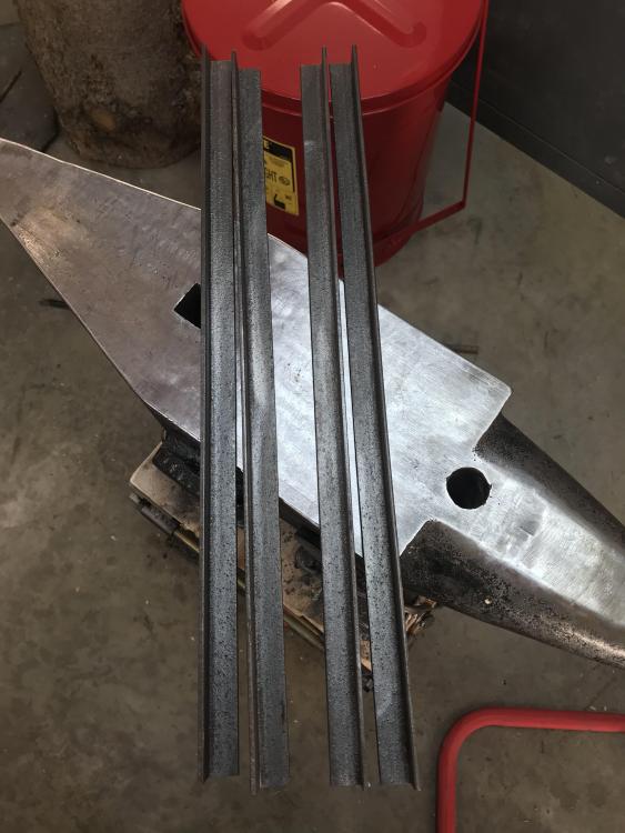

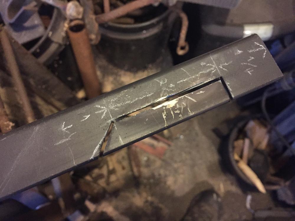

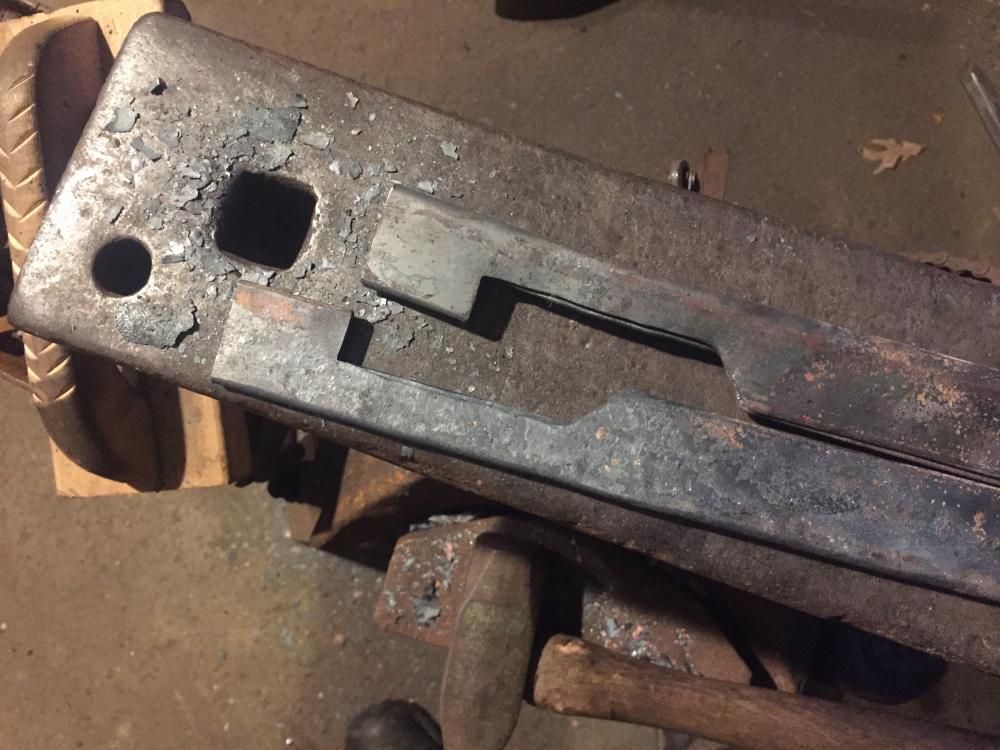

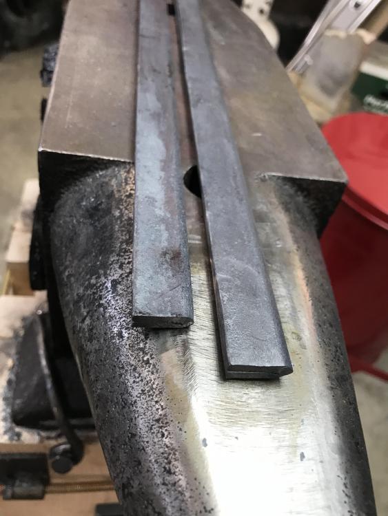

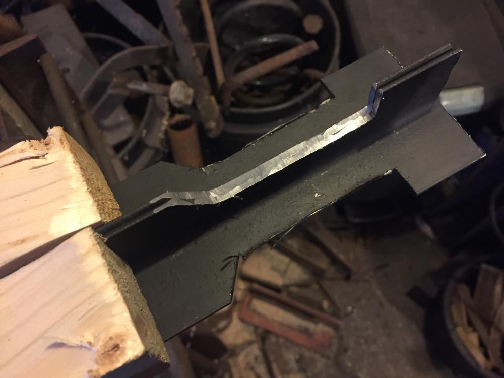

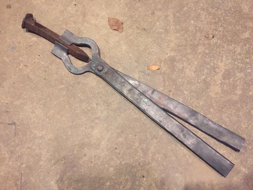

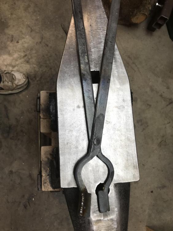

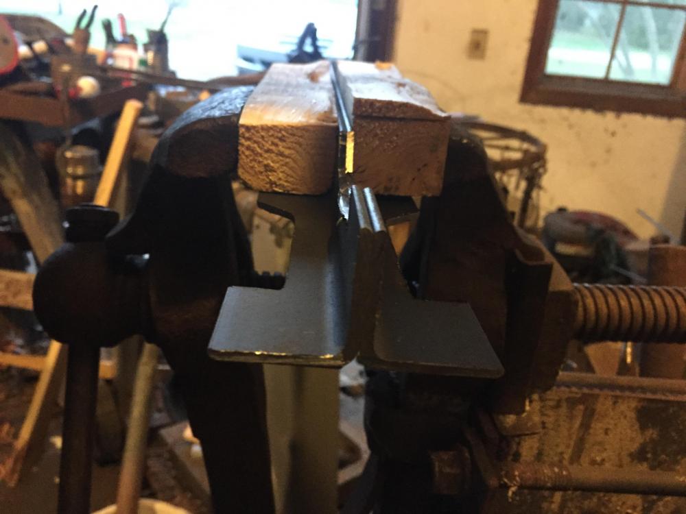

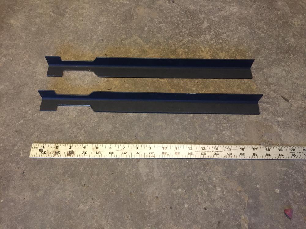

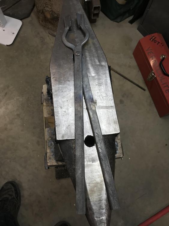

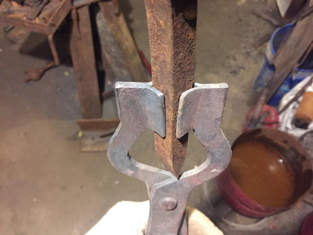

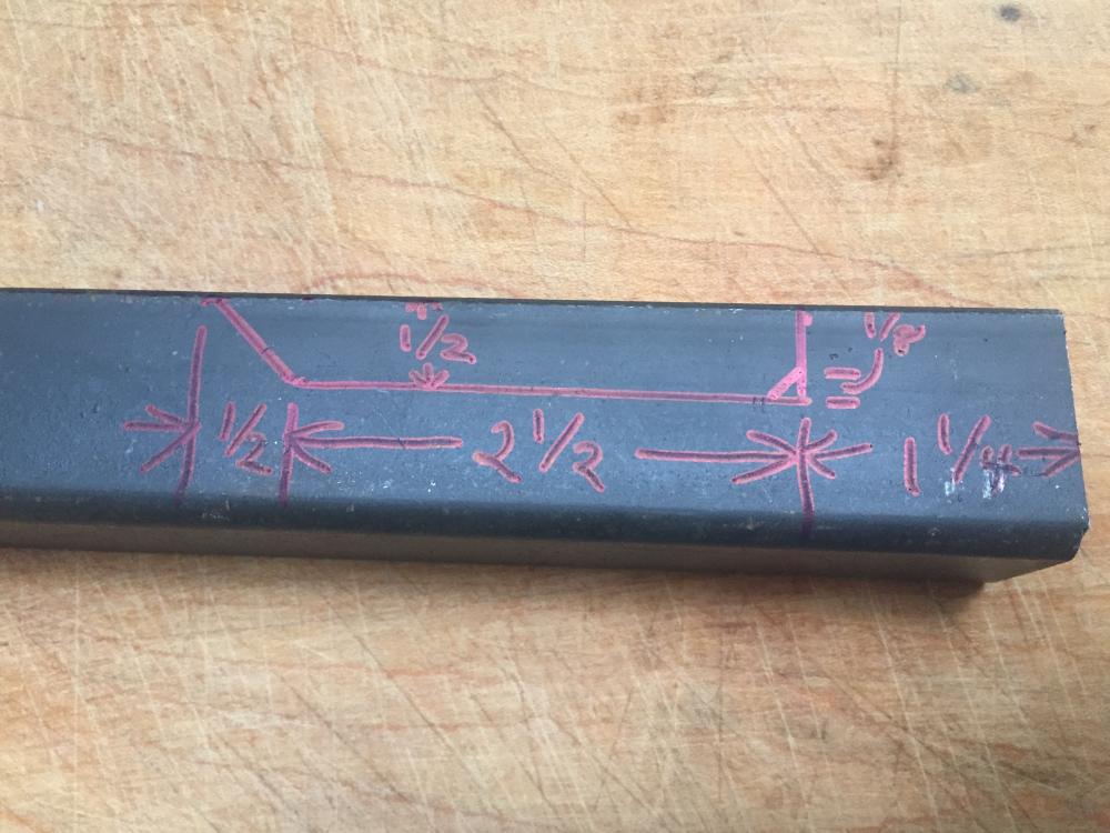

JHCC Posted November 27, 2017 Share Posted November 27, 2017 Some months back, I came into possession of a couple of bed frames. It’s basically 1-1/4” angle iron with 3/32” thick sides. Sparks like high carbon. An idea came into my mind for making some bolt tongs, and today — after thinking through a few issues — I finally gave it a try. Here’s the process. Cut two 18” long pieces. Mark both sides of one end of each for a long notch, with dimensions as shown: And cut: Clamp both pieces back-to-back in the vise (spacer blocks come in handy) and clean up the notches: Ready for forging: Flatten both pieces: Shape jaws, punch, and rivet: Heat the tips of the jaws, clamp in vise, spread with a chisel, and match to your stock (in this case, a RR spike): Ta-Da! Quote Link to comment Share on other sites More sharing options...
ThomasPowers Posted November 27, 2017 Share Posted November 27, 2017 DON'T QUENCH THEM WHEN HOT!!!!!! I've used old bed rails for making Q&D corner chisels for mortise and tenon work in timber. Quote Link to comment Share on other sites More sharing options...
JHCC Posted November 27, 2017 Author Share Posted November 27, 2017 TRUE!!! Same as with any tongs except KNOWN mild steel! Quote Link to comment Share on other sites More sharing options...
Mark Ling Posted November 27, 2017 Share Posted November 27, 2017 I had made a pair of hammer making tongs from coil spring, and I knew not to quench them, but because all I had ever used was mild steel I once forgot and quenched them, and ended up with alot of cracks in the tongs. since then I have made a new pair and have not quenched them! littleblacksmith Quote Link to comment Share on other sites More sharing options...
JHCC Posted November 27, 2017 Author Share Posted November 27, 2017 Observation: I think I'll be drilling the rivet holes on the next pair. Punching through doubled-up thin stock was messy, and I'd rather have a nice clean hole. Quote Link to comment Share on other sites More sharing options...
Buzzkill Posted November 27, 2017 Share Posted November 27, 2017 Just curious here. Why not heat and fold the angle iron before making the cuts? I think you could cut all 4 "slots" at the same time with a vise and a clamp to keep the two folded pieces tight to each other. I love the innovation. Great idea. Quote Link to comment Share on other sites More sharing options...
JHCC Posted November 27, 2017 Author Share Posted November 27, 2017 Definitely going to do that in future. In fact, I think I may flatten a 6 foot length, cut it in quarters, clamp them together in the vice, and cut all four notches simultaneously. Quote Link to comment Share on other sites More sharing options...
Daswulf Posted November 27, 2017 Share Posted November 27, 2017 Cool idea for sure. How about folding the reins over again to make them more hand friendly. Might just have to try a pair of those. Quote Link to comment Share on other sites More sharing options...
JHCC Posted November 27, 2017 Author Share Posted November 27, 2017 Just now, Daswulf said: How about folding the reins over again to make them more hand friendly. I've thought of that, but I've found them surprisingly comfortable so far. Will modify as necessary. Quote Link to comment Share on other sites More sharing options...

ThomasPowers Posted November 27, 2017 Share Posted November 27, 2017 I was thinking of a wood insert for the handles to avoid any chance of pinching when working with the closed ends. Quote Link to comment Share on other sites More sharing options...
JHCC Posted November 27, 2017 Author Share Posted November 27, 2017 You can't really see in the picture, but the reins splay out very slightly to the sides. Between that and the rounded "spine" of the folded edge, pinching isn't much of an issue. Quote Link to comment Share on other sites More sharing options...

JHCC Posted November 30, 2017 Author Share Posted November 30, 2017 The only thing that would worry me about that (and this is more my own ignorance than anything else) would be the risk of the HC bed rail cracking if the welding weren't done with the appropriate pre- and post-heating. The last thing you want is your tongs coming apart while you're hammering on a workpiece. I'm no welder, though, so I hope someone with more experience with that can offer some advice. Otherwise, this whole idea is about making use of what you have on hand, so I guess it's worth a try. If you use the dimensions given above, you'll need about 7" to allow for the bits and bosses, with a little left over as a base for welding the reins. Quote Link to comment Share on other sites More sharing options...
Smoggy Posted November 30, 2017 Share Posted November 30, 2017 I have to say I do like the concept and the process, if I were going to weld reins on I would opt for thin diameter heavey wall tube if available. I see no problem arc welding reins onto the tongs. I've welded up ingot molds from bed frame angle, and it takes both the heat cycle and the inevitable pounding without detriment. I can also imagine this design lending quite well to bolt and offset tongs. Quote Link to comment Share on other sites More sharing options...
JHCC Posted November 30, 2017 Author Share Posted November 30, 2017 1 minute ago, Smoggy said: I've welded up ingot molds from bed frame angle, and it takes both the heat cycle and the inevitable pounding without detriment. That's the information I was looking for! Quote Link to comment Share on other sites More sharing options...

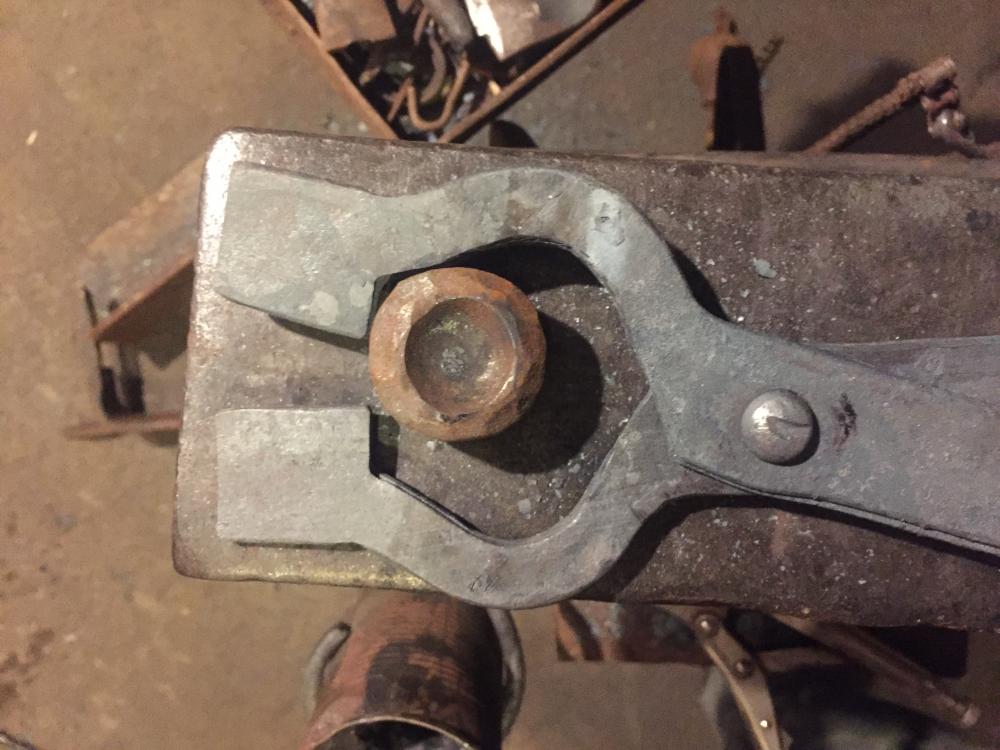

Chris J Dixon Posted April 15, 2019 Share Posted April 15, 2019 Built these over the past few days. Cracked them working them too cold but they welded and reformed just fine. Fitted them to a railroad spike. My angle wasn’t as beefy as JHCC but they still made a nice pair and decently comfy too use. Quote Link to comment Share on other sites More sharing options...
