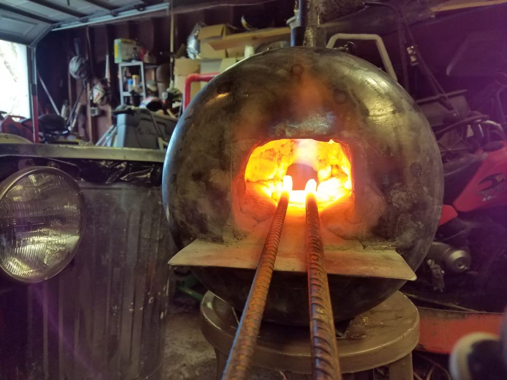

Here's a link to my forge burner build! Pretty easy for most who have common tools like a welder and a drill!
The photo shows a heavily reducing flame. Apparently, this person doesn't even know enough to see what a bad flame is.
This is a first light photo no adjustment at all! Thanks for the feedback! Feel free to watch the video and you'll understand more! Thanks again for feedback!
Pretty sure this is getting the job done! Thats hot enough! This is a great first build for someone just getting into the craft!
Given that the .023" Mig tip is the smallest available, the burn does look pretty rich (reducing).
What it looks like out of a forge is fairly meaningless: there are plenty of rich-running burners doing precisely what they need to do (I don't recall this being specified in the video).
With the caveat that digital cameras can really mess with color, that looks like a perfectly adequate forging temperature to me. The video on the other thread looks like a good forging temperature, but probably not a good welding temperature {though I could be wrong).
If the forge does what it is intended to do, no changes are needed.
There is a lot of Dragons Breath in the video, so if needed there should be scope for increasing the flame temperature with more air relative to the gas.
A smaller gas jet would increase air, relative to gas, but is effectively ruled out by smaller mig tips being unavailable.
The burner looks very much like a Frosty Tee with some, probably unhelpful, changes. It's not clear why the changes have been made: The build seems to require all the same tools as the Frosty Tee, but with the addition of a welder. It does not seem to offer improved performance in its current form.
My guess would be that the hex end cap offers some obstruction to airflow, and that the depth of the hex end cap also causes the gas jet to be further into the throat than is optimum for air induction.
If the burner will not achieve the required temperature as it is, there is some scope for trimming back the mig tip to try to increase induction. If this does not get it there, it seems likely that the hex cap will need to be re-welded with a reduced insertion depth to reduce the obstruction to airflow.
