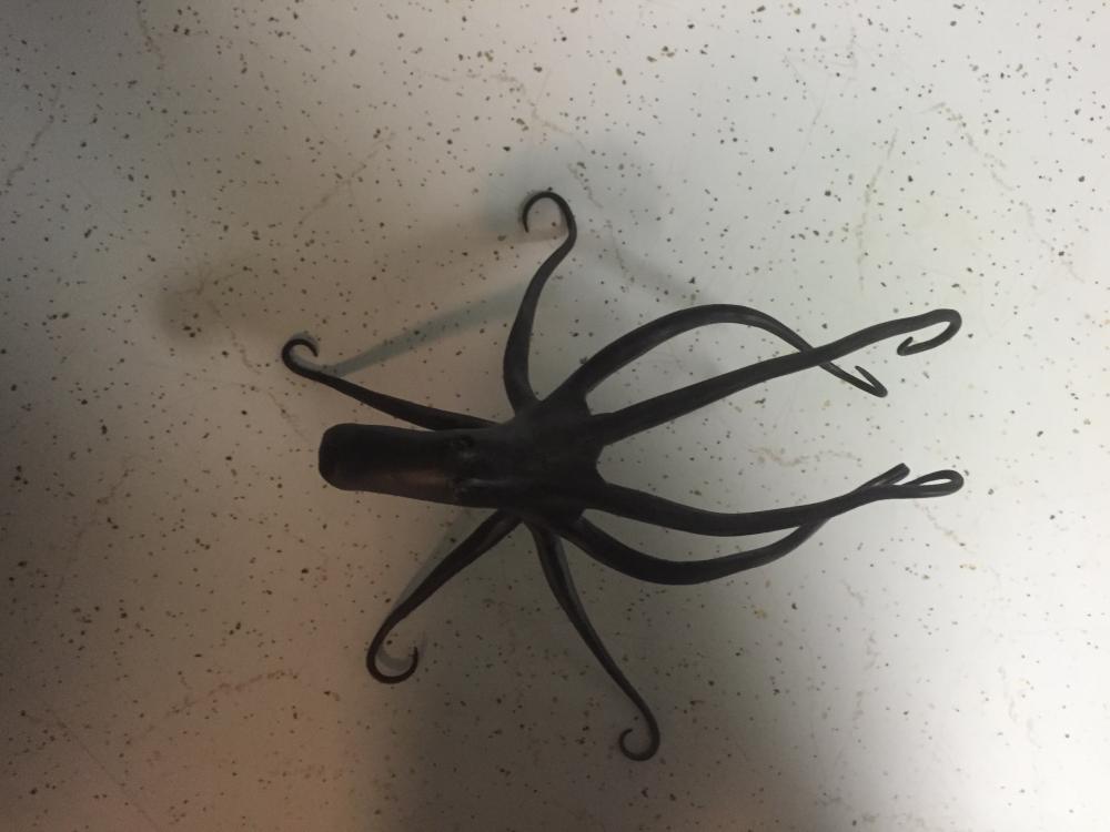

An octopus I made to hold a painted shell for the lady. Needs tweaking yet to hold the shell.
More pictures on the counter. More once I get it right.

A little more webbing between the limbs, perhaps?
Not bad at all Das, I like it. Is it heavy enough to counter balance the weight of the shell?

JHCC, I think it could use a little more as well.

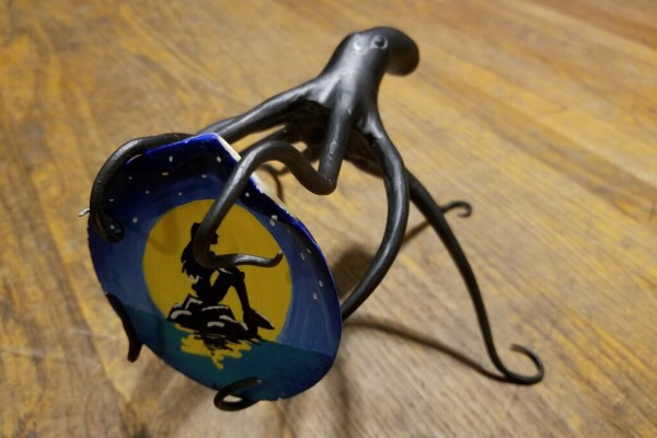

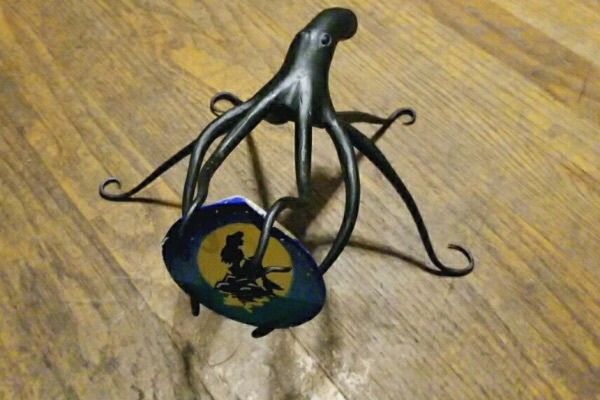

Frosty, thanks. Yeah it has the main weight over the hind legs it sits on and will have no problem holding the shell. It just needs a small tweak and I'll get a picture with the shell after work today.

Not much; just enough to make the legs look more octopus and less sea star.

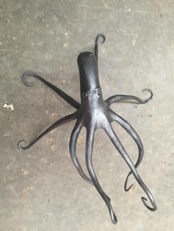

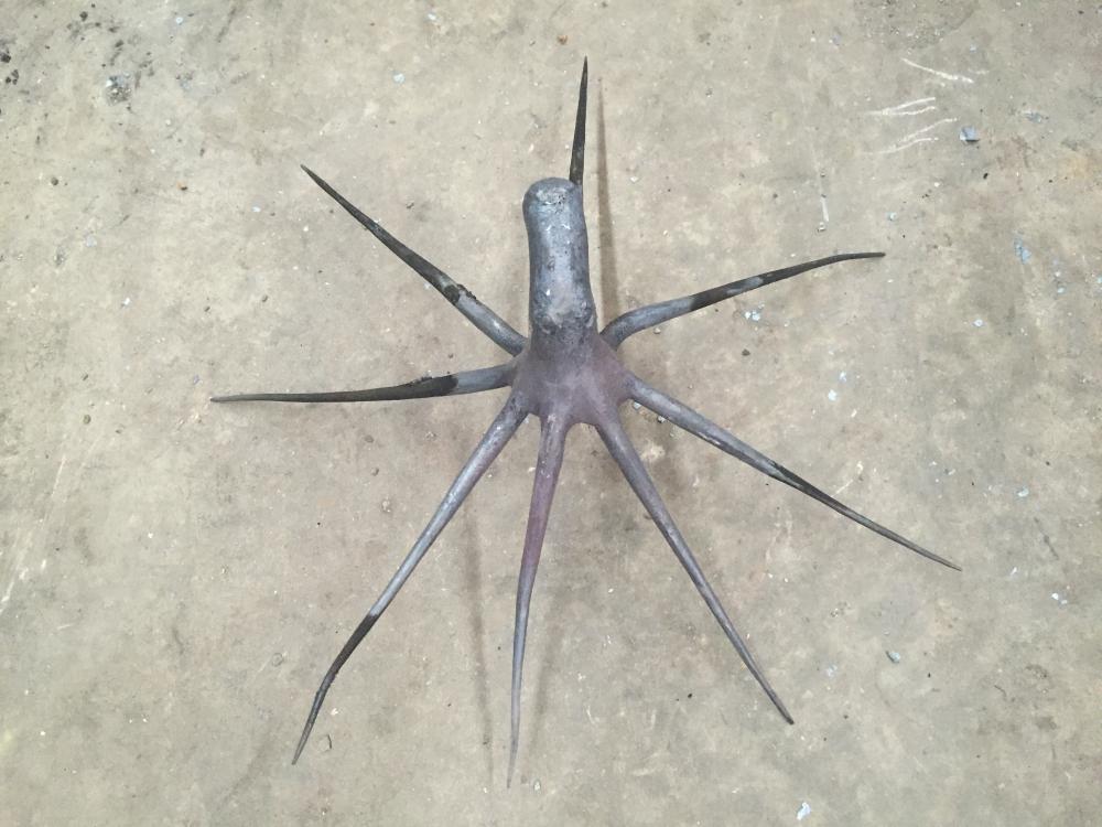

That is way cool, Aric. Amazing when you look at the first pic how you got such a smooth transition from legs to body. Your lady will love that piece.

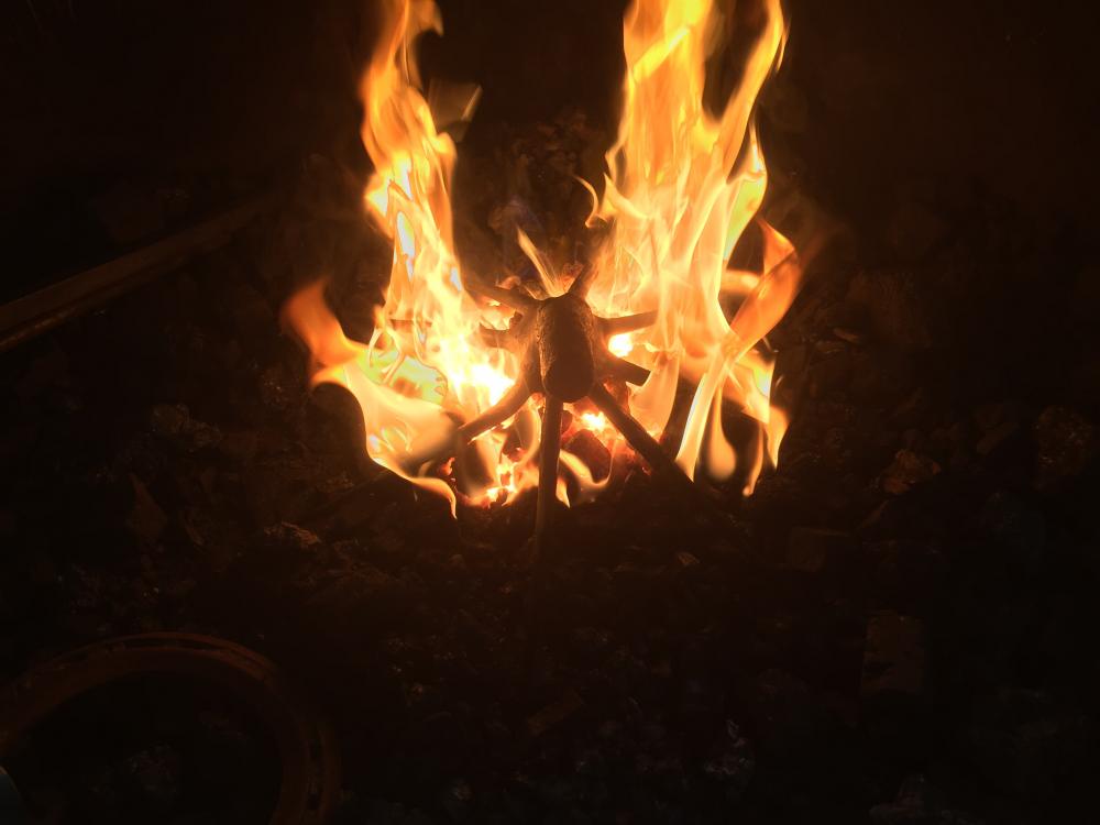

I just eyeballed them to get them even around the body then welded them on, adding a little weld in a u shape between them for some webbing. The smooth transition is thanks to a tie grinder with a burr bit lol. Then some sanding of course. Then into the fire to shape the legs.

Thanks Olfart, yes the girl that painted the seashell saw it and thought it worked out great as well. :)
