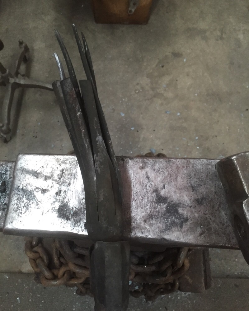

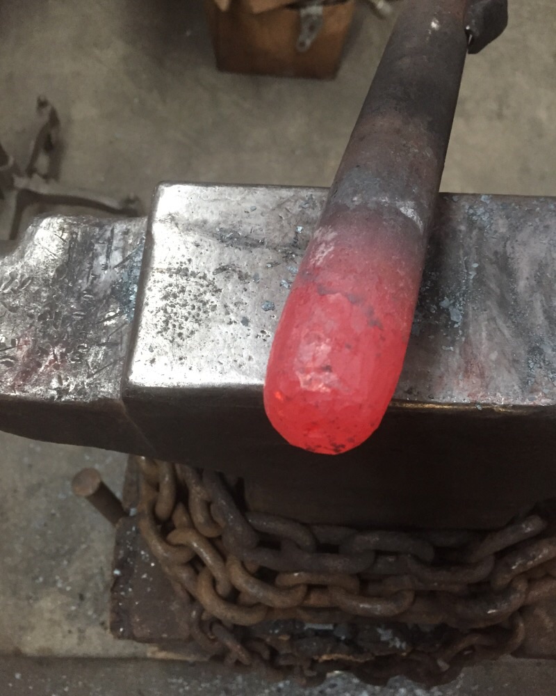

Under da sea. Trying the pipe method. So far a pain but not so bad. Ugh.
Did you split the legs one cut at a time or two sides of the pipe at once?
I used a porta bandsaw and cut down the length. I could have used a cutoff wheel and done one at a time.
Of course, I even noticed the portaband in the background but it didn't connect. I guess I'll never make detective.

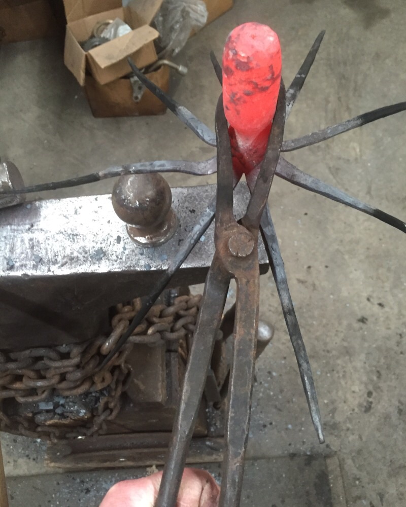

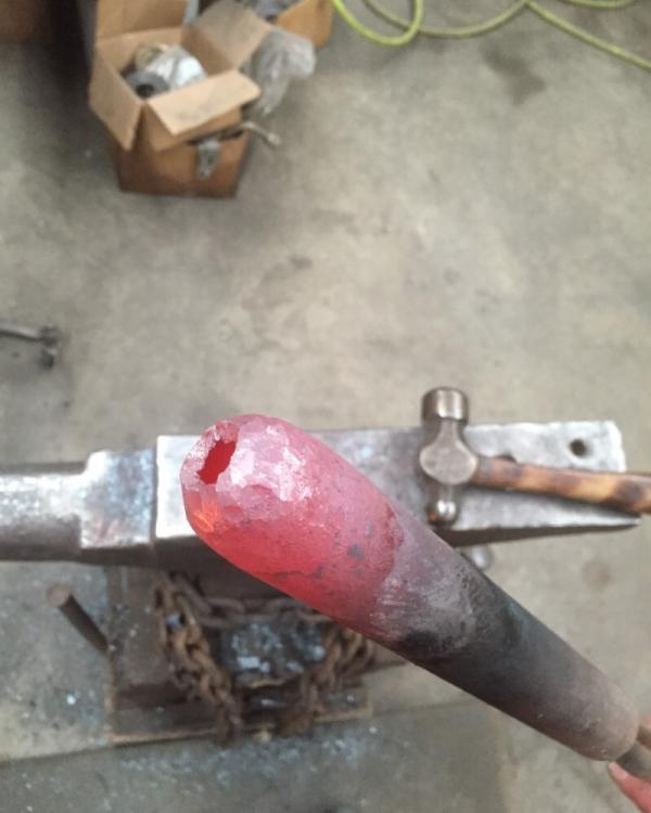

Hah! I didn't even know I had it in the background. Working more on the octopus now.

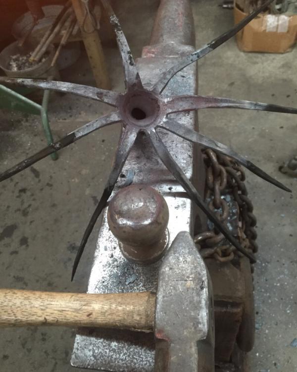

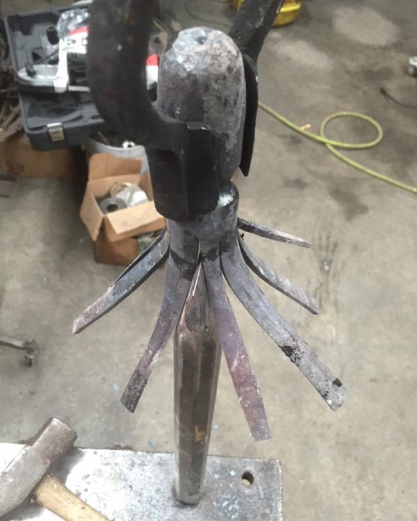

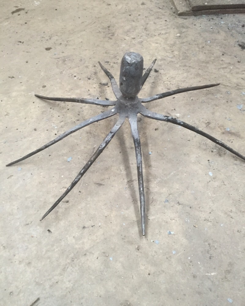

Done for the night on this one. Got the last 4 legs tapered out and spread the base starting with a ball pien then ball hitch hardy hole tool. Now it's time to decide what this sucker will Do. Next I'll round the tentacles a little more then shape them and then bend the "head" back. Then curl the tentacles in whatever position.
Creepy enough? :)  Oh yeah also will chisel at the tentacle base to further the them back.
