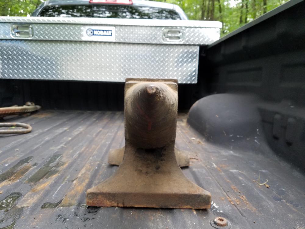

June 17, 20179 yr I finally took the plunge and bought my first anvil. It's a 200lb Fisher-Norris "Eagle". The auctioneer called it a "city" anvil because due to the manufacturing process it doesn't have the telltale high pitched ring. At least that's what he said. I think I may have gotten caught up in the bidding and overpaid a bit for this, but it's really what I was looking for, so I'm telling myself it's OK. I know it's worth is in the eye of the beholder, so I'm not asking if I got a good deal or a bad deal, I'm asking if you would pay $800 for this anvil? Do we have any Fisher experts in our midst? Any feedback is greatly appreciated.
June 17, 20179 yr It's a tool that will last your lifetime and many others. The face looks to be in great shape.. I'm sure it will pay for itself with the work you produce on it, And if you decide to sell it again Call That auctioneer lol. don't worry about it. It's a great usable anvil. Use it in good health. And yes there is a Fisher expert here among us. I'm sure he will post on this soon enough.
June 18, 20179 yr It's in very good shape (not mint but pretty darn good), nice size, collectable name. That was a fair price.

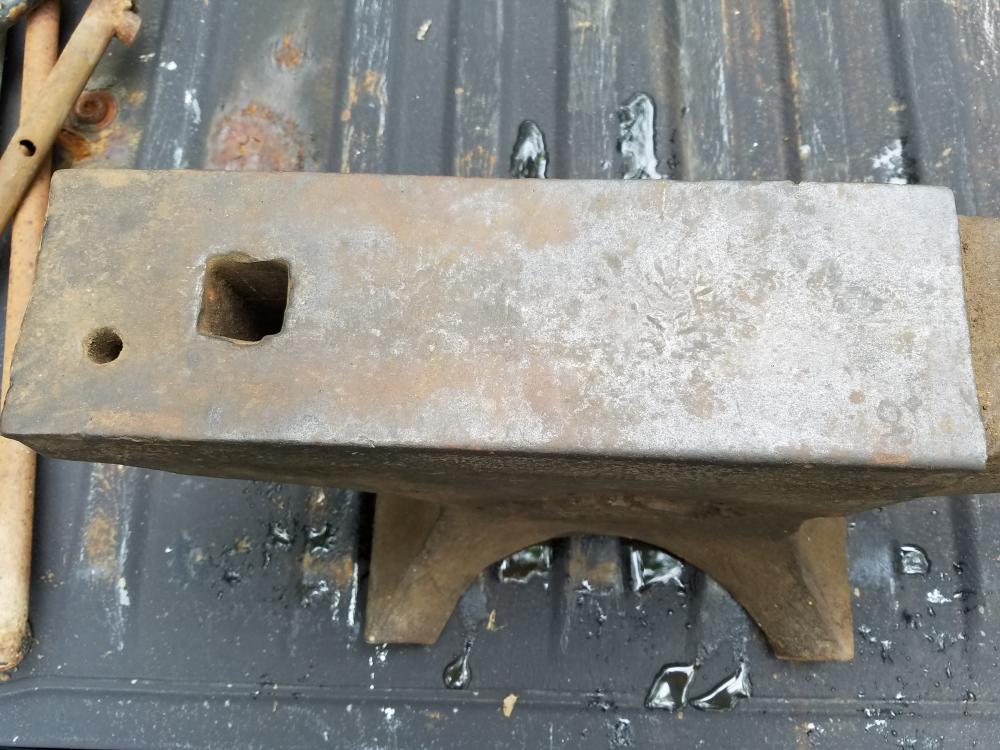

June 18, 20179 yr Author Thank you all for the feedback. There were a few people at the auction that commented they couldn't believe the anvil sold for that price and it had me wondering if I overpaid. Reading all your comments really puts my mind at ease. @njanvilmanThank you for the information on my anvil. 1870's!!!! WOW! I had no idea. I don't want to do anything to hurt it, so would it be bad to try and remove the red paint? Is a wire wheel out of the question? I was hoping to uncover any other markings that might be hidden, but don't want to be excessive with the cleaning process. I've done nothing to this point, so I defer to your expertise. I liked your page on Facebook and I'd like to order a Fisher shirt to help support the museum. Thanks again! Best Regards, Jason
June 18, 20179 yr Nice anvil! Looks like it will only need a light wire wheeling and probably most of the red paint will come off. If you soak a rag with acetone and wipe the painted area first it should soften the paint and probably take some off as well, assuming its just spray paint.
June 18, 20179 yr As Frozenfoge said, go ahead and remove the paint and gently wire wheel the anvil. Then coat it with a light oil, or boiled linseed oil. Then put it to work. I doubt you will find any other markings. But you never know. Be sure to check the base also. Fisher first started dating anvils on the base in 1879 and 1880. After that they were under the heel. All the information for ordering shirts is in the post on the FB site. Any questions, ask away.
June 19, 20179 yr Author On 6/18/2017 at 1:24 PM, njanvilman said: As Frozenfoge said, go ahead and remove the paint and gently wire wheel the anvil. I wire wheeled the anvil today and I tried to be gentle, but there were a few spots I had to be a little more aggressive to get the rust off. I finally had to force myself to stop before the OCD wore that anvil down to a 100lb'er.
June 19, 20179 yr Very nice indeed. Give it a coat of wax or oil (some folks here like automatic transmission fluid; don't ask me why), and you'll be good to go.

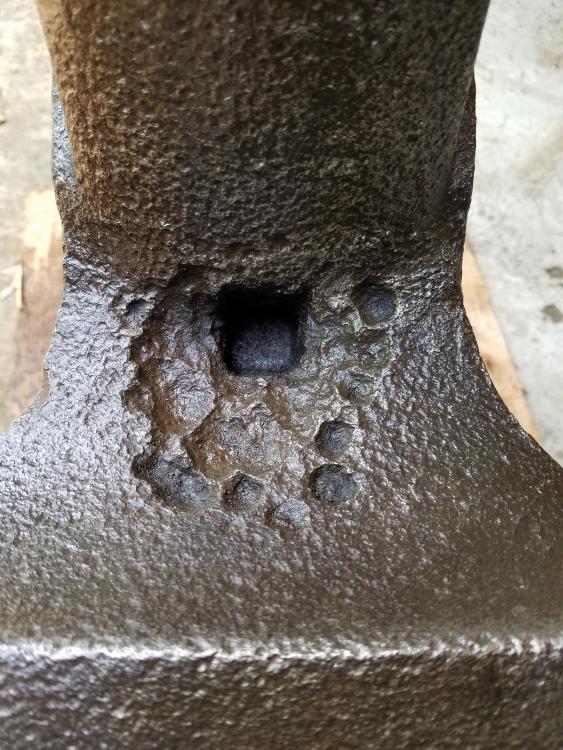

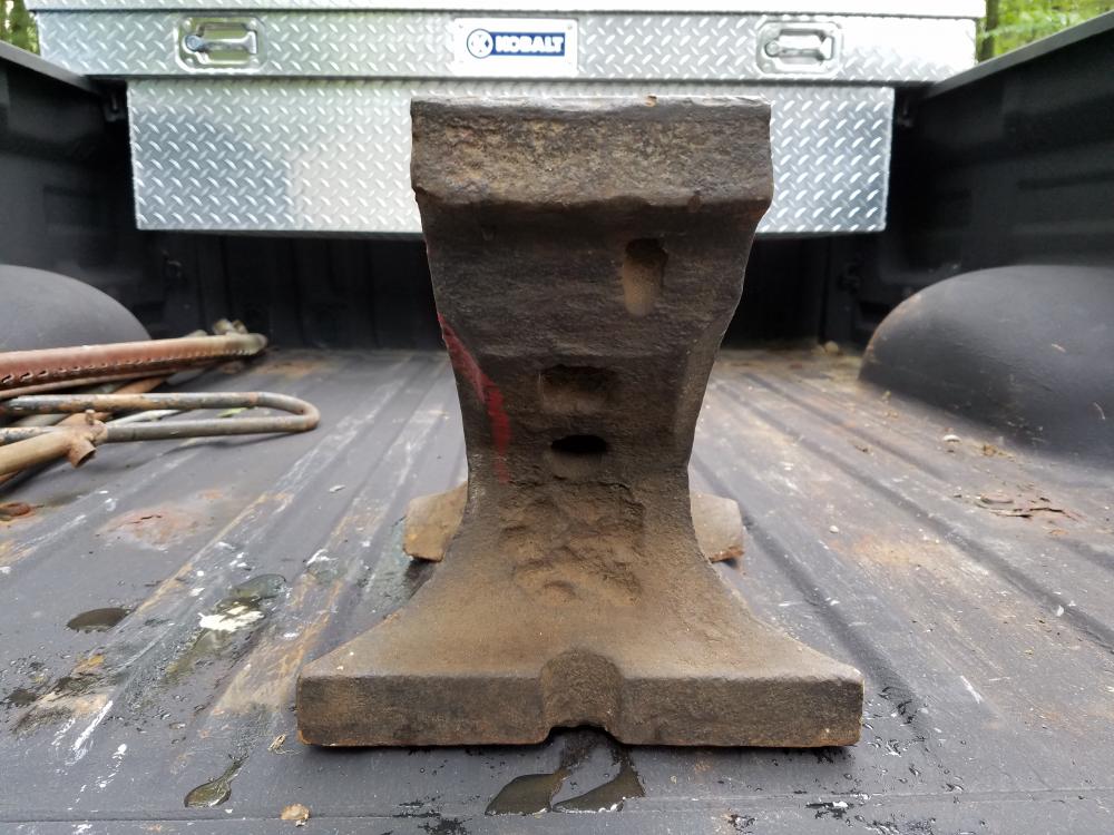

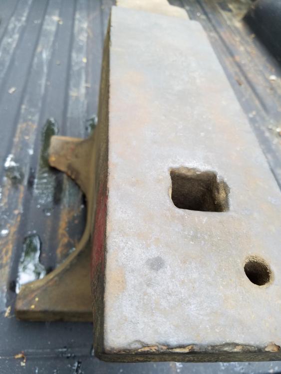

June 19, 20179 yr Author On 6/18/2017 at 1:24 PM, njanvilman said: I doubt you will find any other markings. But you never know. Be sure to check the base also. Fisher first started dating anvils on the base in 1879 and 1880. After that they were under the heel. I didn't see any additional "markings" per say, but I did find something I didn't see before. There are two square holes on either end of the anvil, just above the waist, in the body. They were full of dirt and grease, but when I cleaned them out they are almost the exact same size. Also found a bunch of gouges under the base. I don't know if that was done for a reason by the manufacturer or afterwards by the owner. Not sure why someone would do that? Testing tools maybe? Any ideas?
June 19, 20179 yr @njanvilman can correct me on this, but I believe those gouges are from where the gating was cut off the final casting.
June 19, 20179 yr Somebody correct me if I am wrong, but I believe they were used during the production of the anvil. I believe this picture show these holes in action.
June 19, 20179 yr The "gouges" around the two square holes and on the base are from impurities and turbulence, and shrinkage in the molten iron when pouring. They are nothing to be concerned about. The square holes were used to handle the anvil during grinding and finishing operations.
