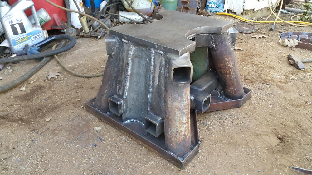

jlpservicesinc Posted May 9, 2017 Share Posted May 9, 2017 I wanted a stand that would offer maxium stability while at the same time offering flotation on softer footing.. I had a design change and is when I made it into the blackwidow.. it has accesory shoes for additions like a foot hammer, tong rack, extra stakes basically a 2" receiver with lock down bolts.. The part that touches the ground is concave so it only touches on the outer edge all the way around.. it is height adjustable by slipping in wood or steel plates depending on what a person has an hand.. Quote Link to comment Share on other sites More sharing options...
jlpservicesinc Posted May 9, 2017 Author Share Posted May 9, 2017 One can remove the side covers and add scrap or weights to the inside of it.. Quote Link to comment Share on other sites More sharing options...

matto Posted May 9, 2017 Share Posted May 9, 2017 What do you have planned for the 4 corner receivers?? Tool tray?? Vise?? Quote Link to comment Share on other sites More sharing options...
jlpservicesinc Posted May 10, 2017 Author Share Posted May 10, 2017 Anything.. I haven't made any accessories yet, but basically it's limitless as the 2" square stock just slides in so if you need a 3rd hand, or a foot hammer or a vise or tool tray.. you just put the 2" square in and build what ever it is you need on it.. the combined weight of the stand and anvil is nearly 700lbs.. The other thing is out riggers.. with pressure feet.. for doing large bends or large bending work in a fork.. Also if need be a wheel kit so it can be moved around the shop.. Really its open to imagination and fabrication skills.. Once the shop is up I'll do more accessories for it as then I'll have more room and time.. Quote Link to comment Share on other sites More sharing options...
Ranchmanben Posted May 10, 2017 Share Posted May 10, 2017 The 2" receivers are a great idea! Really well done. How many pounds of rod did you burn building that? Not a bad thing but there are a ton of welds! Quote Link to comment Share on other sites More sharing options...
Frosty Posted May 10, 2017 Share Posted May 10, 2017 Oh MY! Gad to see you didn't get carried away Jennifer it could've gotten out of hand. Black widow is a good name I like the hour glass base. I don't know if it's an improvement or not but I like the style. Matto, there aren't 4 receiver tubes on the stand, I count 10 of them, 4 up just below the anvil and 6 just above the foot. If at least one accessory isn't a cup holder I'm going to have to drop Jennifer's style score a point. It is one WICKED COOL anvil stand. Well done, VERY. Frosty The Lucky. Quote Link to comment Share on other sites More sharing options...
jlpservicesinc Posted May 10, 2017 Author Share Posted May 10, 2017 9 hours ago, Ranchmanben said: The 2" receivers are a great idea! Really well done. How many pounds of rod did you burn building that? Not a bad thing but there are a ton of welds! Thanks.. Well I use MIG (500amp with push pull on it) so I can't really say.. I would guess maybe a half of 0.035 33lbs spool.. With wirefeeder it goes pretty fast I think this was built in just about 4 days of part time work. Maybe 5hrs a day.. .. I'm pretty well setup on the fabrication stand point.. Still a few places to finish but I wanted it so water would be able to evaporate so there is a space on the bottom of each side.. This will get filled at some point and I will more than likely completely fill in the bottom of the black widow center part.. 8 hours ago, Frosty said: Oh MY! Gad to see you didn't get carried away Jennifer it could've gotten out of hand. Black widow is a good name I like the hour glass base. I don't know if it's an improvement or not but I like the style. Matto, there aren't 4 receiver tubes on the stand, I count 10 of them, 4 up just below the anvil and 6 just above the foot. If at least one accessory isn't a cup holder I'm going to have to drop Jennifer's style score a point. It is one WICKED COOL anvil stand. Well done, VERY. Frosty The Lucky. Frosty... LOL.. Ah,, by now I imagine you are seeing a pattern start to develop/ emerge .. The black widow bottom came about as I had just made it so the anvil would sit on it.. I went to stand in forging position and my toes and boot hit the C channel and it reminded me of just how much I used to dislike banging my feet in the anvil block (my original one in the shop was tapered wood) so before going any further I made the modification.. I used scrap I had on hand from other projects.. Can't wait to get it into the shop so I can actually use it.. I've done a few trial runs with bigger stock working out the back of the trailer but once I get the shop up will be a nice center piece.. Thanks for the compliments.. Quote Link to comment Share on other sites More sharing options...

jlpservicesinc Posted May 11, 2017 Author Share Posted May 11, 2017 8 hours ago, Daswulf said: That's one wicked anvil stand JLP. Really like the hand forged I bolt hold down. Thanks for showing it. Thanks.. I know its said time and time again that large anvils over 300lbs werent usually bolted down. But I really like the anvil mounted to the base solidly.. this was a proto type design and really loved the way it came out and looked.. It is really solid and I can add blocks up to about 3" before the bolts run out of threads.. At some point I'll have to make another set with longer main bolts.. I used the basic design of this hold down system in the blacksmith trailer but simplified it with a straight 1/2 rod on each side threaded on the end.. This then goes through the middle tension bolt and then the end plates are put on.. This way its a lot easier to make as you only need 2 bolts with eyes vs 6.. Of course it lacks the really neat vintage look but it works very well.. I've included pictures of the 2 designs side by side for reference.. 8 hours ago, Scrambler82 said: In all honesty... It looks like a piece of yard art my wife just went out and pay $$$$$ for ! I like it and the Receivers are a great idea, I am surprised more people haven't built them in to their stands; I added two to my welding table design just a week back, ordered them up from a local store, glad to see the idea in an Anvil Stand ! I will make a MIG Torch Holder to fit so I can move it end to end as needed. Great work ! Does this mean I am the originator of something finally??? I ship nationally.. I'm having a spring sale on art deco type items.. Also some steam punk.. Thanks.. I'm really surprised I haven't seen this before especially with all the fabricated stands now.. I did have a picture somewhere that I had a pintel hitch in one side and a ball in the other.. One of my friends asked where the wheels were.. 5 hours ago, Anachronist58 said: So JLP, I have finally had the chance to parse this thread - most impressive. Very nice to see you have weighed your work with (is that a steelyard?) Also, before internet access came to my corner of the world, I built a modular half-ton crane wagon based upon those square tube goezintas (as named by Thomas, or Frosty?), so I will be expecting royalties......... Seriously though, very inspiring modular design. So much more than just an anvil stand - the Black Widow Multi-Tool. Robert Taylor Yes, thank you.. It is a Steelyard.. I have several.. One goes to 100lbs total and the other to 400lbs total the 400 runs 100lbs on the fine side and 400lbs on the quarter weight.. Then a few smaller ones.. Super handy.. I'd love to find one in the 1000lbs range or a model/drawings with measurements.. Be really neat to have.. Well that was a wagon but in this case who came up with the design first. Goezintas and who has more goezintas mine or yours.. LOL>. thats cute.. Have any pictures of the wagon? Love to see it. . Quote Link to comment Share on other sites More sharing options...
