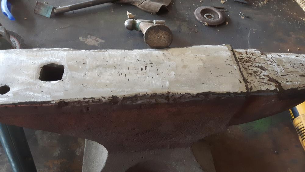

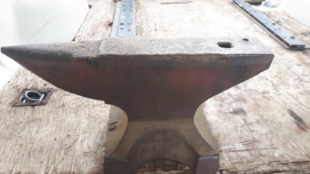

Well tilted says it . Picked up a anvil the other day. Has not bad rebound. The face has been beat up really bad by chisels so I figured no big deal as people can be hard on stuff. Well upon future inspection while I was grinding away the pitting. I realized that the face is extremely soft and dents very very easily looks like I just bought a hundred and thirty five pound piece of cast iron
It does have a steel free so I can tell by the spark  difference between the face and the base that is cast iron but I don't know I looked into getting some hard surfacing rodds  would that work to build up just a little bit I appreciate any advice on this thank you
No! DO NOT REMOVE MATIERIAL FROM AN ANVIL! The only time you EVER remove anything is when dressing sharp edges. If it is close enough to flat that you would even consider a belt grinder, it is NOT worth removing 100 years of use. Many of the people here actually prefer a little sway.

Well.....a belt sander still removes steel from the face, and is still considered grinding the face. Yes it would level it, but then your stuck with an oversized paper weight. Or in other words, you still ruin it! I just hope your not asking this question after you did this.

Why level the face? If it has a depression like an old nags back, that is an area that has been worn away, leveling the face off is simply wearing away the better sections. Use the sections that are good. A depression is a bonus when straightening a piece of metal.
Do your research before you make a modification that you can't undo (easily) on a piece of equipment that costs more than a night out at McDonald's, or in other words, it's best to do your research! May we cry over a before and after pic? I am assuming you are new to the craft, its fine, 1. It's not my anvil, and 2, you now know what not to do. My guess is that the anvil really wasn't that bad, but is now worse than it was before. As stated earlier, and in just about every other thread about anvils, YOU DONT NEED SHARP EDGES!!  Not only do you not need them, you don't want them! They are more prone to chip, and aren't useful.

ok, doesn't seem as bad as I thought...but than again, you cant see how you damaged the heat treatment of the anvil

In not new to this . But you have to understand that I ground the face because of all of the massive pitting from miss use with a chisel at some point. Now I admit that now where it's at I realize that I more than likely shouldn't have done that. But Imy more than willing to work on it to repair my mistakes

Vulcans often have soft faces anyway in my experience and so are often marked up on the faces; better to planish than to grind!
"Not bad rebound" totally meaningless unless we know how much experience you have with anvils---(which getting a chisel scared Vulcan would seem to be low)
That is why we suggest the ball bearing test.  Simple, Cheap, Easy and provides objective results easily interpreted.
Now the damage has been done so use the heck out of it and get it to pay for a better replacement!  Still better than a rock!
I do not consider Vulcans ASOs,  just the lowest tier of real anvils (through grinding on the face rapidly changes them to an ASO).  He may get some work hardening through use also and it will teach to keep the workpiece *hot* and hammer control to avoid marring the face worse.  Vulcans are quiet anvils, a feature when trying to fly under the radar or working in a space enclosed with hard walls. They are not too my taste; but I have had friends who loved them.
