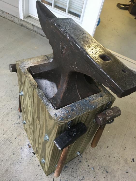

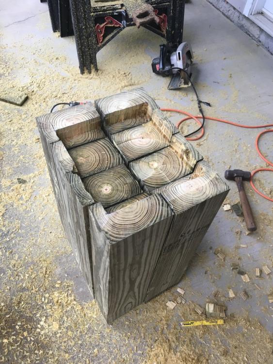

Melw45 Posted April 4, 2017 Author Share Posted April 4, 2017 I am calling this done. For now. The old stand and the new and improved with the anvil mounted. You can see the supervisor checking to see if i did a good job. I am thinking of putting some legs on the old stand and converting it to hold My yet to be built forge. Thanks for looking! Mel Quote Link to comment Share on other sites More sharing options...
arkie Posted April 4, 2017 Share Posted April 4, 2017 Nice sturdy stand; it should serve you well. If I may, here's a suggestion for hanging any hammers around on the stand. Use round rod for the loops rather than flat bar stock. On my stand, made of 4x4's, I made a strip from 1/8" bar stock with loops in it and screwed it to the base. The first time I used it I noticed that when dropping or placing hammers in the loops, the edges of the bar stock started chewing into the hammer handle. I took that off and replaced it with loops made from 3/8" round rod and in 4 years have had not one hammer handle damaged. Quote Link to comment Share on other sites More sharing options...

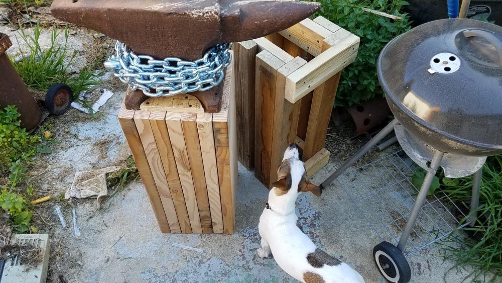

Arkham Posted April 7, 2017 Share Posted April 7, 2017 Mel, some dirt and an air supply added to that round shaped object in your last photo, and you have your forge. Just a thought. Quote Link to comment Share on other sites More sharing options...
Melw45 Posted April 7, 2017 Author Share Posted April 7, 2017 I will do something like that when I finish moving out of California. We keep having spate the air days. With large fines for any solid fuel fires. Thus the propane forge I am building seen in my other thread. I read the thread about the box of dirt forge and it sounds interesting. Mel Quote Link to comment Share on other sites More sharing options...
SReynolds Posted April 10, 2017 Share Posted April 10, 2017 I like a truck brake drum as it makes for a very stable base i.e. the foot print is very small and works very very well on nearly any surface. Flat or irregular. I use a large section of log in which to mount the anvil upon. The log is lag screwed to the flange of brake drum. I'm talking about a truck drum; 16.5" shoes by 8-5/8" wide and 11-plus inches deep. From a truck. You need a log diameter about 14" minimum to mount the drum to the face of the flange. There are ten holes there to run some large lag screws through. About 13-15" tall depending on height of anvil......and your hand. 100 pounds? 150? Then the log. Very secure base. Dirt cheap. Folks are asking me to provide them with drums and logs. I have better things to do, honestly. The cool factor is I can roll it anywhere. Quote Link to comment Share on other sites More sharing options...
ThomasPowers Posted June 9, 2017 Share Posted June 9, 2017 Are you assuming the base of the anvil is dead flat? Are you assuming that wood won't expand and contract with changes in humidity and every board will do it slightly differently? If it will be a "permanent stand" I would trace the outline of the base on the top of the stand and then rout it out say 1/4 to 1/2 inch and then bed the anvil down into that space with silicone caulk. You could also fit the anvil to the base by checking to see where the anvil is making contact and then lower that slightly, recheck, etc until the entire base is making contact. As my smithy has a dirt floor I don't have to worry about wobble due to inequalities of the floor or the "stump", When I take them to teach we use wooden wedges to stabilize them on a different surface. Quote Link to comment Share on other sites More sharing options...
Melw45 Posted June 9, 2017 Author Share Posted June 9, 2017 7 hours ago, Scrambler82 said: How's it working out and why so much chain ? I know, to cancel noise, but is all that needed ? I was thinking chain on the stand I am working on but I didn't think I needed that much ! I got my Anvil with to pieces of right angle steel for clamps, did it quiet it down. I was going to use something similar to the original clamps, was thinking chain but do not want that much ! What does the future hold for the stand, tool racks, tool slots, maybe a steel top, just asking ! Working good. The chain is just a tow chain from harbor freight i did not feel like cutting it. I would like to have some tool holders just have not made any yet. The anvil is held to the top of the stand by silicone caulk. The stand looks some what different now I have put some plywood cut to fit the shape of the anvil center curve. I smoothed the top and bottom with a belt sander. The bottom still rocks on hard floors but works fine on dirt. I would like to mount it in the ground when i get to it's permanent home. Not sure hoe i will do that yet. Mel Quote Link to comment Share on other sites More sharing options...

Judson Yaggy Posted June 10, 2017 Share Posted June 10, 2017 On 4/7/2017 at 6:45 AM, Arkham said: Mel, some dirt and an air supply added to that round shaped object in your last photo, and you have your forge. Just a thought. That would be a cruel thing to do to the poor little dog... Quote Link to comment Share on other sites More sharing options...

Melw45 Posted June 10, 2017 Author Share Posted June 10, 2017 You can see the ply half rounds in the photo with the chain. I would never turn my dog in to a forge. She is the good one. So far the only time scale started any thing like a fire was when I pulled a spring out. Some got down in a crack in the stump and started smoldering. Mel Quote Link to comment Share on other sites More sharing options...
