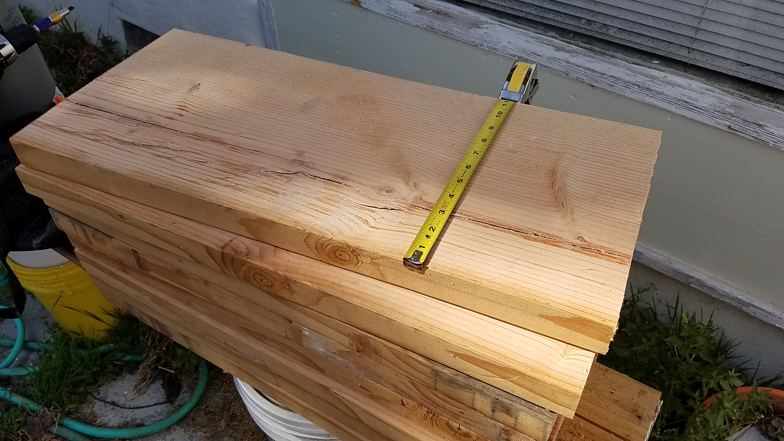

I was out of good 2x4s. So quick trip to Home Depot. To see if they had any cheep ones.
What I found in the Cull pile was in the first pic.
What is there is a 20 foot 2x12 cut in half and a 8 foot 2x11.
The second pic is the 2x12 cut to the 26" height I need.
I was able to get 8 lengths out of the 2x12.
May have to abandon one for a large crack. That should not be a problem as the anvil is on a 11x11 footprint.
The cull wood came to $9.87 for both pieces.
So I have changed the stand completely.
Next is to score some all thread and flat steel to reinforce the block.
Thanks for looking!
Mel

Made some progress today. First pic is of the glue up. the next one is the test fit of the anvil.
The top of the anvil is just below my wrist joint. Just need to find some chain to tie it down to the stand.

To provide a update. I did some more sanding to the stand top and bottom.
I appears that my anvil has some wear on the feet it rocks some.
I read that some have been using silicon to mount there anvil. How has that worked out?
As you can see from the photo I wrapped the chain around the anvil. Wow that worked a treat.
The ring is bearable. Not painful now.
