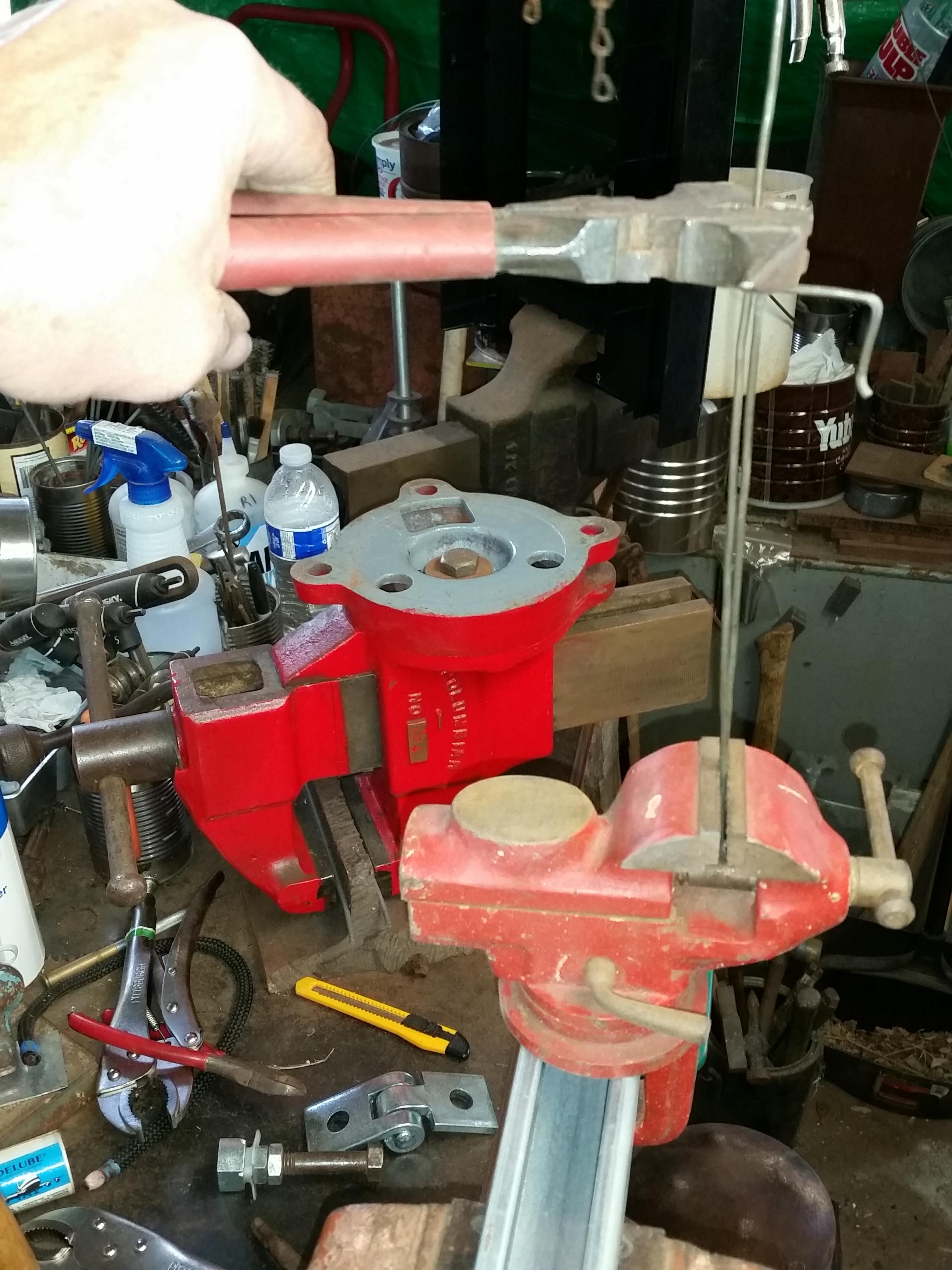

Anachronist58 Posted December 27, 2016 Share Posted December 27, 2016 Below illustrates a matter of scale - a Columbian 604, and a no-name jewellers vise with built-in anvil. The jewellers vise is of exceptional quality, and I can go at it with my 4 oz ball pien all day. The Columbian has a split segment of locomotive rail between its teeth and is quite happy under heavier work. We always sacrifice durability when applying force to mechanical assemblies, but some of these older tools can really take a whoopin. Robert Taylor Quote Link to comment Share on other sites More sharing options...
