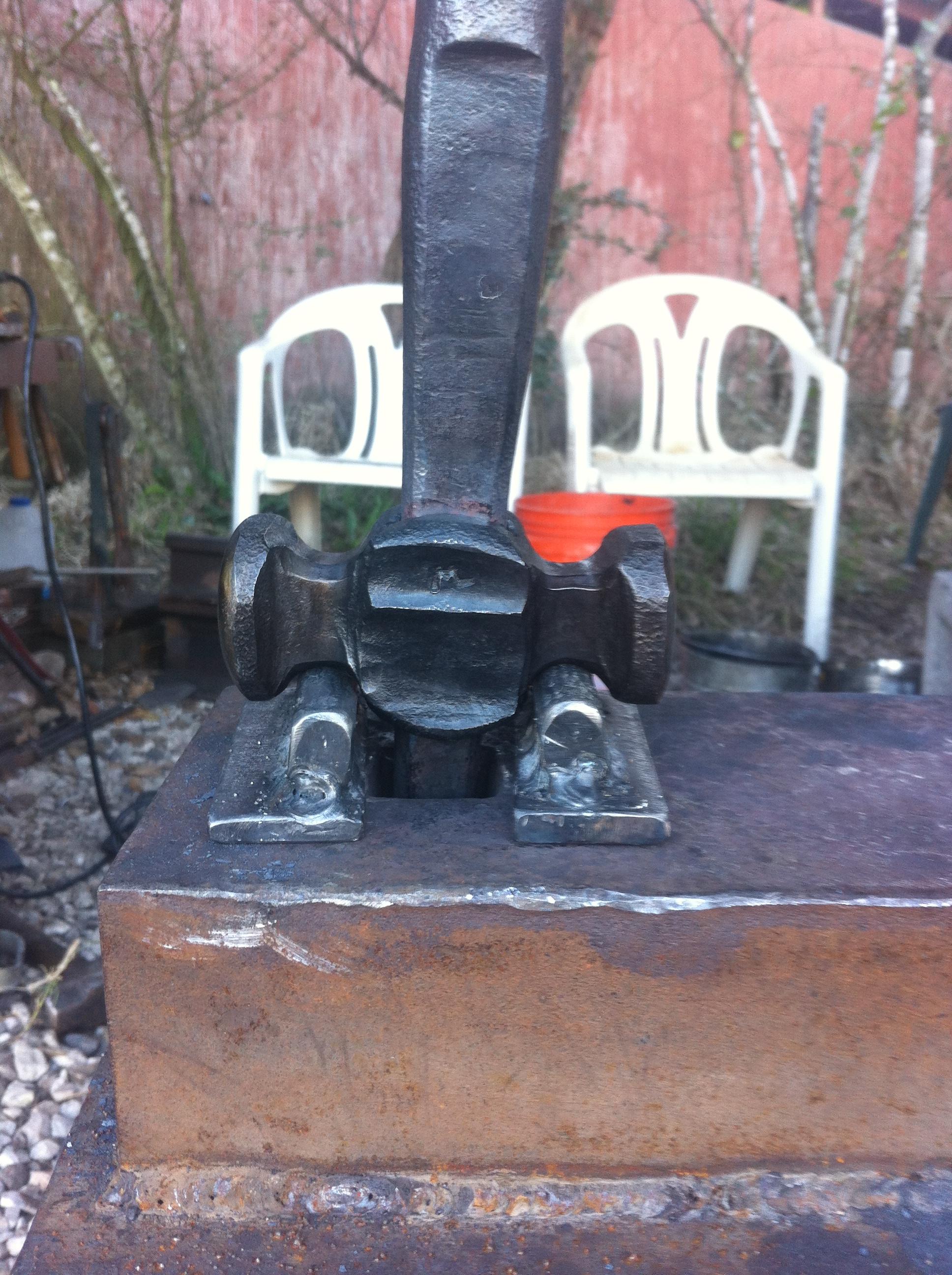

Mark Ling Posted January 29, 2017 Author Share Posted January 29, 2017 My first hammer! Made from a large pin of some sorts, about 1 5/8" in diameter. It weighs a little more than 1 1/4 lbs. I figured I would start small, and get the process down before I move up to making larger hammers. This one wont get a whole lot of use, as I don't use hammers this light very much, but I enjoyed making it. I was able to persuade my dad to strike for me, so that made it fun. I fullered it a little thinner than I would have liked, but I was trying to get one side even, and before I knew it I had forged it down a lot. So, I ended up having to do it to the other side of course, but I think it looks fine. Also included some pictures of my "hump tools" used for supporting the hammer when you are driving the drift after you have begin spreading the cheeks. After I made the hammer, I decided to make a wedge for the handle, and then I made another, and anther, and ended up making 6. Quote Link to comment Share on other sites More sharing options...
SJS Posted January 29, 2017 Share Posted January 29, 2017 Good Job LB. It is wonderful that you are taking the time to make lovely tools. Self discipline, and patience are marvelous character traits, and will benefit you all your life. Having nice tools to play with is pretty great too... Don't dismiss the small hammers, they definitely have their place. Don't rush the big hammers, it is too easy to give yourself repetitive stress injuries. When I was young my favorite hammer was an 8# hand sledge, but now I'm not even 50 yet and my favorite hammers are 2-2.5#. Having an iron will ruling over mere flesh and bones, leads to injuries in my experience... You are getting a good start, take care of yourself and use good judgement, so you can do this for a Long Long time... Quote Link to comment Share on other sites More sharing options...

Frosty Posted January 29, 2017 Share Posted January 29, 2017 Your skills are improving almost too fast to follow. I strongly agree, do NOT use too heavy a hammer, you're too young to feel the damage but it catches up. You'll be selling tools before long. Frosty The Lucky. Quote Link to comment Share on other sites More sharing options...
arkie Posted January 29, 2017 Share Posted January 29, 2017 Very nice hammer, LB! You'll find you will use the hammer more than you realize. Keep up the great work. x2 on SJS's comments...young folks try to do too much too soon with heavy hammers. Result, long term injuries....unless you like wrist, elbow and shoulder surgeries!! My go-to hammers are 2#, 2.5# and 3#. Quote Link to comment Share on other sites More sharing options...
Mark Ling Posted January 29, 2017 Author Share Posted January 29, 2017 Thank you all for ya'lls very kind words! I think I should maybe say this, because when we hear "heavy hammer" we think of different weights. When making hammers, anything over 2.5lbs is heavy (in my opinion). Not so much heavy to swing, but heavy forging (again, in my opinion). I probably wont attempt anything over 3.5lbs for a while. I would like a 4.5lb hammer though, which I will make eventually. I swing a 3.5lb rounding hammer almost exclusively. I do swing a 4lb when doing anything over 5/8", and I also use a 3lb cross pein, because that's my heaviest cross pein hammer. What weight do you all consider a heavy hammer to swing? Littleblacksmith Quote Link to comment Share on other sites More sharing options...
