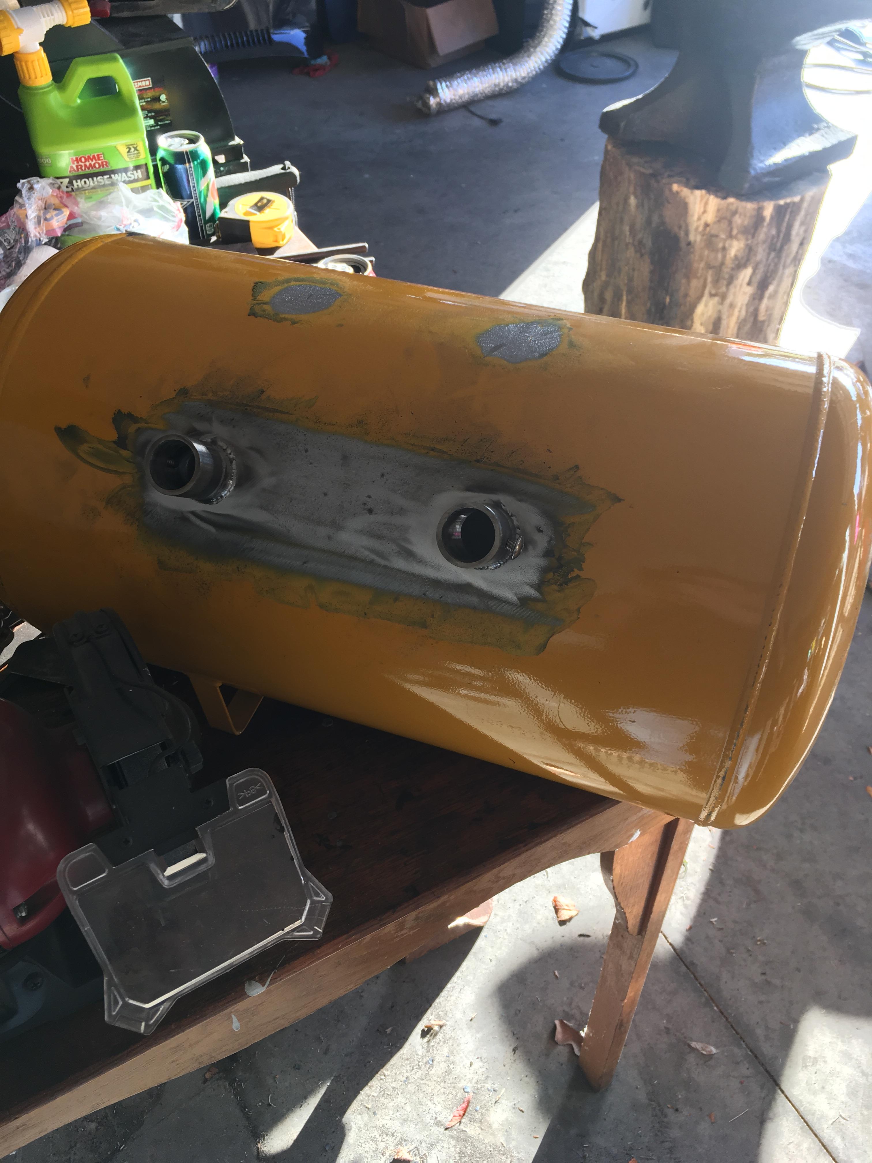

  6. After the lining and the brick in the floor, if my math is right. It should only be about 550 cubic inches. The last one I built was right around 950 cubic inches, by the way I'm also using the same burners. My other one would come up to heat just fine, but it took it around 20-25 minutes to come up to full heat, the whole idea behind this smaller one was to come up to heat quick, and besides the fact that I wanted a flat easily replaceable floor. Deminsions of just the housing are 13.5 long, 13 wide, 10.5 at the tallest point of the elipse. With a 2 inch lining of inswool, a couple coatings of satanite, ict-100, and the 2 and a half inch firebrick should give me a forge chamber of around 5.5 at the tallest point, 8.5 wide and 13.5 inches long.
  7. 2 Naturally aspirated 1 inch burners.
  8. What would be the best burner placement for a half round forge like this? I'm not quite sure what the best angle would be. Would you just mount them like it's a full round and get the same swirl effect? I don't think it would work like that but I don't know.

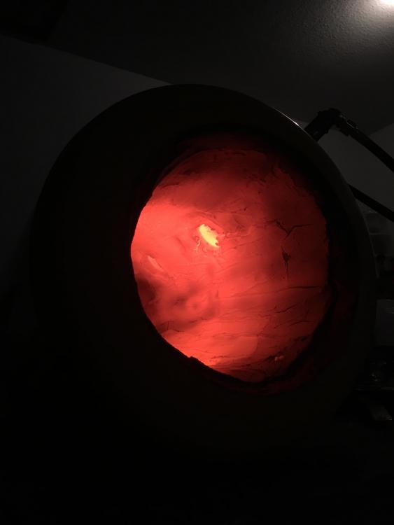

  13. Well, I ended up taking the flare off. Moving it about 2 inches back from the liner. Works great! The burner stays nice and cool. No more possible melted propane line. Man that could be real bad. Glad I caught that in time. I figured the burner needed the flare but it doesn't. So we're back in business!

  15. Yeah I wasn't asking you do to any math for me. I think it would just need another burner for its size. Anyways, yeah the flare won't fit inside the mount. Didn't quite think it through. I didn't think it would need too! Oh well, xD I also have noticed the top off my burners. The brass connector that's on the propane line. Is hot to where I can't touch it. Is that normal?
  16. I have the back blocked off completely with some firebrick. I just need to get some more so I can cover the front. Haven't been to the store to do so. The way I have the burners held in place I'd have to cut everything apart redrill and weld the mounts back. I don't have a welder in the shop yet. I really need to get one. Not to mention they just banned personal projects at work. So that's kinda outta the option for awhile. I could just cut them off and take a carbide bit to the hole but then they'd more less be dangling. Rather have them securely mounted. You can see how I have them mounted in the picture. They just barley slide in. I only left about 10-20 thousands play, also I think this housing might be a little big. 12" diameter 22 inches long. Thanks again frosty.

    So finally getting the satanite over the inswool. Was curing the first layer when I noticed my burner flare was glowing abnormally hot, to me at least. I'm all new to gas forges. I've seen people say "oh yeah theyll do that its okay" and some people say" no no that's bad. So here I am. After about a minute of burn time they start flowing pretty cherry red, I had the flare adjusted outside of the forge where it wouldn't get hot like that at all. And I've adjusted them in the forge as well, I can't really move them any deeper in the inswool because the flare just sits over the pipe and a hole is drilled and taped for a stud to hold it on. Here's a picture of it running about 3 or 4 minutes. I would assume they would get that hot anyways because the temperature the forge gets. It makes sense that they would, but I just feel like they shouldn't be. Anybody with some more knowledge chime in?
