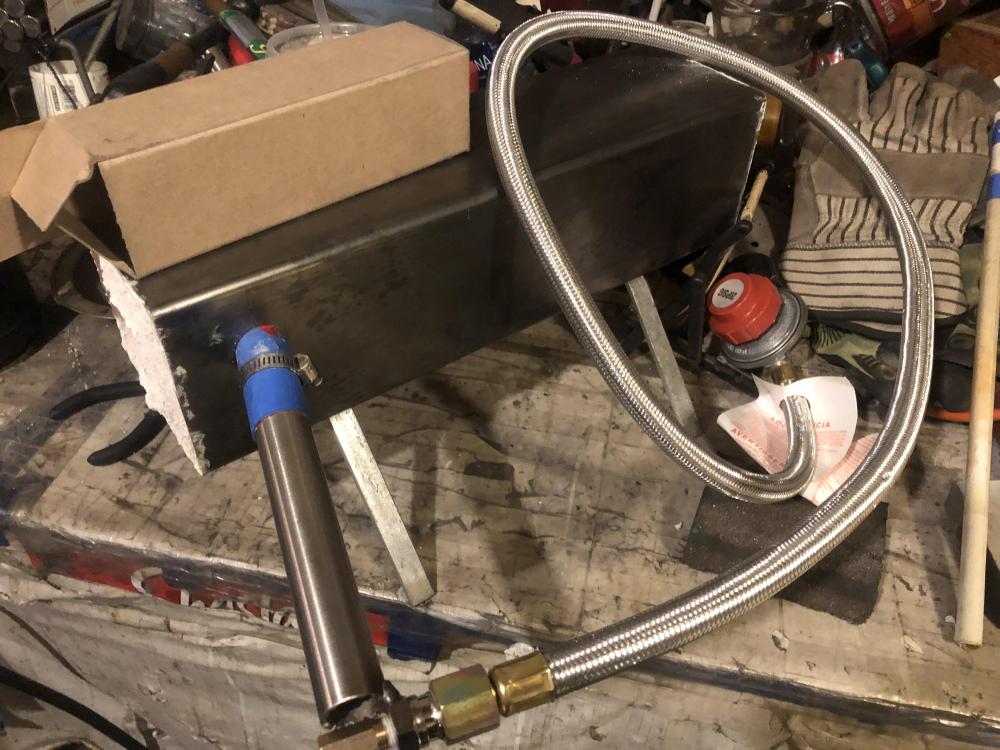

AngryDaddyBird Posted January 19, 2019 Share Posted January 19, 2019 Mods if I’m posting this in the wrong place please let me know or just delete it and I apologize. Here’s another pretty simple one I made after the Micro forge. It’s been drying for 7 days now. I have to put the burner on it and it’s ready. I attached the Atlas 30k with atlas regulator hose but think I’ll try my modified torch first?? I think its ready anyway??? This Build was made with these items: 1) housing (4” steel square tube”) 14.5” long 1/8” wall thickness 2)Kast-O-Lite 3000 3)Metrikote (this was the final chamber coat) 4)2 steel 3/4 bars 12” long and 1/8” thick bent at the 4.5” mark from each end to make legs 5)nuts12), bolts (4)and lock washers(8) to attach legs 6)burner, I haven’t decided what burner to use? I was planning to use my modified torch head but think I might just use my atlas 30k burner assembly? 7)2.5”-2.75” tube( I used a 2.5 outer diameter pipe for the burn chamber The build was easy enough. Fist cut the square tube to length. Then locate and mark where your leg bolts will be. Then mark your burner location. Drill all holes. Important to do this next 2 steps! Install the bolts for your legs! Either seal or put a tube into the burner port till it reaches the chamber pipe! Ok now seal one side of the housing (square pipe) with blue tape. Now flip the sealed side down and coat your chamber pipe with oil or pan! Now center your chamber pipe in the housing (square pipe) making sure it’s centered on both ends! The pipe needs to be longer than the square tube housing! Mix up Kast-O-Lite 3000 to texture like mortar and start packing it in around the pipe and ever 2/3” be sure to pack it down nice and good! I tamped it with a wooden dowel every 2-3” until ful to the top and level. Leave it a couple hours to set up firm then you’ll be able to move it to a better place to cure. You might want to remove or at least twist the pipe to get it out easier but I left mine in until the next day. After a day I twisted the pipe and it did. So after a day I decided to take the chamber pipe out. It took some time but it came out without damaging the chamber! I mean it TOOK SOME TIME! But hey it’s only my second attemp at a forge! After the pipe was out I peeled off the blue tape from the opposite end and let it dry another day by the heater. After dry I mixed the Metrikote with water until it was like latex paint and coated the burn chamber and both open ends. I let it sit for DAYS Next to my garage heater and today is Day 7! So I think I can try to fire it up starting at low heat for few seconds or minutes eventually bringing it up to forge temps over a few hours time OR I could just wait another few days or a month to be sure it dries haha! Anyhow I still have enough supplies to make yet a third forge. I’ll really think about it before I do. Now when making this one I didn’t think much about heat reaching the outside housing as you can tell by the thin walls haha. If I had to do this build again I’d use 6” diameter square or round pipe to make sure the outside walls wouldn’t get to hot. I’m sure any forge eventually get veryhot but I think this would have helped. So what size is this thing considered? Micro or mini? How about “Micrini” like Mee-Cree-Knee haha. What burner will I use? Well I might just use my torch but at use my atlas burner instead! It fits right in there perfectly as seen in a picture. But who knows. All I know is it might be full of flaws but thought you’d all enjoy see my mistakes so you don’t make them same ones. I’ll keep you all updated when I fure it up! Enjoy the pictures! Quote Link to comment Share on other sites More sharing options...
Another FrankenBurner Posted January 19, 2019 Share Posted January 19, 2019 There is a heat cycle to finish kast o lite. Most people let it dry for a week or so and fire their burner for a minute and let it cool, then 2 minutes, then 5, then 10, and so on. I did something similar with mine and it turned out well. Just don't turn the burner on full blast and let it go as the water escaping quickly causes problems. If my forge has sat for longer then a few days, I also start up slowly as I once read that refractory materials absorb moisture. It sounds like this forge does not have the 1" of ceramic blanket that your can forge had. This adds to the mass and reduces the insulation which will require more fuel to heat and may lower your temperature limit. It looks like you have a higher output burner to heat it so it may not matter if you don't care about fuel usage. Your outer shell may also get quite hot. I look forward to your update to see how it performs. Quote Link to comment Share on other sites More sharing options...
Frosty Posted January 19, 2019 Share Posted January 19, 2019 You're over doing the cure time and heat cycles guys. KastOLite does not dry, it is a water setting refractory and for maximum strength treat it just like concrete. After it sets keep it at 100% humidity for as much as 7 days. Also like concrete the wetter it's mixed the weaker it is when set. Once it's set and you've given it a day or two at 100% humidity to cure. (I sealed mine in a plastic trash bag with a few soaked rags) Once cured fire the burner for a minute or two stop shy of red heat and let it cool. Fire it and let it soak for a bit at red and let it cool. Then you're good to go. None of us cares about getting maximum physical strength from Kastolite 30, we're not running rail cars full of scrap over it. As for observing "proper" set and cure procedures the stuff is intended to trowel or gunnited onto furnace walls that have only been shut down and cooled enough men in aluminized suites can make repairs. The stuff doesn't require careful handling at all, just don't get silly. AngryDaddyBird: I'd be concerned about the round chamber in the square shell, the large difference in liner thickness being the issue but I don't think Kastolite cares all that much. The aggregate in the mix is there to allow steam to escape and movement during thermal cycling. Again the refractory is water setting, it does NOT dry so any moisture is the product of condensation and capillarity WILL draw it into the liner proper. You can't keep it out so it needs a way to escape. Frosty The Lucky. Quote Link to comment Share on other sites More sharing options...

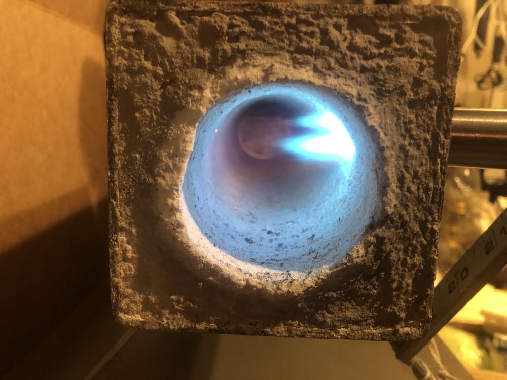

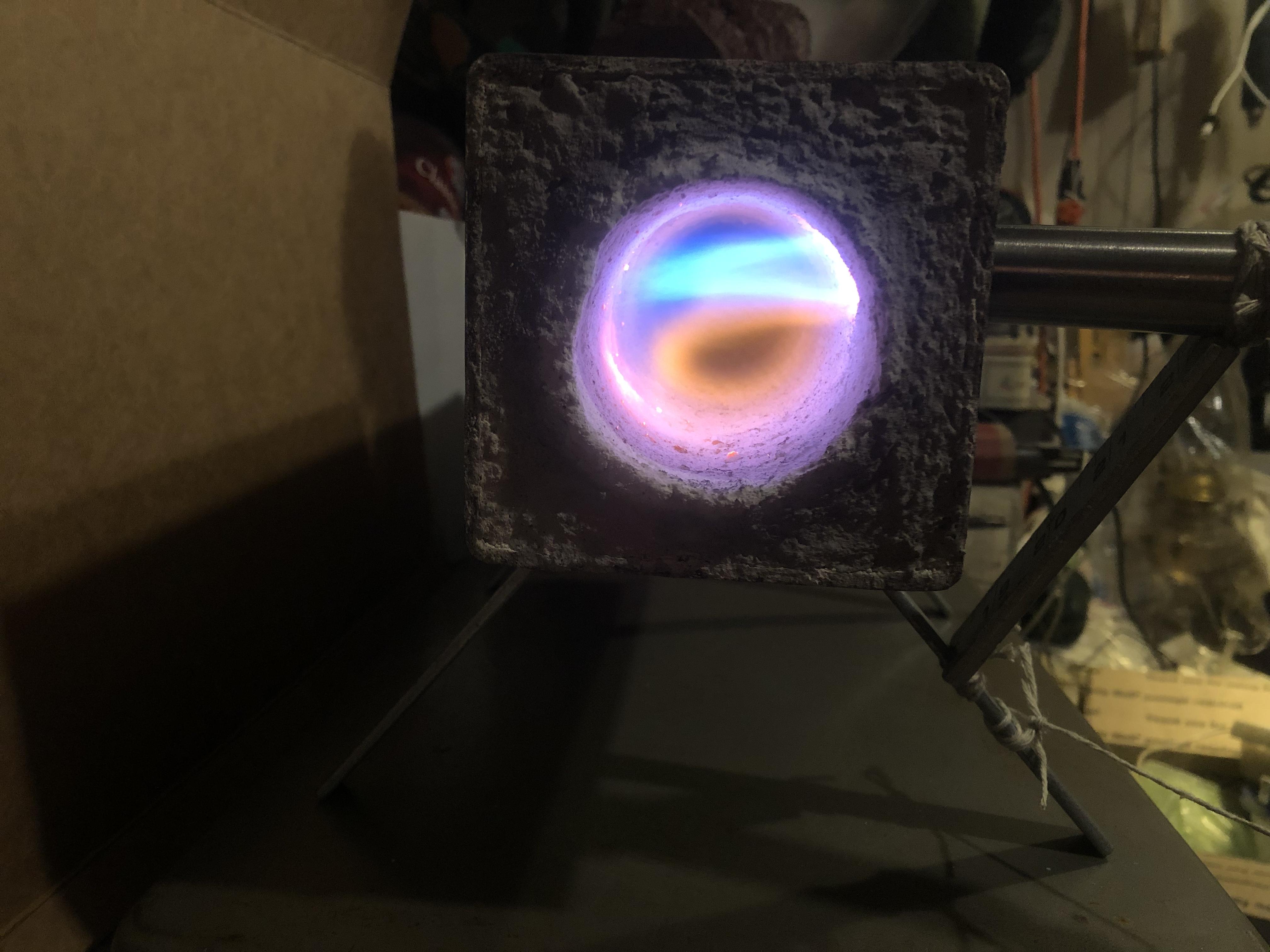

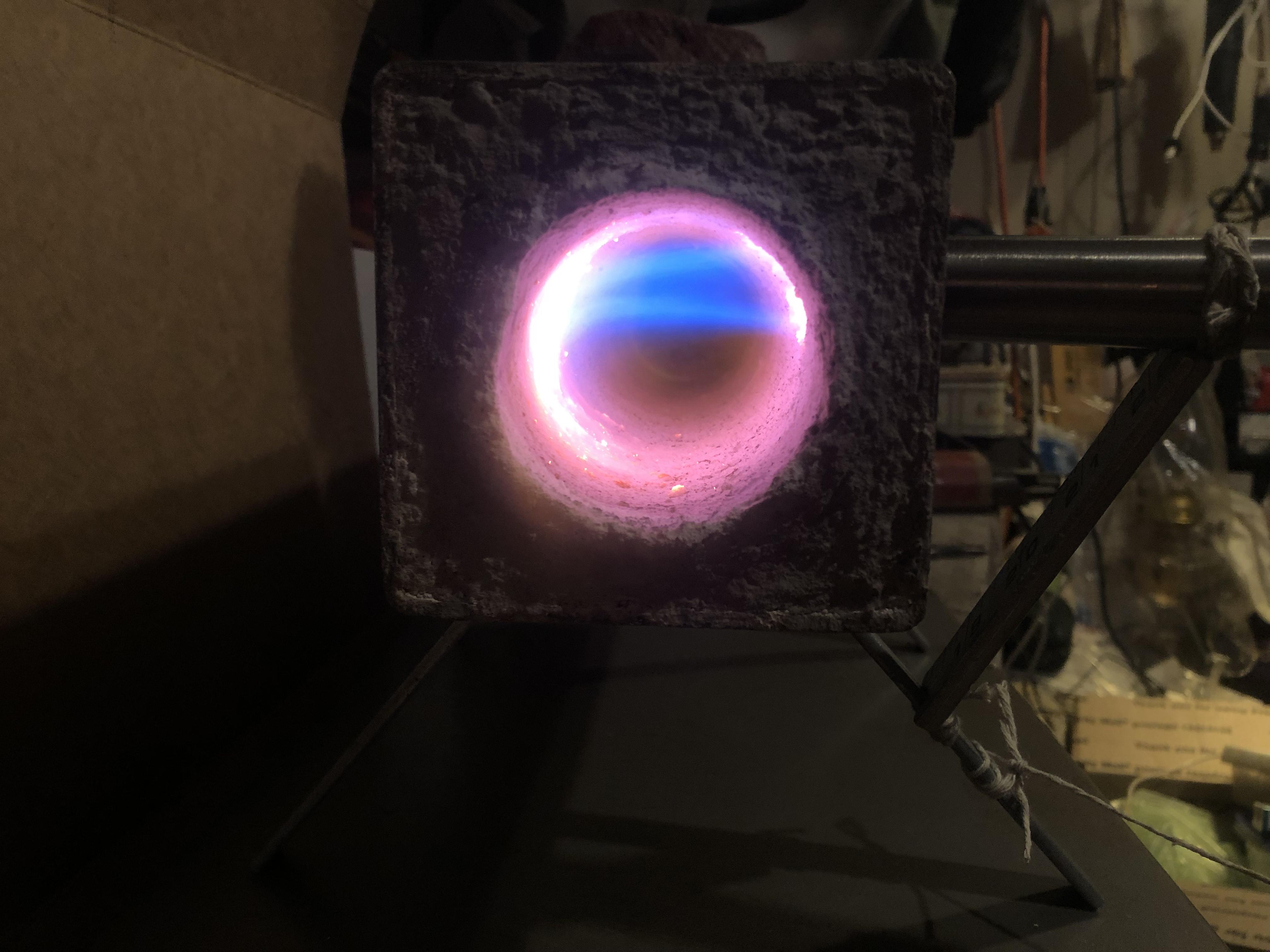

AngryDaddyBird Posted January 22, 2019 Share Posted January 22, 2019 Here’s the flame. Looking better after playing around and adjusting depth ect. It get very hot!! Pictures are from start just out to full power! Also a picture showing flameout the back and front. Is it looking ok?? I never had a production firge so have nothing to compare to? Quote Link to comment Share on other sites More sharing options...
Another FrankenBurner Posted January 22, 2019 Share Posted January 22, 2019 Based on the large exit flame at the burner end of the forge and the small exit flame at the other end, I would guess that a lot of your heat is coming out of the burner and blowing right out the front door. It may have been hotter if the burner were closer to the center of the forge. I finally went and looked up the atlas burners you were talking about and see that your forge looks similar to theirs, in terms of burner placement. Perhaps aiming it more towards the rear would cause it to push more heat that direction. The atlas forge looks to be lined with drilled out soft fire brick. Depending on which firebrick they used, it's durability may be very poor. I am also not the biggest fan of their burner design. I don't own any of their stuff, so I have no clue about them. Based on your burner, I'm sure their forges get hot enough to work, they just need more fuel to get the job done. In smaller forges, this probably matters less to people. That said, your forge looks hot. Nice job again. Don't mind my rant. If you are happy with your forge, it's a good tool. Quote Link to comment Share on other sites More sharing options...
Mikey98118 Posted January 22, 2019 Author Share Posted January 22, 2019 You would get more heat if you could get a neutral flame; that will take more secondary air. On the other hand, your work is probably coming out of the forge with a lot less scale. Also, you haven't put a brick wall in front of the openings yet; that would also raise forge temperatures. Not that they aren't in good shape, but you could get a little more, if you want it. Quote Link to comment Share on other sites More sharing options...
AngryDaddyBird Posted January 22, 2019 Share Posted January 22, 2019 49 minutes ago, Another FrankenBurner said: Based on the large exit flame at the burner end of the forge and the small exit flame at the other end, I would guess that a lot of your heat is coming out of the burner and blowing right out the front door. It may have been hotter if the burner were closer to the center of the forge. I finally went and looked up the atlas burners you were talking about and see that your forge looks similar to theirs, in terms of burner placement. Perhaps aiming it more towards the rear would cause it to push more heat that direction. The atlas forge looks to be lined with drilled out soft fire brick. Depending on which firebrick they used, it's durability may be very poor. I am also not the biggest fan of their burner design. I don't own any of their stuff, so I have no clue about them. Based on your burner, I'm sure their forges get hot enough to work, they just need more fuel to get the job done. In smaller forges, this probably matters less to people. That said, your forge looks hot. Nice job again. Don't mind my rant. If you are happy with your forge, it's a good tool. I don’t mind any feedback! Thanks 47 minutes ago, Mikey98118 said: You would get more heat if you could get a neutral flame; that will take more secondary air. On the other hand, your work is probably coming out of the forge with a lot less scale. Also, you haven't put a brick wall in front of the openings yet; that would also raise forge temperatures. Not that they aren't in good shape, but you could get a little more, if you want it. I had the brick 1/4 away from the rear opening. But I also add a lip to keep the rear ending closed a bit more than the front. The flames out the rear and Fron are almost equal in amount. The burner is faced towards the rear but When I angle the burner even more that way flame only comes out the rear. I tried closing the ends withbricks and it seems to hold heat but the way it’s burning now is very hot. I know now what your saying about neutral flame. I can get it to do that when I pul the burner out and leave a gap for air to come in with the flame. But it actually took longer to heat up and when I put anything in the chamber it blowed the flame back out that gap. Likeghechamber is pressurized. Weird. The forge gets hot! I have a 6” square pipe same length as this forge and I think I’ll use it and put this little one in the6” one but first wrap it with Koawool. Maybe that will help it retain some heat? Not that I think it needs it because it gets way hotter than my micro forge! Quote Link to comment Share on other sites More sharing options...
Mikey98118 Posted January 23, 2019 Author Share Posted January 23, 2019 I think the design you went for has big advantages, but will also create its own limits; nothing is perfect. You have a winner here. If you want to experiment, I would suggest coffee-can or half-muffler forges, with 3/8" homemade burners. I think you would be very good at that. You started out with a highly successful forge; I don't think you would get much of a kick out of incremental improvements to it; that is slow work. Quote Link to comment Share on other sites More sharing options...
